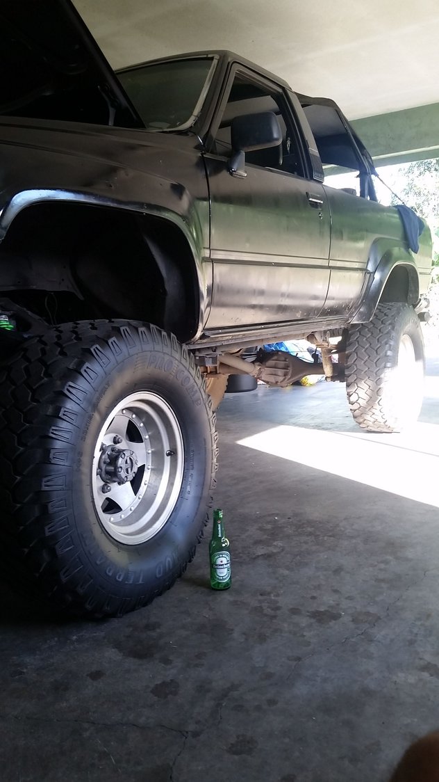

Now I need to change the cv boot on driver side and I have a sway in the rear. Sway only happens when I pull out hard or down shift to fast. Tried tightening the u-bolts. Not the problem. Figured out its the leaf spring bushings

The add a leaf walks out. Ive rechecked to see if u-bolts loosened up. They were tight. Used a rubber mallet to bring it back straight. Test drove it and looked under they moved again. Anyone run into this problem?
Could it be because I haven't changed my leaf spring bushings yet?

Mine always did that when I had them. The factory leaves have the retaining straps on them to prevent that. You can fab up your own set as well.

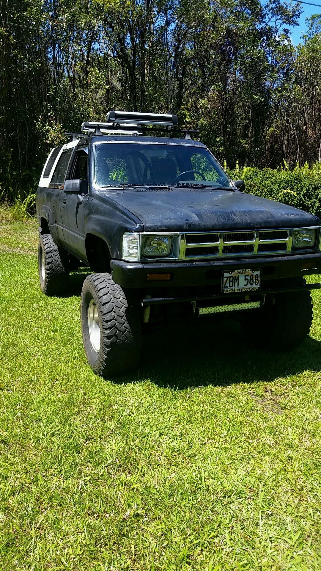

It's a work in progress. I got it totally gutted. Added a second Gen 4runners center console. Rewired the second gens tailgate window switch to the old harness thanks to chefyota4x4. Next is to mock up some interior panels. Theres none in at the moment but it's either particle board or going heavy duty with Diamond plate
Reading everyone's build up has been helping a lot.
