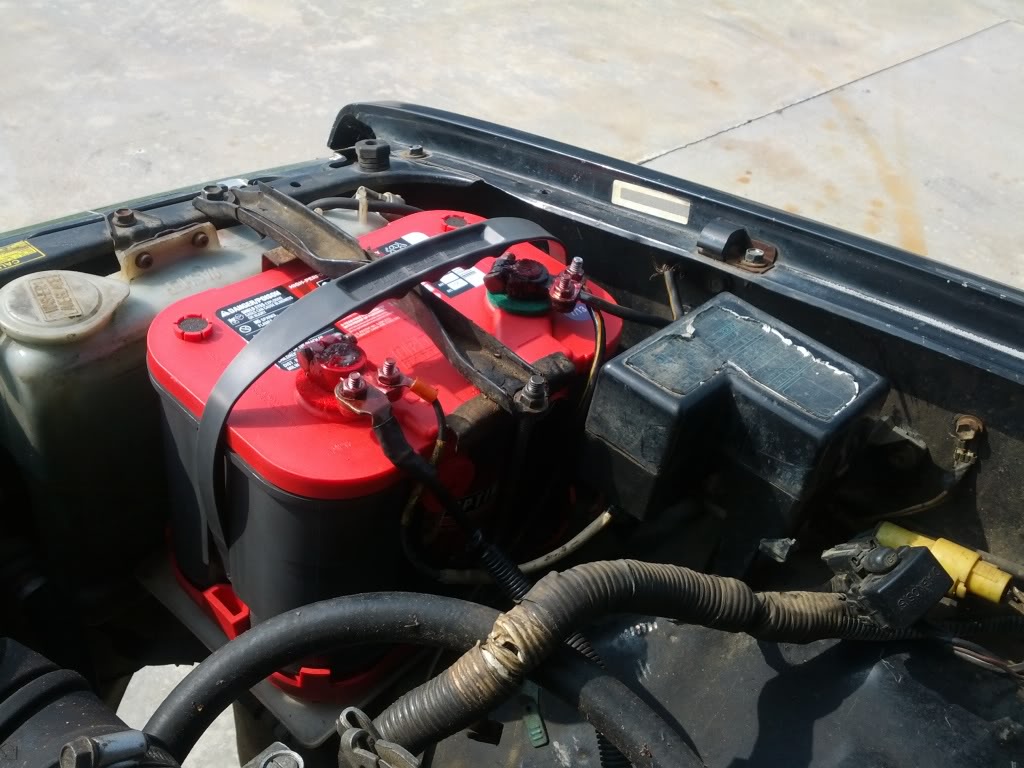

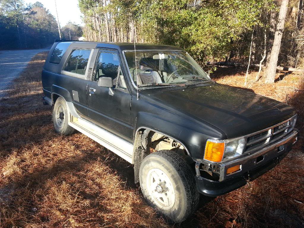

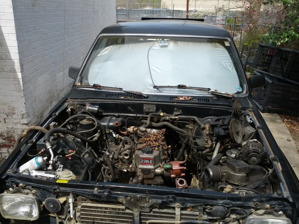

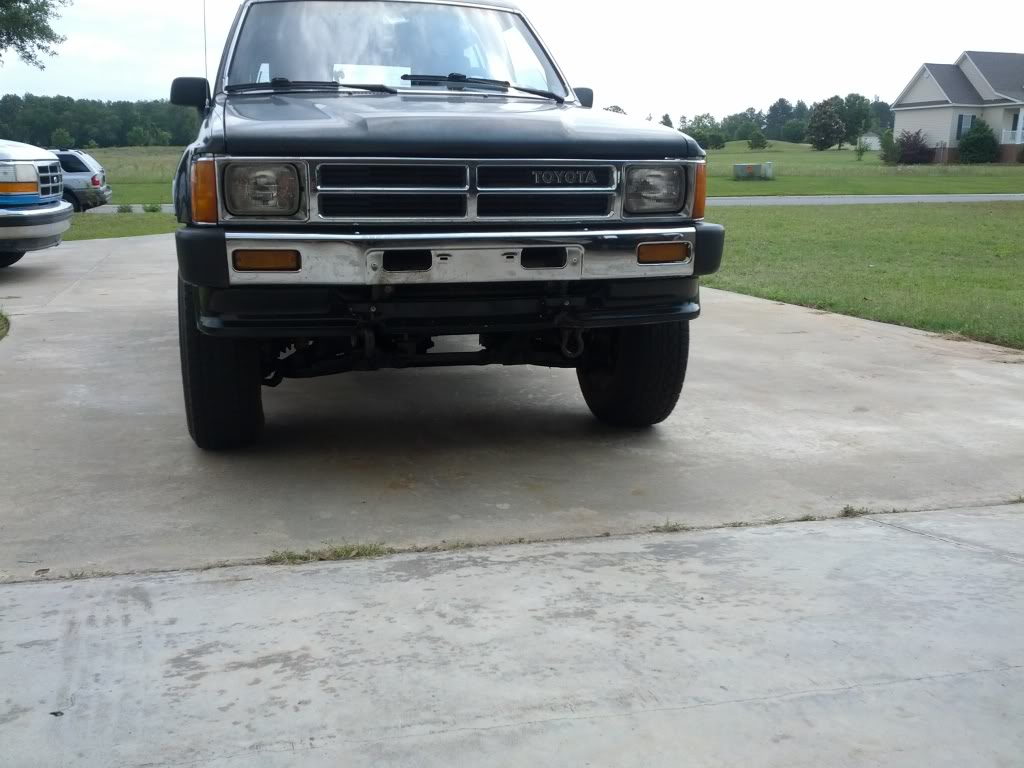

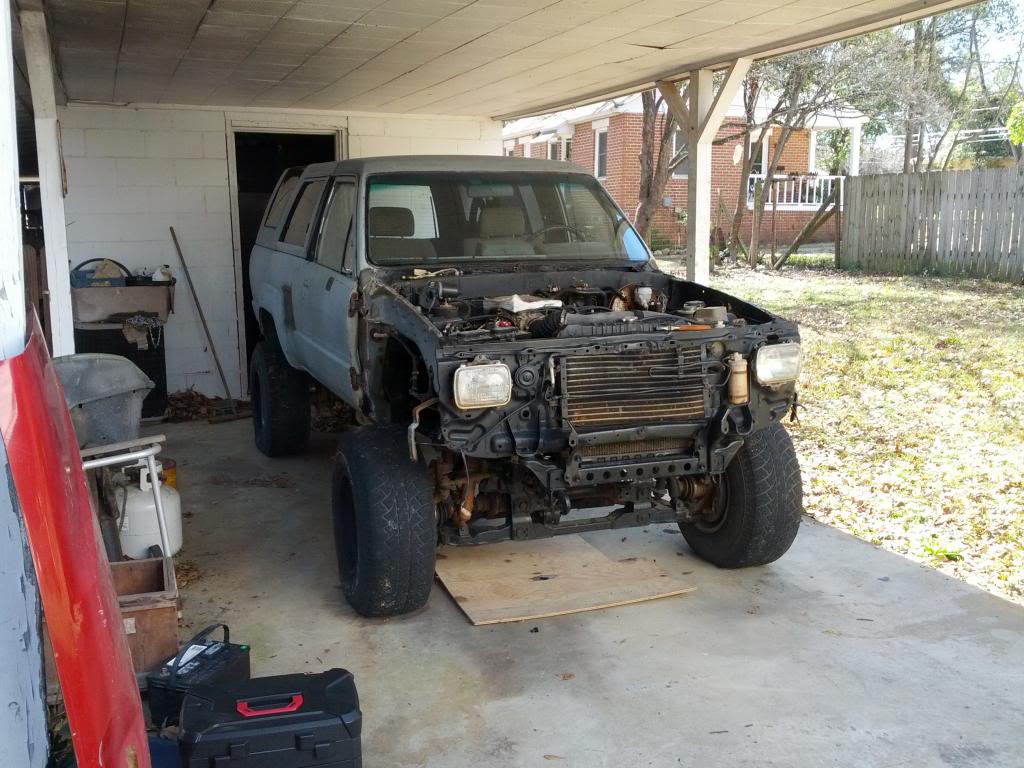

This first one is my second truck, aptly named #2.

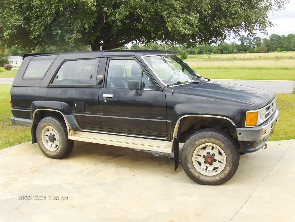

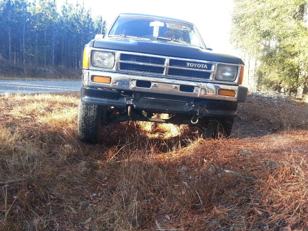

And here is my sweet Black Beauty

Black Beauty looks sweet man, nice and clean..! #2 looks like it needs some love for sure, but its got plenty of potential. Good luck with the motor swap..!

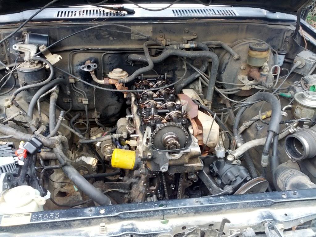

Okay, I got some progress done today.
Black Beauty:

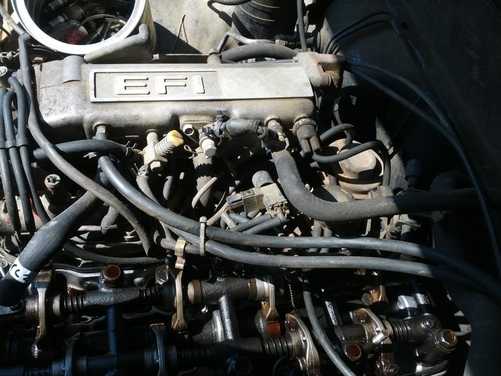

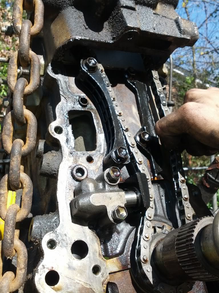

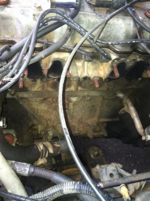

The intake is removed and the wiring harness is fully disconnected, as well as the starter has been removed. So the passenger side is ready to go for the removal of the engine after the fuel filter is removed. Here's a pic of right before I pulled the starter. Shows where it's at. And the valve cover and timing cover are only removed because my mechanic pulled those to assess the timing chain issue it had.
This next photo is the top of the injector, purely for my own future reference, feel free to observe though.
And one more reference photo if you guys don't mind. This one's kind of far off, but I hope it'll still help me later.

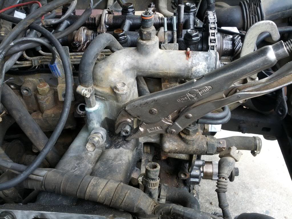

And guys, this is what scares me. I labeled anyhting that didn't seem obvious, but once I pulled the harness away, I began to worry that maybe there's a lot more on there than I thought that isn't as obvious as it seemed. Let's hope that's just my first timers jitters.

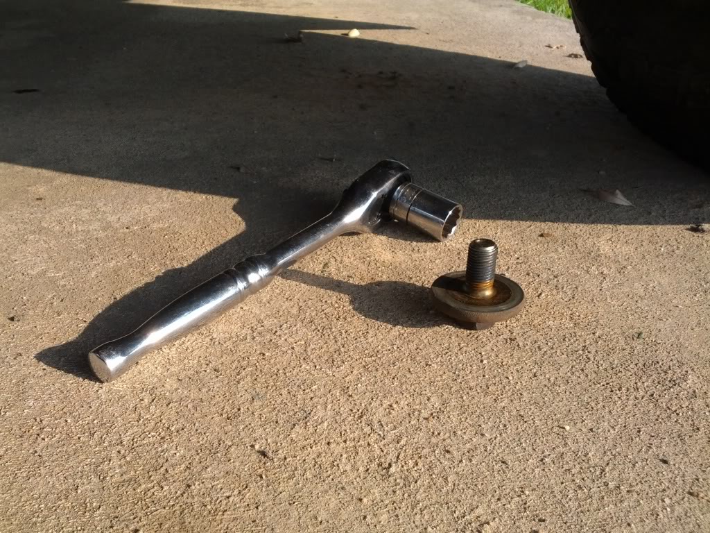

If you strip your allen bolt, just do this. It's so super easy and gets it right out.

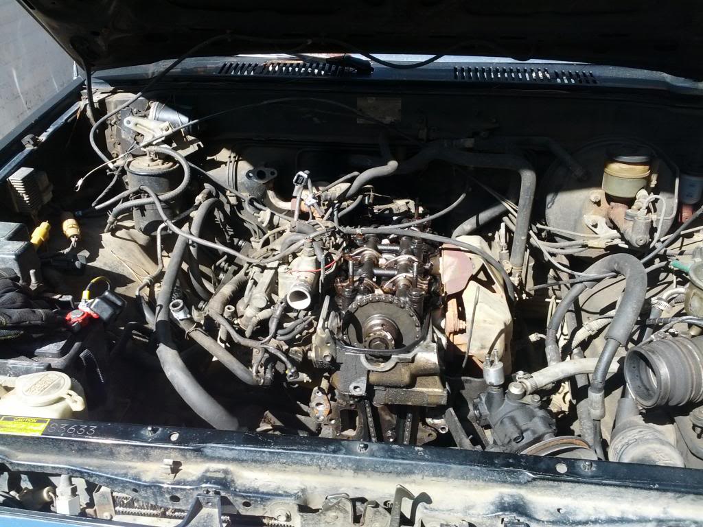

Got nothing done. How it looks in the first post is how it is right now. I did notice an oil leak though. From right here:
Rear main seal, am I right guys? I plan to replace it while it's out of the truck. Because I hate oil leaks, no matter how small they are.

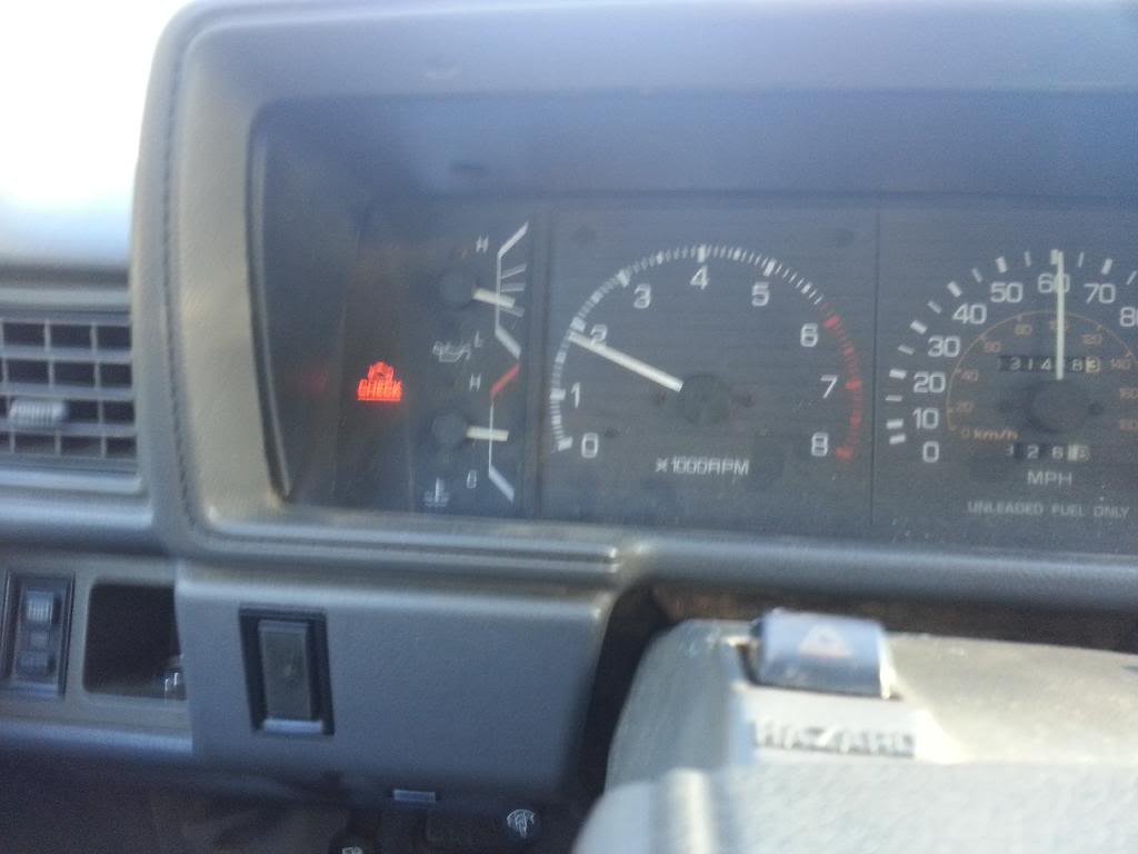

Hello folks. The engine from number 2 is in Black Beauty now. Running beautifully. But... I have a question. Why would the truck leak the same amount of oil from the rear of the engine every time I drive it. After I turn it off, it leaks a certain amount, makes about a hand sized oil stain or less, and then stops leaking? I put a new rear main in, though I know that doesn't guarantee anything, but do you think the oil pan isn't sealing up at the back or would that be a different leak? Also, is there any way to know for sure it's the oil pan and not the rear main?

Hey guys, the question above this one is still open. Also, it's leaking a little bit from the front. It looks like it's coming out of the bottom of the timing cover really. Does that mean I have to pull it off and redo its seal, or is that how a front main leaks? The oil isn't dropping down from the crank pulley, it's from the bottom of my timing cover. Any help is appreciated. I'll update this thread when I get pics off my phone and onto the computer. The only update for the secondary vehicle in this thread, the one that looks rough, is that there is now a bird nest in it.

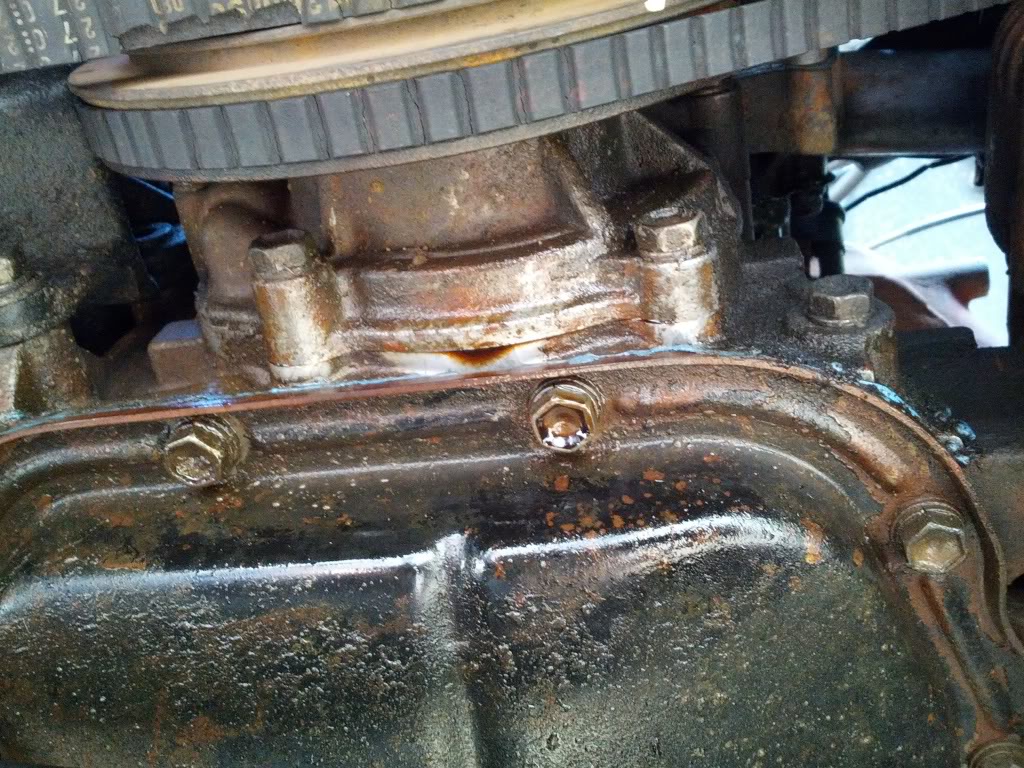

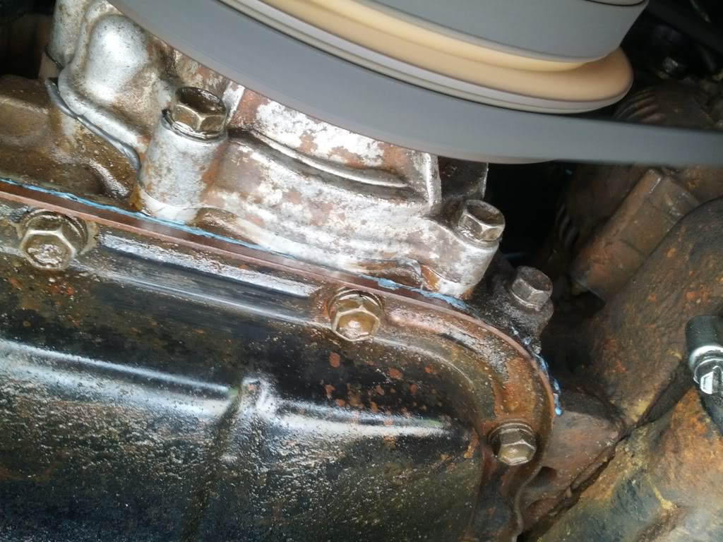

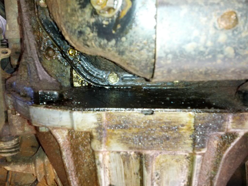

I'm going to do the oil pan for the rear leak, because that's what I'm pretty sure it is. I've already got the oil pan specific silicone from Toyota. But the front leak is while it's running. I'm trying to figure out if I need to pull apart my front end just for a resealing of my timing cover or if a new front main and oil pan gasket will do.
Found this thread.
https://www.yotatech.com/forums/f114/what-earth-going-22r-front-main-seal-leak-again-again-227307/
Good info in it for sure. My leak is where his is, the little black mark between the oil pump and timing cover. I said that wrong earlier. I know I said timing cover to engine, but I meant oil pump to timing cover. The front main would leak at the pulley and a failed oil pump would leak at its bottom, is that correct? So by that assumption, I need to get a new oil pump?

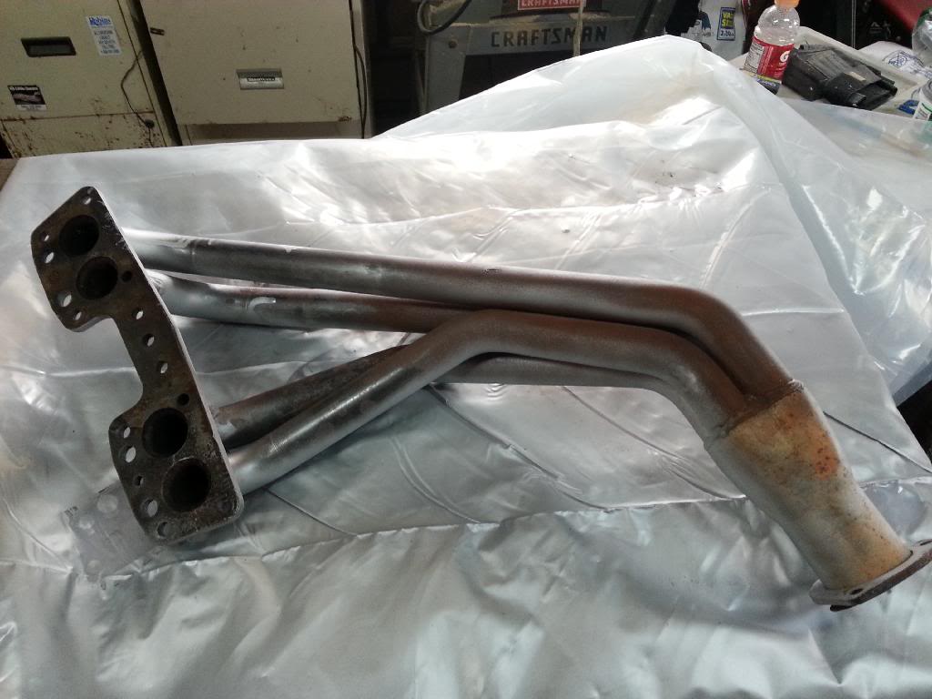

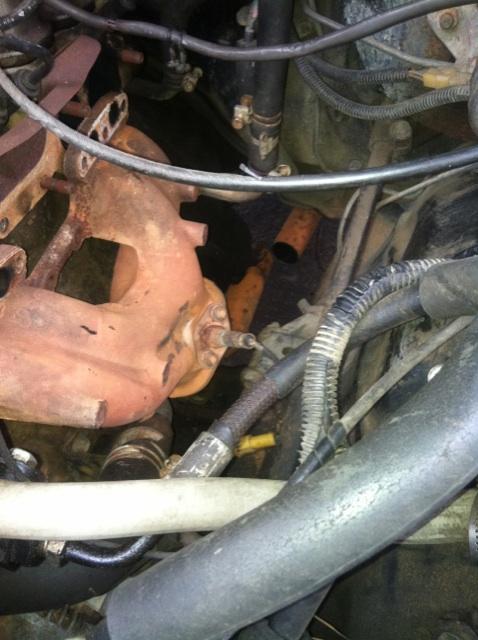

First off, here are a few pictures of the engine swap and getting it done up. The first one is right after the engine came out. The man in the picture is my grandfather, he helped me to get it out as it clung to the transmission.
A picture of what caused all this...

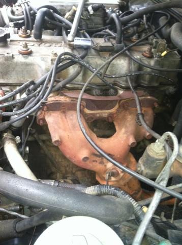

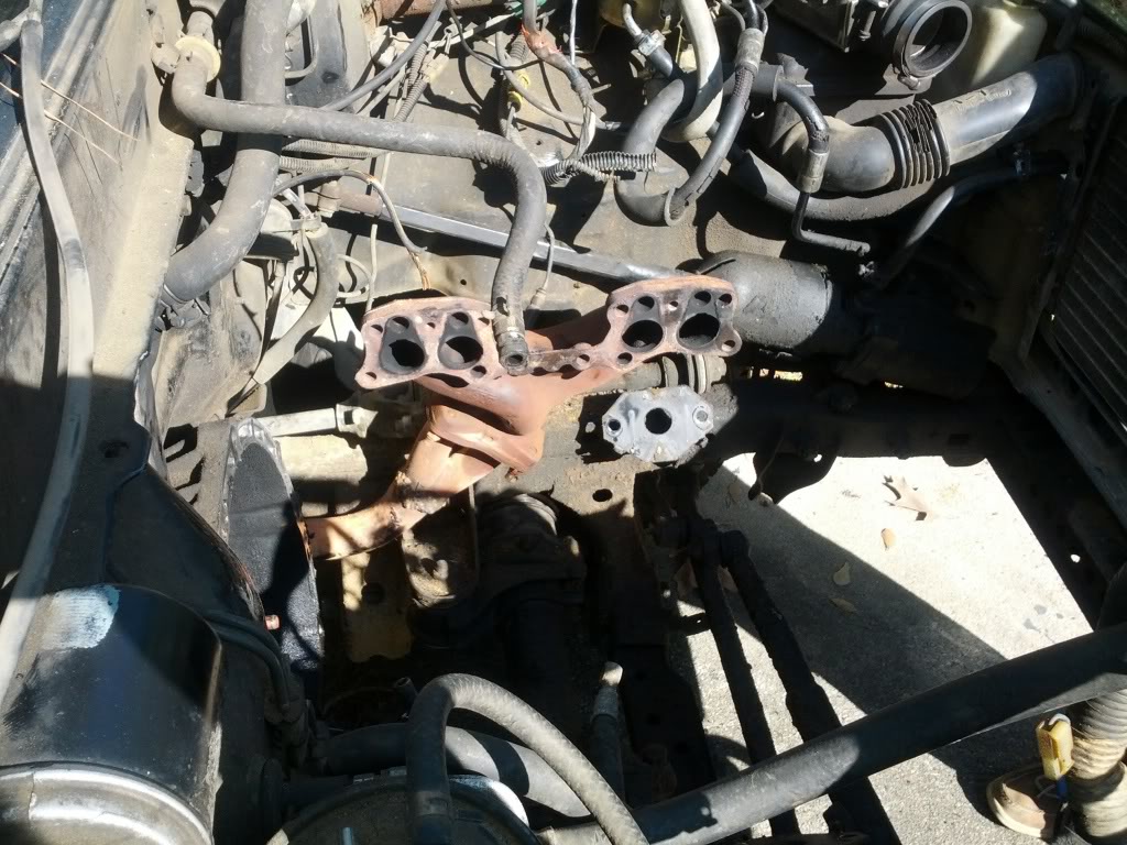

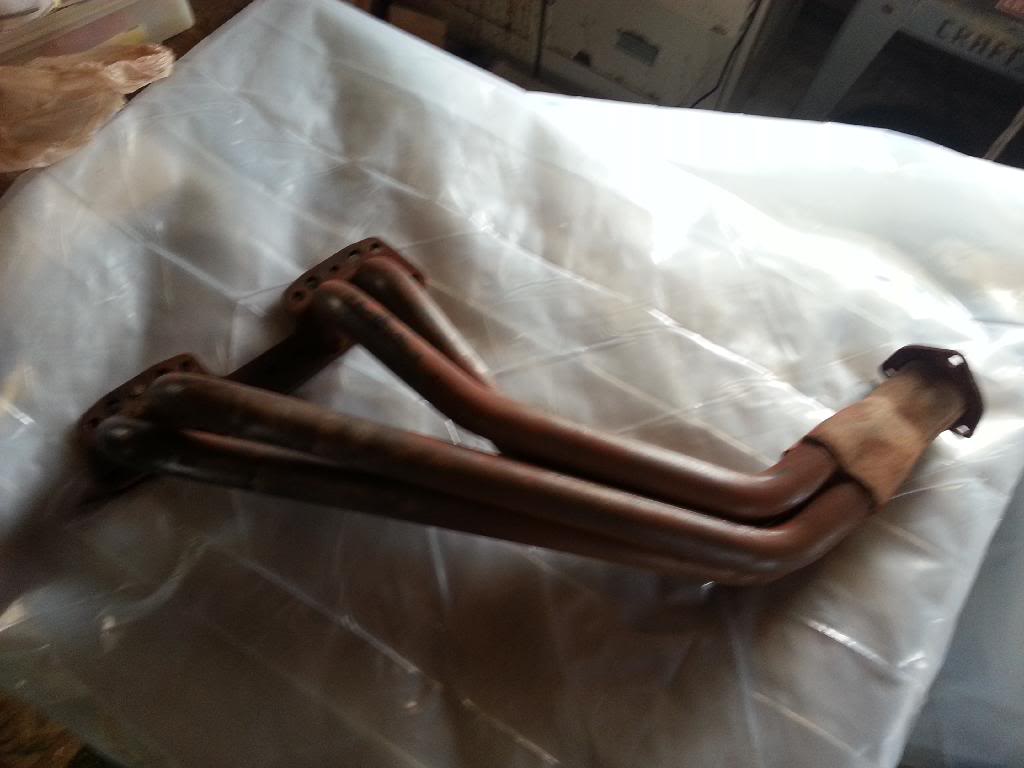

This is one of the engine bay, and my beautifully orange header. I'd like to get an LCE one when I can afford it, but that time is not now.

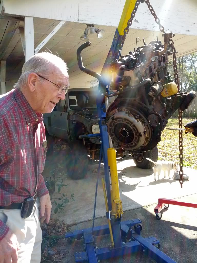

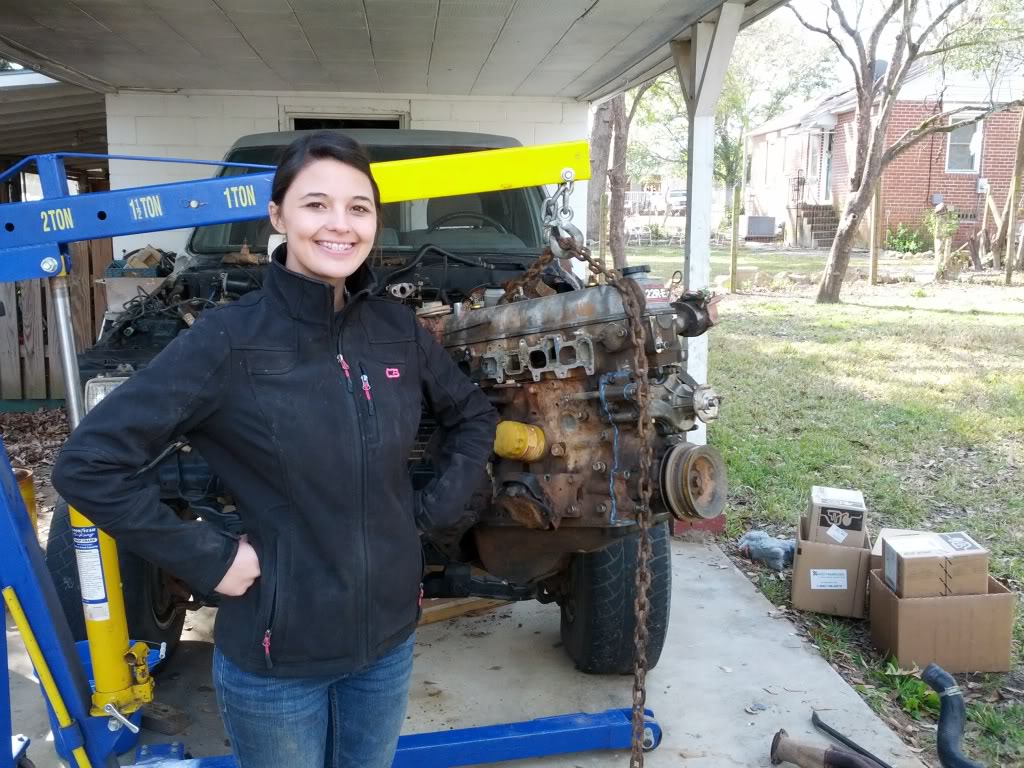

And now we got started on getting the other trucks engine out.
And then it was out. The girlfriend wanted her picture with it. She actually took the manifold off for me, which was pretty cool.
And the BING, BANG, BONG! One clutch kit and flywheel resurfacing later, it's in Black Beauty.

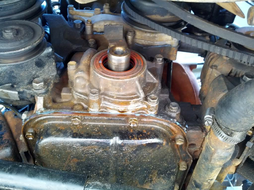

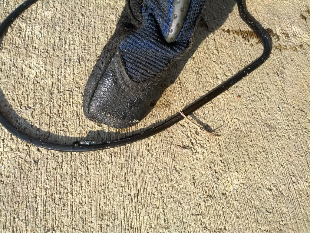

Oil Leaks

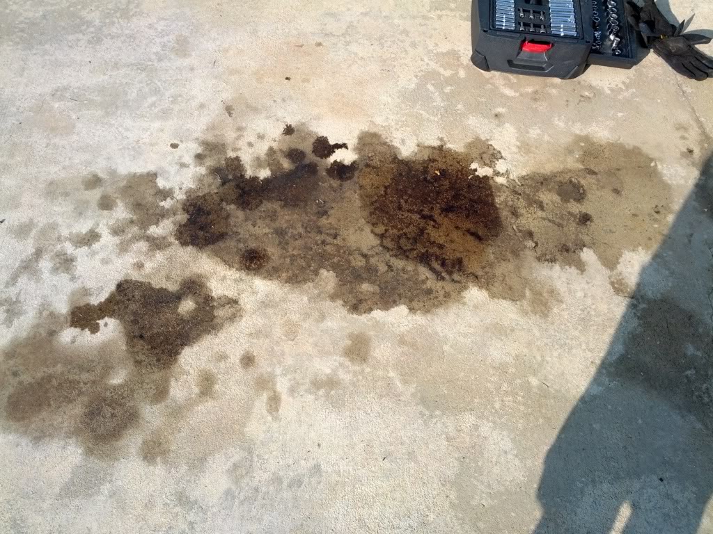

O em gee! An oil leak!

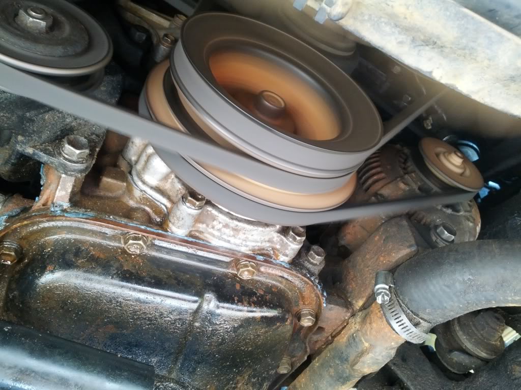

Guess it's time to get the tools and get to work. To get off my crank pulley, I used just my 1/2" drive ratchet and it came right off. But put it back on with your torque wrench at the specified 116 ft. lb.s or whatever it is. Because I'm not just some nerd that knows this from 3 months ago off the top of my head or anything.
Then I pulled off the pulley and stuffed my accessory belts out of the way, like so.
I then loosened up the oil pump bolts with this under it to catch any and all spillage.
And then reminded myself why I was doing this, because I was a little tired.
This must be the problem!!!
Get a hammer and a flat stock of wood to install your new front main that you're installing because you took off your crack pulley
and if you're like me, put a thinny thin thin layer of RTV on the oil pump gasket just to tell it to seal perfect. I'm sure it's somewhat unneeded but I did it anyway. Then as I said before, torque your things that need torque! And then... CHECK FOR LEAKS!
And you're done!

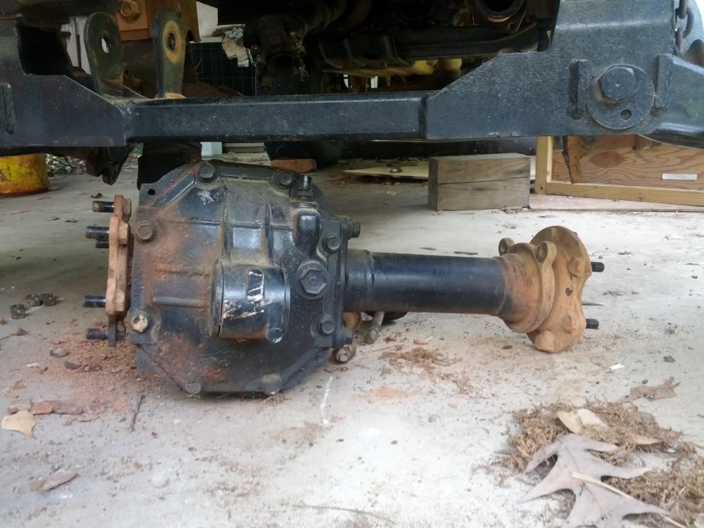

Now pull out you're front diff and do your oil pan gasket.
A lot of folks say you can just undo the motor mounts and jack up the engine, to which I agree, but the room you gain from pulling your diff makes it worthwhile to me. Also helped me find that my passenger side axle was leaking some fluid, so I traded diffs with #2, as is hopefully shown in my post to follow.

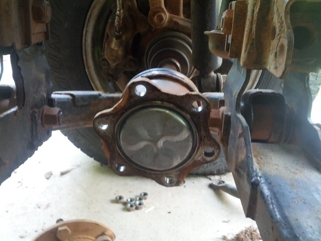

4 Wheel Drive
At this point, I needed something to do, So I fixed my 4 Wheel Drive system. First thing I did was remove (for now) my Aisin hubs and replace them with these sweet easy to use long body hubs. This picture is from when I regreased them.
And now if you're reading this thread and not just thumbing through the pictures, you'll remember that my pas. side axle seal in the front diff is leaking, and has up and down play. No es bueno! So I went over to #2, which is rapidly becoming a parts truck, and took this out of it.
As the truck sits, the CV's are held up by the control arms to some extent, is there anything I can do about that while I wait until I put a new diff in, though I may wind up parting out this vehicle, still undecided. Here'sa picture of the angle, not too bad if you ask me, I think they're holding themselves up.
Anyway, that's all for now, I'll come back later with an update, but right now I'm down in Florida enjoying Mexico Beach. So thanks for reading what I've got so far, and stay tuned for more of my broke and busted budget building!

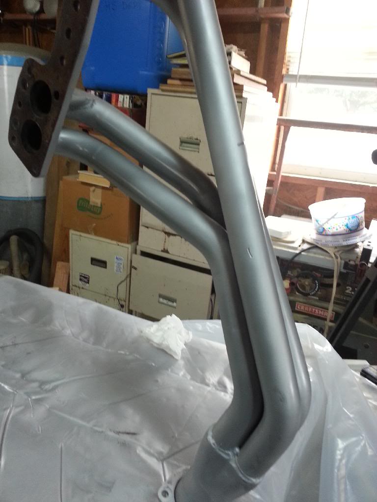

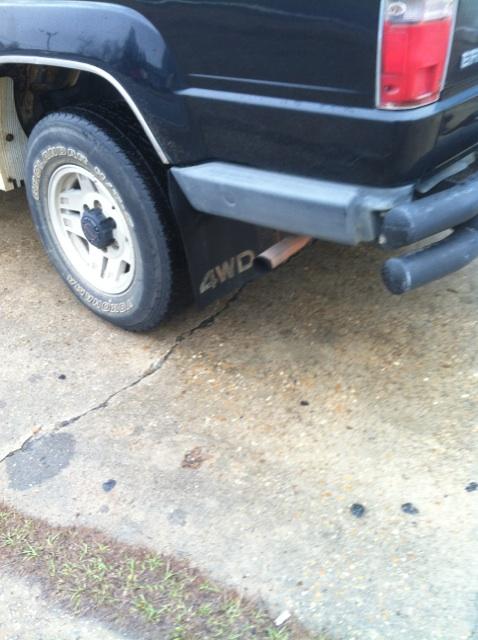

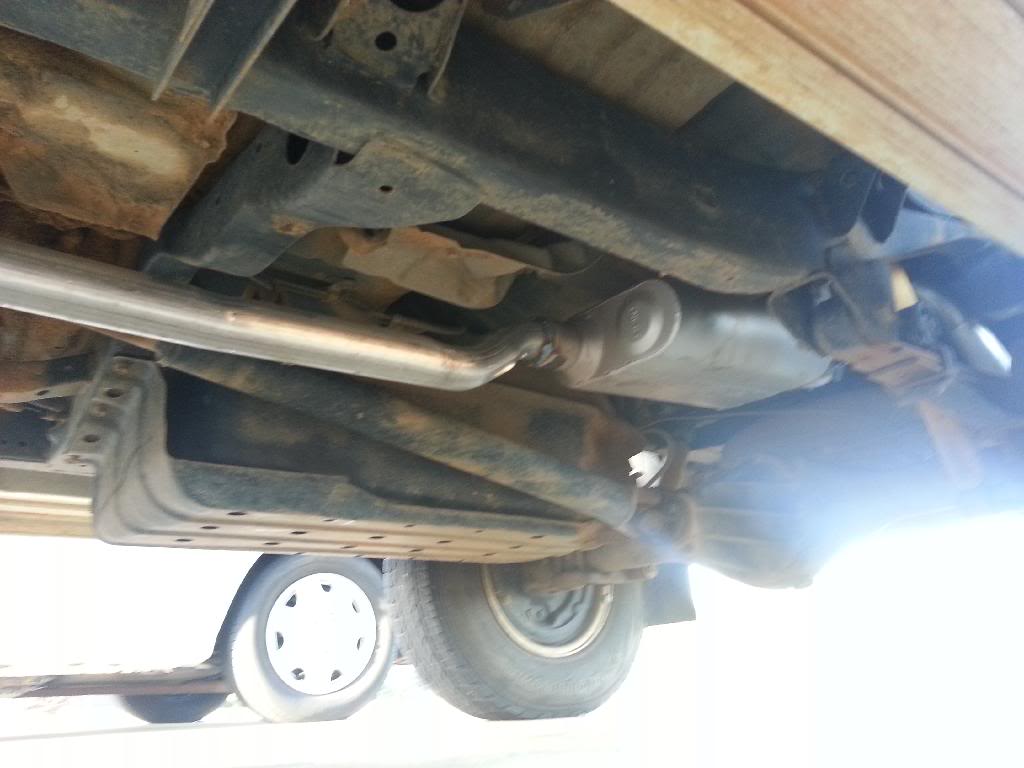

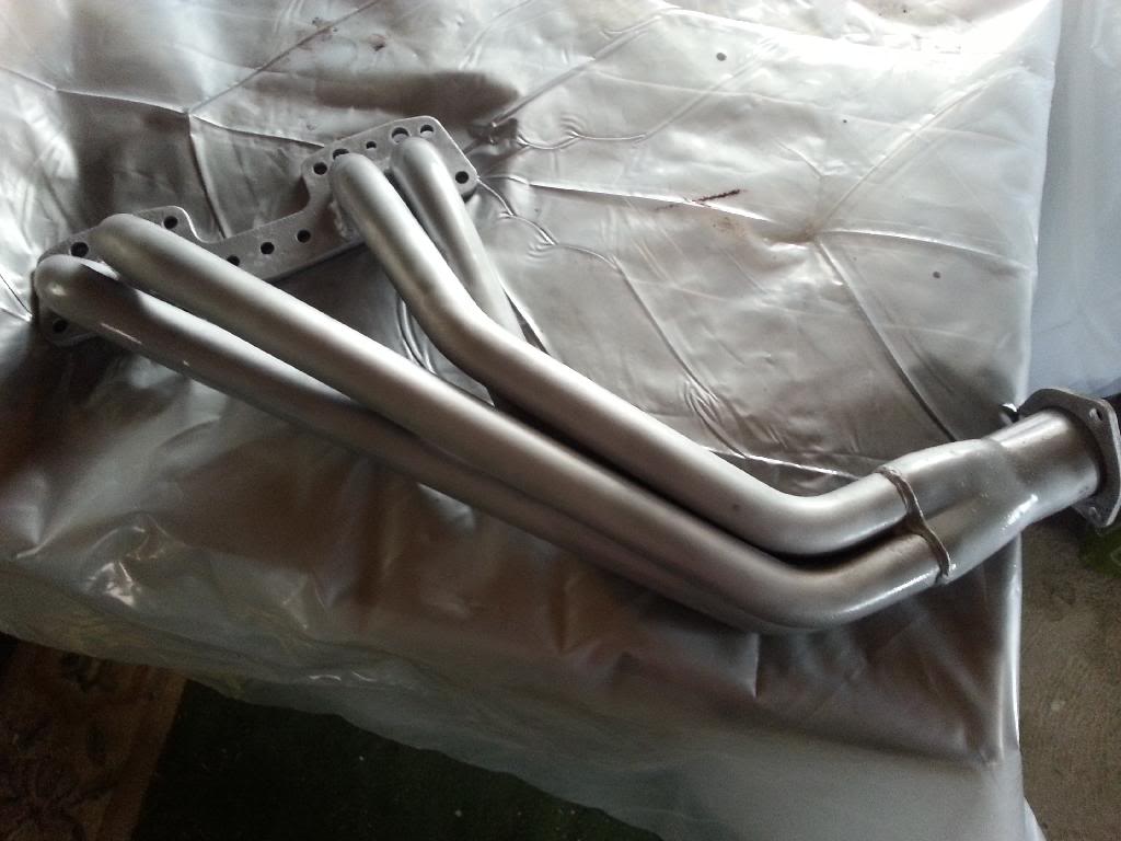

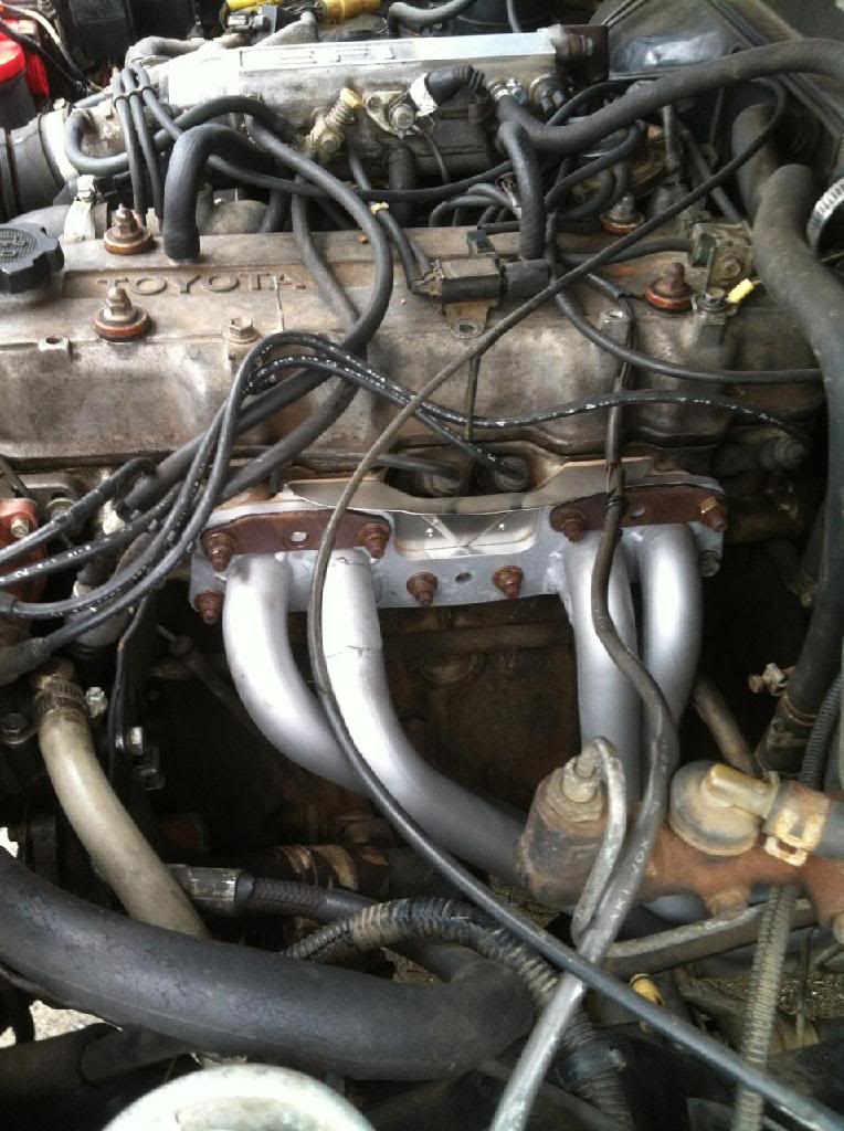

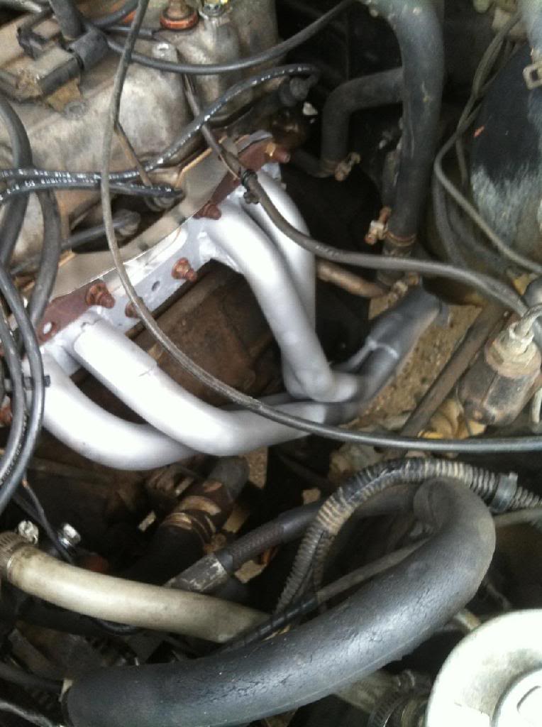

What's up guys! Small update, more really soon! This really is so I can see if I can pay pictures from my phone. I installed an optima red top probably the day after my last post or the oil pump stuff, quite a while ago, but I had to because my battery was needed in what I thought was my boat so it could leave forever, but that's a different story and I can vent elsewhere. So... Optima red top!
That seemed to work, so I'll continue. Here's something cool.
Cool, right? Idk, maybe I'm just easily excited... but the reason I'm excited is that this thing cost me $6.2x total and the header looks new. It's a Pacesetter and I've seen mixed reviews, but I'm going to give it a go. I was ready for a new exhaust anyway so this was awesome! Anyway, I know that this requires very little explanation so I'll just post more pictures.
How about it guys? Yay or neigh? It sounds really cool, I gotta say I've always loved the 22-RE's idle through a flowmaster 40 series. It's kinda loud so I may be going back to have it quieted down some. Something else I'm bothered by is that you may notice the lack of O2 sensor. Anyone know if I can buy just the pipe with the O2 bung in it that usually comes with a header new? Or can I just bung it myself? Idk... I'm still too new to this stuff to be honest. I didn't understand what the exhaust shop guy was telling me. I have an O2 sensor and he had a bung to weld on, but he said there's one more part I needed from my original manifold. Really confusing. I thought he'd just bung it, I screw in the new Bosch O2 I bought, "bang, bang, bang, I'm back before weeks end, we spend the money. How is this a bad plan?" King's to you if you get the reference. But really, what am I missing here? And a final picture to bother you with...
And thank you to anyone that reads this, reply or not. It's just cool to me to see you guys are interested, even a little. hahaha
! EDIT !
Ignore the hardware for the header in that picture. I'm getting new hardware from Toyota today. In about 2 hours hopefully. They said lunchtime. And I'm east coast.
! EDIT !

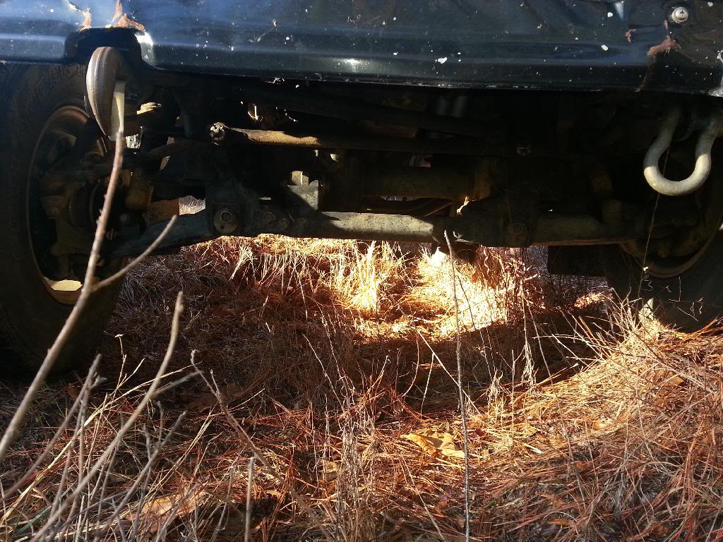

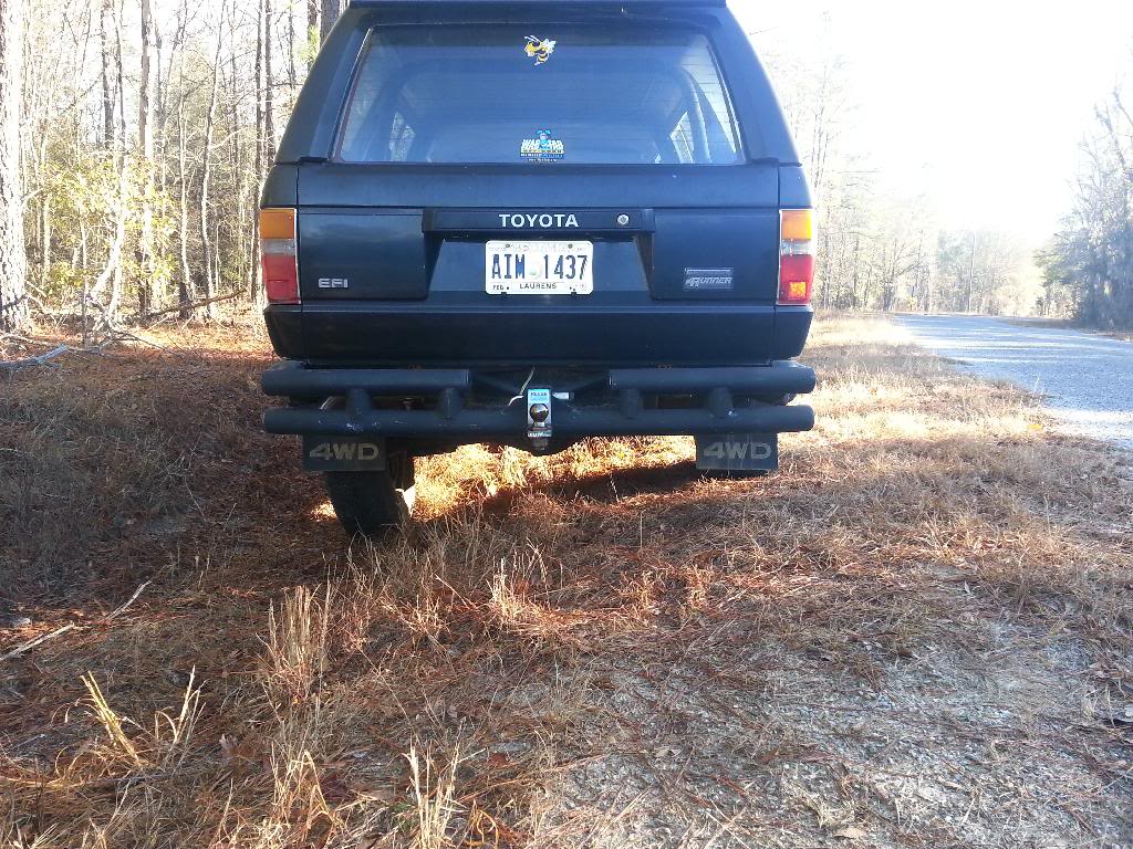

Just some pictures of sweet IFS flex. Yes, that was sarcasm. I like the rear though.
Overview shot plus rear tuck!
Front
Closeup of lower control arms
Overview other side and rear droop
And finally rear end overview

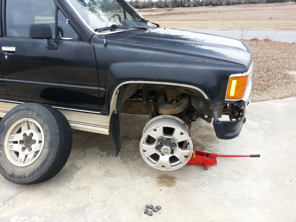

Mere moments ago I test fit my new rims. Not sure if I mentioned in any above posts, but I have a set of 05 trd prerunner rims to go on. They're 16x8's as opposed to the good ole sr5 15x7's on it currently.
The only fitment issue is that the wheel weight will contact my tie rod end. I plan to run the minimum wheel spacer I can get away with, but that may be determined later. I'm not sure at all about it.
However, I was thinking that even though a 1" spacer will probably be enough, maybe 1.5" will be better for my comfort while off-road and under any heavy cornering, which I don't do because I have no sway bar (which feels NO different). I'm just not sure if 1.5" will be too much when I look down the side of the truck and see wheel sticking out. I also don't want body damage when the rear wheels tuck. I plan to talk to the wabbit before I order wheel spacers but I have seen next to no-one running these rims on these old trucks, and I don't see why? They're both hub centric rims off a Toyota, made of lightweight aluminum, and the 16" rim is easier to get tires for.
I'll also be getting the tire shops idea on it if they'll talk to me. I'm going by there sometime this week, because one of my friends wanted me to help him out with tire choice on his rsx-s. It's an awesome car too, hot hatches are fun. I'll be sure to post a pic even though it's off topic. I mean, the rims he got have a 3" lip. hahaha
