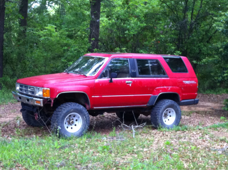

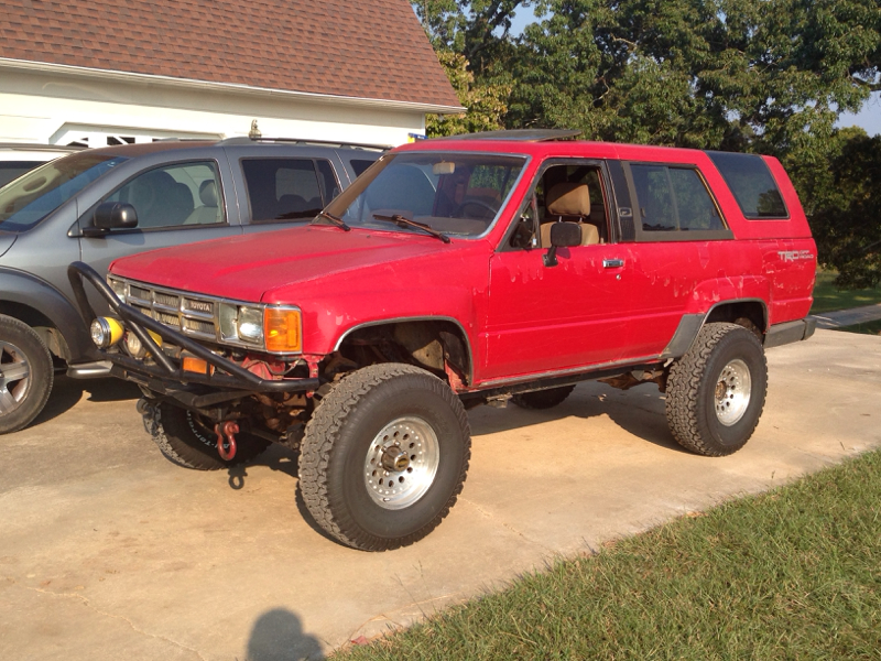

I've since fallen in love with the piece of junk. I guess I don't need to explain the love between a man and his 1st gen to anyone here. I've done some odds and ends... new brakes, wheel bearings, CV boots, parking brake, things like that. Spent about 6 hours cleaning countless pounds of mud from the interior. Got some used wheels (Old ones were mismatched), caught a set of 33x10.50 BFG AT's on sale (personally didn't like how 12.50s hung out for a DD. For some reason I like mildly lifted trucks to have tires and body in line), and got a buddy to mount and balance them cheap. All together I've only got $835 in the wheels and tires M&B. Here's a couple pics as she sits now. '86 4Runner DD/Mall Crawler Build-image-2098942317.jpg '86 4Runner DD/Mall Crawler Build-image-1015409735.jpg

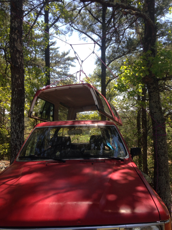

REDNECK HARD TOP HOIST
Things are already getting hot here in Bama, and with no money for a soft top yet, and no one to help me take the hard top off -I live alone- I spent about $70 at Lowes and whipped up a little 3 pulley system. Save your flaming for someone who tried to do something perfect, cause I didn't. I didn't measure a thing, know nothing about pulley angles, and had it done in 2 hours including the trip to lowes. But it works just perfect for me until I can get my tan softopper. I'm sure you could make it more perfect if you planned to use it permanently. Most of it is self explanatory....I used carabiners through the bolt holes at all four corners. If you use the upper bolt holes up front (by the sunroof) you'll obviously need to shorten those 2 ropes to compensate. Top 2 pulley knots are Butterflies. All other knots are figure eights, most could be done on a bight, some had to be done as follow throughs. I purposely overshot the weight of my top at 300lbs and bought all hardware accordingly. The only thing that seems stressed is the 4 corner carabiners, they are only rated for 75lbs each. If you plan to use this permanently I might upgrade these, but they're working for me.

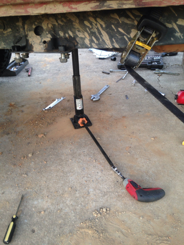

In the midst of putting in a new flywheel and clutch kit, thought just for laughs I'd share a few things.
Firstly, my redneck electrici-fied bottle jack.
'86 4Runner DD/Mall Crawler Build-image-662905279.jpg
'86 4Runner DD/Mall Crawler Build-image-3261796948.jpg
1/4 to 3/8 to 11mm to reversed 1/2-3/8 reducer.
It works, that's all I'm gonna say.

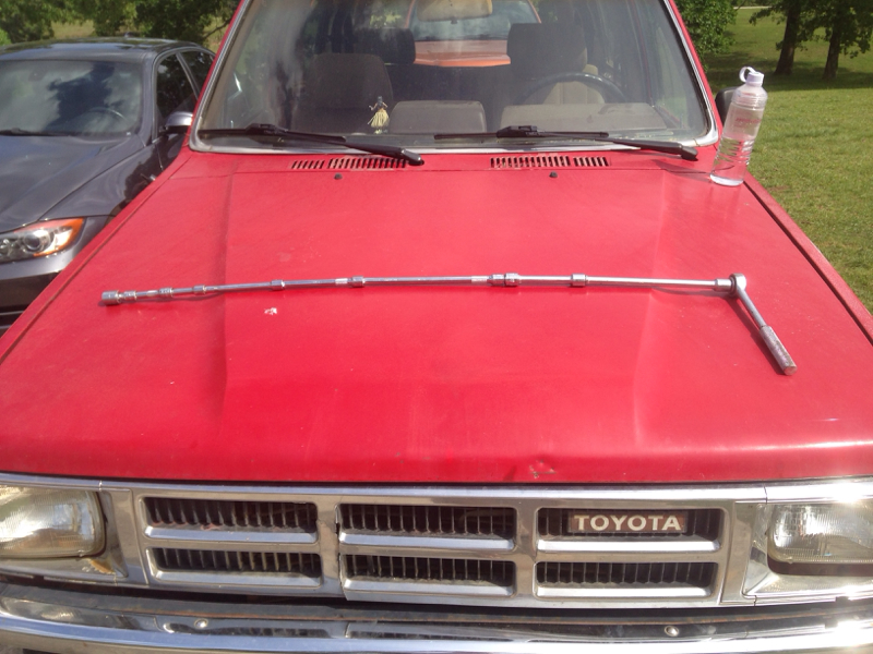

Also here's what it took to get my top 2 tranny bolts out
'86 4Runner DD/Mall Crawler Build-image-238097368.jpg
43" from end to end. Thanks 80's toyota engineers.
Here's another....
'86 4Runner DD/Mall Crawler Build-image-4221604168.jpg
Transmission jack? I'll be danged. The infamous electrijack and a few good ratchet straps.
Just for the record I went to HF later that night and bought a tranny jack. Lucky I still have all my fingers.
Old May 16, 2014 | 09:29 PM
konayota86's Avatar
Joined: Apr 2010
Posts: 63
Swivel sockets come in handy for bell housing bolts.
I've done the ratchet strap method also haha.
