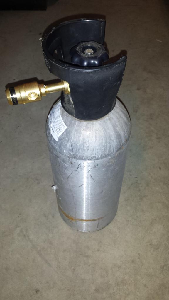

Here is the C02 air tank that I have assembled. This uses a piston style constant regulator. I have mine set at 125 psi, but I could do 100 or 150 depending what I wanted. I felt that 125 gives good flow for airing tires up quickly, but still reasonable for running air tools. I am using a 10lb aluminum air tank with handle. I have listed these on my website if anybody else is looking for a cheap alternative to the other high end tanks that other sell.
Here is what the regulator looks like.
I am using a used tank here in the pictures as I had a tank and wanted to make sure this all worked before selling them. The ones on my website are brand new tanks.
all put together, still needing to attach the quick disconnect and the hose.

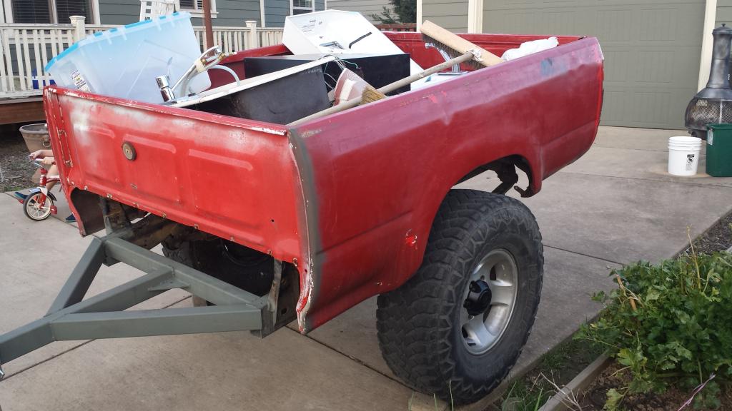

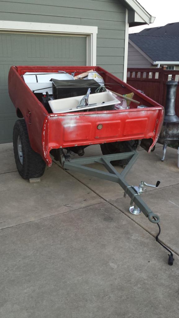

Made a little progress on the Toyota trailer today. I used 2"x3" square tube for a 2" lift block during the build stage. I will get solid 2" blocks for the complete trailer. I wanted to check clearance for the 35" tires. I also went with a ubolt flip kit. Doing this negated the stock shock placement. I put a set of shock brackets on the axle tube and have the shocks in the stock upper mounts for the moment. I plan on adding a tube across the frame rails and putting long travel shocks on the back eventually. I also welded up the front A brace. I am not finished with it yet as I need to round the corners and finish welding it in place. I added the ebrake handle from a 4runner to the bottom of the bed and have it hooked up to the factory rear drums. This will give the trailer its own brakes when sitting by it self. I still plan on fitting a custom cut piece of diamond plate to the front of the trailer I think. I also want to fit my 35" spare to the tongue as well as a mount for 2 scepter cans as well. I haven't decided if I want to add a water storage or another fuel storage area in the stock location and use the factory fuel hole for that or just leave it open and find a door. Slow progress but progress non the less. I am still looking for a nicer bed and an elocker. Once I find the nicer bed I will swap it out and paint it to match my 4runner. The elocker is so I will have an extra on the trail as a spare if needed.
I also have all the lights working like there supposed to. The amber turns work independently of the brakes and the tail works work as well. The only thing not working is the back up lights.

What material did you use for the trailer lift block?
The right side looks like it is kind of mashed. Might just be a test fit for tire fitment testing?
Edit-just enlarged the post on my phone and saw they are temporary...
The matching wheels look great

Old Feb 24, 2015 | 04:56 PM
  #336
85toyman's Avatar
Joined: Oct 2009
Posts: 1,044
Likes: 6
From: Centeral Willamette Valley Oregon
The right side looks like it is kind of mashed. Might just be a test fit for tire fitment testing? Yeah they are just temp material to see tire fitment.
The matching wheels look great. Thanks
I think having an extra tank in the stock spot with an transfer pump would be awesome.
Cool. I was thinking that an extra fuel tank would be awesome to have on the trail when its for long periods of off road adventures.
