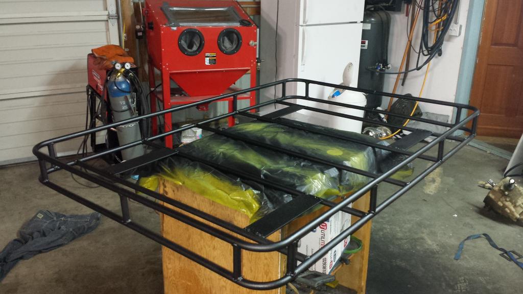

Finished building my roof rack this morning. I wanted a custom unit since I couldn't find anything that was built to the size and specs I wanted. It will allow me to install a 32" LED light bar in the front between the bars and fits nicely above the top without hanging over to get hung up but not so small as to be useless as I found with most other manufactures.
The mounts are built up on top of the tubes so the rack dosent sit another 1" or more above as others designs either. All around I am pretty happy with it. Just need to be installed on the Zrunner and then put my hi lift and shovels, ect....

glad to hear you got the TPS issue figured out, its probably a big relief having it running like a top again! I like the roof rack, it turned out sweet! Can't wait to see pics of it mounted! I'd like to build one someday. What size and type of tubing did you use on yours?
Thanks rustED,
I am very happy indeed. It drives me nuts when things don't work like they are supposed too. I am a little ocd about having stuff work correctly.
I will post some pics once its all put together and on the Zrunner.

Originally Posted by rustED
Your roof rack looks awesome mounted! What size tubing did you use?
Thanks,
3/4" tube .85 wall. So it's pretty light and strong. I used spray on truck bed liner to coat it.

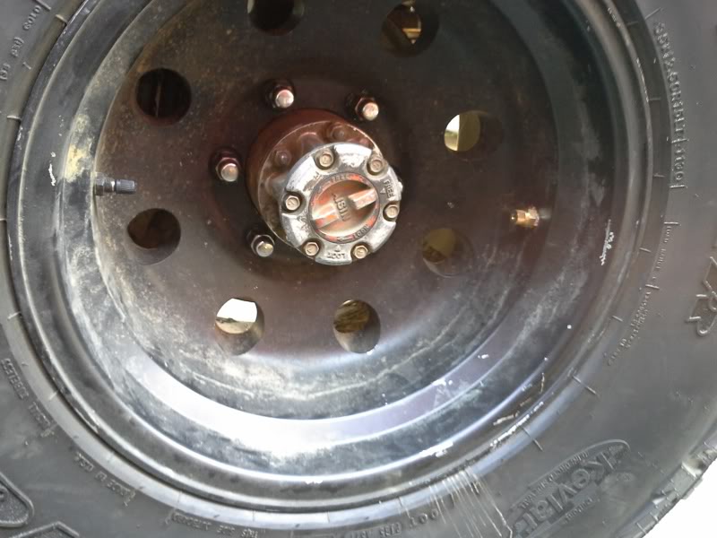

Originally Posted by 85toyman
Hey dropzone
What kind of wheels and tires you running?
Wheels are 15 x 10's not sure of the brand, they came with the 1st set of 35's i got in a trade
Drill and tapped for monster deflators
tires are Goodyear Kevlar MTR's 35x12.50's which i am not sure if i would recommend or not. Great traction but took a little while to balance, i ended up using about 10oz of airsoft beads.
i had some wobble issues periodically that i thought were tires but could have been my steering box. Replaced the box and did the airsoft beads at around the same time. Seems to have gone away.

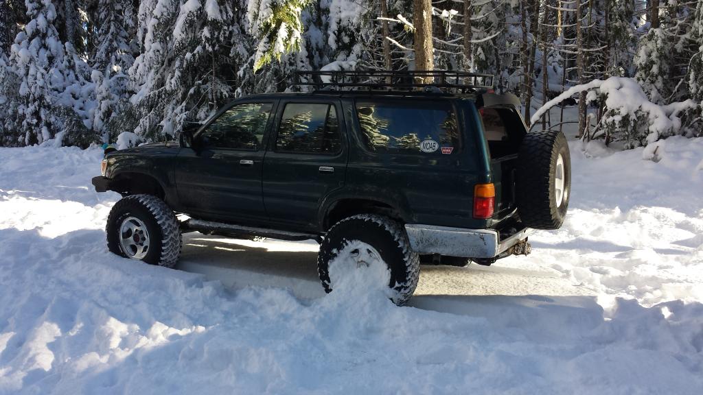

Here are some recent pics of the runner. I have been really happy with the double elocker and solid axle. Those along with the 1uz make this thing an awesome trail rig!!!
