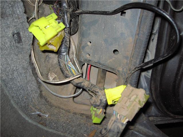

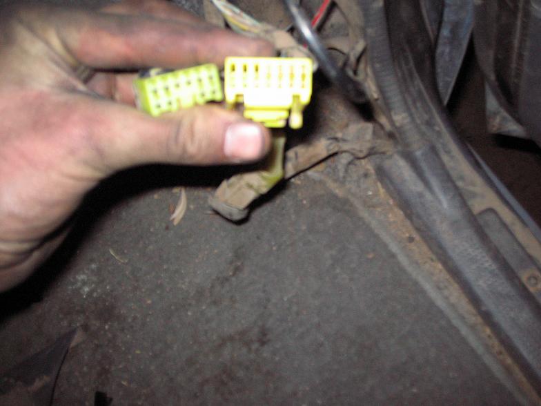

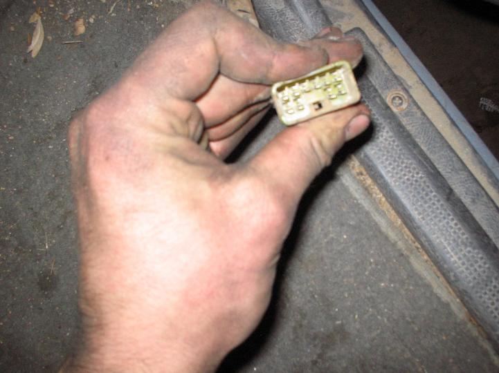

This is what mu kick panel area looks like, which connectors are ih1 and ih2?
Attached Thumbnails 7m's swapped & sas' d 87 extended cab-getattachment1.jpg   7m's swapped & sas' d 87 extended cab-img_0892.jpg   7m's swapped & sas' d 87 extended cab-img_0893.jpg
