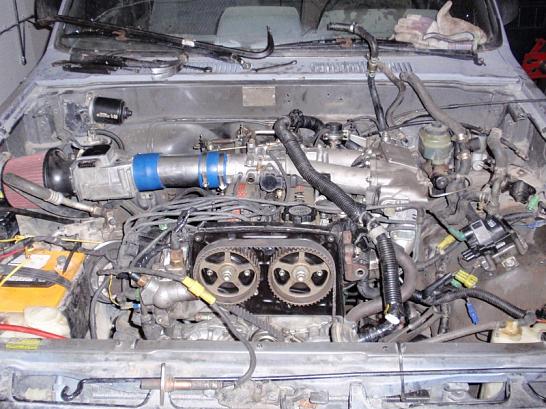

Look like your coming along nicely, I made some good progress today. Here is a pic of my engine bay as it sits right now. DO you know which fuel line is feed/return? I think feed is at the rear of the rail and return is at the front but I'm just not sure.

ps, very nice, was your's a efi modle to start out? oh and im so jacking that coil location, i have mine up to high and doesn't fit the stock wires...

Yep EFI from the start, so wiring should be easier. I had the same problem with you as far as the coil goes, mine was mounted up higher and all of the wires wouldn't reach. Thanks for your advice on how to get the engine in there, worked just fine for me. I just had to do it twice because I forgot to put the back cover plate on the first time.
