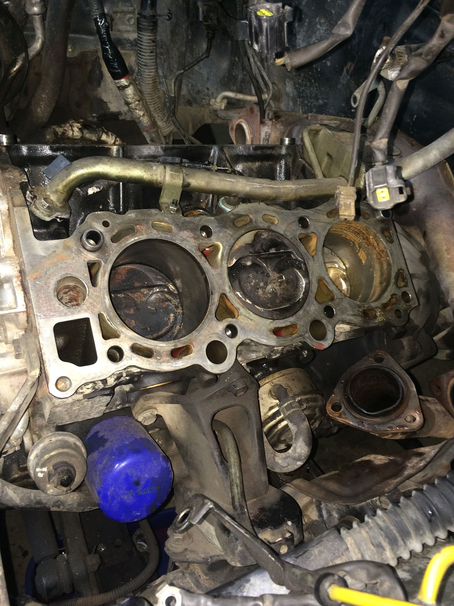

Here are the pictures i took
Pictures of before
Something off
Intake off
Cam Gears off, (Hint: open valve covers and use a crescent wrench on the flat spot on the cam. It was much easier then holding the gear.)
Right head off
Both heads off
cleaned up
As you can see, cylinder 6, back right, was steam cleaned i wish i would have video taped me draining the oil. I filled almost 7 quarts because of the coolant in the pan
