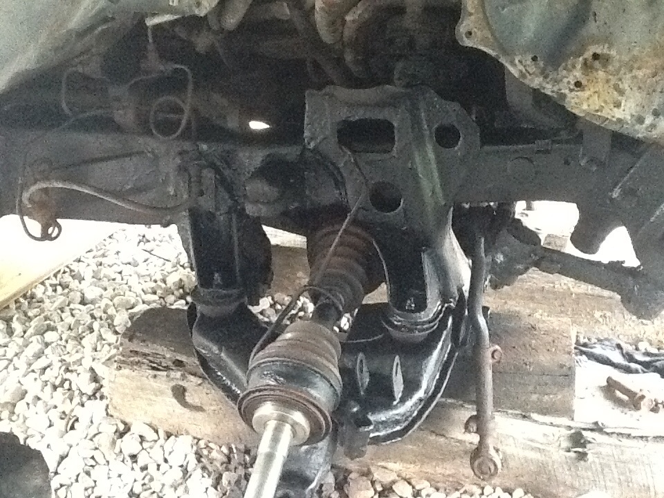

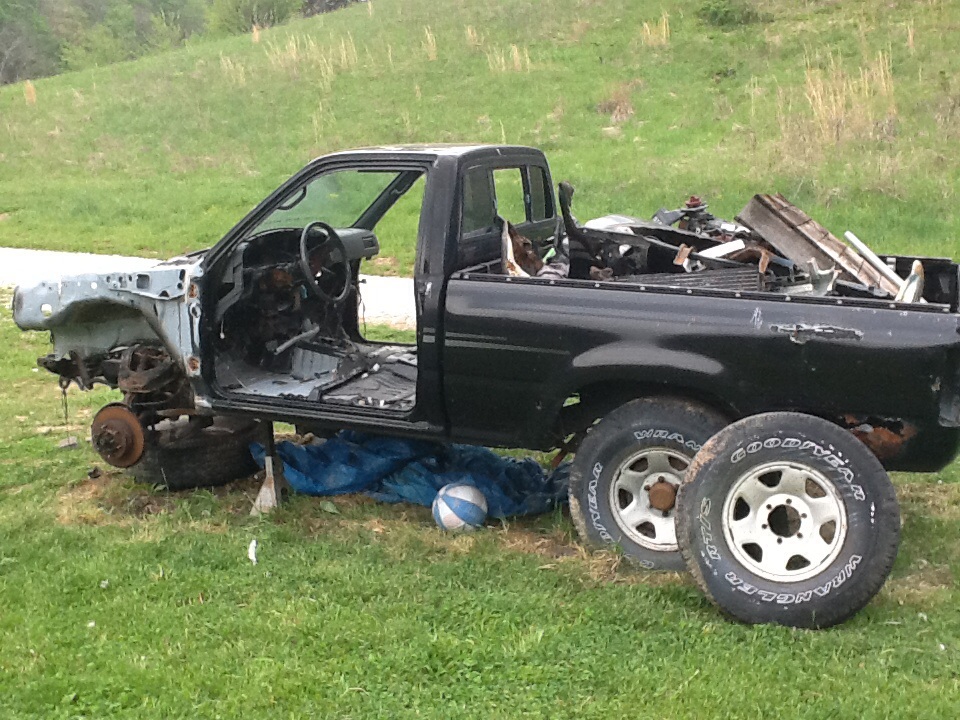

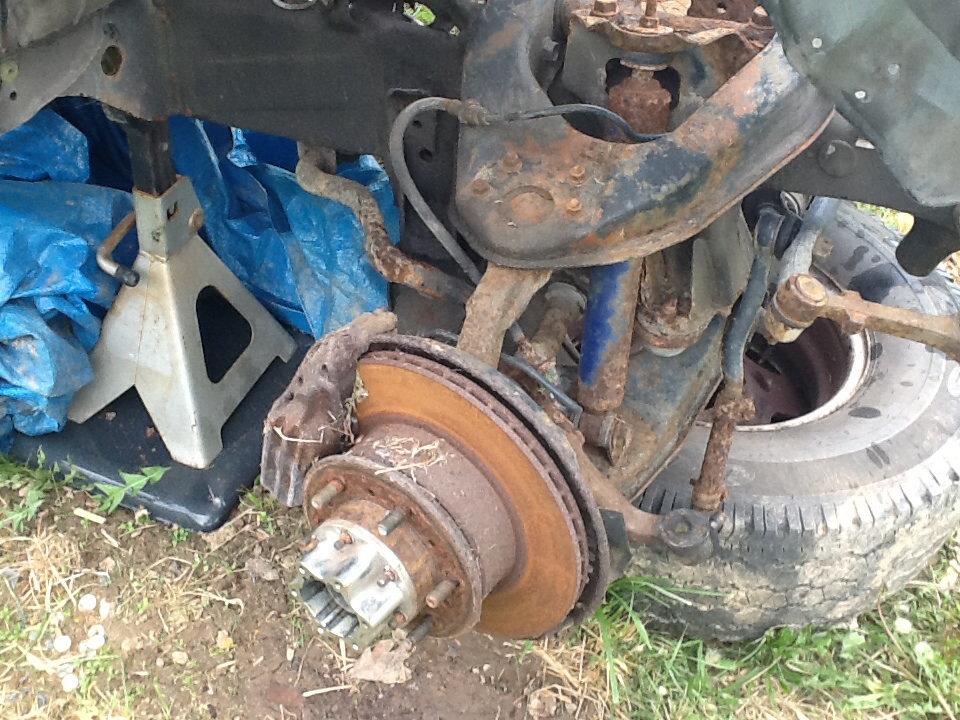

It's bloodroot! The roots ate a deep red colour. They are found near ginseng sometimes. I am not going to tell if I found some or not because ginseng goes for around 400$ a lb. bloodroot for 3 to 9$ a lb. anywho, I got a lot more done today I finished taking off the shock on the pass. side and had to brush the rust off the lower control arm. I got it down to bare metal and laid some rusty metal primer, then black paint, then undercoating to protect from further rust. I also sprayed the inside of my frame with some internal frame coating from Eastwood. Here is the parts truck I'm disassembling also.

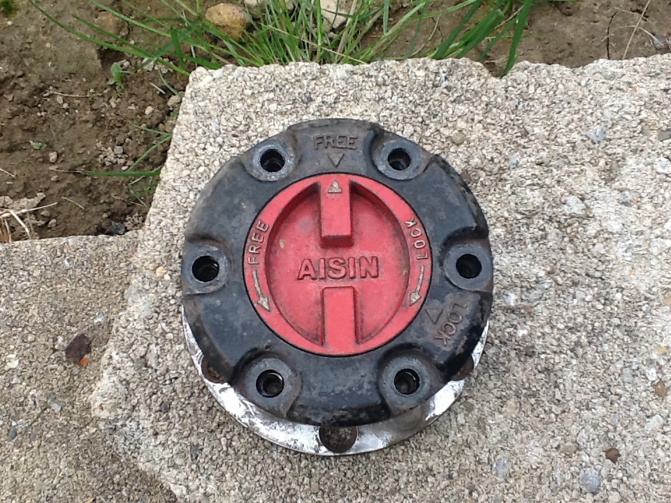

I also got a nice set of hubs from this truck.

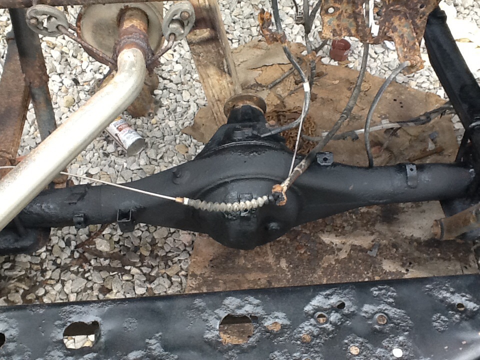

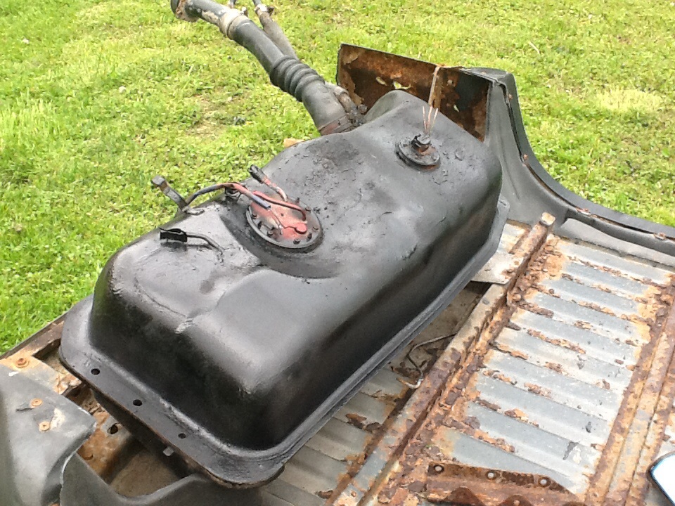

I finally got the tortion bars off of the 94 and I got the upper control arm off too. I cleaned it up and laid the paint n' stuff to it. Along with my gas tank, leafs, and diff.

And the finished project on the lower control arm.

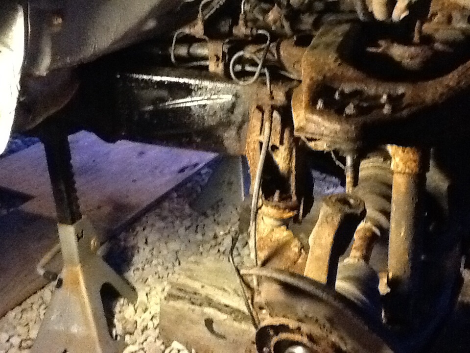

Now, I need some HELP, I have a broken lower ball joint bolt, how do I remove it, or should I use my parts truck for a steering knuckle?

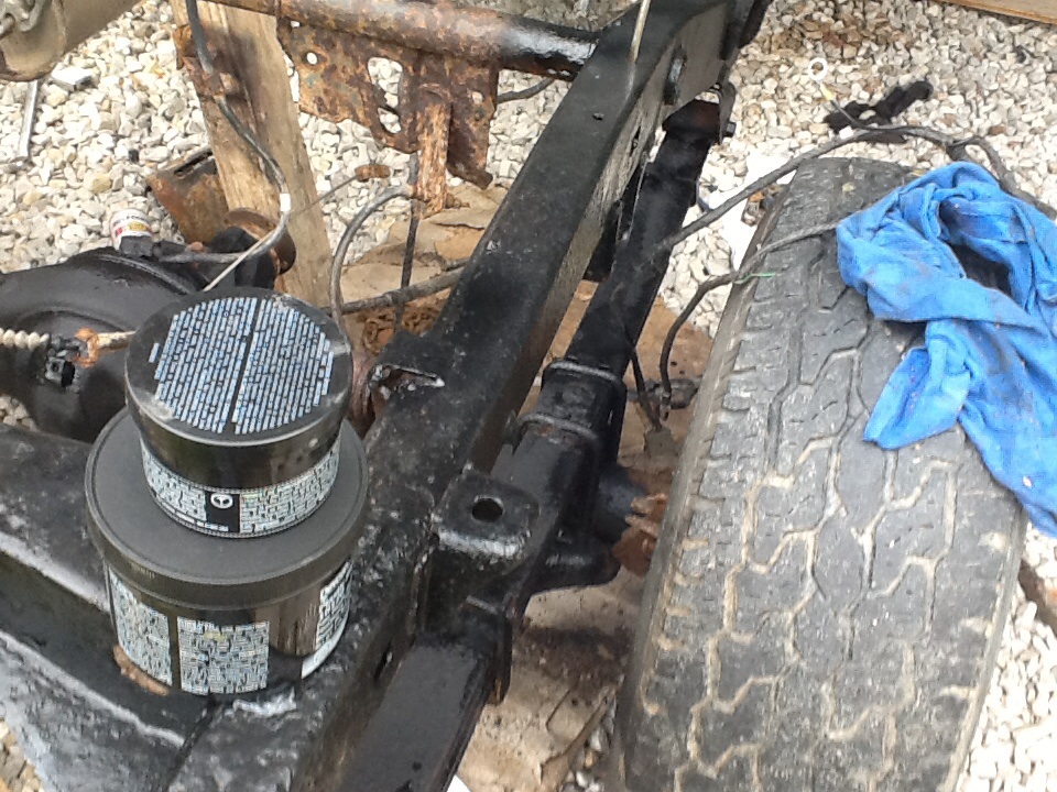

In the upper pics, there was a few of the same pics posted, and they weren't what I was wanting to show. The DEVCON I used for the diff. is on my frame in the pics above.

you could take the rest off and then grind that down and drill retap it but that would be my last resort try soaking that thing in pb blaster and getting the others out and the bj off so there is somethig to bite on and use vise grips and try twisting it out. or i dont know how well it would work but i know at my work we sell this kit where you drill a hole in the bolt then there is a taperd reverse screw that you twist in and once that is wedged in it could start twisting the bolt out. i work at ace and thats where i saw it. hope that can help.

I have another steeting knuckle, so ill use it. I can only hope I dont break another bolt. And I have seen those before. I would only use it on larger bolts
