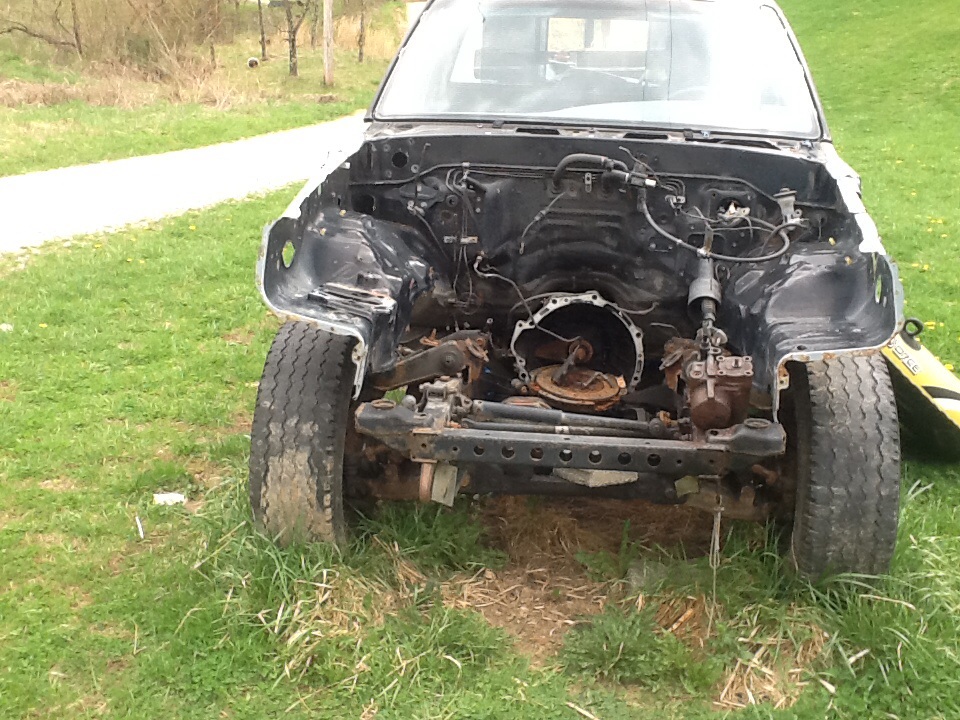

I had my first accident today
[IMG][/IMG]
I tried parallel parking here[IMG][/IMG]
When I tried turning too far, this is what happened to my parts truck
[IMG][/IMG]
Mom wasn't too mad, but dad is still yet to know. He will find out soon enough.

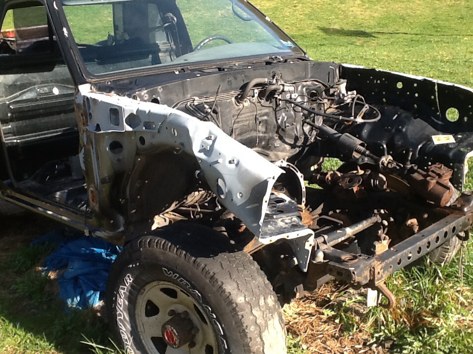

Before the accident-
After the wreck
