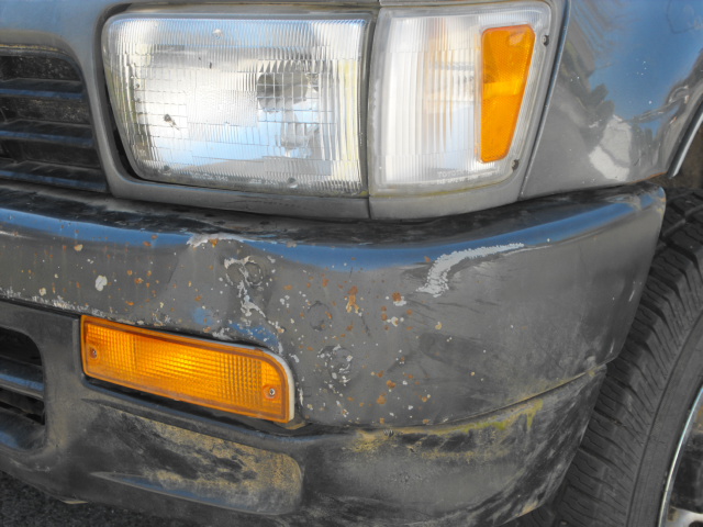

Easter Sunday - Work Day and cleaning day!
Todays task started with wanting to replace the bulb in the drivers side headlamp. To get the lamp assembly out, one must remove the grill. To get MY grill off, I needed to remove my bumper. Why? The huge crumple in the corner was preventing the lower grill lip from coming away from the front end, even a little bit. The two bolts holding the wings of the bumper/valance to the body sheared off at the nut, but the rubber bumpers still register on the broken stud. Bumper came off, my hammer and a dolly came out, and some loud noises were heard on this holiest of days. Not a perfect job, but enough for the lens and grill to go back where/how they should. Someday, I would like to replace the bumper, so this definitely works for now.
Bulb replaced, and as luck would have it, re-installation of the lens assembly revealed a broken mount within the assembly itself. It affect the direction of the lens, but I hope I fixed it enough to hold me over until a new assembly can be acquired. So long as the lens isn't bouncing around and shining into oncoming faces, I'll be happy.
Time to go to Brown Bar car wash!
Wooey!
Attached Thumbnails 1993 4runner - Documenting everything!-dscf6004.jpg   1993 4runner - Documenting everything!-dscf6005.jpg

A closer comparison...
