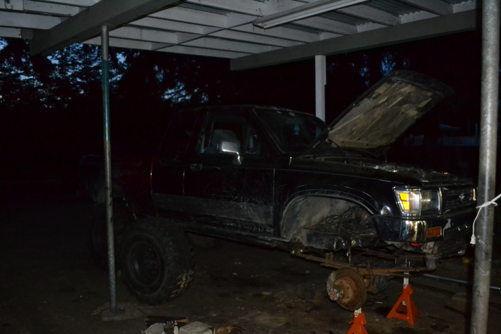

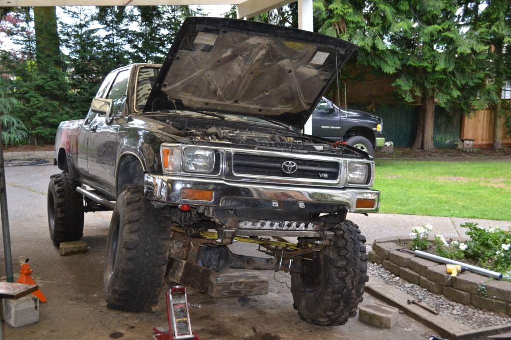

sas
progess today!
shop flooded aha

Old Jun 24, 2012 | 08:59 AM
  #112
rustED's Avatar
Joined: Sep 2010
Posts: 2,716
From: Tri-Cities, Wa
Its looking good! You made quick work out of ditching the ifs!

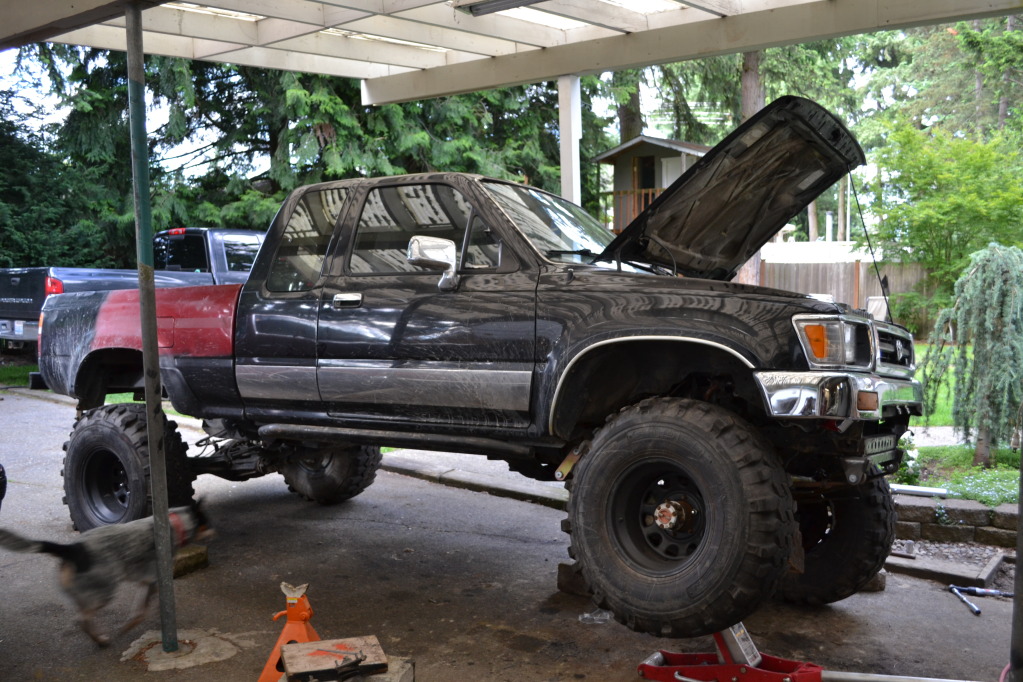

sas
got a bit done today
got the tubes welded in
with no weight on the springs the shackels were inverted like they should be so i figured they would be fine when i had weight on it. but when they weight was on it my shackel angle is to much close to 30+*(hard to see in the pictures)
a couple flex test pics
