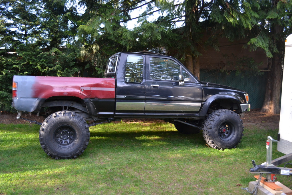

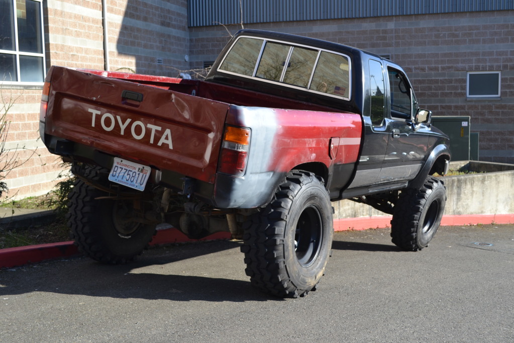

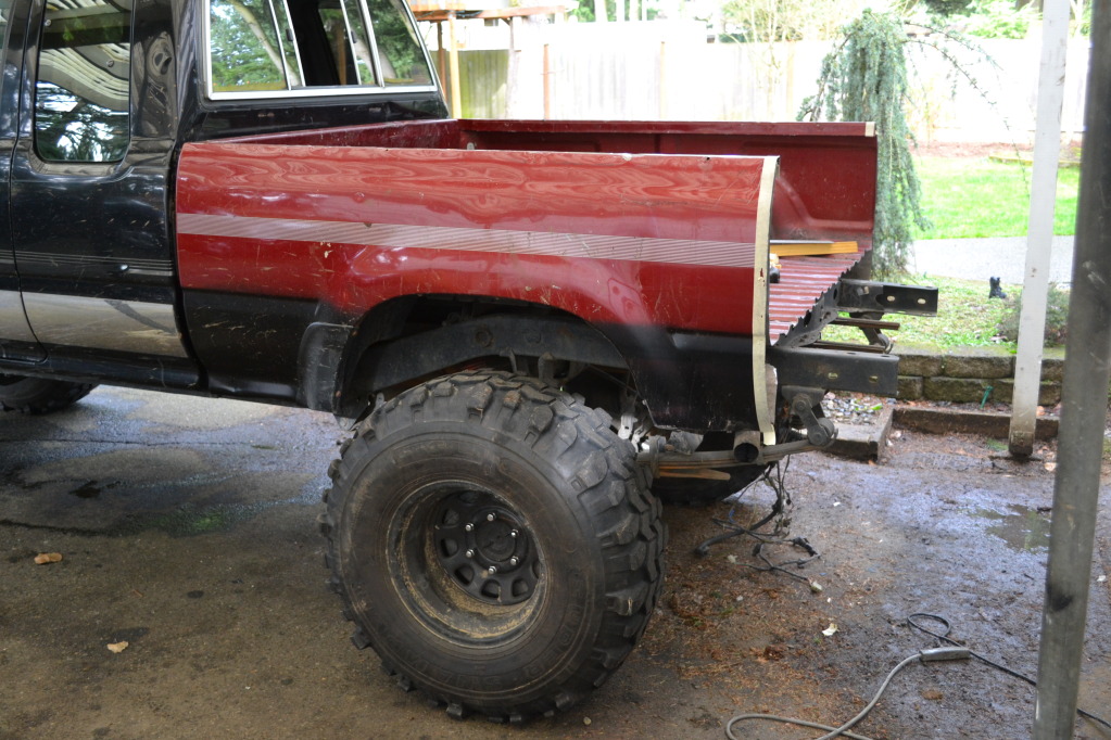

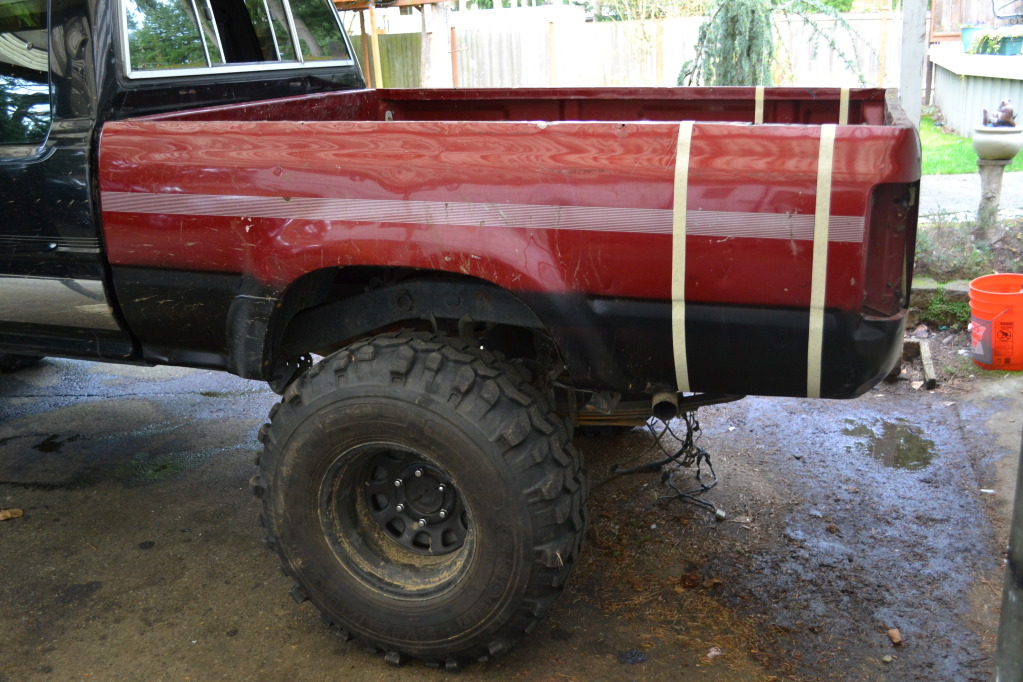

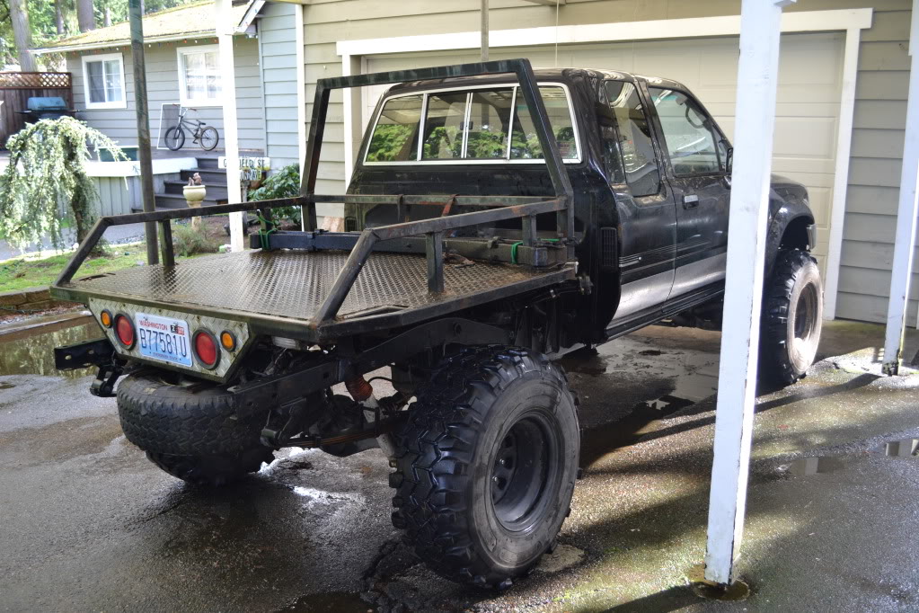

i got the truck with a flatbed and it was just kind of awkward and short so i picked up a bed that was beat up and red so it was perfect canidate for a bob. i thought 10 inches was a good amount.
with the 10inch bob my frame stuck out about 2 inches.i plan on adding some square tubing for a bumper.
as i was starting to tack the bed together my 20 year old craftsman arc welder broke down so the bed was bolted together on the top with some 1in flat steel on the top. my brother picked up a new miller welder so now the project is back underway.

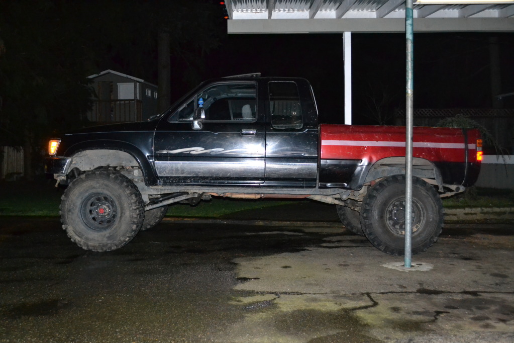

flex and bob
somewhat finished my bed bob a few days ago. still gotta paint it. also removed my sway bar and got some ifs flex aha
before swaybar was taken off
after (the one from the same angle got deleted opps but you get the point)

Yea,I was talking to RMP8080 about bobbing my bed,but was worried about my 63s sticking out.Could you post a pic of the rear where your frame sticks out so I can see what it looks like?
you can kinda see how far the frame sticks out from the flex picture of the rear but ill get a better one for you up soon

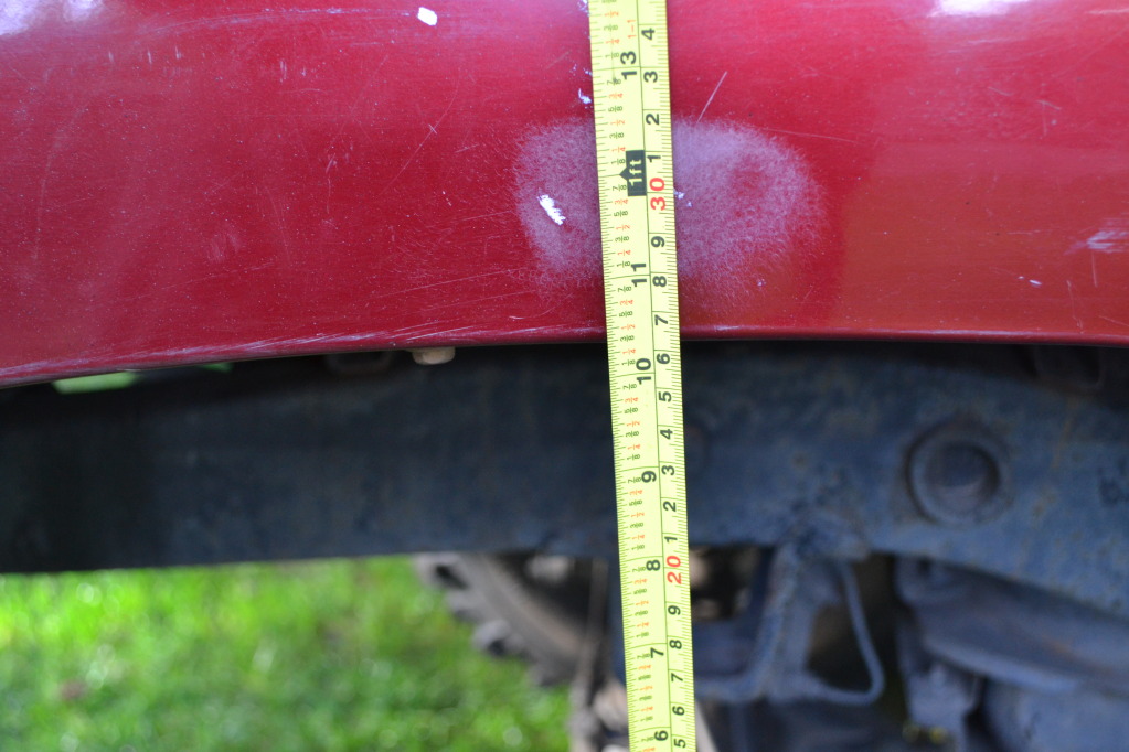

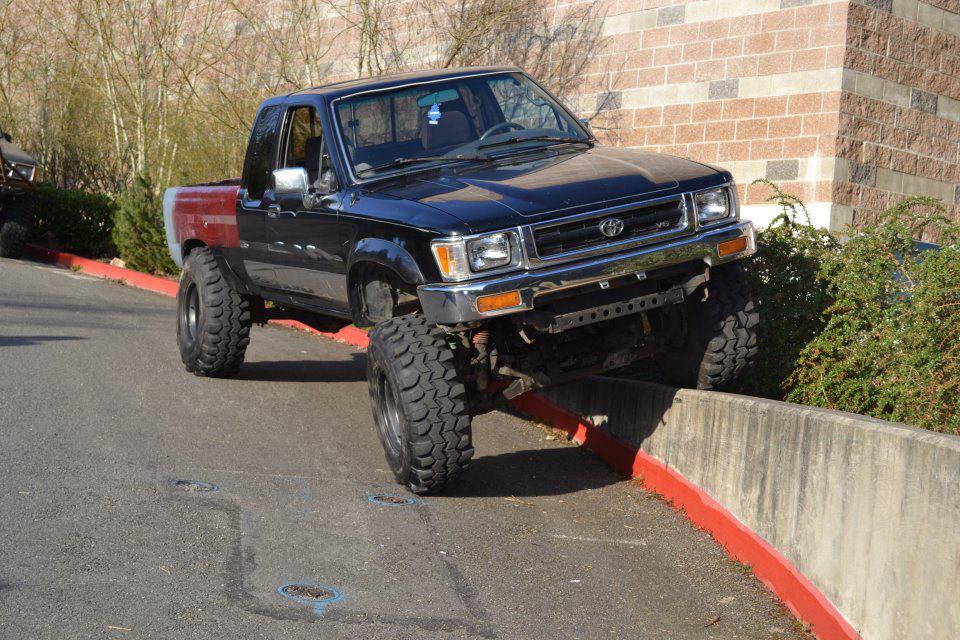

chevy leafs
got my chevys on yesterday. flexes pretty good for an ifs
[IMG]
gained about 2.5 inches of height
