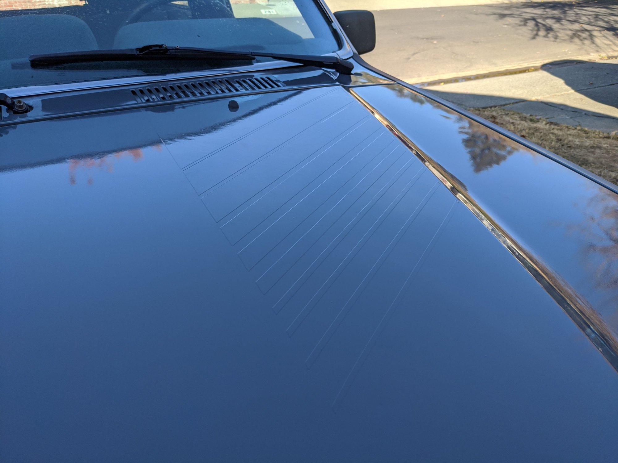

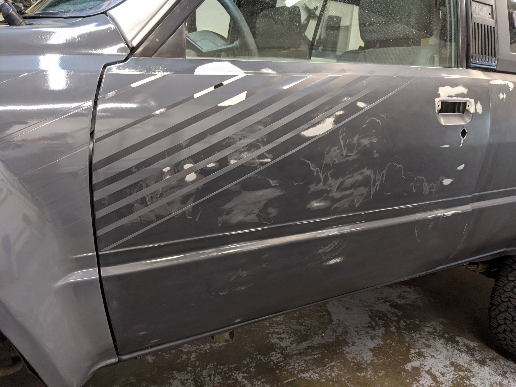

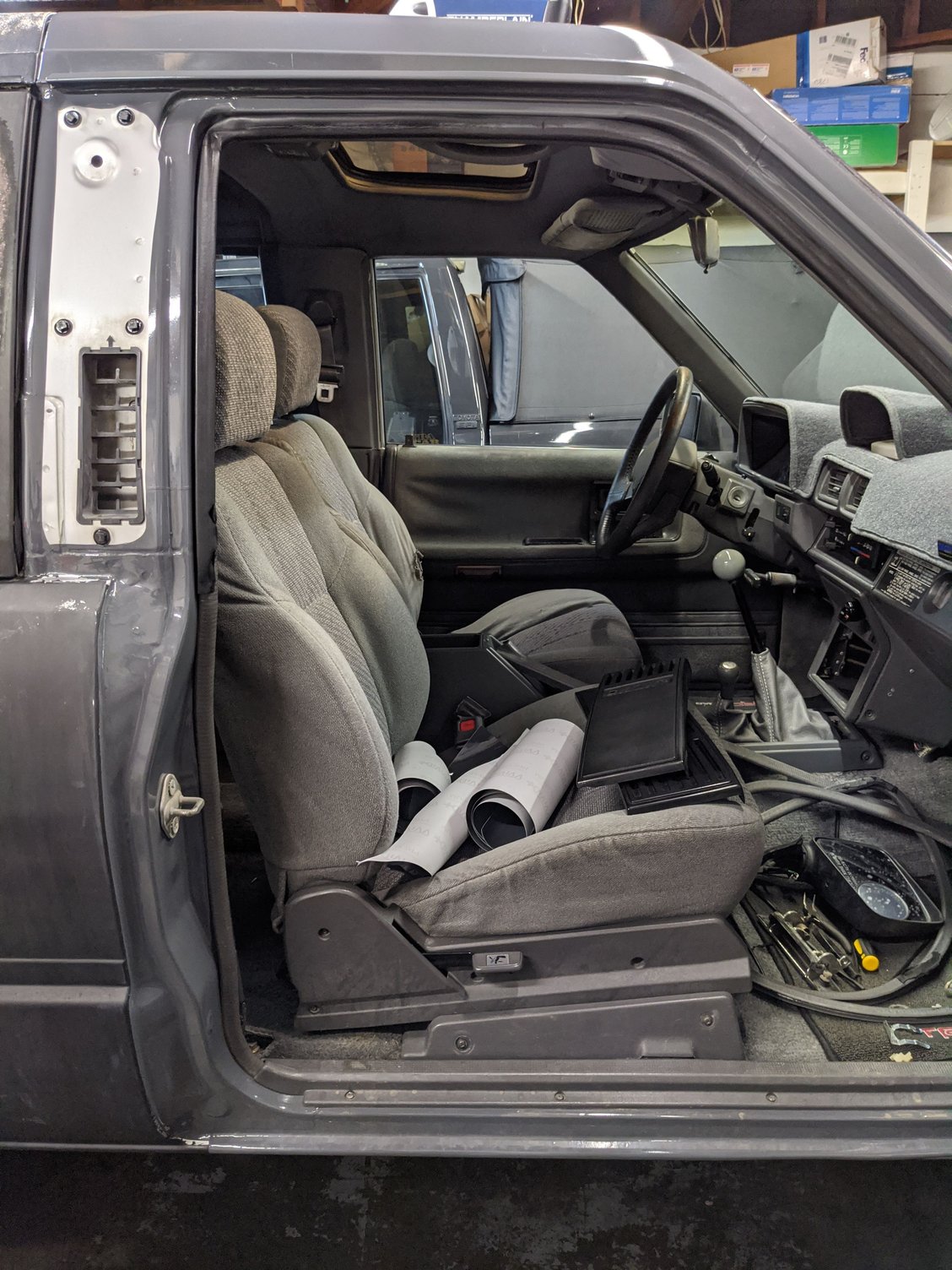

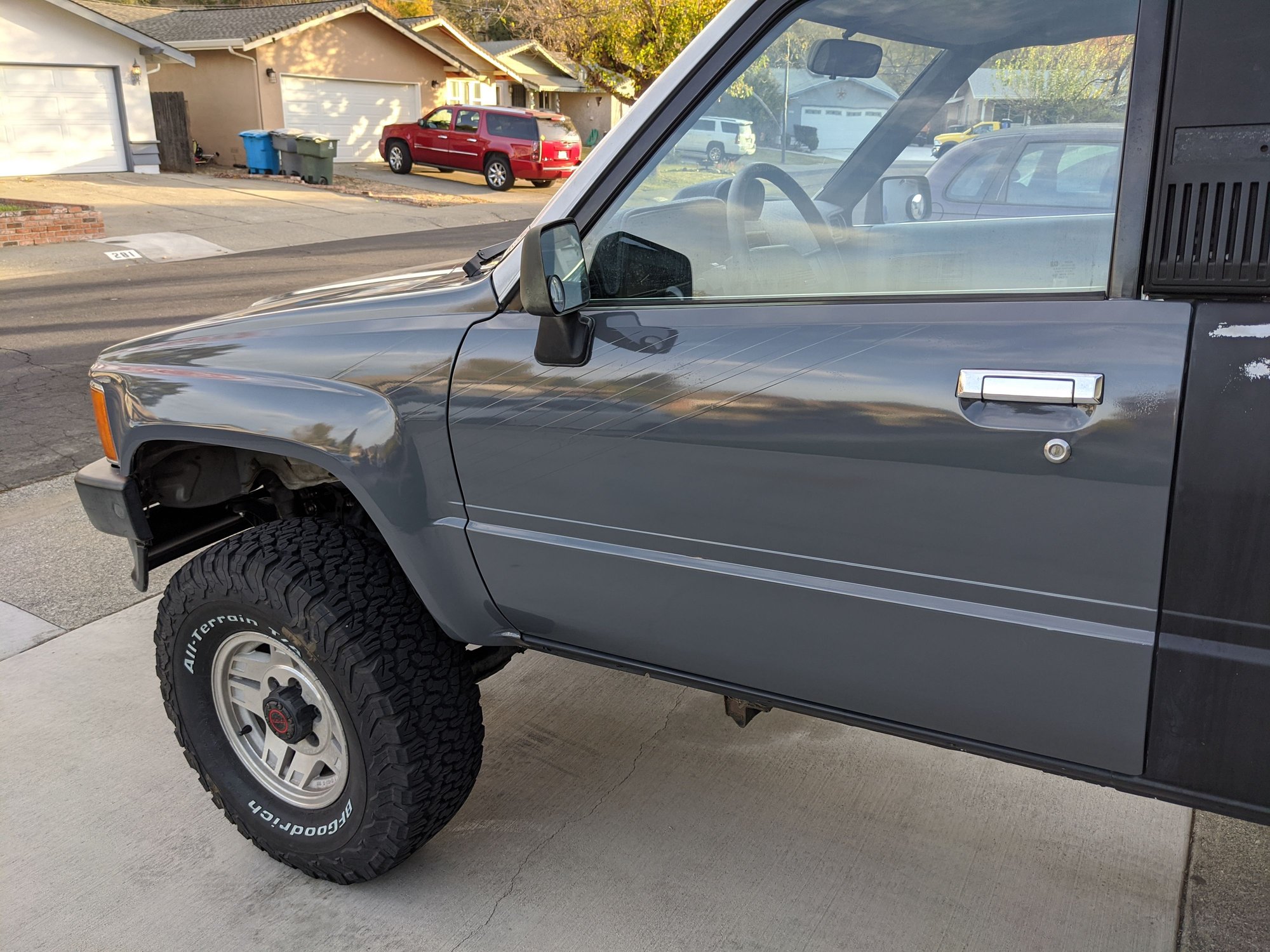

It has been a busy few months! Between moving to a new place, getting married and the holidays its been tough to find the motivation to work on the 4runner. I worked up the courage to try my hand at vinyl wrapping it, my first ever venture into this craft and it is going slowly.. I am doing one panel at a time and it is coming out OK. I didn't have super high expectations going into it because the paint job I am trying to cover up is less than ideal, and there is some bodywork that should be done that I am avoiding. All in all though, I think in the end its going to look much better than it currently sits with the rattle can flat black drip fest that had little to no care taken when being applied. How long will it hold up? Time will tell, I am not totally sure, it says 5-7 years life expectancy. Im guessing less than that in the hot sun here.
I purchased a full roll of Vvivid Gloss Slate Gray for $500. You dont need a full roll to do a vehicle but I figured since this is my first attempt there would be some screw ups, and when the time comes if I have to recover a panel from getting scratched up on the trail, that would be some easy peace of mind knowing I have spare stuff in the garage to easily fix it.
I really didnt want to have to do any body work but to get at least a half way decent result, I have been wet sanding down each panel before wrapping it. This is getting most of the dry old dead paint off and allowing me to see and get rid of the dozens of runs in the flat black paint you couldnt see before. It is truly amazing how many runs are on each panel..
I started off with the hood and cowl, easy flat pieces right? Well sort of, there is quite a bit of technique to do this stuff right. I decided to try and keep the existing sr5 stripes but instead of laying new ones on top, I used the remaining faint lines of where the stripes used to be as a guide and tediously recreated them. Once those were all laid on, I did the complete wrap on top of the new stripes to give a kind of embossed look. I think it looks ok, would be nice to have it pop a little more but Ill have to wait and see how it feels once the whole thing is done to really get an idea on it I think.
It doesnt look half bad, but up close you can see a lot of imperfections, mostly from the terrible rattle can paint job. The issue im really having is that when applying vinyl, there is a lot of repositioning, lifting the film back off, stretching a bit and applying again that you do to allow it contour to different curves. That is all fine except that this stuff is pretty tacky and grabs the paint really well, so well that its ripping patches of poorly prepped paint areas off when you try to reposition the film. This new challenge has added a an extra layer of stress while learning how to apply the vinyl. I have started to identify where the prep in the pain is extra bad and trying to sand that off more aggressively, in addition, I am applying a light coat of waterless wash/wax to some of the larger flat areas of the panel to reduce the tendency of the film to stick so much in areas that look questionable. It still sticks but doesnt like to pull up the paint as much which is helping quite a bit. They make a 'tack reducer' you can apply, which is basically what im trying to do.

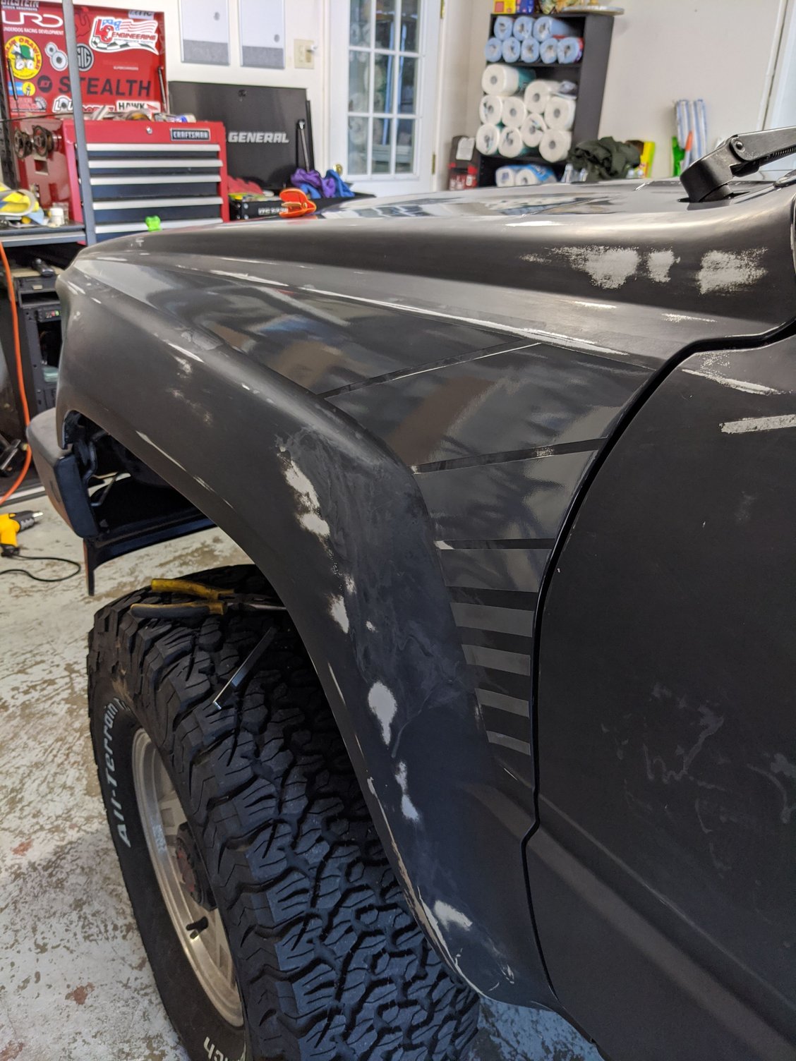

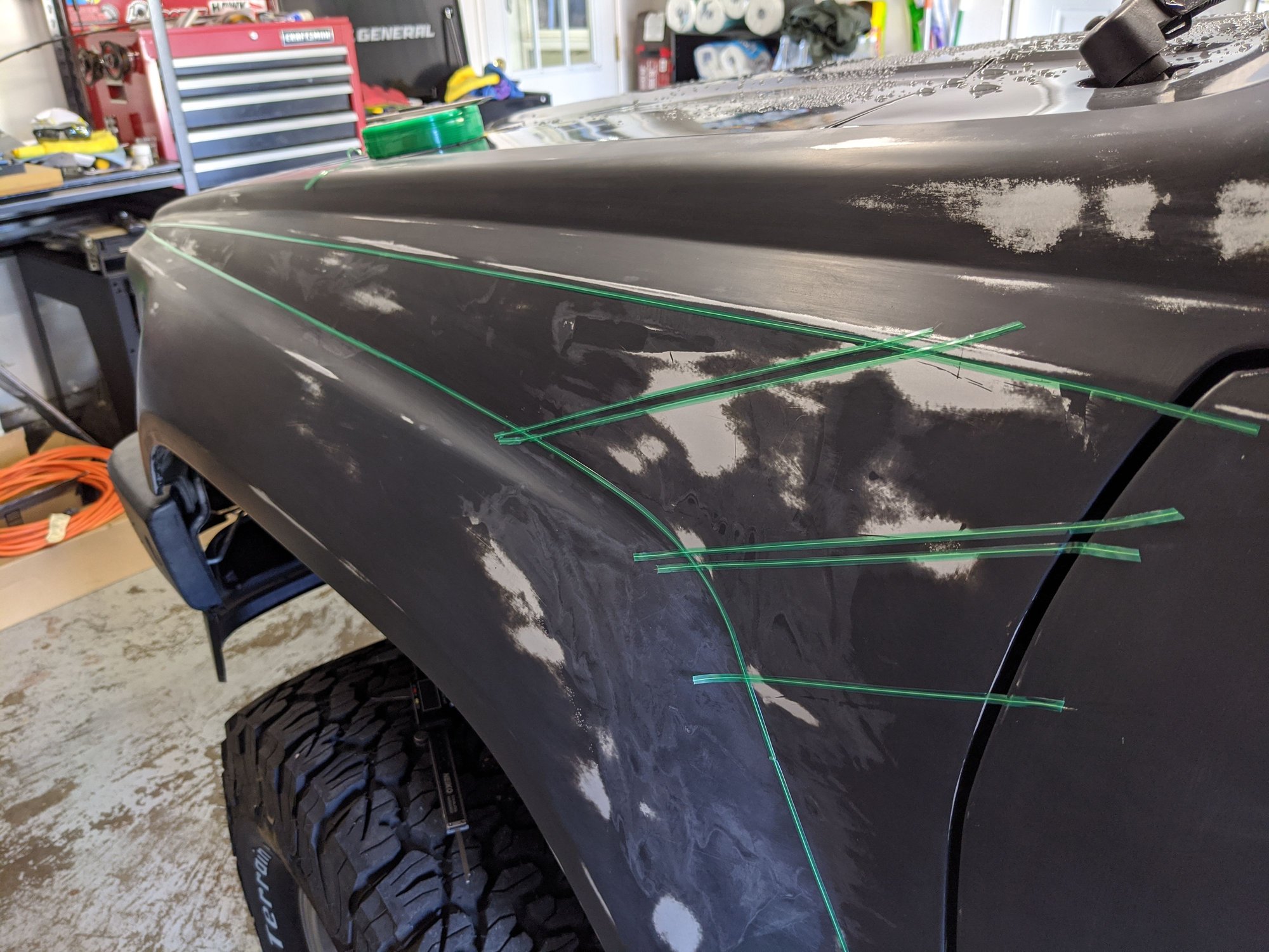

Next up is the fenders, I got a roll of 3m knifeless tape and started tracing out some of the harder to cut sections of the stripes, once the first layer of film is laid down, you pull out the very fine string in this tape and it cuts the vinyl that is laying on top of it. Pretty cool stuff. The edges are not as perfect as when you cut with a razor but you can't tell at all when the stripes lay under the top layer of film that covers the whole panel.

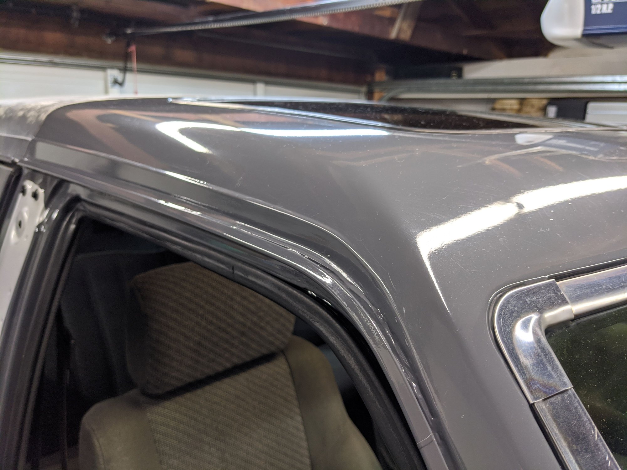

Now with some of the easier panels completed I thought it was time to finally tackle what I think is the hardest job on this truck. I searched for quite a while on some tips for this next portion, and I came up empty handed. The roof! So as you guys know we have these lovely drip sills on our trucks. They dont make vehicles like this anymore, and I dont think people wrap them either. Well I couldnt just leave them silver and I wasnt sure what the ideal process would be to wrap them, since they are very intricate in shape and would require a lot of fiddling around, tons of wrinkles probably and even more patience.
I guess pretty much right.. After pondering how to approach this section for weeks, I finally came up with a plan. I decided to wrap the whole inside of the door jamb and extend those pieces up and over the drip sill, terminating them in the top gutter of the sill. Then lay the roof wrap on top of it, so there are essentially 2 layers of wrap overlapping inside the sill gutter, that is where the seam is. Each end of the sill/gutter is a pretty fiddly to finish up, and not perfect by any means, I dont even know how you could do this better but hopefully if anyone knows, chime in! Just lots of trimming, and creating little tabs thats wrap around and under/over the other side of the sill/gutter to kind of close it up, followed by a nice application of heat gun to try and get it to stay put. It will probably fail here first..

Originally Posted by jakey poo
Looks great so far! How long is this product supposed to last?
Thanks jakey, it claims 5-7 years with a 3 year warranty. I imagine in direct sunlight outside in CA summers it will be much less, time will tell.
Old Dec 14, 2019 | 09:37 AM
  #112
cdd408's Avatar
Joined: Oct 2005
Posts: 51
From: San Jose, CA
Should of just done Macco, 599 clear coat all in one with a 3 year warranty, cheaper with a coupon
Old Dec 14, 2019 | 05:52 PM
  #113
rsmdon's Avatar
Joined: Sep 2018
Posts: 81
Likes: 15
From: Billings Mt
I was skeptical but that door and fender look pretty darn good!
