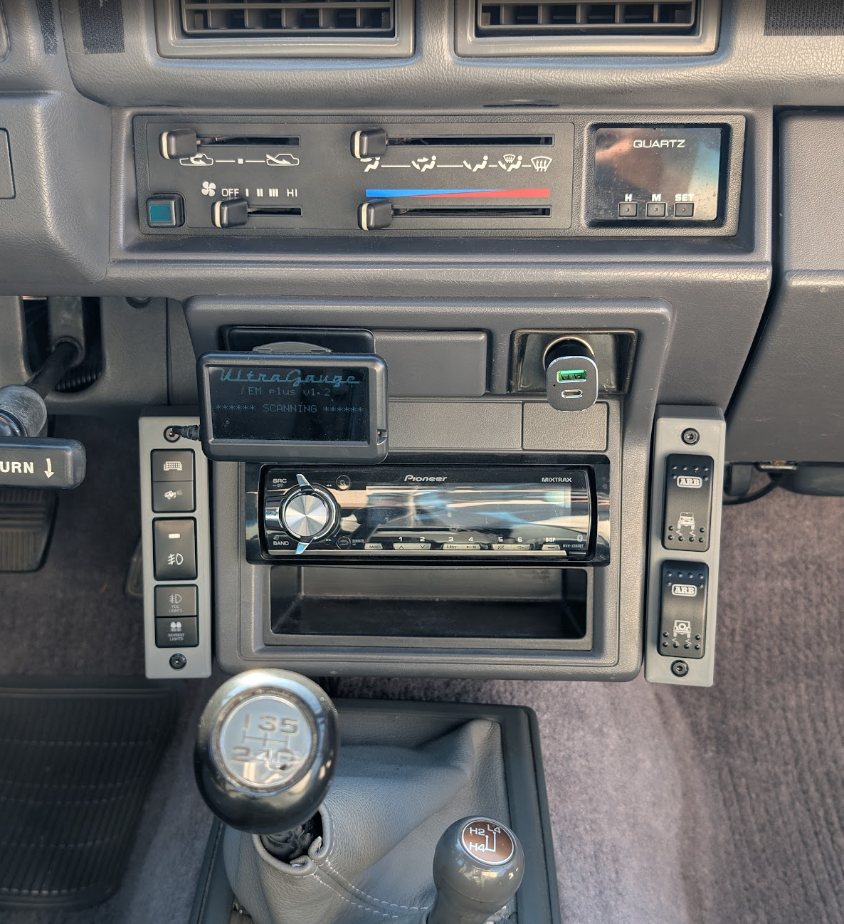

I needed to add some locker switches and lights to the 4runner, ended up designing a switch panel system that allows you to add more switches with out drilling into your dash. It uses the factory fastener locations to attach. Wanted to post it here incase anyone else was interested!
There are both driver and passenger sides available in common toyota interior colors with several options for what switches you might want to use in your build.
