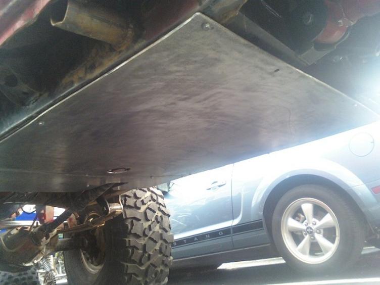

one thing that helps with the 120 inch wheel base and 26 inch frame hight is the aluminum flat belly.I am landing on that thing all the time .So many times I thought I would high centerd just to slide off.Since the pic I counter sunk all the mounting bolts.
