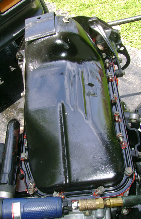

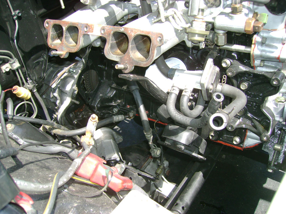

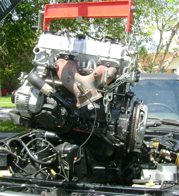

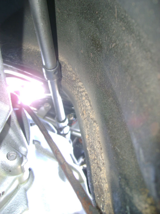

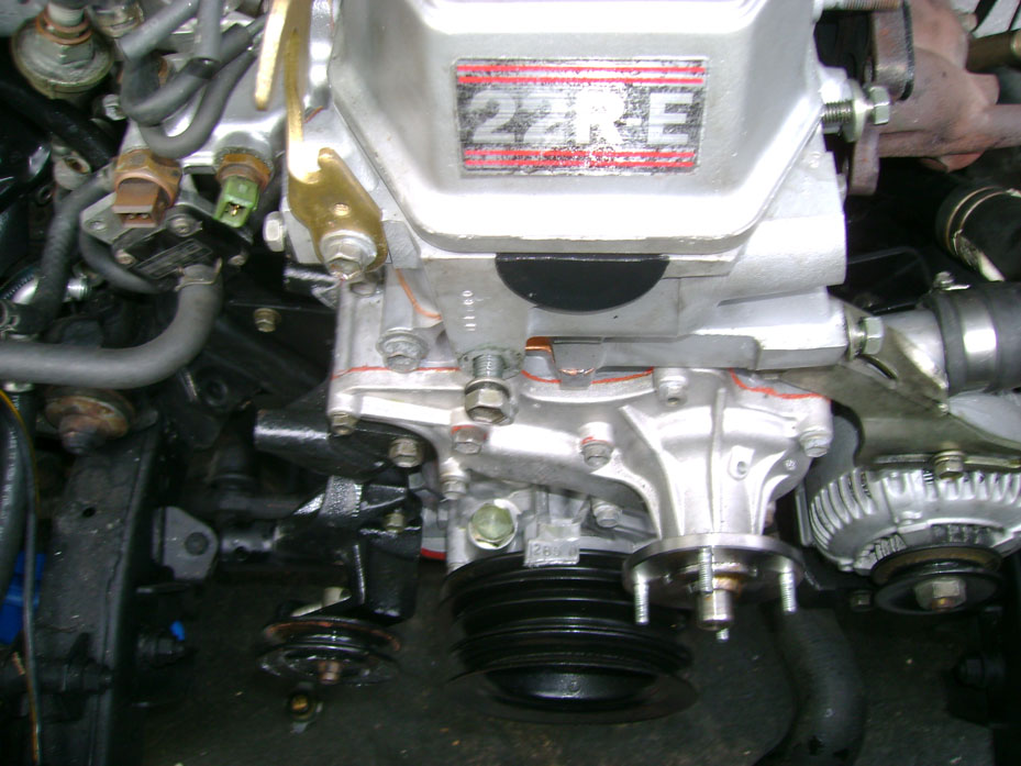

Pulled everything out of the way so I could easily pull the engine out of the bay. that was easy...
long extension to get that bolt at the top of the tranny ball.
Engine Pulled
Oil Pan ready for removal.

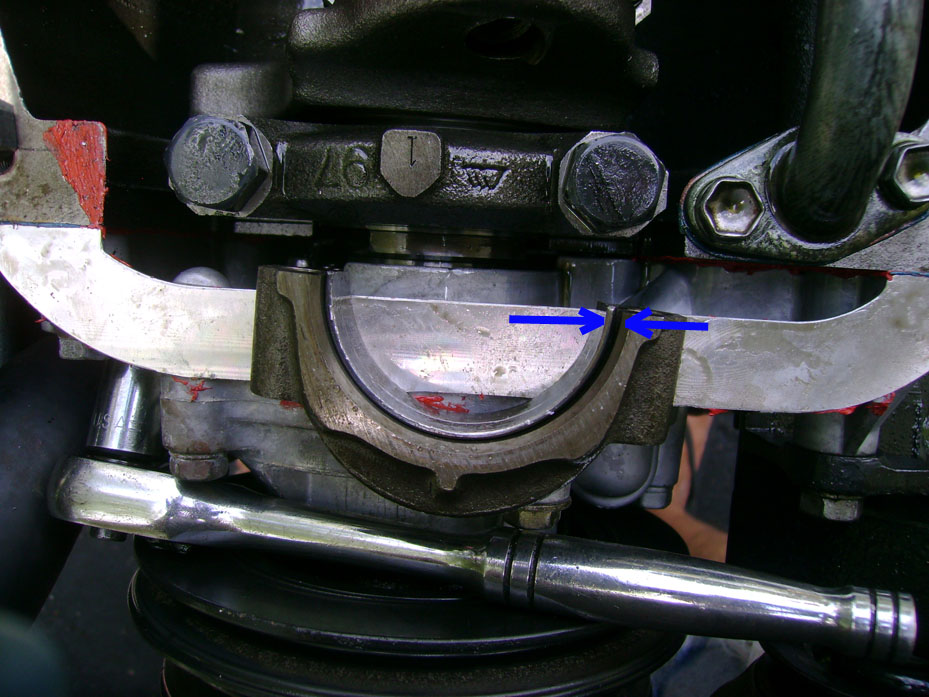

Spun Bearing
Check out the gap on this, I check to see if the rod bearing cap was badly worn down,(not by measuring, but by placing another good bearing in it to see how it fit, and it seated tight - still needs to be measured.
sadly i'm crying on this and i think both I and the machine shop are at fault for this. They did a sloppy job from the get go I think... And I for not checking it myself which would have been the correct thing to do.
