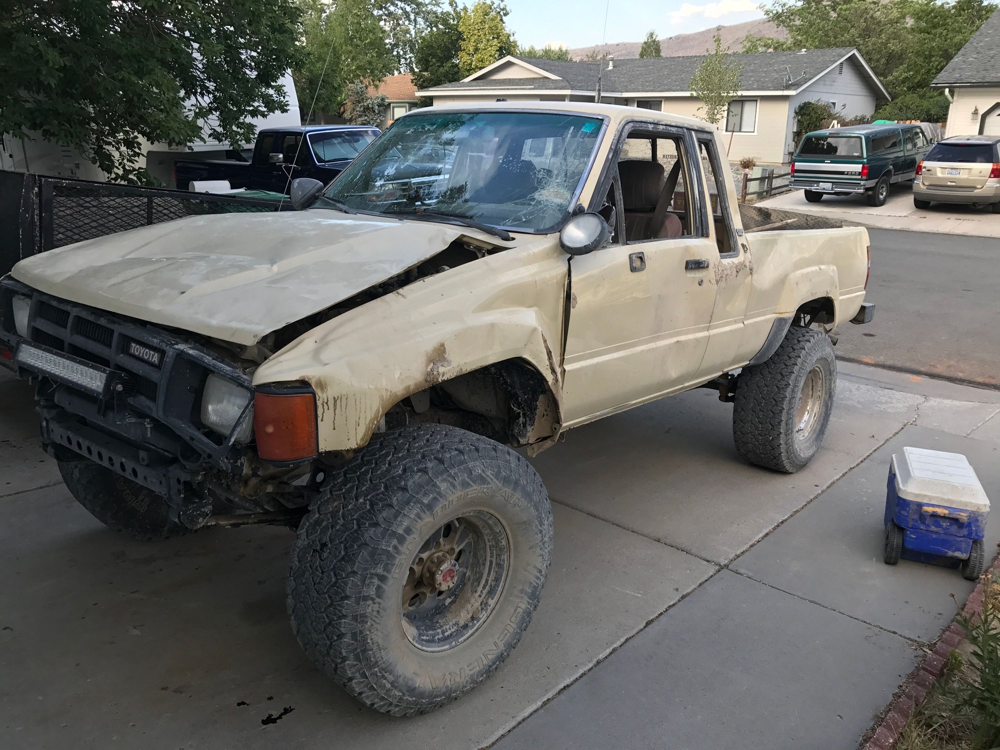

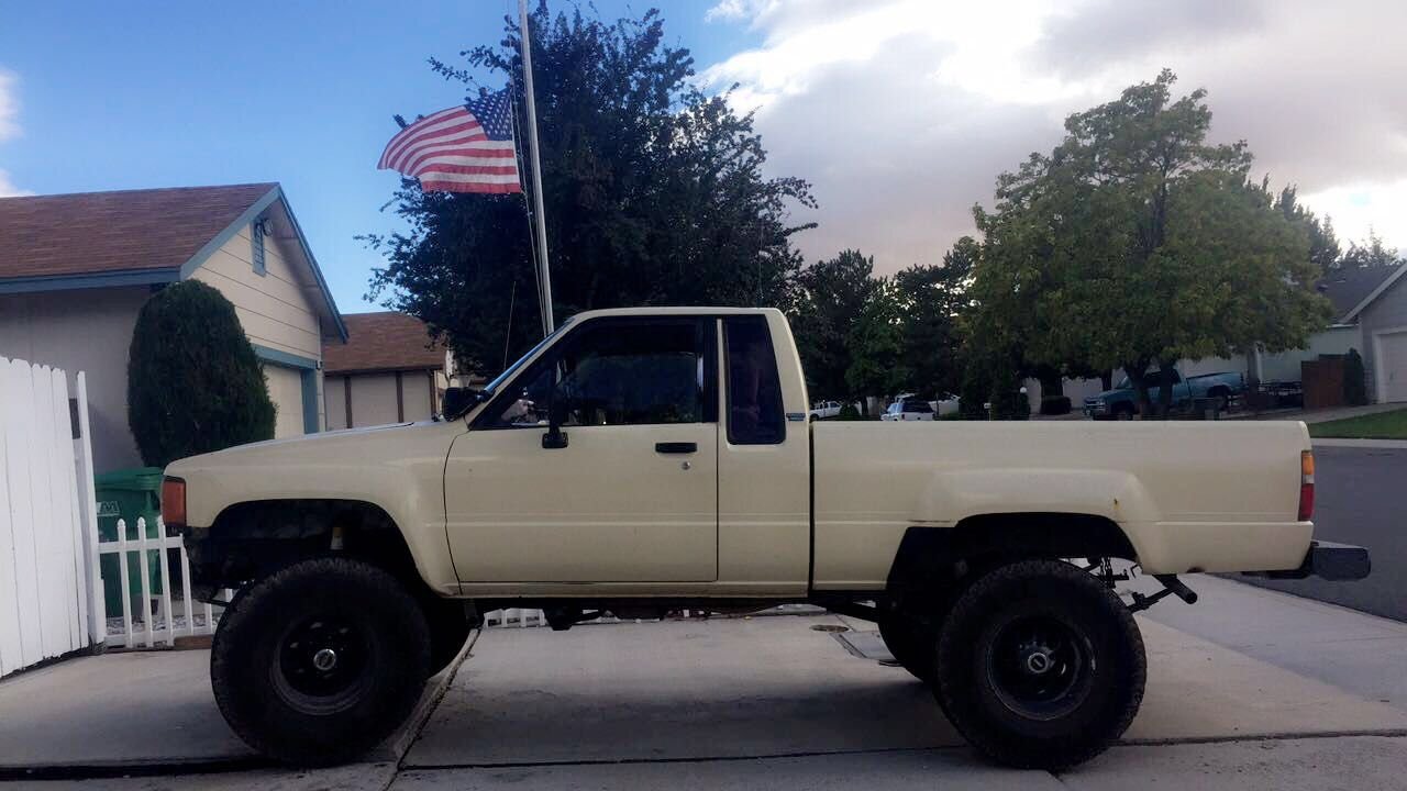

Hey all , been awhile since ive been on here as i rolled my 85 pickup a couple years ago and parted it out.
It really wasnt terrible and i probably couldve caged it and wheeled it but i was pissed because it was such a nice truck before this lol

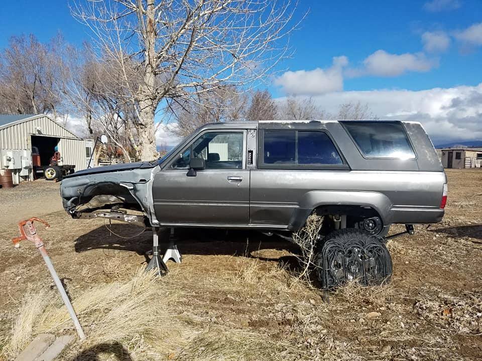

Well i finally picked up something ive always wanted, a 1st gen 4runner!
Its ugly, and rough but a decent start to a fun project and wheeler.

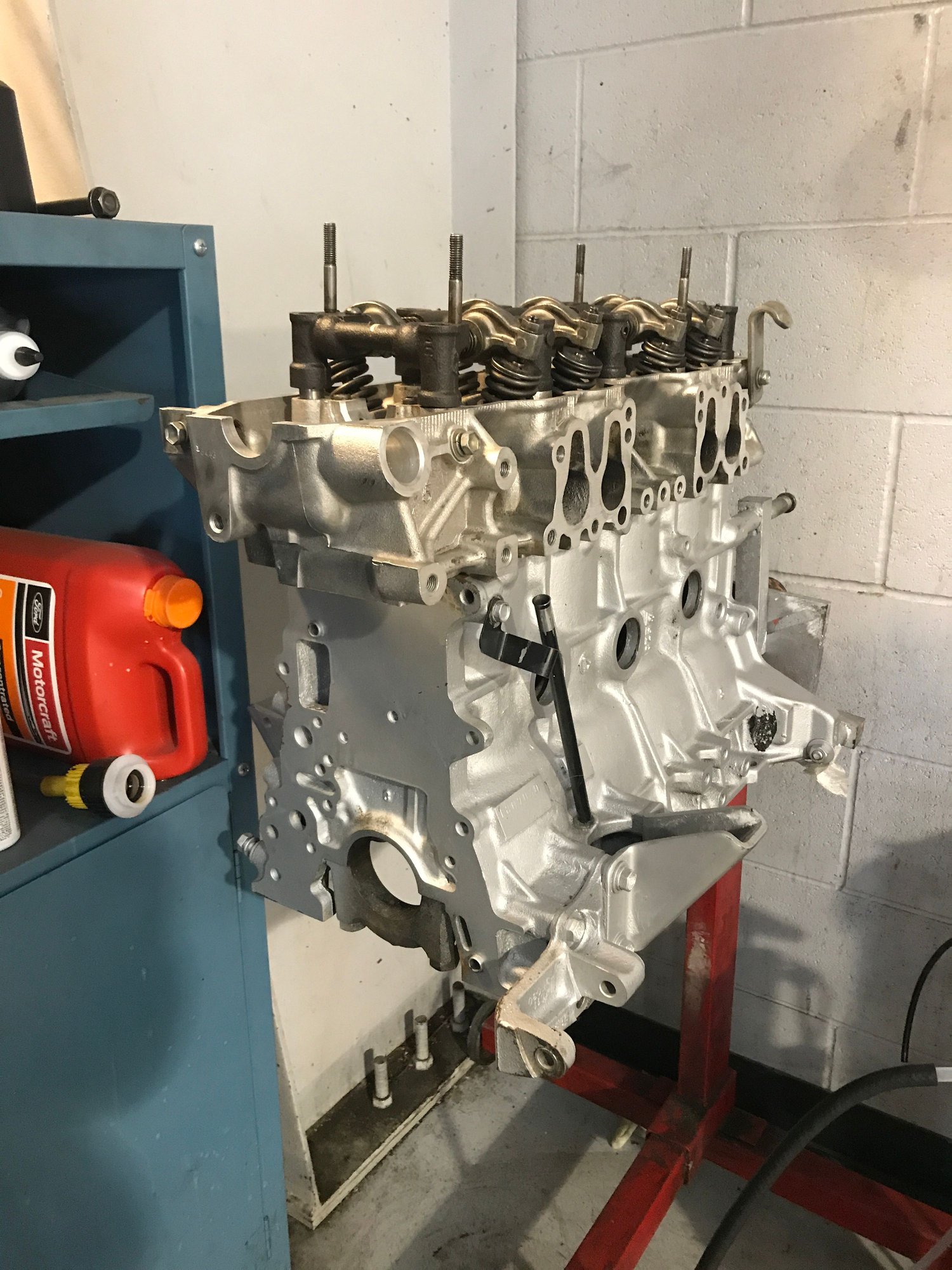

I bought it with the engine removed and torn apart. It looks as though everything has been through a machine shop though. although it looks as if the head has been slid on some sort of rough surface, so i am going to take everything to the local machine shop to be rechecked and remachined (if need be) and also get the cylinders measured so i can order the correct pistons. Also need to order a few missing parts. timing cover, new oil pump, as well as a rv cam and a header.

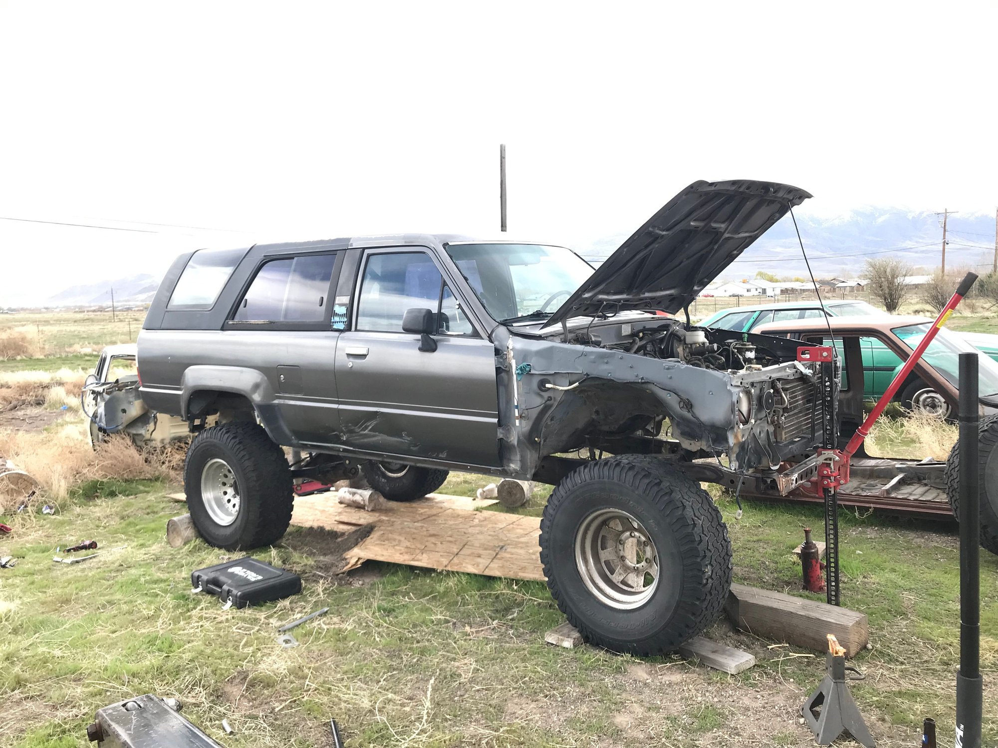

got the motor together and dropped it in, chasing a couple small coolant leaks from the front cover, hopefully i dont have to pull it back off.. the power steering system is clogged somewhere so have to figure out how to "flush it" out. fired it up sounds healthy though! and then the starter locked up.. oh the joy of working on old vehicles! so hopefully i will be driving it within the next couple weeks. had a buddy in need of some stock wheels and tires so i sold those to him and ended up slapping some 33s i had on it for now, looks funky but hopefully doing the sas soon and it wont look so funky haha

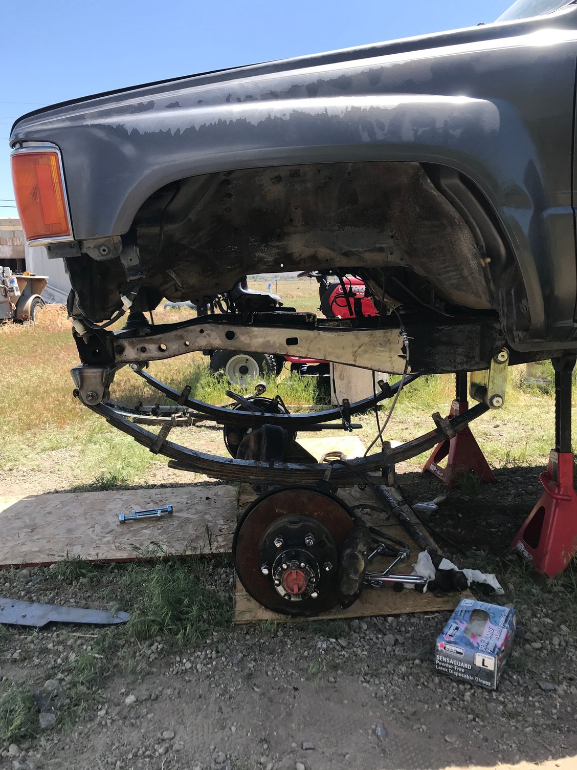

got the spring hanger tacked in, rear shackle tubes are in and we hung the axle. i used rear OME lift springs and they are definitely too much lift for the front so we are going to play around with the leafs and see if i cant get it to sit right. if not, i might have to hunt down a set of stock rear toyota leaf springs. also had wrong ubolts, so ordered a set of marlin front u bolt flip kit. probably wont get to work on this thing for a couple weeks but im excited to at least make a lil progress this weekend.

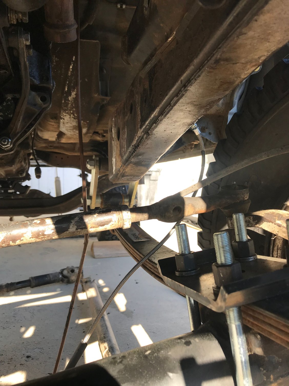

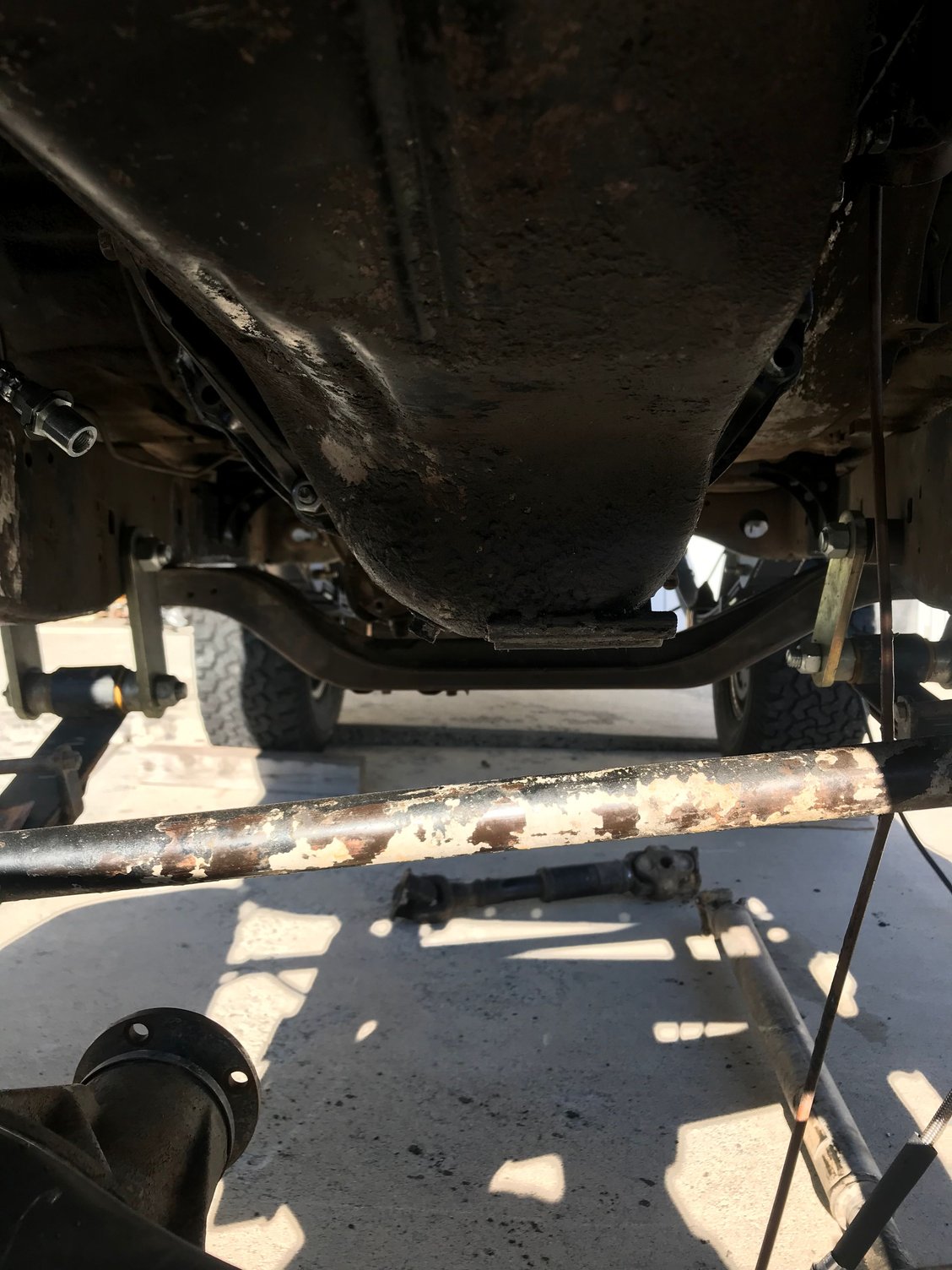

so there she is sitting on her own weight. got the tie rod in. im afraid im going to have some clearance issues when it flexes out. if i do i will just have to go with a normal high steer set up.

couple weekends ago i flexed it out to measure for shocks and such. the steering definitely limits the flex a bit but still not too shabby.

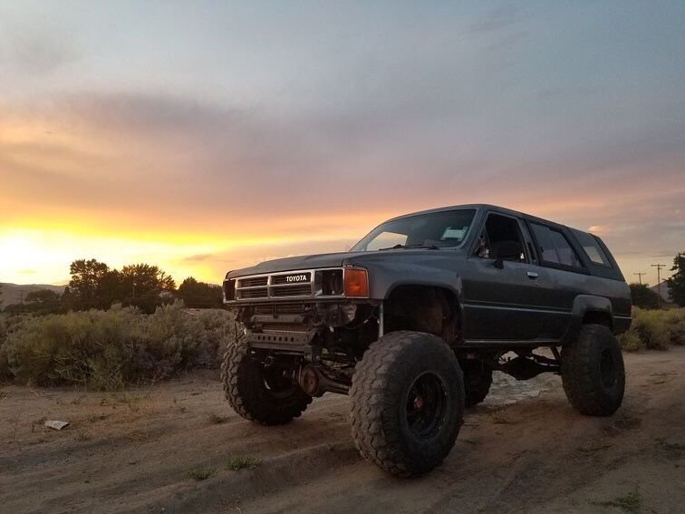

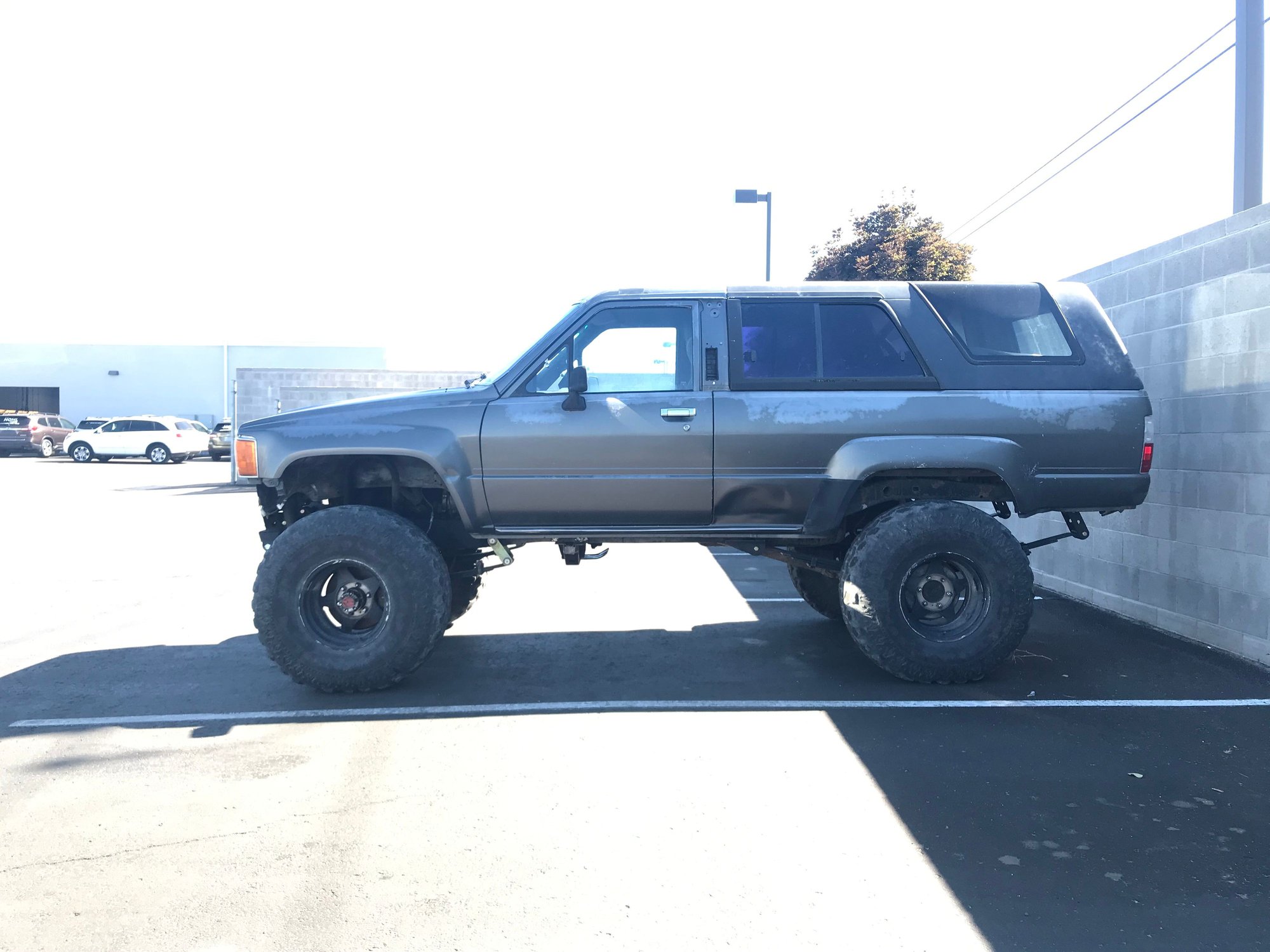

finally driving! still need to fabricate a front driveline but i took it out and flexed it a little bit. definitely need to install some bump stops. steering hits and the front shocks bottom out. pretty satisfied with the out come though! ill pick up my headlight buckets and bezels tomorrow and install my headlights
