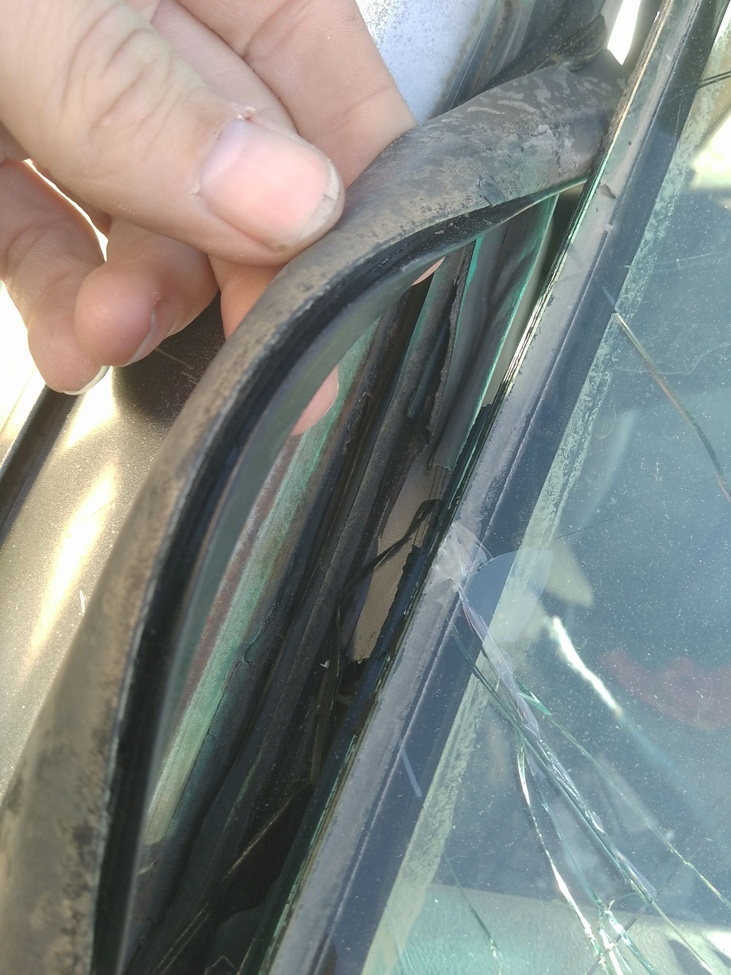

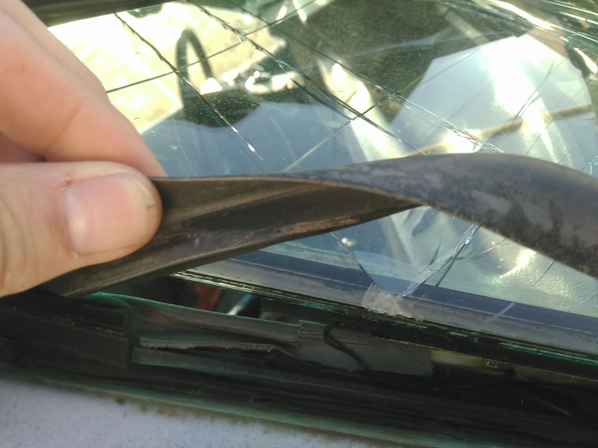

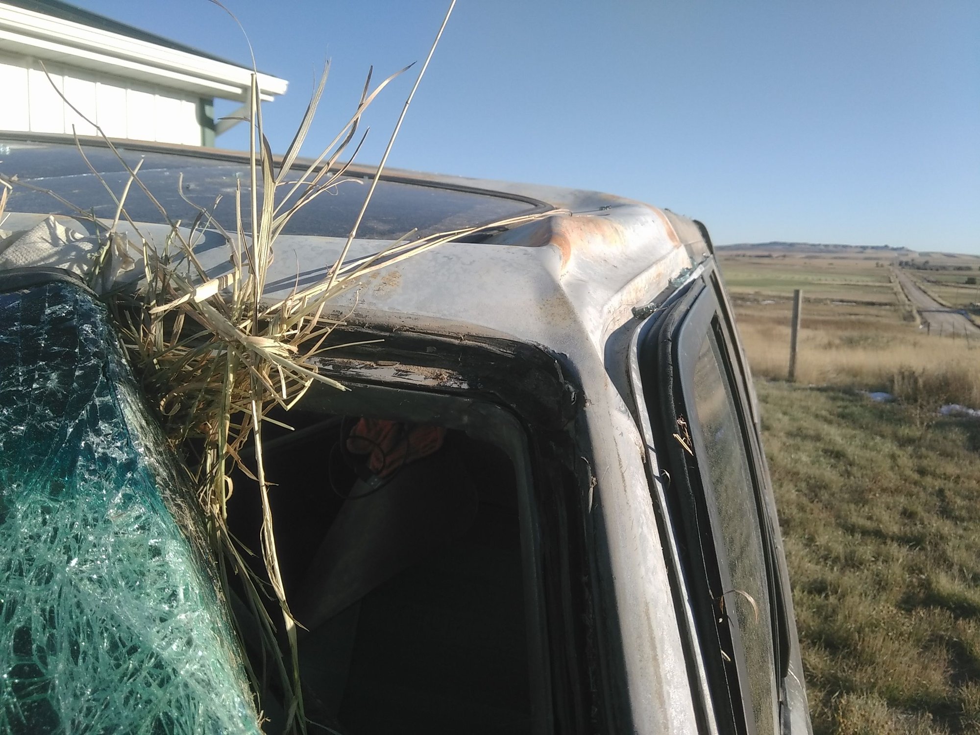

Window gasket 1
Window gasket 2
Window gasket 3 (there were some questions about my gasket in the replacing the rust maker trim thread, well there it is..)
Part of this is the cowel not being attached. Thera a big divet on the right hand side. The hood opens but has some spring to it.

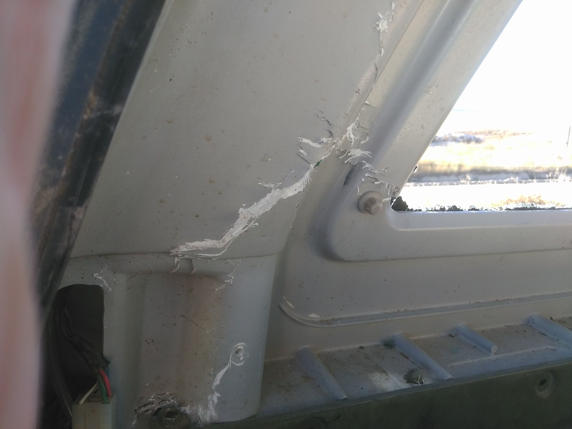

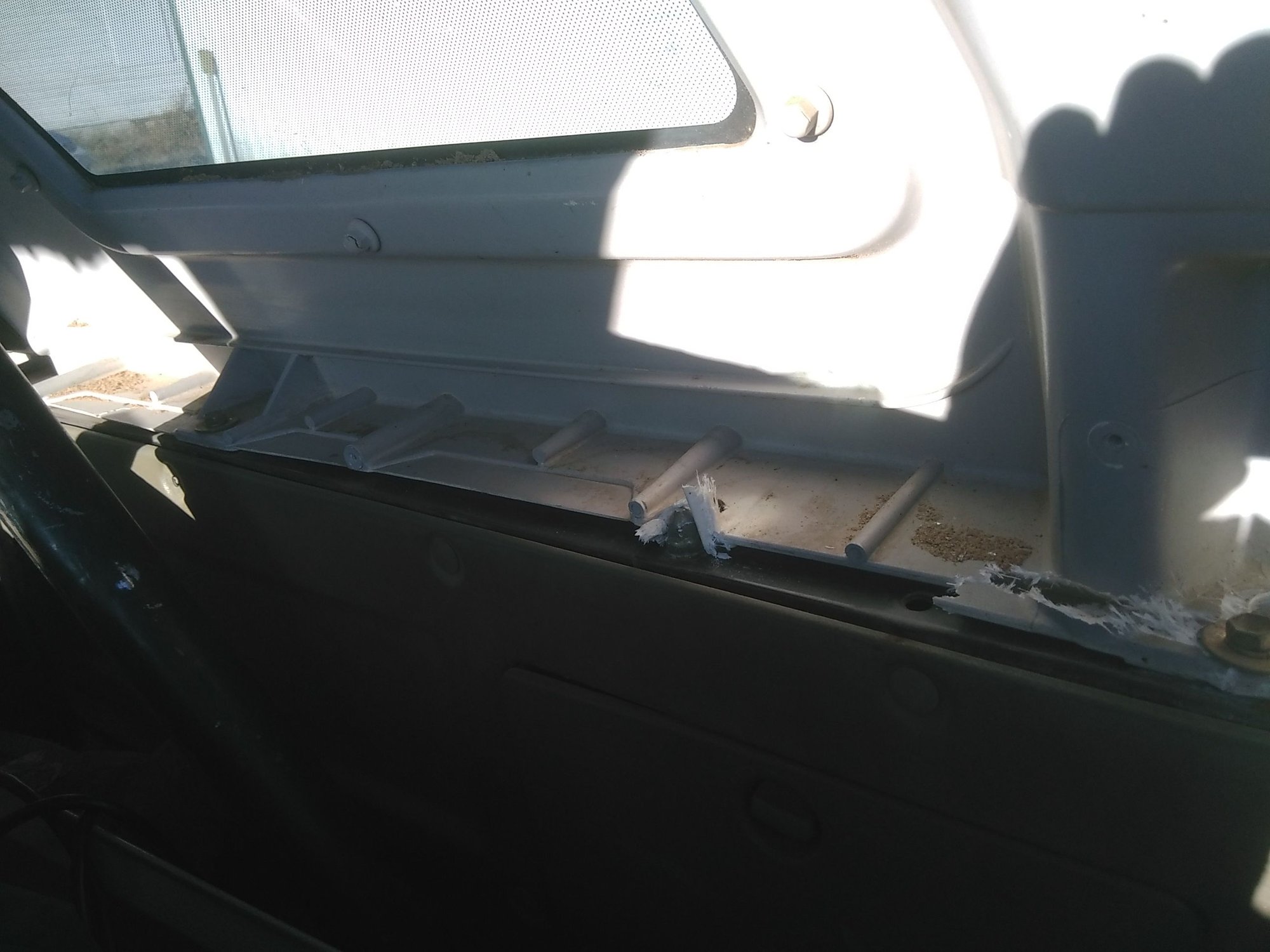

Inner left hand side of the shell
Inner right hand side of the shell
Right side , bit gap
Left side no gap
Looks like the cab is tweaked maybe. Door pops open when the latch is released.
Exploded driver side outside of topper.

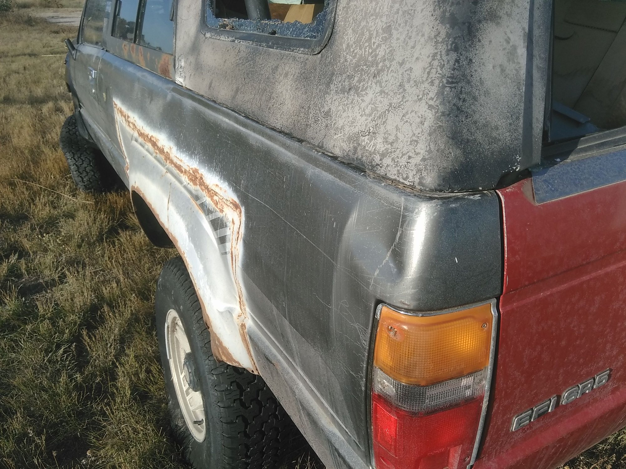

Dent above indicators is new, some.of the ripple in the quarter was alwaya there but there is probably some new ones. (It was a really bad patch panel which i thibk ive mentiones before, loads of mig wire cut off on the inside of that patch. They tryed really hard not to warp it.)

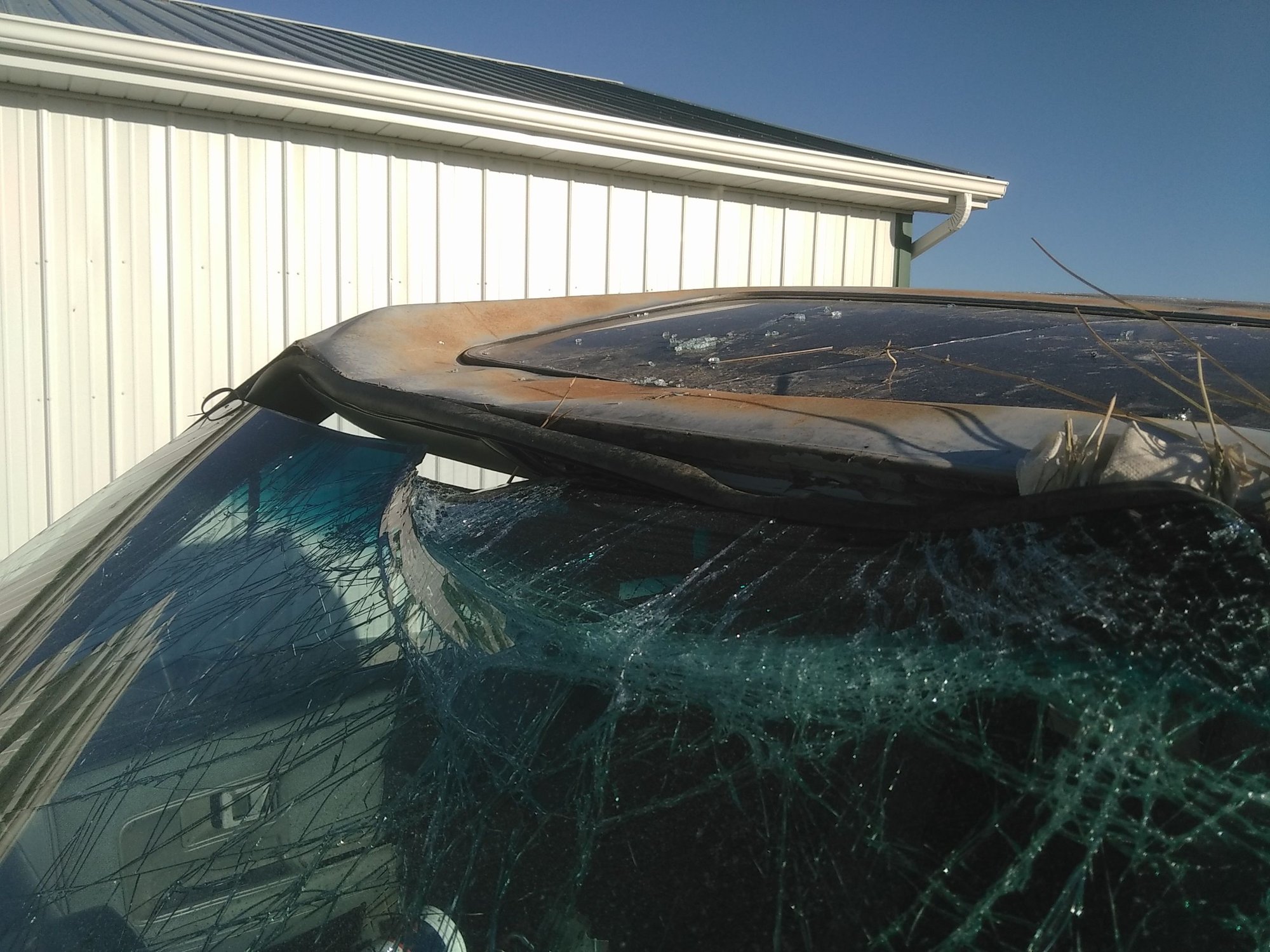

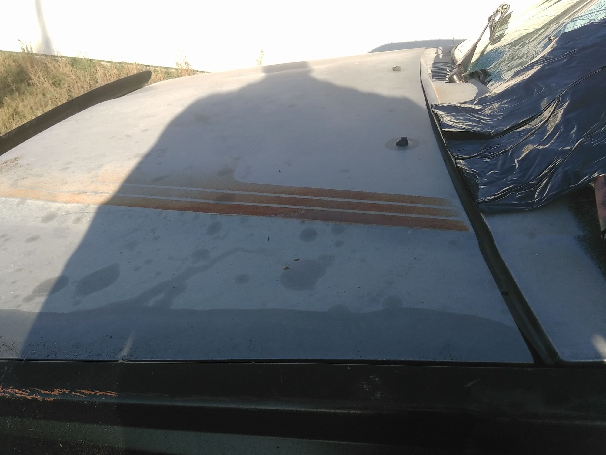

The traumatized roof. Its multiple layers here. Fixing it means cutting the panel out at the spot welds and massaging it back into shape (Like i did the 94's quarter panel) while trying not to stretch it out with the hammer and dolly.

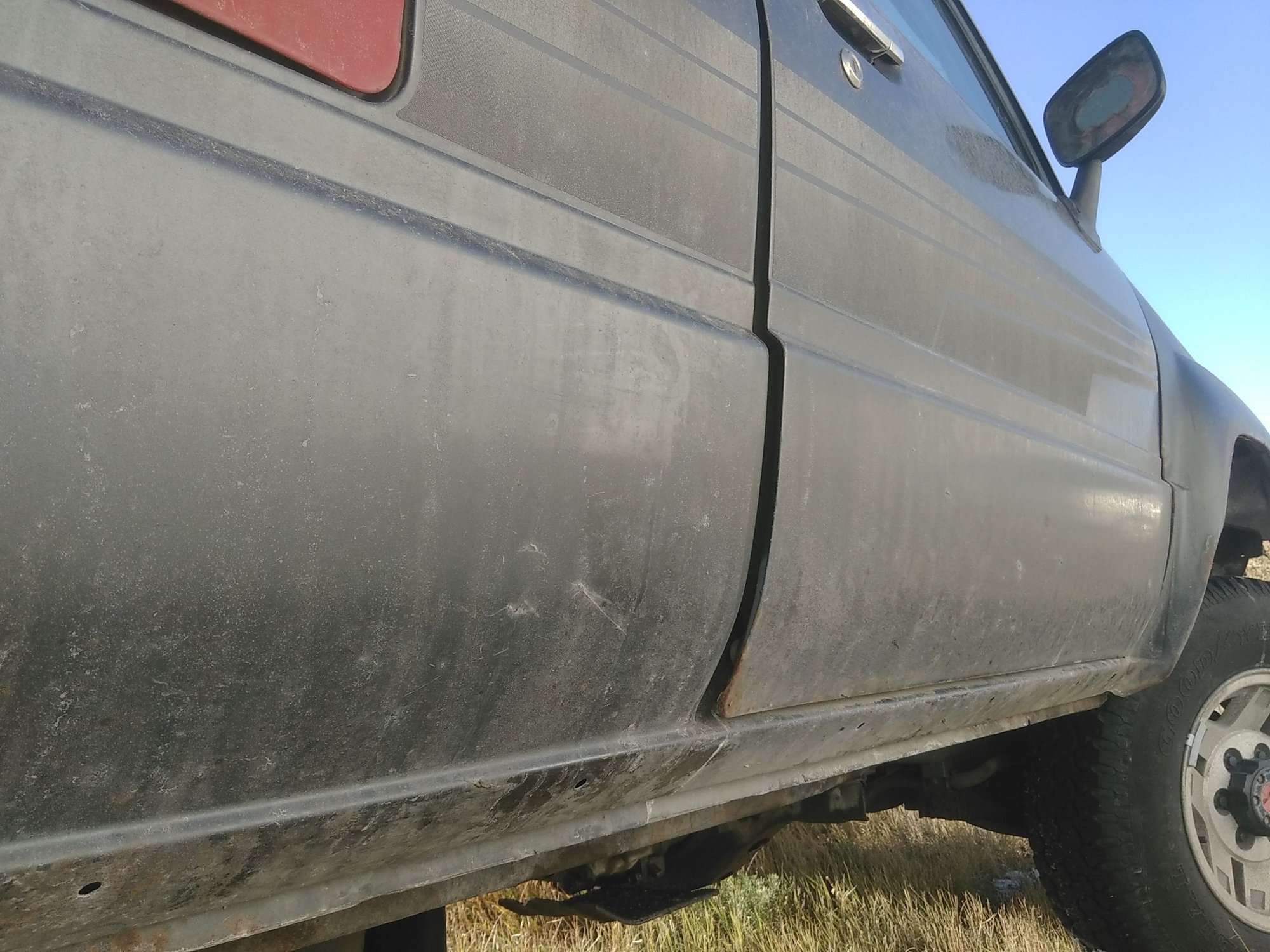

Got some indent on the side also. Dont know if thats from the accident or the recovery, it was pulled sideways quit a bit to get out of the gully.

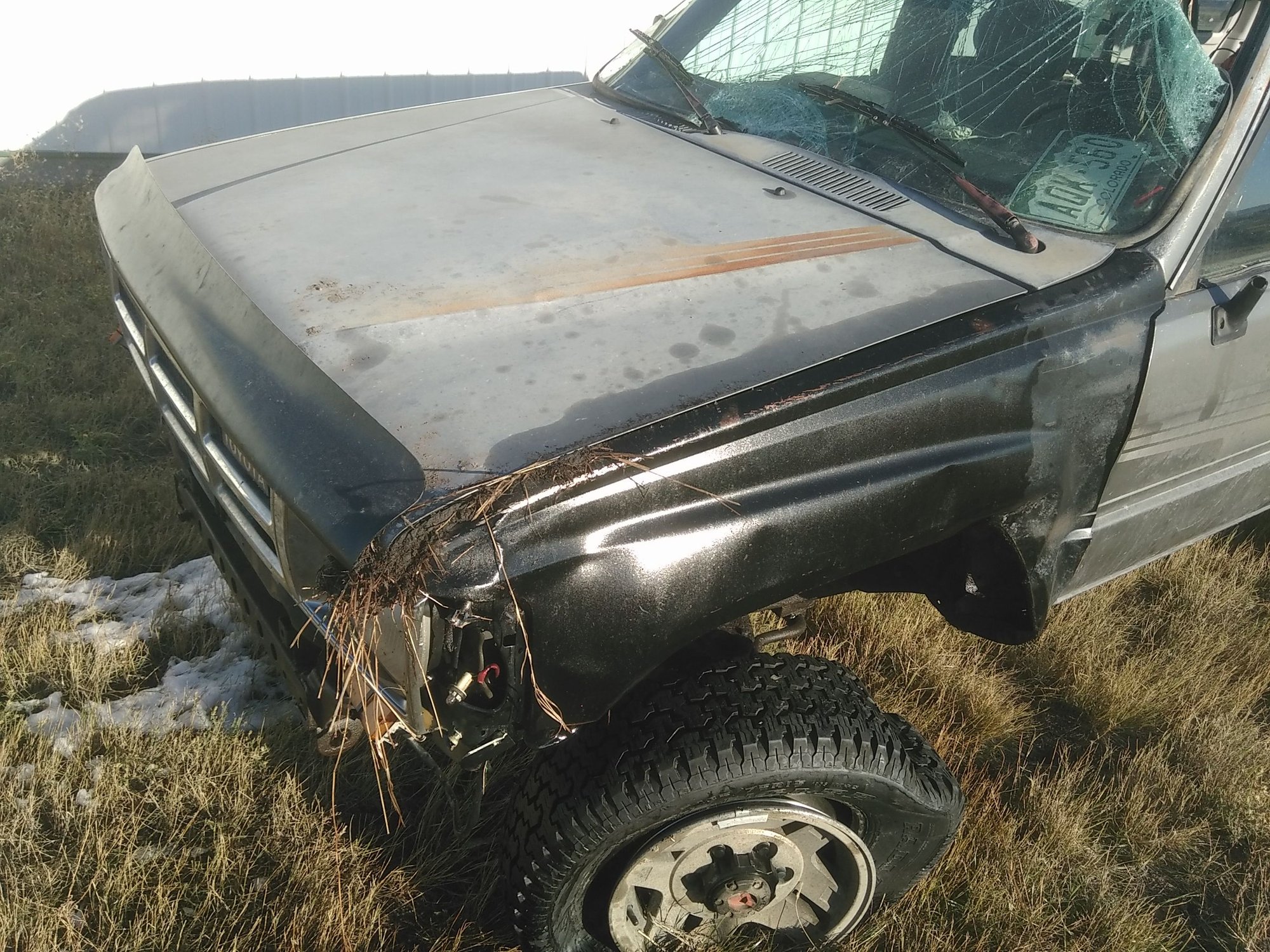

The tire dislodged during recovery im pretty sure it was still "round" while upside down. Fender mangled but not ripped.

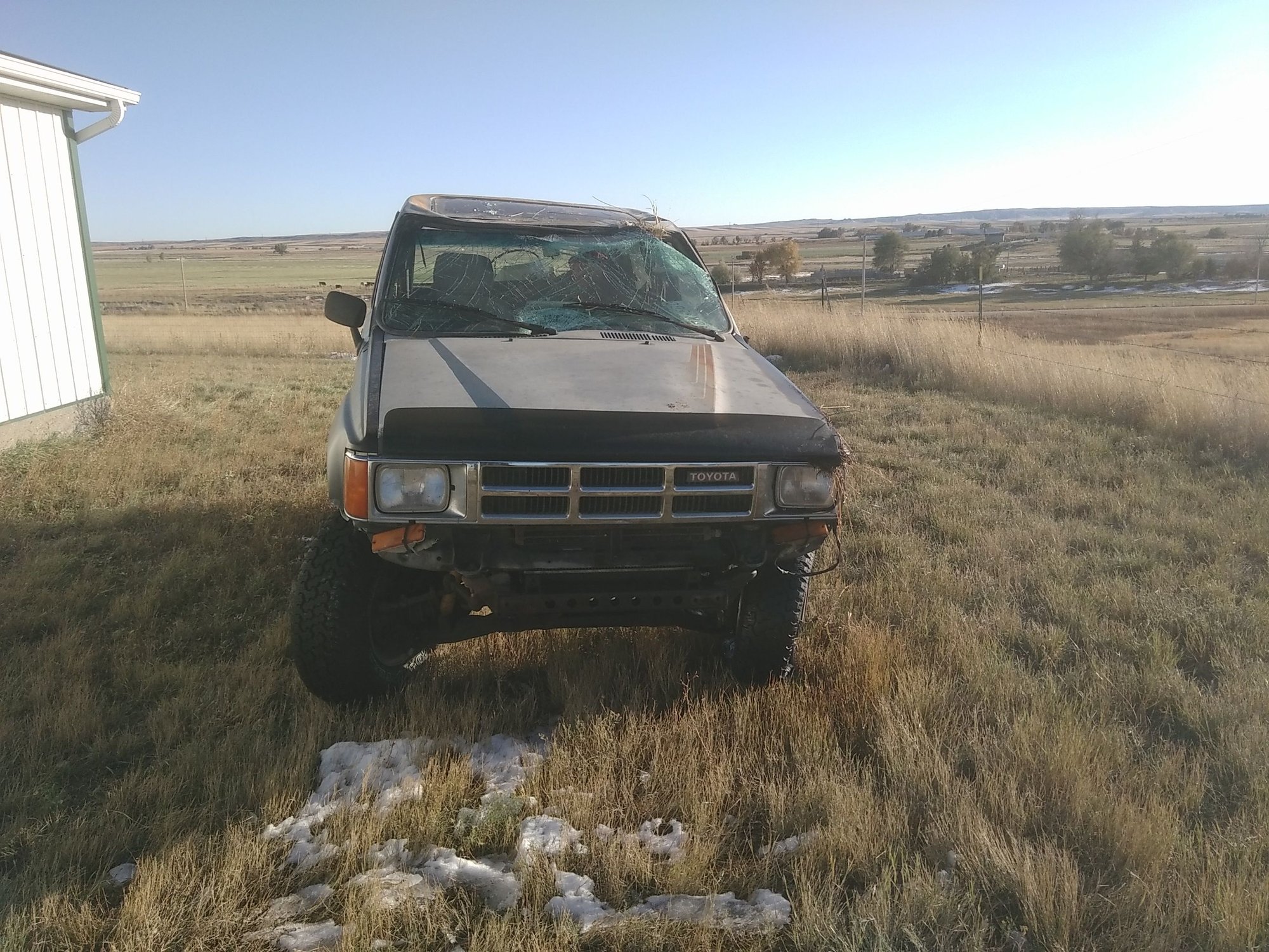

First look at it in clear daylight.

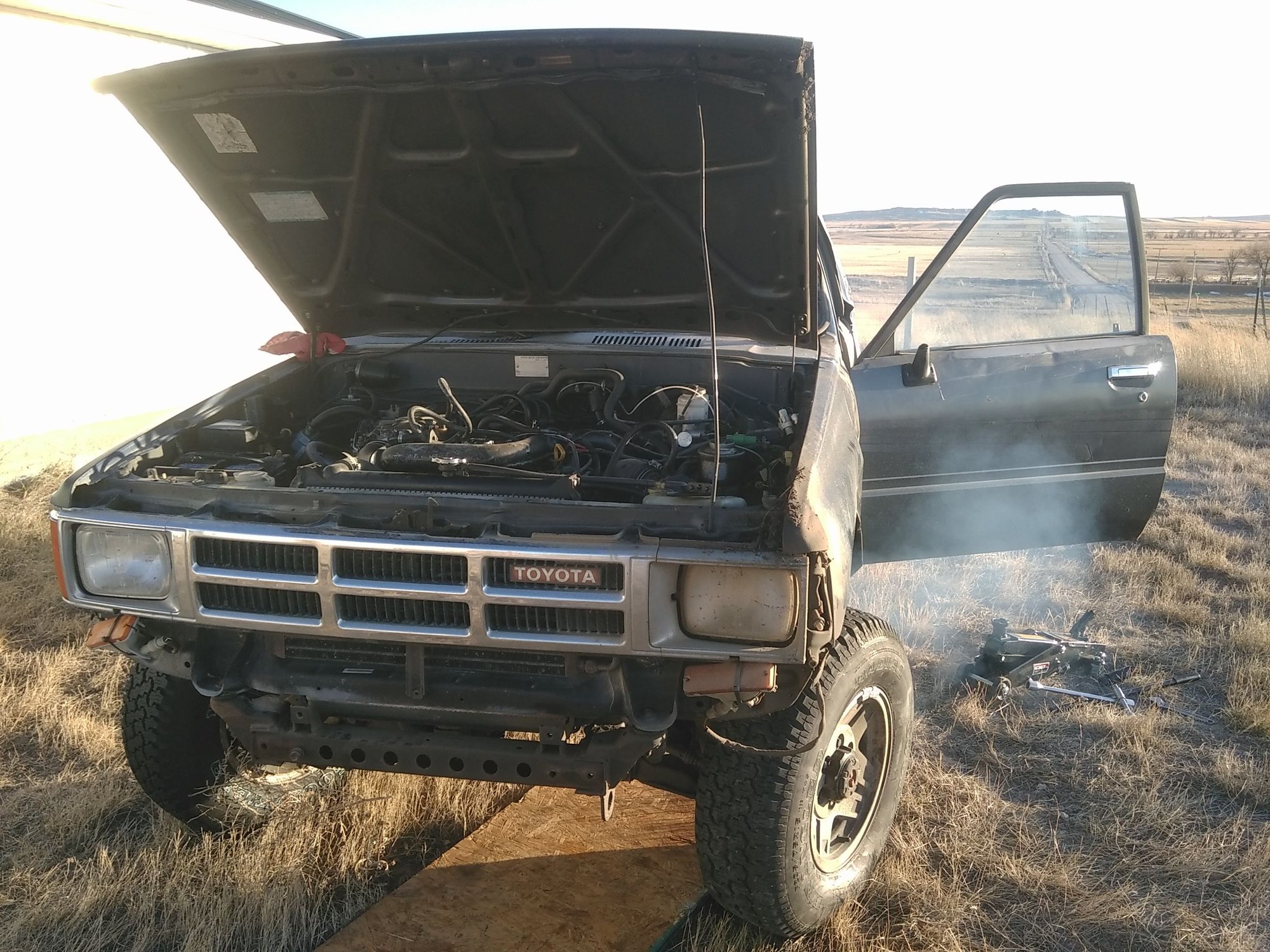

You can probably spot the grungy headlight? That whole fender inside and out, as well as the frame and suspension bits, are just buried in "oil" which has grabbed onto all the dust it could find..
I was really kind of concerned with how much "oil" the turbo pumped out while it was on its side and upside down..
Well turns out that's actually all my transmission fluid that ran out the dipstick tube and not "oil". This was very apparent after putting it into gear to pull it into the garage and not going anywhere. Pulling the dipstick confirmed "yep you need some ATF sir!" Never having had to add any to it I didn't have even a single quart on hand and had to drive an hour to town to get some.
Got it pulled over next to the dumpster where I cut out the few bits of urethane holding the windshield reminents in and tossed it into the dumpster.
Pulled the screws out of the cowl and removed it and the wiper arms so the hood will quit rubbing.
Will take a few minutes to get the hood back in shape, but the cowl got a good bend or two due to the windshield shoving it down/forward.

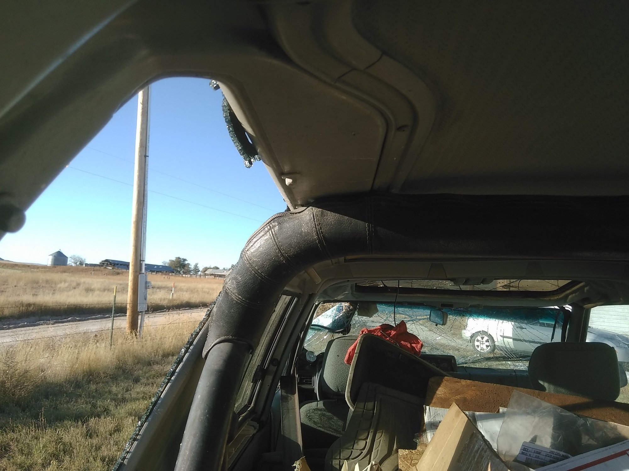

The upper cab has a good bit of a bend to it. Topside of the drivers door has a maybe one inch gap, and the passenger side has a similar gap at the bottom (and springs open due to it..)

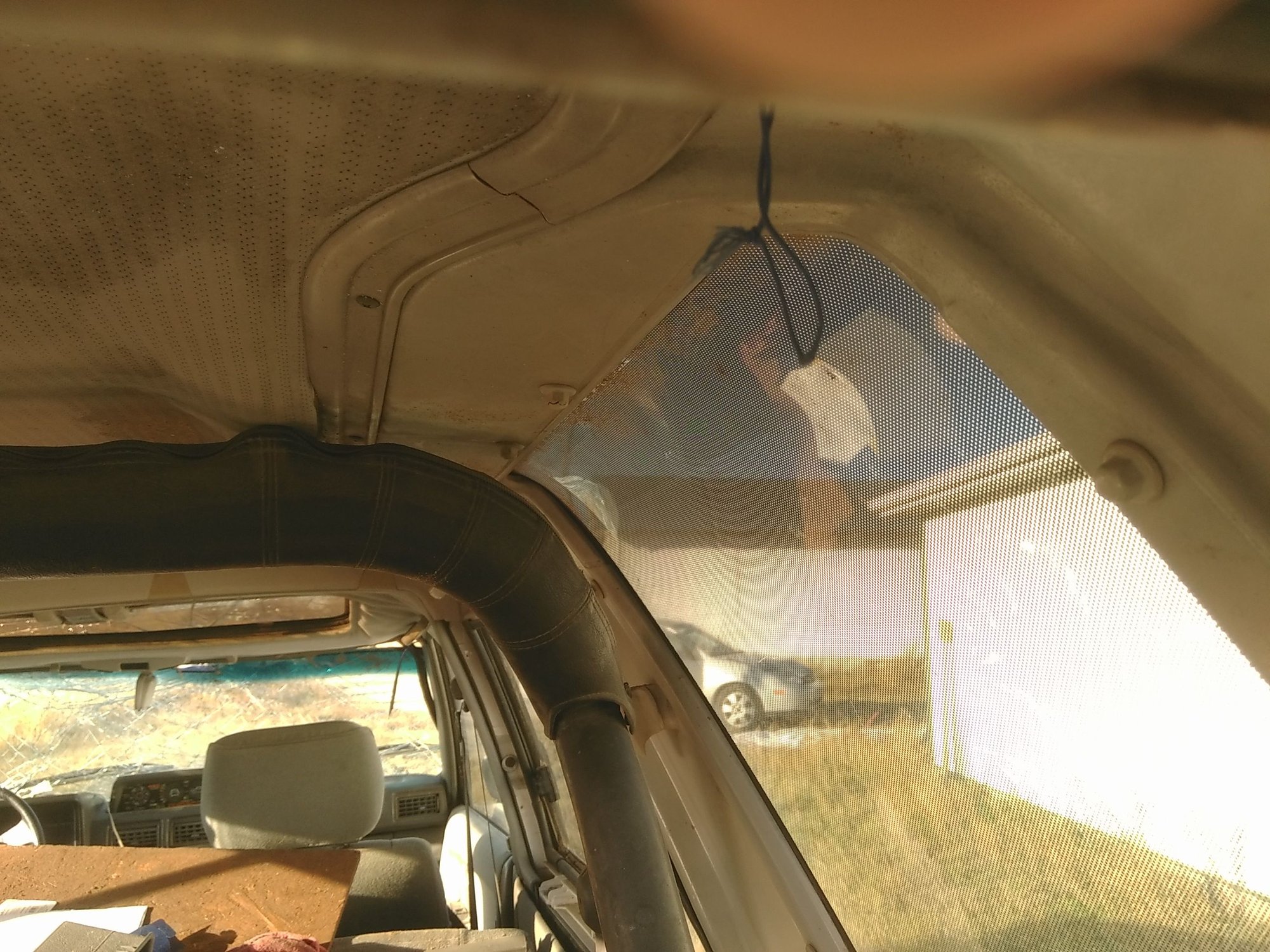

Spent another hour or so tonight with the shop vac. Started thinking, You know you didn't have to throw me into the ditch to get me to vacuum I would have got there eventually.
I did figure out the passenger slider goes alot farther forward than I thought after I got custom those exhaust flanges and stuff out from under it. =D
I've got the front seats cleaned up pretty well and two, no three, small containers of misc nuts, bolts, screws and other important things that need saved and sorted.
Tomorrow will be another go at the mid cabin area which should go pretty quickly.
Once I get to the area behind the rear seats there will be more glass, LOTS more glass, those rear windows aren't laminated.
I'm really tempted but trying to avoid calling yota Jim and having him cut out an A-B pillar and roof section, there aren't any 1st gens in the U pull salvage yards.
Still need to find the back glass and the topper rear glass. There aren't any of those "$50" fiberglass toppers popping up in CL, there were a good half dozen back when I didn't need one. And nobody snagged up the cheapy glass for me I mentioned before that the guy wouldn't take a PayPal for.
I'm shooting for mid spring, but the lady is thinking it'll be out of the garage by mid winter and I just can't do epoxy work if it's below 60 something at night.
