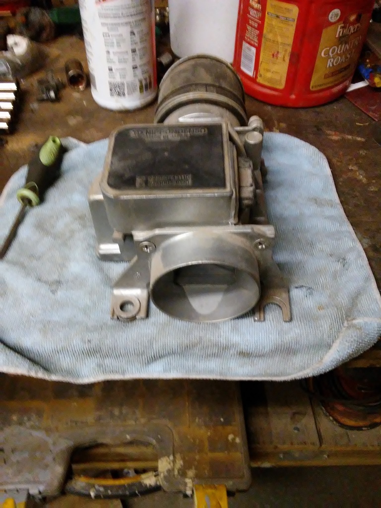

VAFM..
So warmed up the shed, grabbed a flash light, and attacked this for removal to the warm place.
Hole in the bypass cap.
Original seals

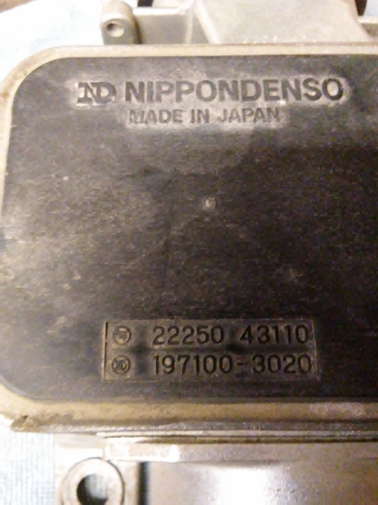

Part number 22250 - 35040
Lower cover marking G010-3
Inside the exhaust side on the roof: "2 S"
GUTS, circuit board identifiers.
Intake aperture at exhaust side: 1 5/8th x 1 5/8th
GUTS, no markings. Worst wear concentrated in the 2nd and 3rd sections of the wiper area
GUTS, Arrow scribe indicates starting position. Verify spring direction, clockwise increases tension.
GUTS, Helper spring. Only contacts the mechanism while the fule pump contacts are open.
Two teeth tighter. I also tryed two teeth looser, and traced the retainer spring onto the cog for back up markings. I did not count the coils, but looks like three complete turns of the spring(TODO!).
The adjustment on this version really is simple the retaining spring will shift out of the way without loosening the screw. Using my thumb on the spring and a screwdriver inserted into the tooth next to the board I released the spring and levered the cog around.. Use the other side of the cog/board junction to lever the other direction.
Ok so I made the two clicks tighter adjustment and made a few runs, I can't say tighter was better than original, I should have done a refresher run with it at zero adjustment to calibrate the buttock dynometer. Then came home switched it two clicks looser and made another test run. Two clicks loose resulted in me turning around in the ditch and aborting.
It's hard to modulate the throttle, stay on the road, and read all the gauges in the instant it shuts off. I need a co-pilot, gauge lights that work, and a smaller scan area.
I have two boost gauges installed. currently they couldn't be positioned much worse unless I put one behind the drivers seat. Actually that would be an improvement maybe if I could use the rear view :cheese:. The PO had one installed, it's in an A pillar pod and plumbed into the gas filter on the rear of the plenum (actually Tee'd with iirc the cruise or something). I added the second one and plumbed it to a Tee in the wastegate line, it is temporarily mounted on the passenger side of the center console off that lower screw hole. I see on average 2 psi difference but have seen higher around 5 psi on the wastegate as the plenum nears the vacuum to boost transition. I am not sure how much of that is the gauges or actual pressure drop.
Kind of pining for ODB-II I guess.

Merry christymas, that intake tube post is for yall. I laughed my butt off over it and totally forgot to share it.
I wasn't actually sure it was the stock meter, the celica or some bastard child the PO put together. I'm pretty sure now the seals were original and it wasn't altered, and the 35050 part seems correct .. Lets see. Lakeland says 35020, epc-data says 35040, toyotapartsdeal.com says 35050 does not fit, it lists the 20 as the 22REC and it lists the 40 as the RTEC. What is the part number on yours out of curiosity?

I have an 82 Supra meter. It is 197100-3020. I pulled it off a one owner 82 Supra. A kid was texting and driving and rear ended her. I dont know if it is the same for the turbo or not but it is for Supra. I know it can be an upgrade for the 22re. I am not trying to make a sale but I know how hard these can be to find and if you really need it, I will sell it to you for cost that I have into it and shipping. PM if interested.
82 Supra part number and I think it is the bottom number everyone refers to.
Not sure if you tell by the picture but they do have a bigger bore then the standard 22re.
