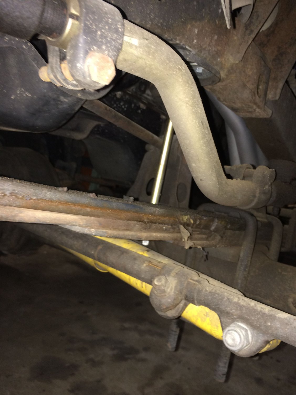

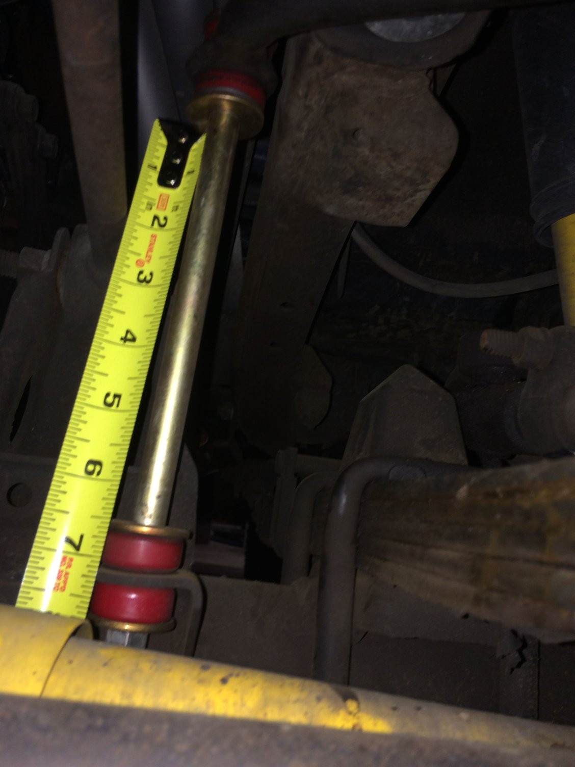

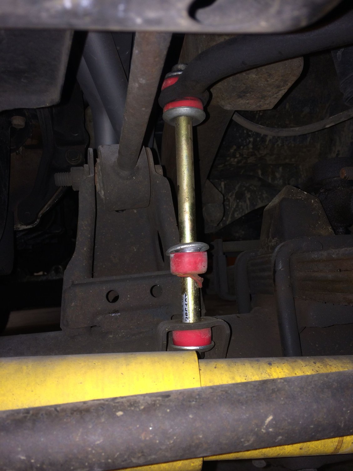

I don't have a part number, I believe it is Skyjacker brand and if I remember correctly was sourced from a local 4wd shop. I'm not sure I'd recommend them since I had some trouble with the washers on one side. It's possible the washer failed because it was overtightened. I replaced it with one that looks hardened and haven't had problems since. Looks like mine have 6 1/2" spacers, and that may be an inch or so too much. Also I'd say the dropped drag link was a preference thing.
