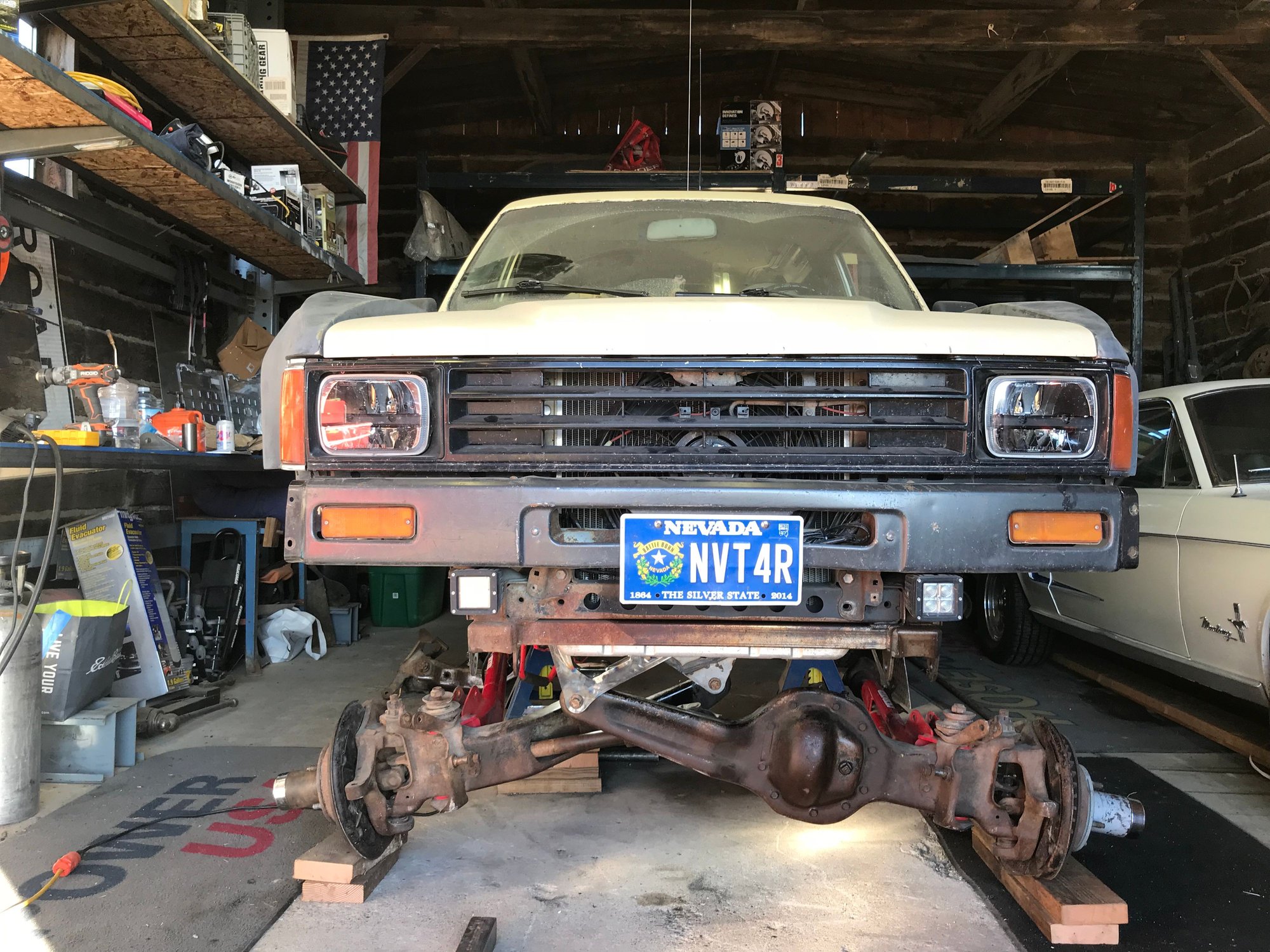

Few more from today, put in a complete axle to make sure that the ujoint that allows the axle to pivot in the center doesn’t bind throughout full cycle of the suspension then I tied the crossmembers together with tubing. Also swapped in Rigid LED headlights instead of the VisionX 4x6s I had adapted to fit. I think they look much better.
Bump
Droop
Front side
Backside

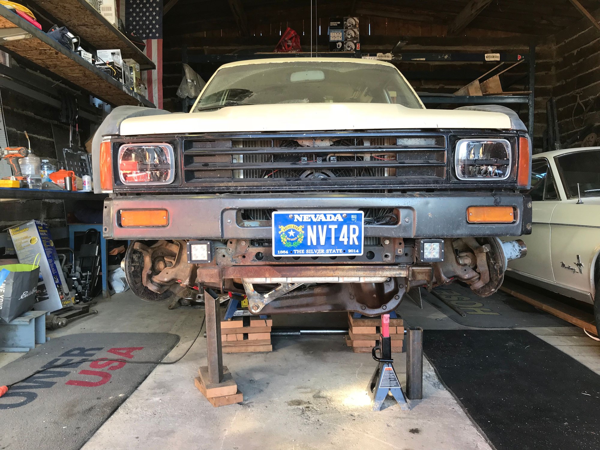

I decided that I wanted a lower ride height so I redesigned the front suspension crossmember. I also ordered a custom made set of deaver leaf spring for the rear end so now I’m waiting for those. I mocked up the new front crossmember the other day and am really liking the ride height a lot more although there is a little more fab work involved to make it all fit. Here are some more pictures for now.
