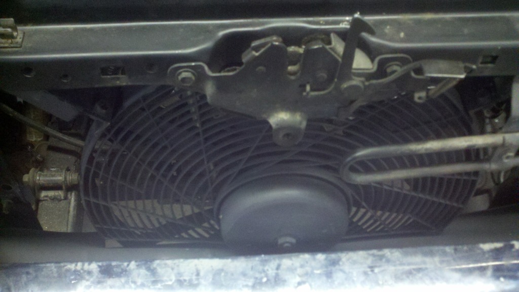

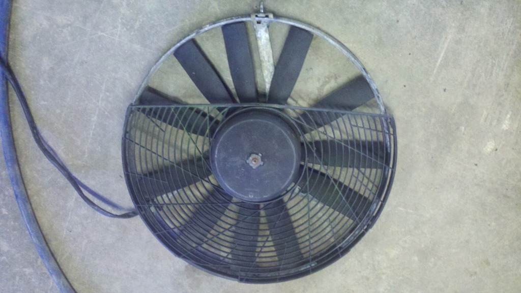

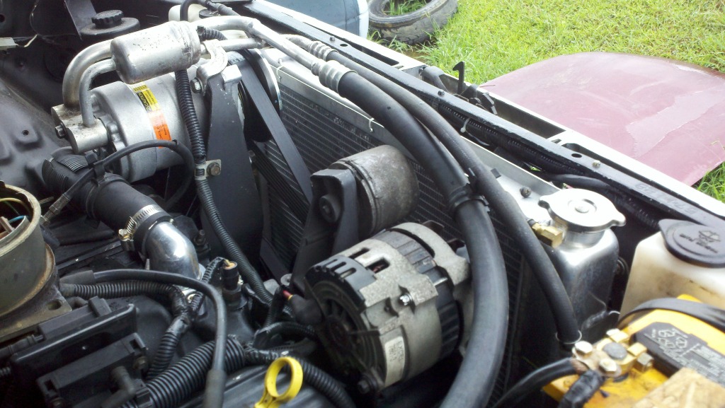

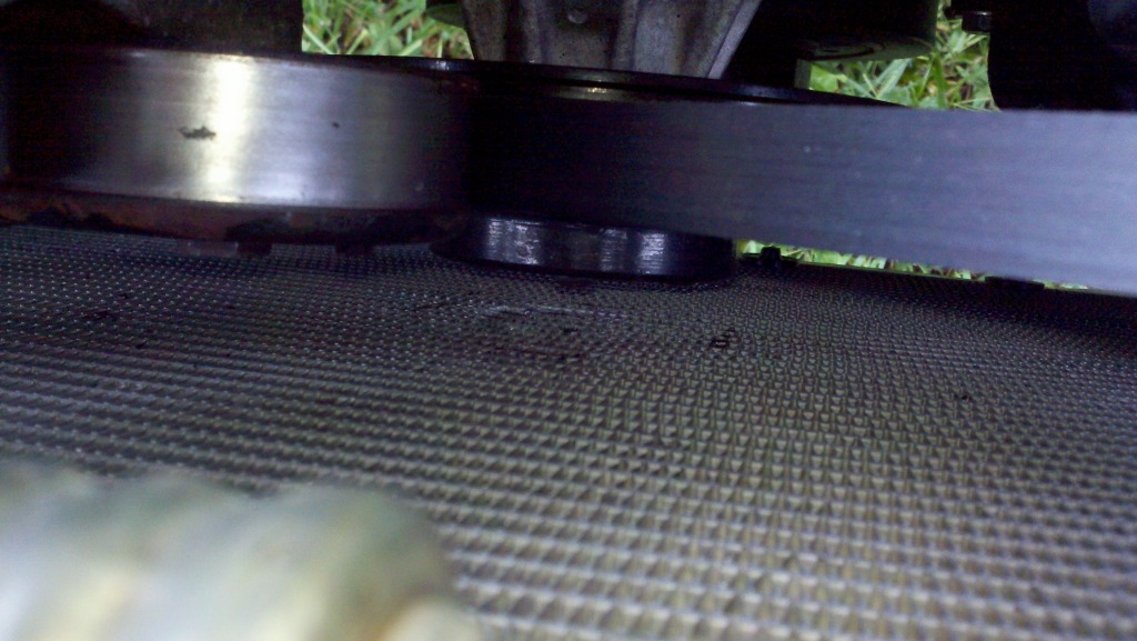

I don't have any pics of the mounting other that previously posted. I will take some more detailed mounting pics and post next week. Here are a few other pics.
Used a mercedes 190 E cooling fan looked like it was made for it.

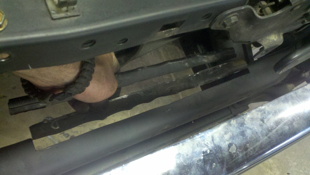

had to cut minimal metal out of the lower radiator support

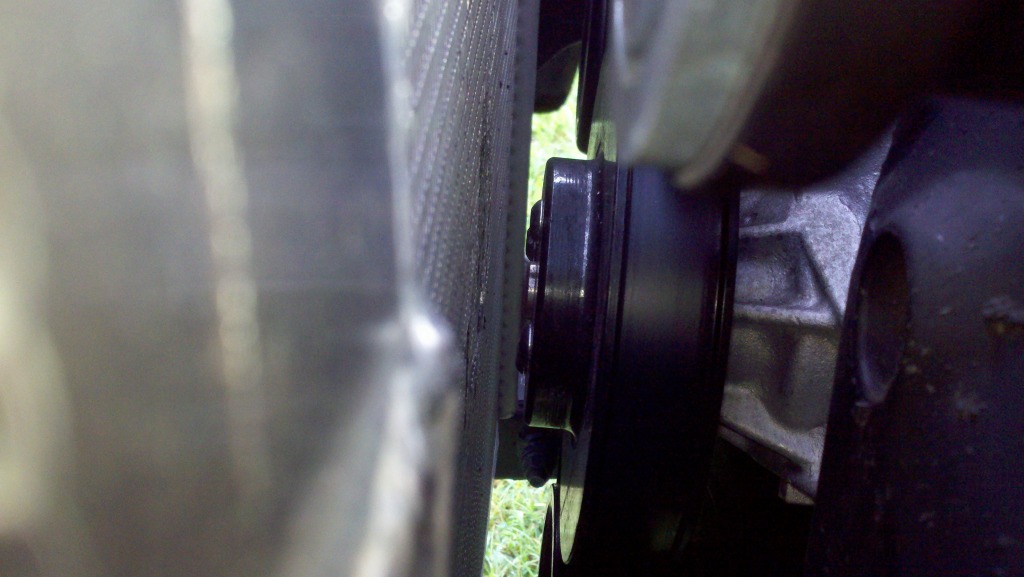

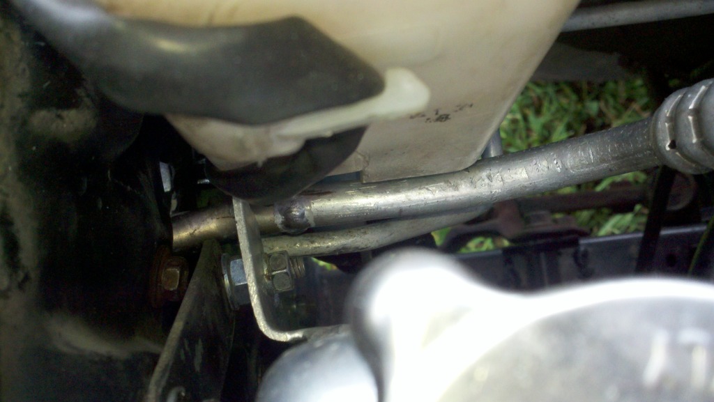

used a 1992 corvette short water pump shaved about 1/2" off the water pump fan pilot and used hex button head bolts for the pully and had about 3/4" clearance would have had over 1" clearance except I wanted air conditioning
