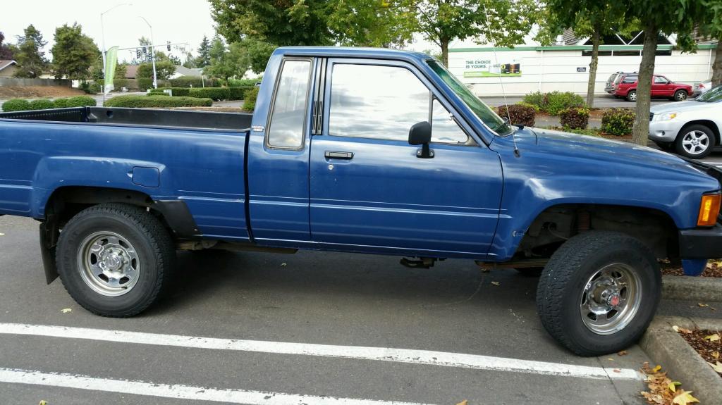

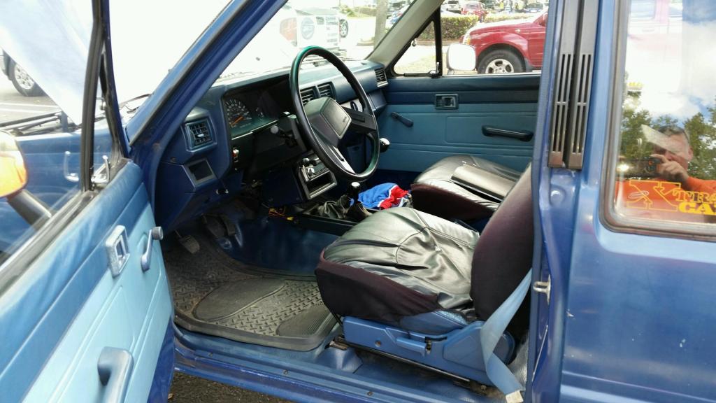

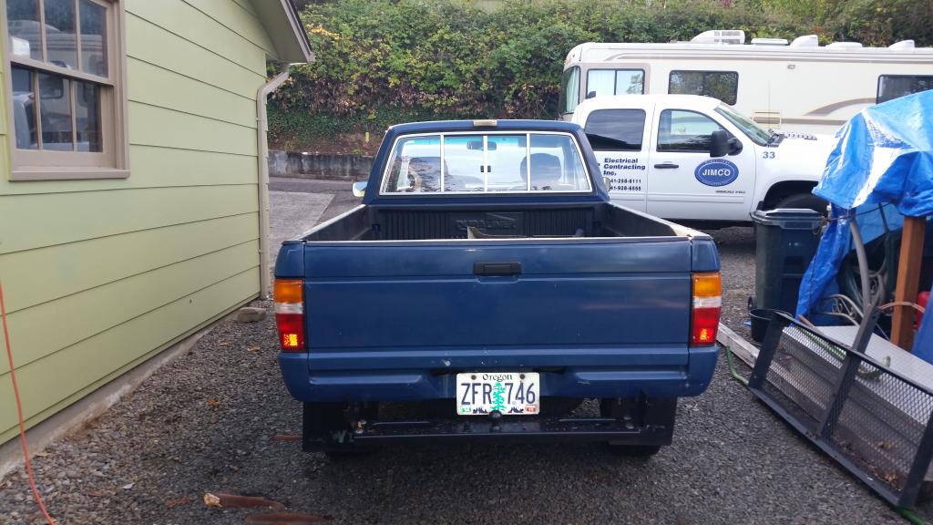

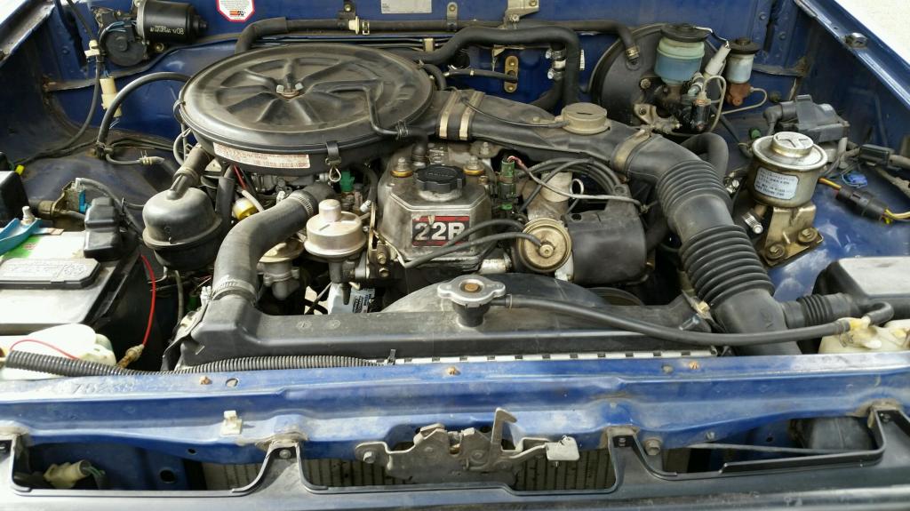

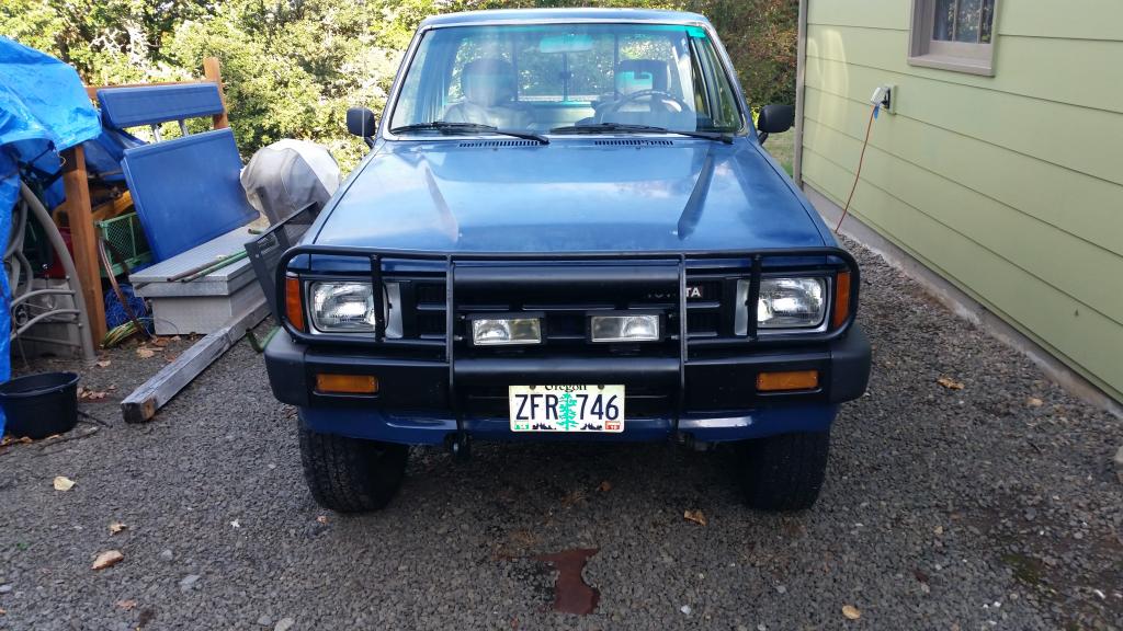

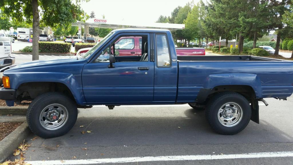

Well I just recently found out that I'm headed to alaska for the next few years and decided I wanted to get another toyota for the awesome snow wheeling and adventures I hope to have. So I started looking on Craigslist every chance I could and came across an all stock and super clean 85 extended cab back home. Gave my dad a call and the next day was the owner of my first solid axle toyota. I'd like to give it a nice 2-3" lift and some slightly bigger tires. Not really wanting to re gear quite yet but also don't want to buy tires twice when I do. Not sure what lift to go with. Any input? I won't really be able to work on it until I take it up to alaska. Anyways, here's some images Name:  IMG_10691.jpg

Wow!!! That truck is in great shape. Sweet find. Welcome to Yotatech and looking forward to your build.

Awesome find!! Sooo clean. Cant wait to see where you go with this build.

Great looking truck!

Omg it's beautiful ! So hard to find them clean nowadays.
