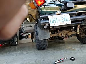

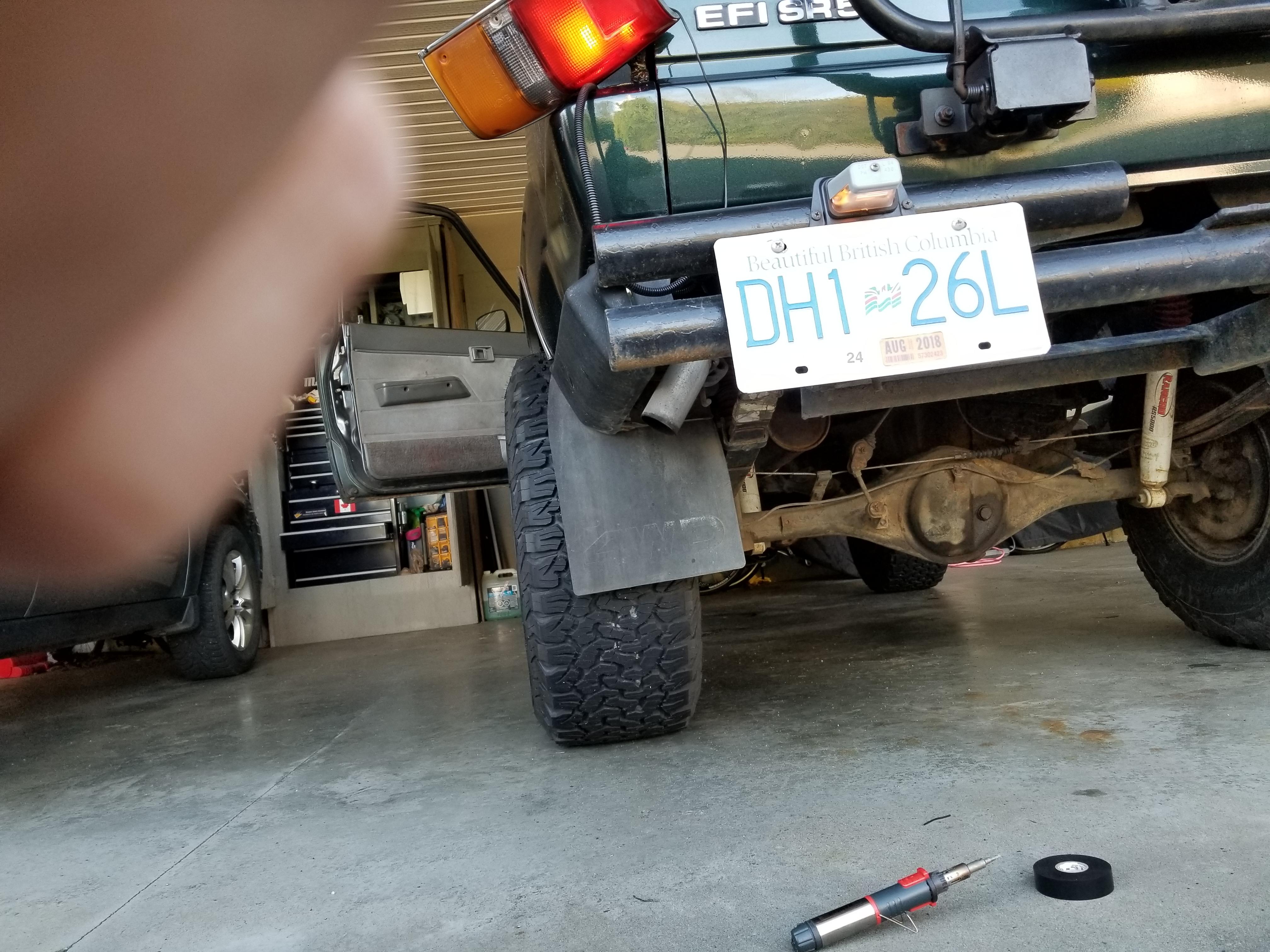

looks great. Where did you end up putting your rear license plate? I ended up getting a license plate holder c/w led light because my rear tire carrier covers the oem license plate holder.

I had it in the original spot, then I zip strapped it to the spare tire. I'll probably make a little mount for it somewhere on the tire carrier where it's out of the way. On my front trail gear bumper it has a receiver so I'll probably make one of these that I can pull on and off when I run trails.

Here the RCMP will bust you for no light, not sure about there. Nice bracket, I like it.

One of my license plate lights in the tailgate is all busted up, maybe I can extend the wiring from that to add a light where I end up putting. You're right I should have one
