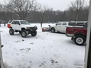

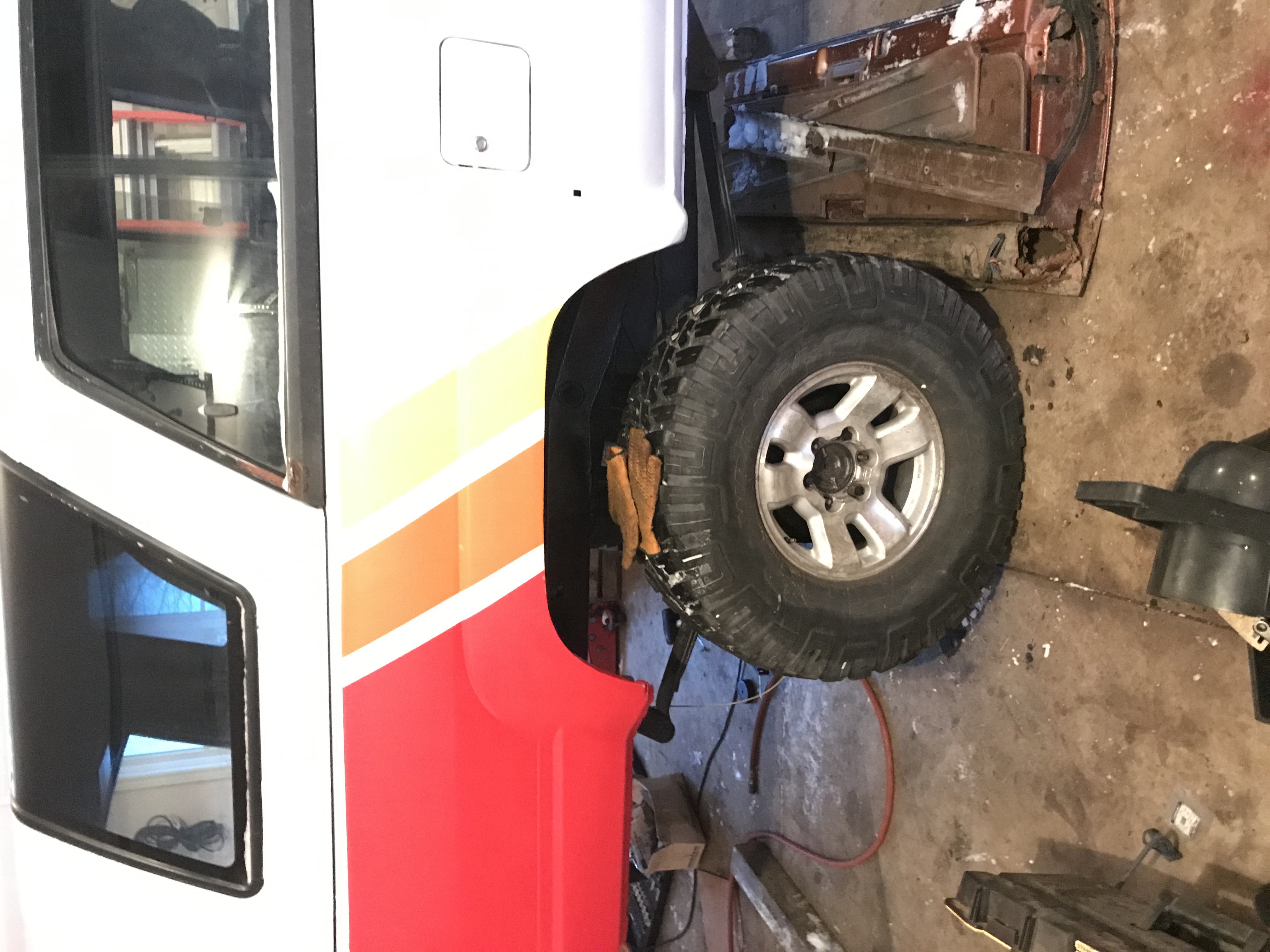

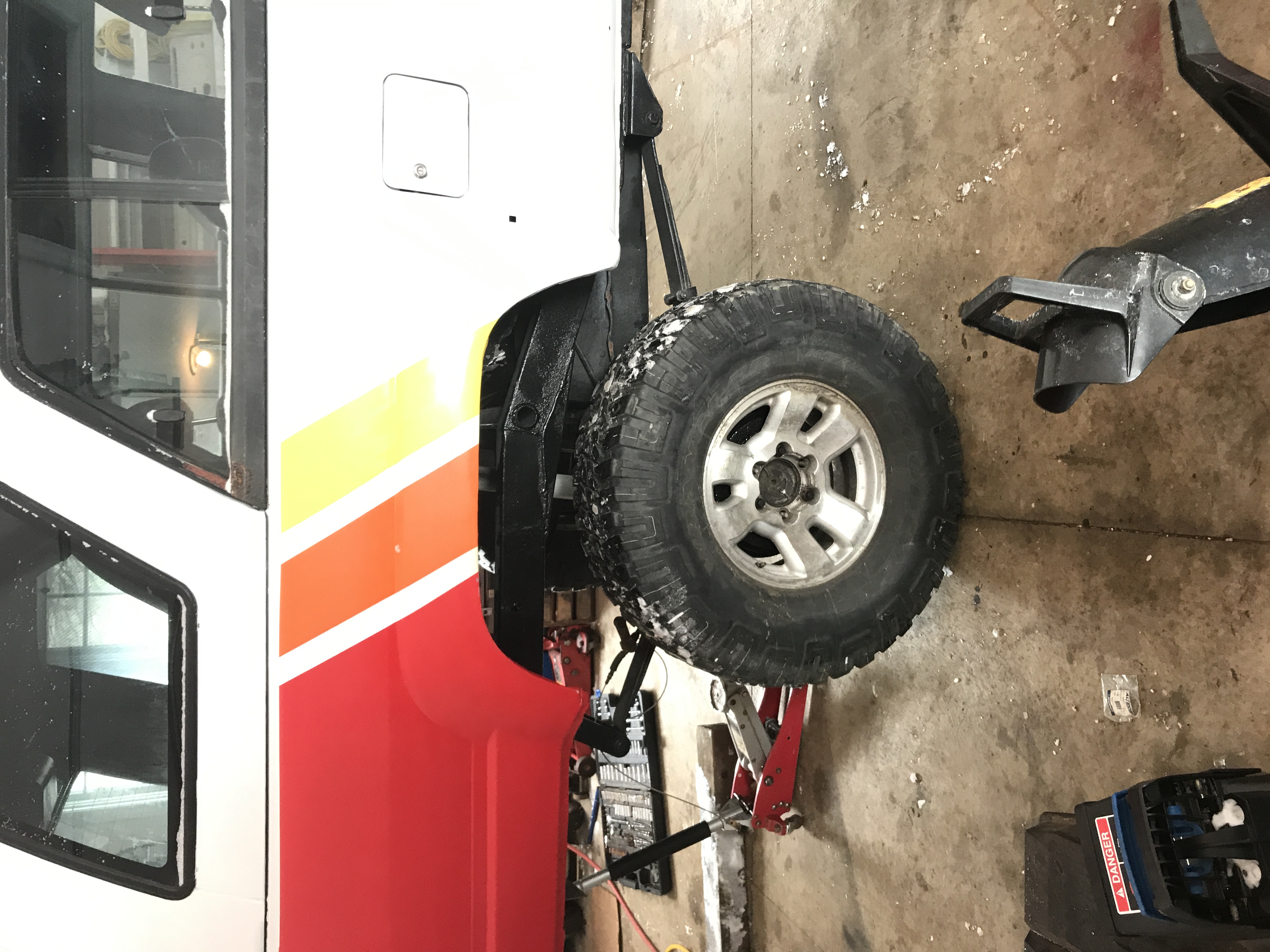

Pulled it back into the garage after a few months of sitting in the snow. I lowered the rear 2 inches, did the rear inner axle seals, changed the fan resistor. And I tried to fix my SR5 cluster temp gauge. It goes to half as soon as the key is on. Another issue I'm having Is my rear window. I applied power to the motor and it's all good. It will go up with the switch beside the driver, but not down. The key in the tailgate does not function. The key won't turn. Any suggestions would be great because I'm lost. I don't think the switch is bad because it came from my Orange truck and worked in that.

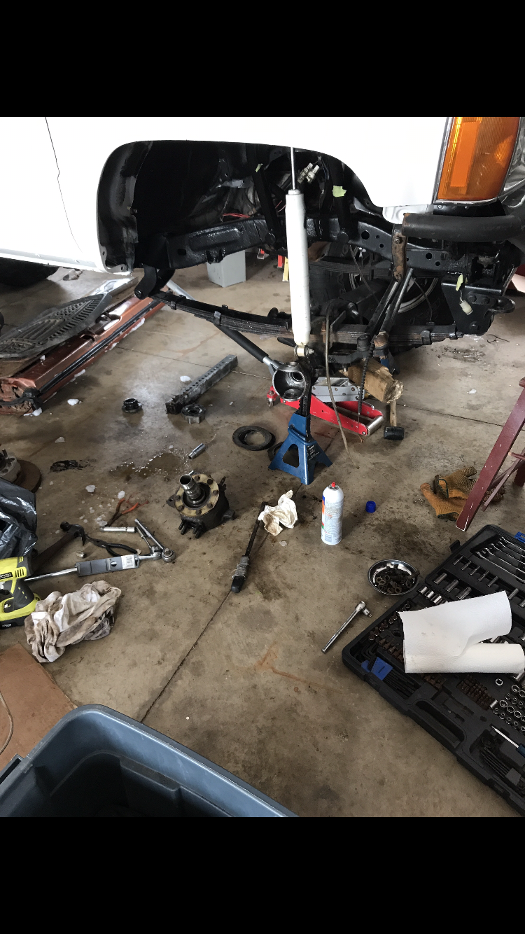

Elbow deep in a knuckle rebuild, its pretty nasty. I did it three years ago and honestly didn't think I'd have to deal with it again. I got Low range backing plate eliminators with brake holder, and trail safe wiper seals and inner seals.
The knuckle studs were loose as a goose, diff had a lot of water in it, seals didn't seem to be in bad shape but obviously they are. I'm having a hard time getting the knuckle preload right. I have the pull scale but just trying to get shims correct.

New TG pitman arm and tie rod end for the drag link. Buttoned up my knuckle rebuild and did new hubs too, took the face off an IFS locking hub I had around

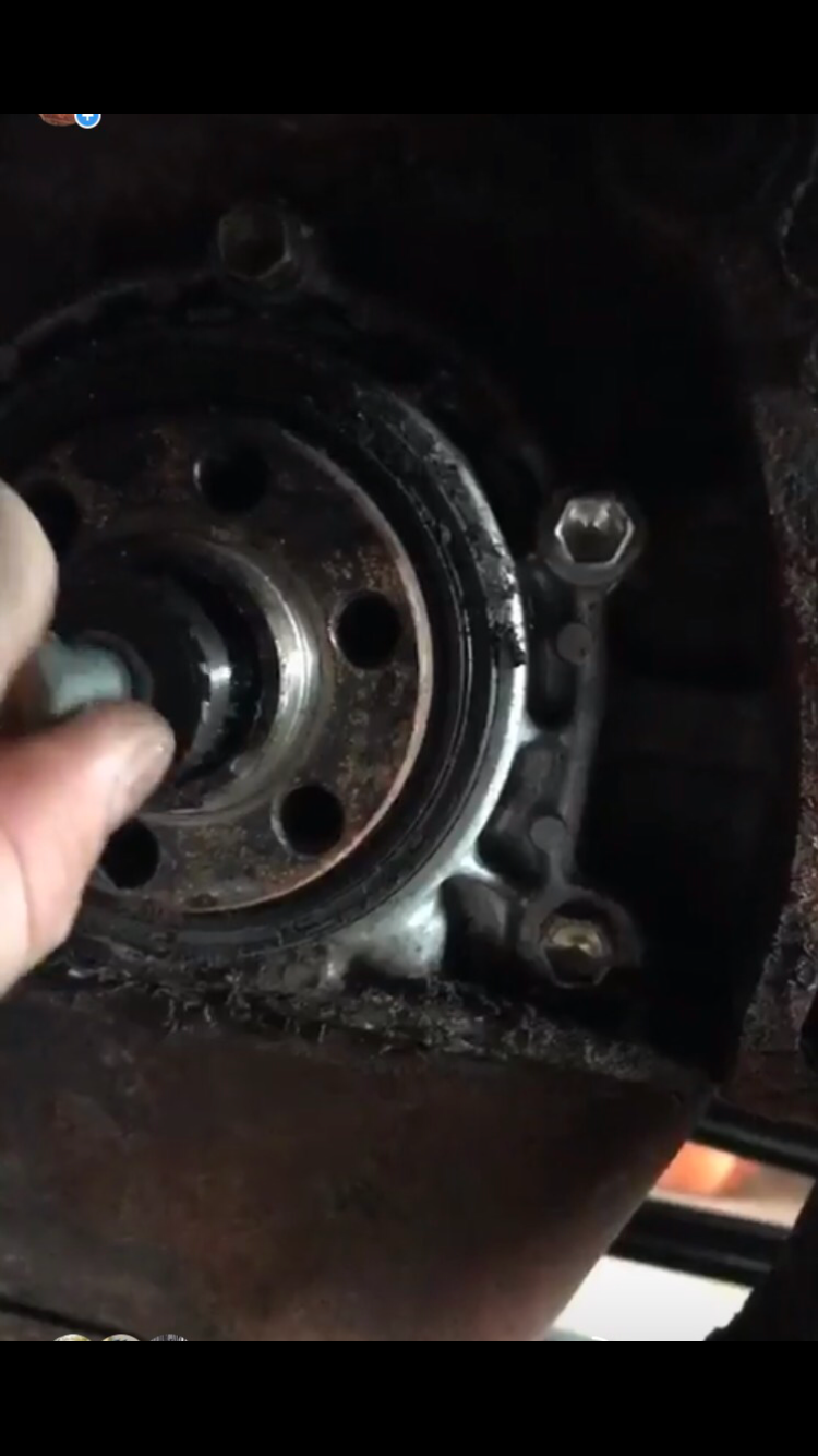

Bad pic but I got the pilot bearing out with the paper truck. Wet paper and perfect size bolt, tapped in.

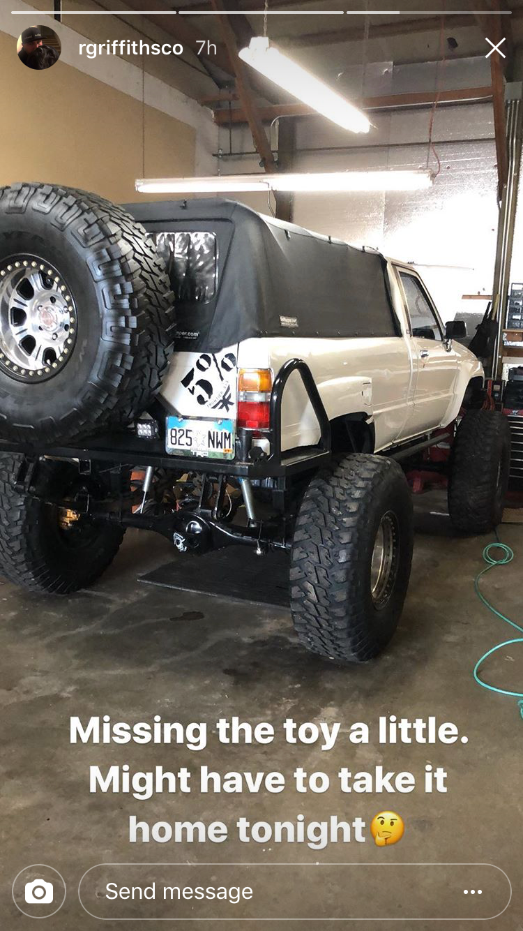

Moving along with the rear bumper

About got the goody out of that clutch!!
Bumper looks simple and clean. I like the clearance it offers. Are you gonna do a tire carrier on it?

Yep I got the sleeve for the hinge for the tire carrier, going to start fitting it up today. Finished product will look like this, I got the side peices bent up too. I'll 45 the corners too

The handle to tighten the swing out

Will you tie the sides to frame?
Curious on overall weight.

I was thinking about tying in the sides. I dont know how much more strength it will give, but I probably will. It is getting really heavy, with the 36" spare, hi lift and gas can it will be pretty heavy. In its current state I would think it's a little over 100.
