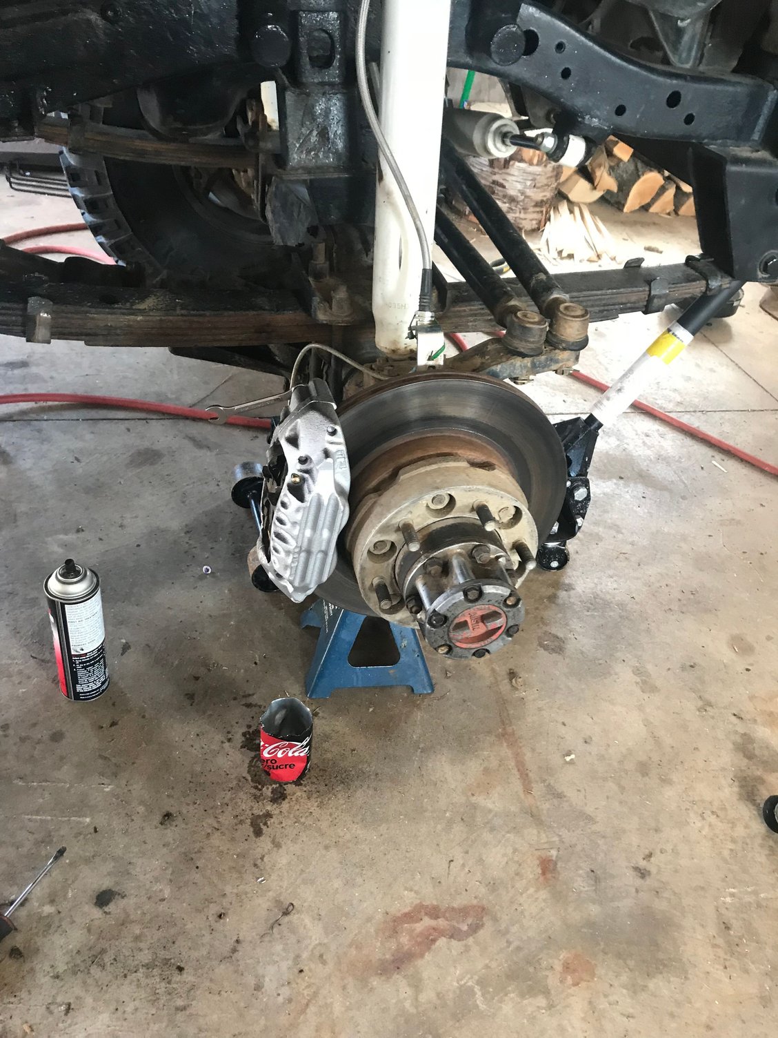

From: Ontario
So my wife wanted to learn to drive standard so we did a lesson the other day. She did really well but I worried because the brakes really suck and I didn’t want her to have to worry about that especially while learning standard. So first off, I swapped the passenger front caliper because it was sticking. And I researched about doing a dual diaphragm booster. Went into my parts shed and found what I believe to be a dual diaphragm booster from a small diameter 86-87 Turbo pickup or 4runner. Swapped that in today without having to remove any lines which was awesome (thank you copper nickel lines) and bled the caliper. It feels awesome, the front end does really nose dive even after playing with the prop valve but I think it has more to do with my suspension setup.
Brake setup now is dual diaphragm booster from a turbo pickup, V6 master, v6 calipers and the bigger drums in the rear from the IFS width axle, and a Wilwood prop valve
After installing the dual diaphragm you can see the size difference
New V6 caliper
Full size spare back on

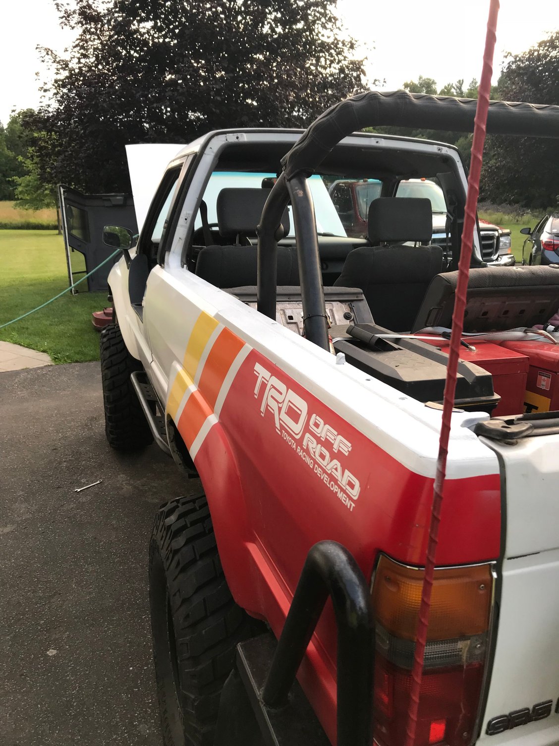

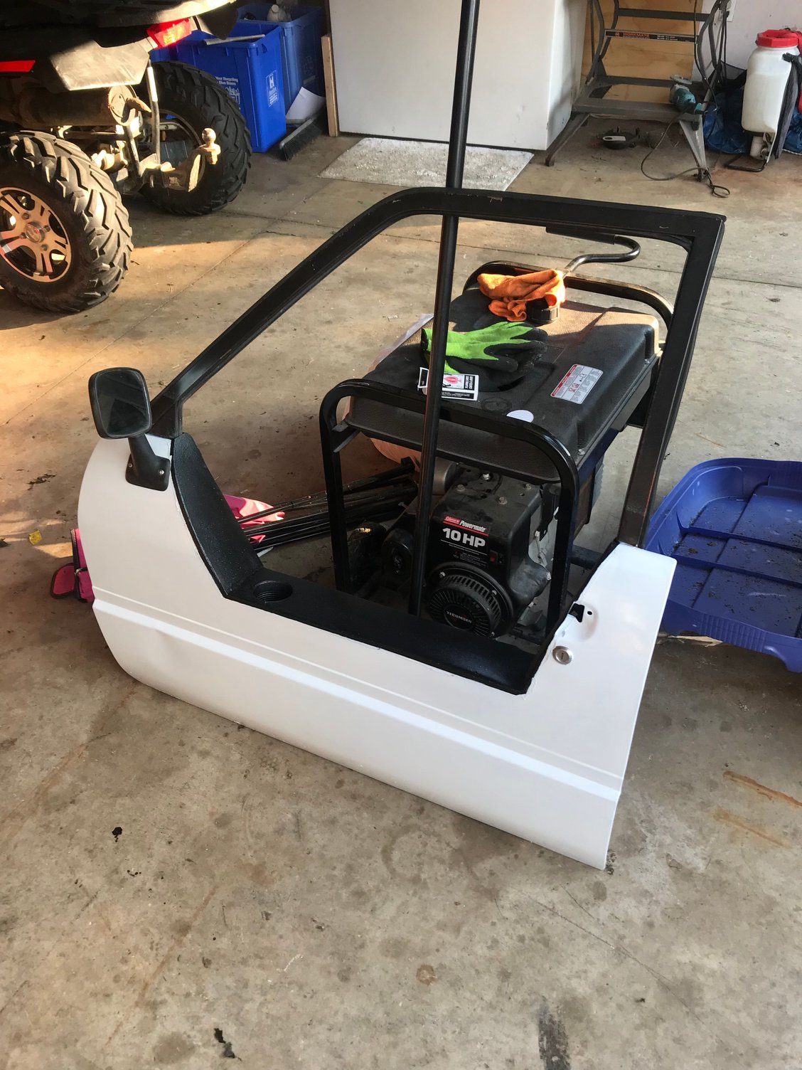

Half doors finally built. Truck is finally turning into exactly what I wanted when I started building it 6 years ago

Those look good, how do you open them?
Old Jul 17, 2019 | 05:06 PM
  #128
Toy(Yota)'s Avatar
Joined: Dec 2017
Posts: 146
Likes: 11
From: Ontario
Right now I just left the original interior door handle peices in the door. I don’t have the handle in there now I haven’t mounted it yet. I just pull the bar that’s in there.
