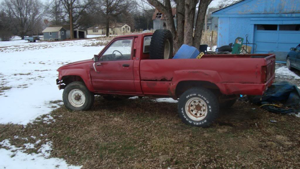

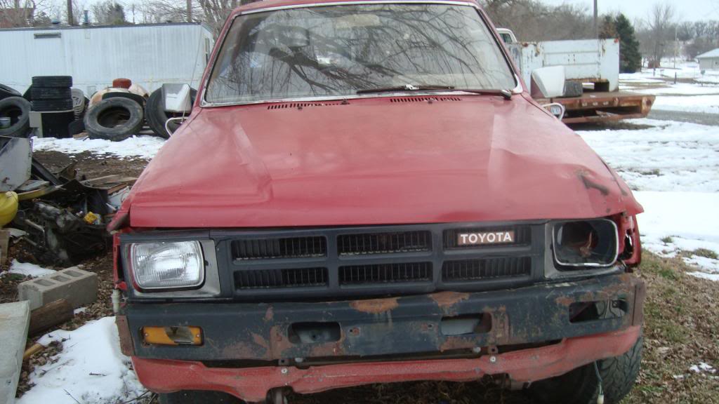

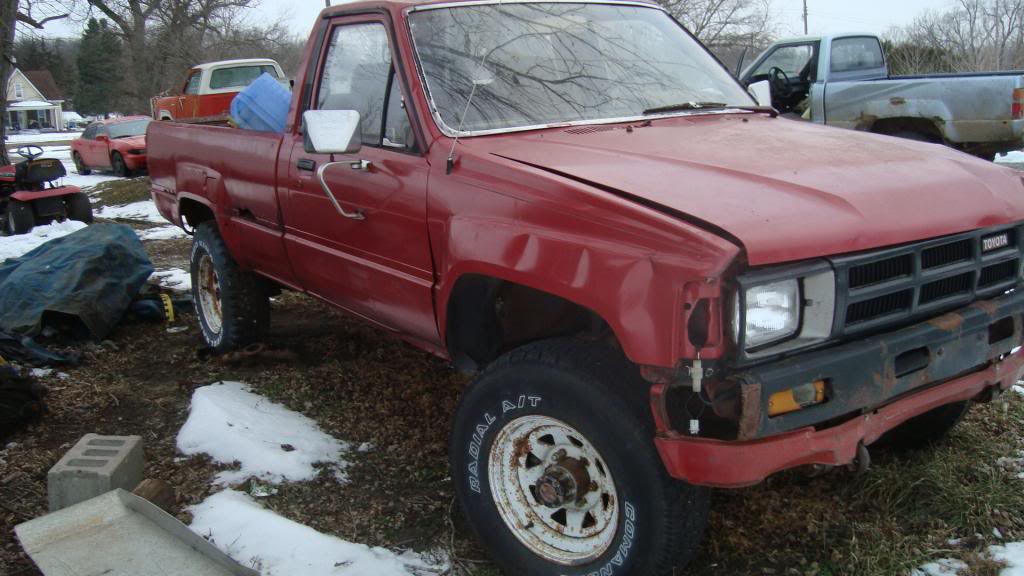

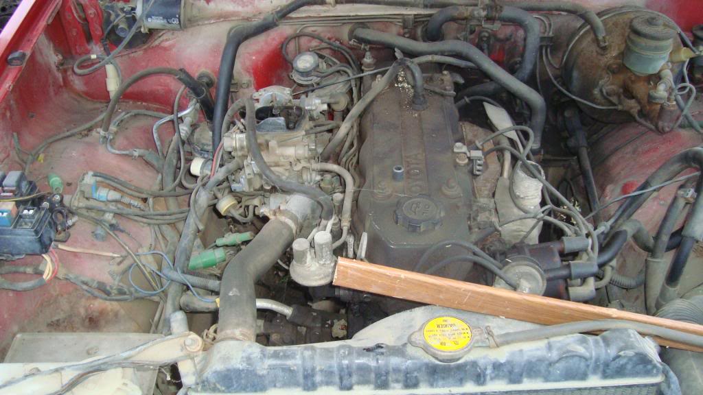

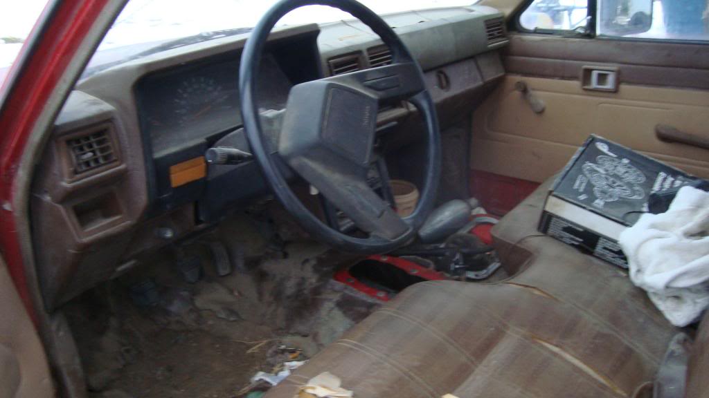

Well i havent finished my 4runner yet and i picked this 85 longbox 4x4 sitting in a guys yard along with tons of garbage (mopars and chevys) lying around his trailerhouse. I had been eyeballing it for a month and decided to go talk to the white trash pirate who owns it. He said he was taking it to the junkyard for scrap and i said id give him $150 for it. He said it would scrap for more than that so i went to $180, He said $250 and then i noticed it did have a right side tailight and housing in good condition which i needed for the 4runner so i gave him $250. I pulled the dipstick and of course it was black but it was full of oil. The radiator had coolant in it. I asked him the last time it ran and he thought it was in 08 but he said it did run. He said it had a 4spd tranny which it didnt it has a 5spd which i believe is a G52 or G54, 6/85 is the build date so it should be a G54 assuming its the original so. The top shift plates for the tranny and t case were lying on the passenger floor along with a cardboard box for a clutch (he says he put a new clutch in it) but the transmission is stuck in either 3rd or 5th, i think 5th. Its red which sucks cause i hate red, it has a 2 piece rear driveshaft which has a rotted out n rusty carrier bearing crossmember that will definetly need some attention. I put a battery in it and dumped a little fuel in the carb and she popped off. Runs a little rough and has a exhaust leak at the exhaust donuts. I reinstalled the shift plates and id end up breaking the shift rod off before this thing would unlock so it definetly has issues in the tranny. The transfer case shifts fine and acts ok. It has typical nebraska rust and has a wing window passenger door and a newer style drivers door without wing window. The frame has a few rusty spots which i could patch. It has 192k miles.

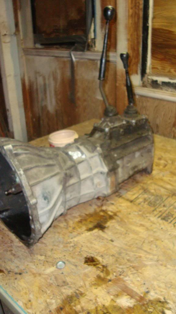

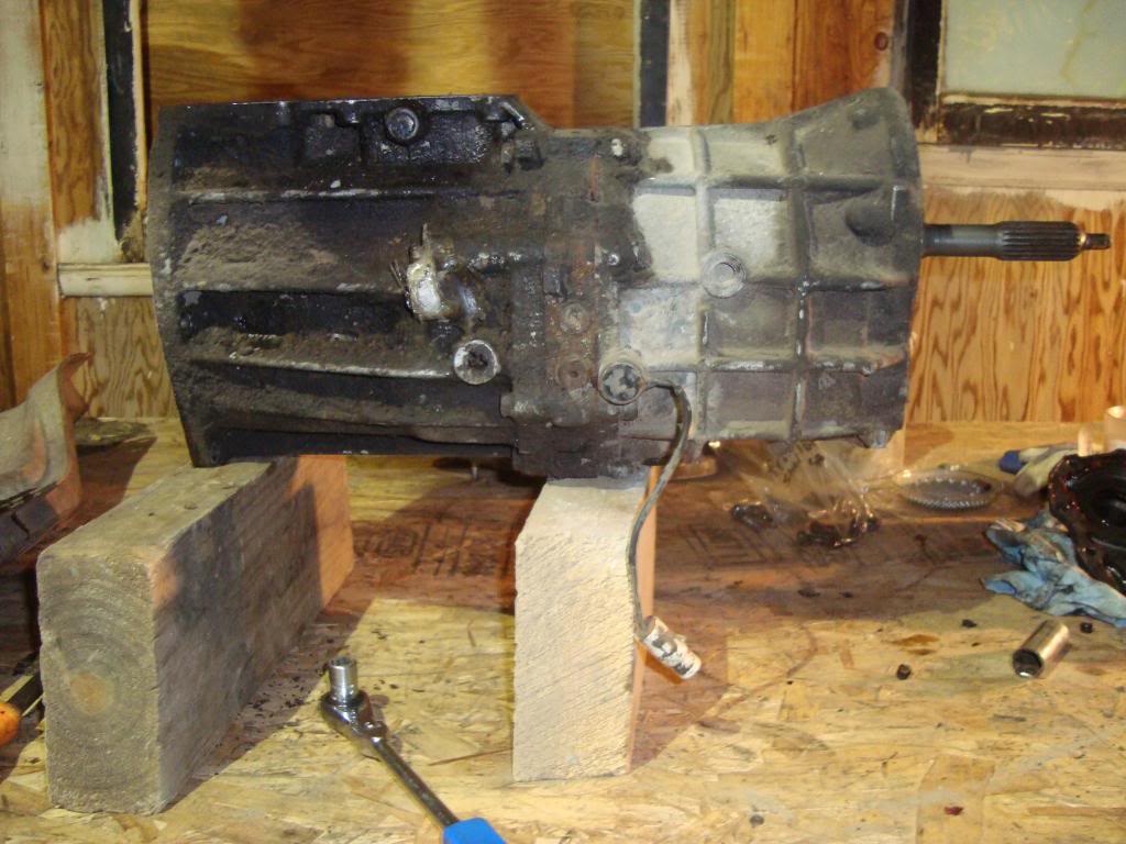

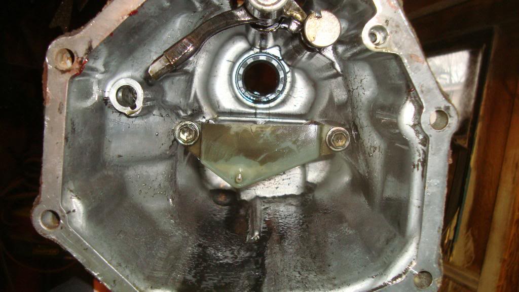

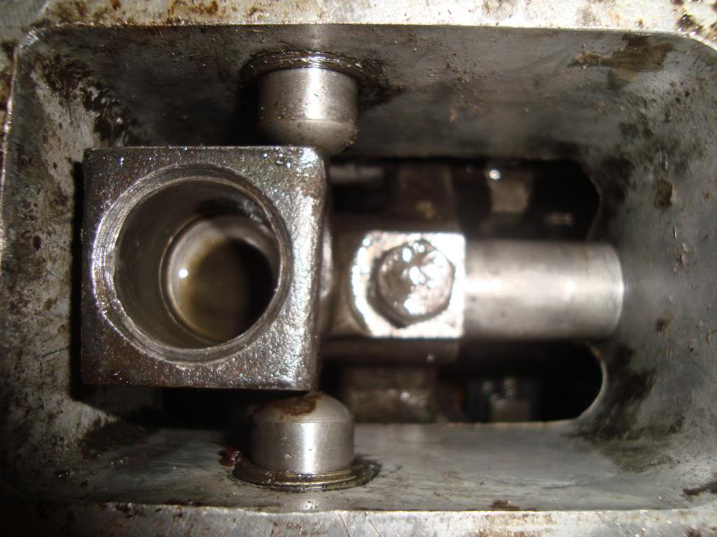

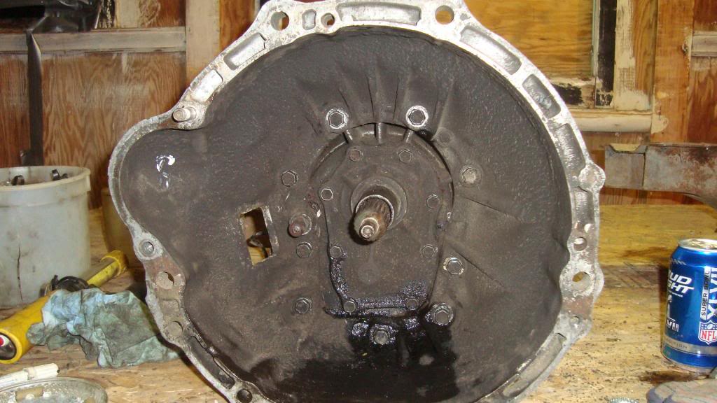

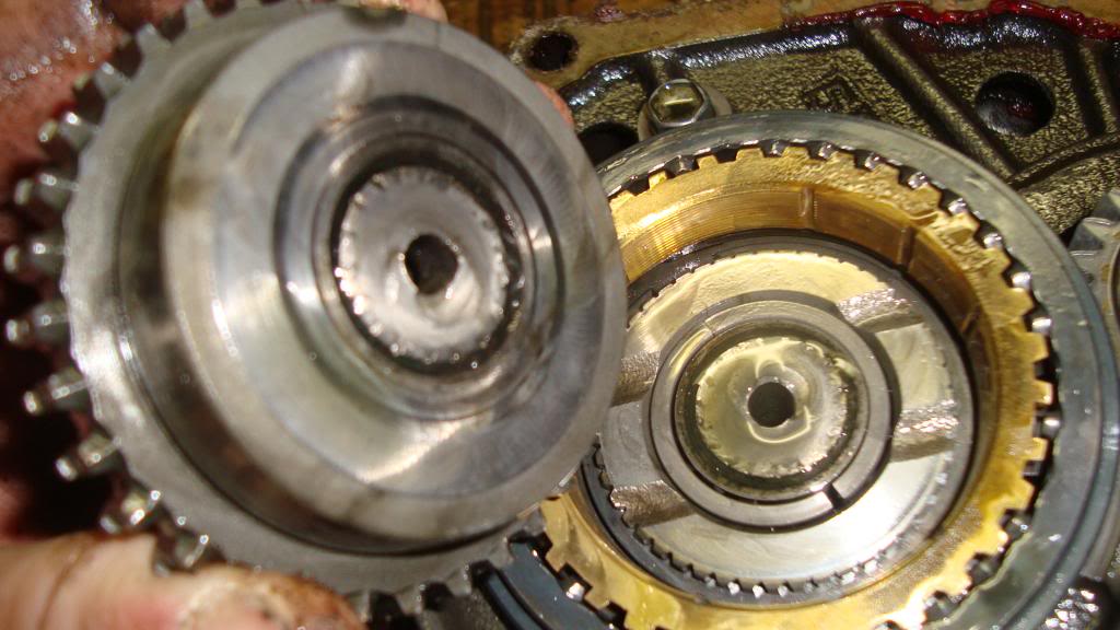

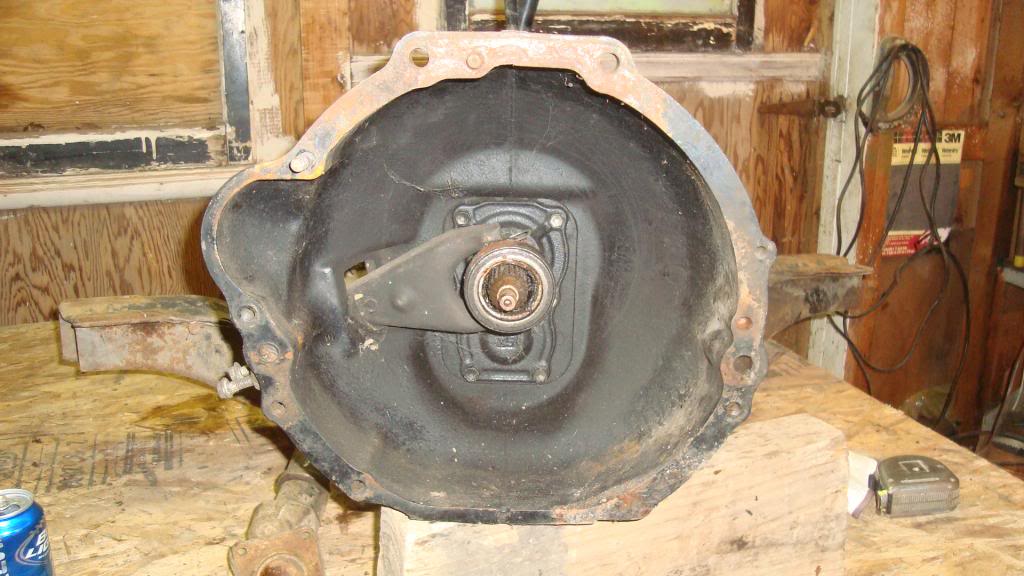

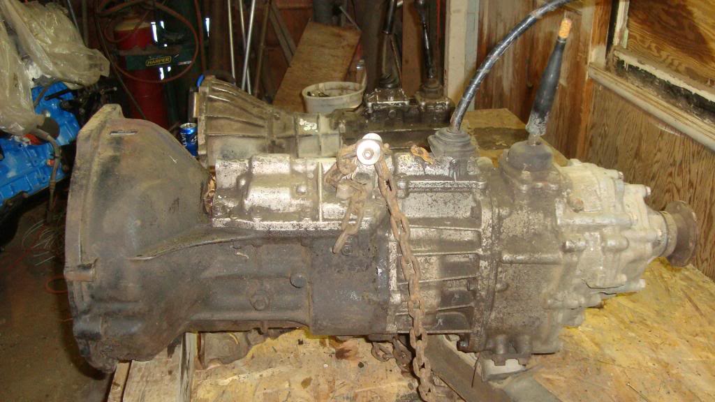

Pulled the transmission and transfer case out today, took it apart to the point i didnt want to dig to much further without doin some more research so i stopped for the evening.

Does it move freely now that its apart. Out of 5th gear
Old Feb 10, 2013 | 05:14 AM
kornhuskerwizard's Avatar
Joined: Dec 2008
Posts: 2,391
From: tecumseh nebraska
No, still stuck. Have to dig deeper. Im going to do some measurements and see if the 4spd transmission and transfercase would fit. Athough i dont see how it could beings its shorter overall and wont line up where the crossmember bolts to the frame.

I bet a shift rail is bent

I dont think so, the main one in the picture isnt anyways, its getting in a bind somwhere on the left side.

So the only way to determine the difference between a G52 and G54 is if it has a sealed or open face input bearing?? So i believe i have a G54. Anyone have any good links on teardown procedures, or more importantly what not to do??

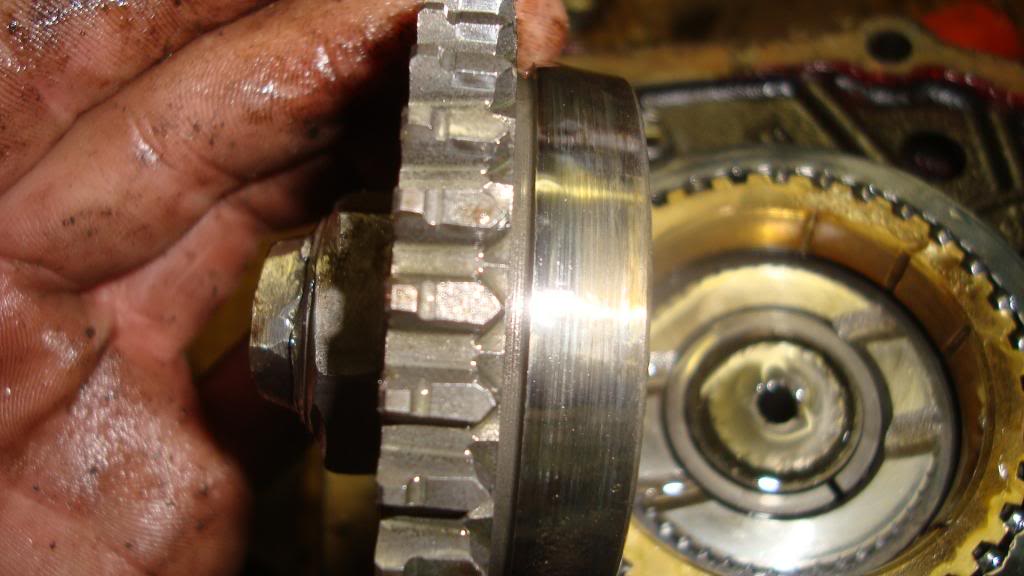

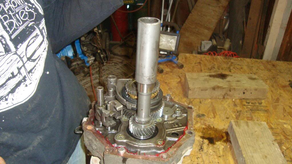

So i found the output shaft was sheared off. I put it back together for now and brought in the 4spd to do some measuring to see if it would fit. I also have a couple w56s but dont know which way i want to go with it yet. So if anyone needs a parts g54 i have one.

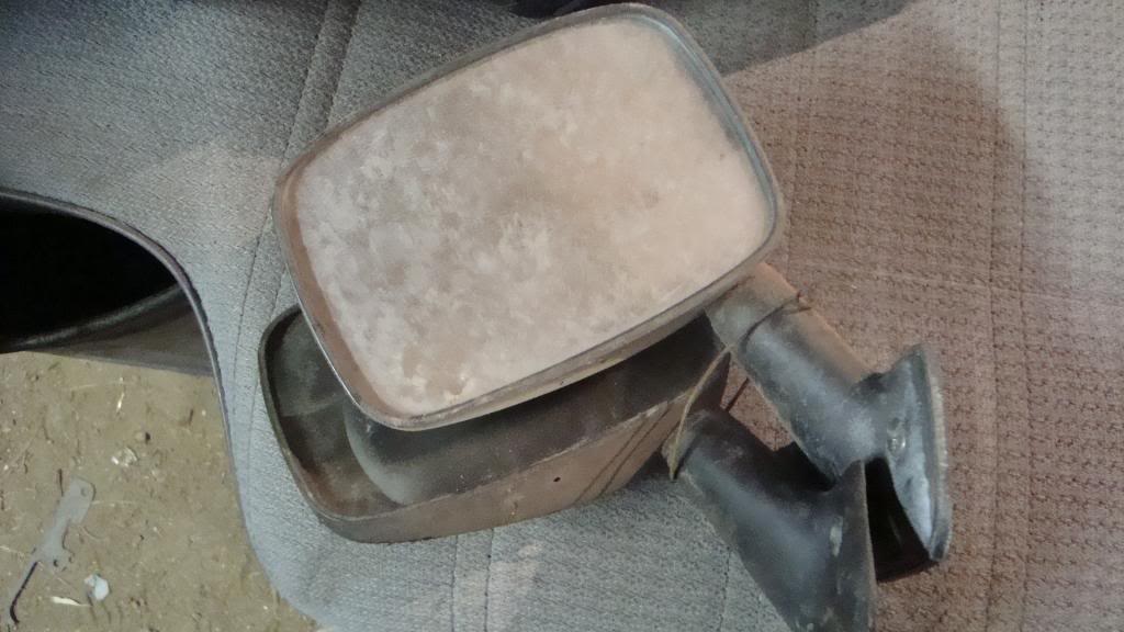

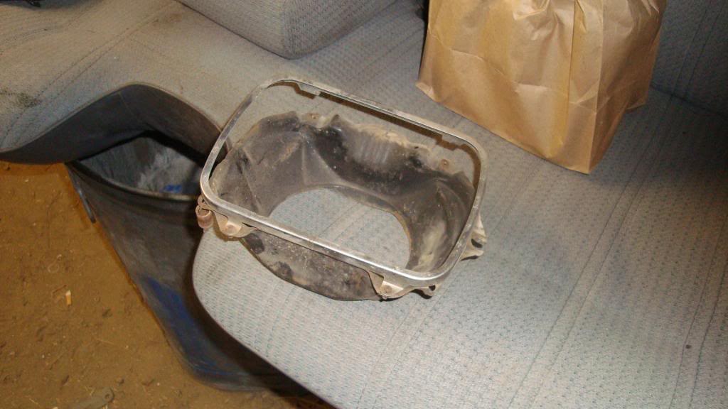

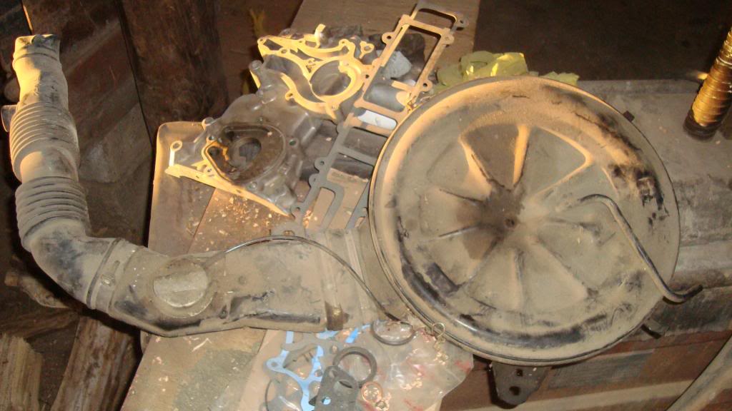

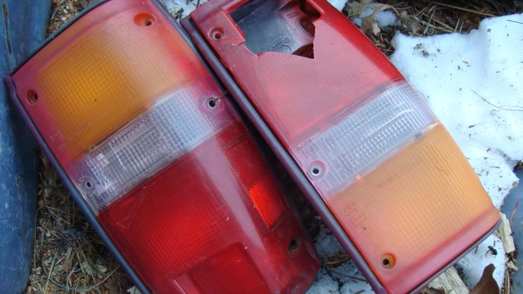

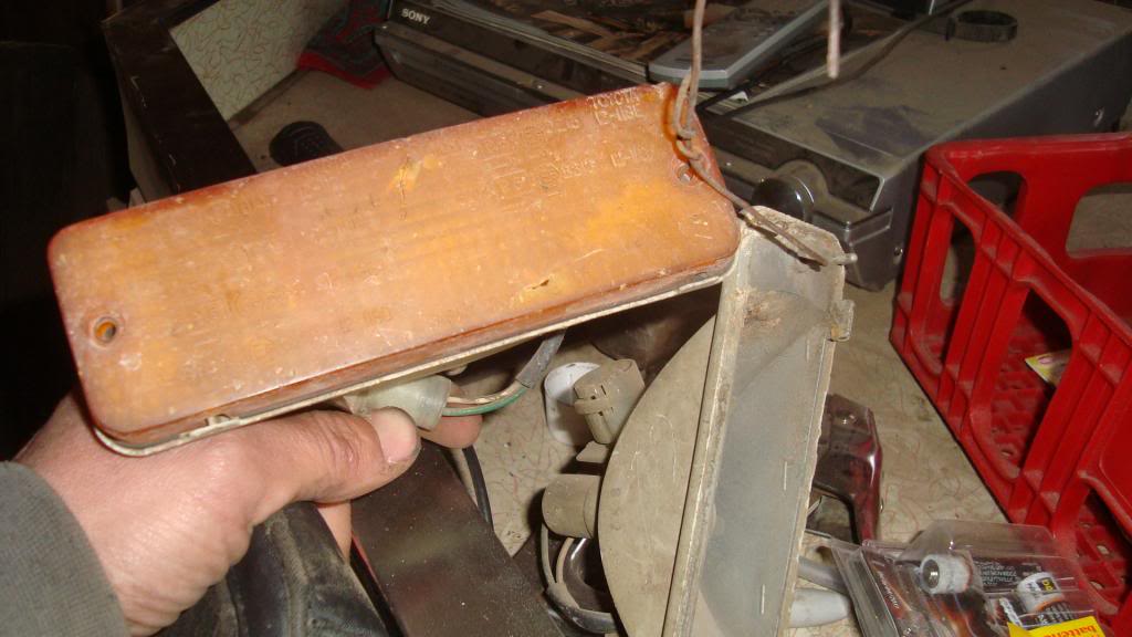

Was looking through my parts and found some things that i can utilize on this build. Stock air filter housing, the mirrors instead of the ugly ones, the trim pieces for the cab, a pair of turn signal housings (still looking for the other lens),and a headlight housing to replace the drivers side thats kinda banged up.Also found two mech fuel pumps a factory intake with carb, and three didtributors. Really need to get the tranny i found and get it moving.
