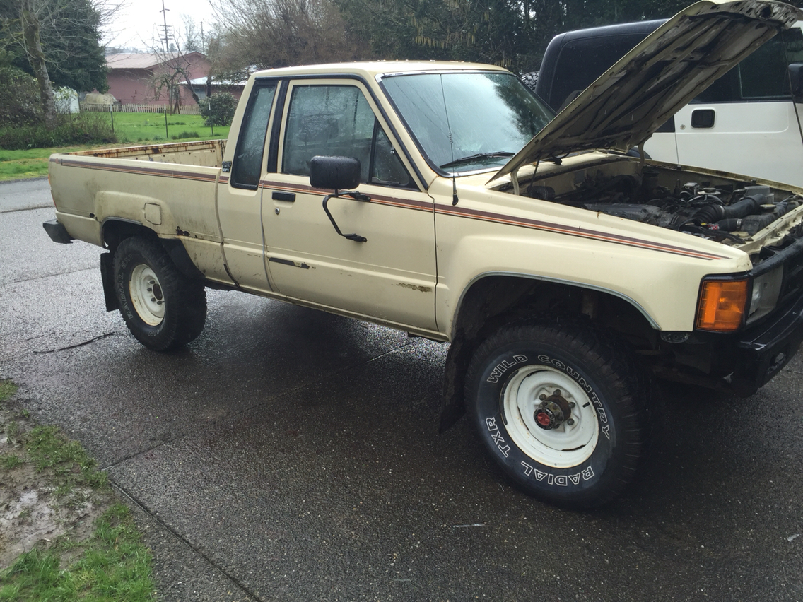

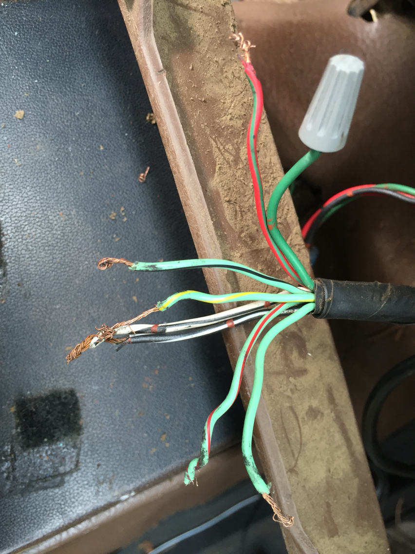

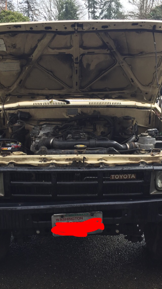

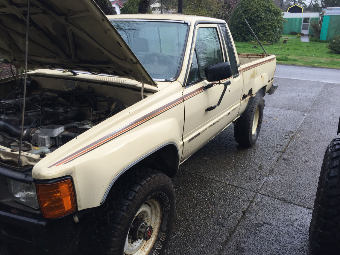

Thanks Terry I've been on here reading this forum for probably 5 or 6 years now and have read your whole thread (Awesome work BTW). Anyways storm came in over the weekend so I couldn't get good pictures or a video but I think it has magically stopped dying if it happens again I'll pull out my phone and shoot a video but today I took pictures. Its got a lot of bed rust but the frame and cab are surprisingly rust free, only cab rust I have found is a pinhole on the passenger side a-pillar under the windshield trim. But I haven't pulled the brakes off yet but tonight I'm getting a new stereo so I'm trying to solve the wiring. I've figured out the speaker wire and 12+, I have what seems to be 2 grounds connected together and a dark green wire that is capped. Pictures should be below. Also I was wondering if any of you guys could tell me what the 4 wire plug tucked up behind the stereo is for. As always thanks for the help!
