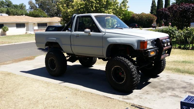

Ive had this Truck for over ten years, It was my first ride and high school stomping truck.
In 2007 it blew a head gasket and i was going to college, then starting a family so it sat.
Now it has fresh 22r and is running good so im on to the fun stuff.
Right now, im doing a high pinion up front with a nice gusseted axle.
A ifs v6 rear with Yukon air lockers front and rear.
Dual case with 4.7s
high steer 25 mm pin upgrade.
and all pro front bumper and sliders
Thats her today before the upgrades.
on the way.

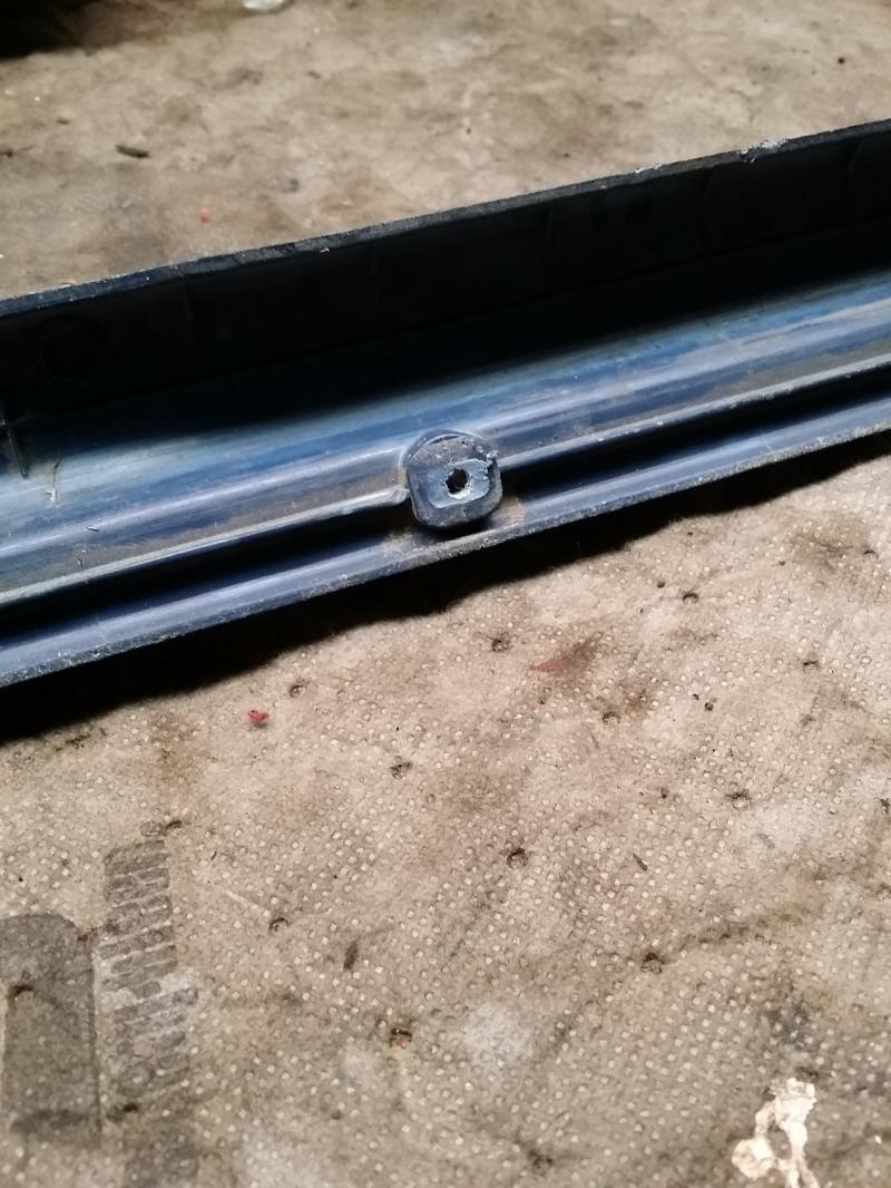

So we all know the little spread nut deal on the trim on the base of the doors correct. Mine like most fall off from time to time due them being quite old and worn out. so i went down to napa and found some inserts for the square holes in the cab. And cut off the spread deal. Now the dont fall off ever
Check it out,

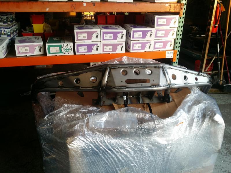

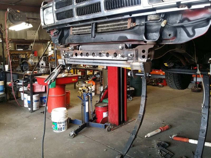

got my bumber mounted and lights fabed up

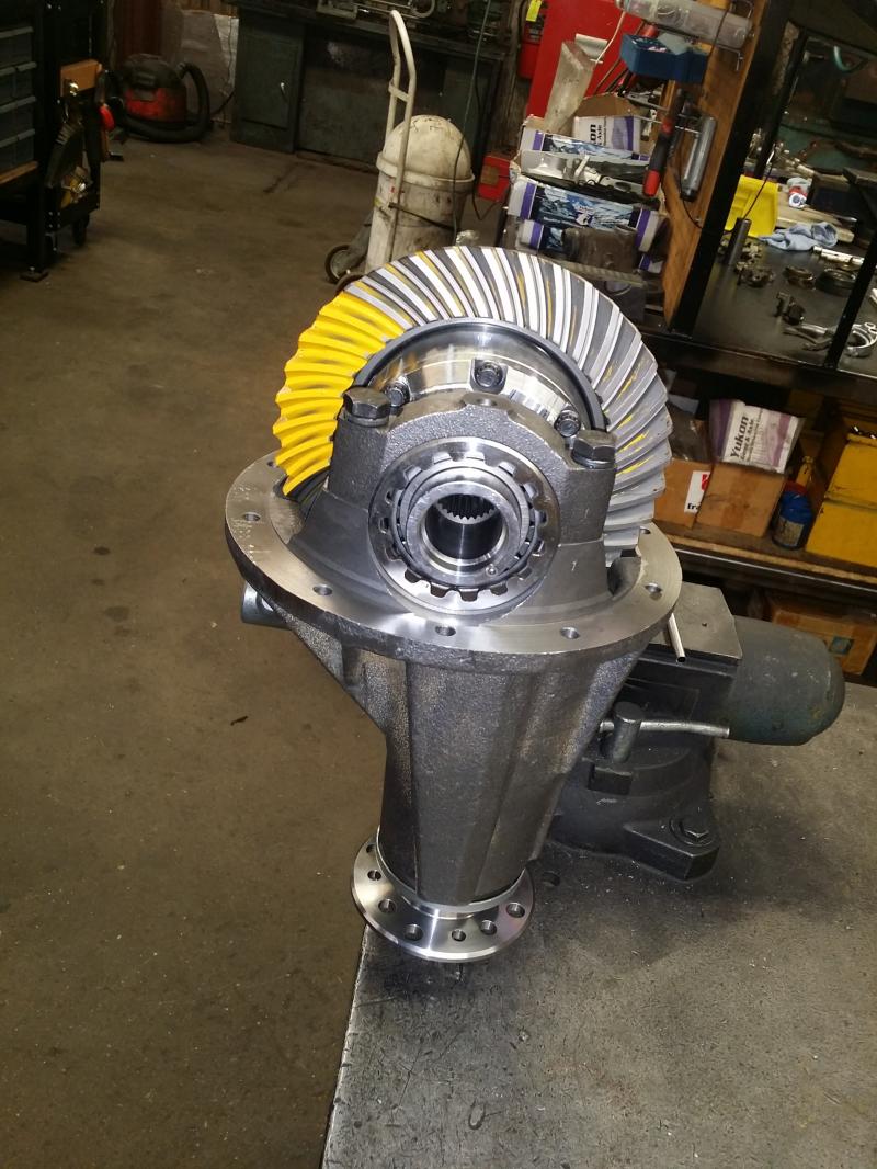

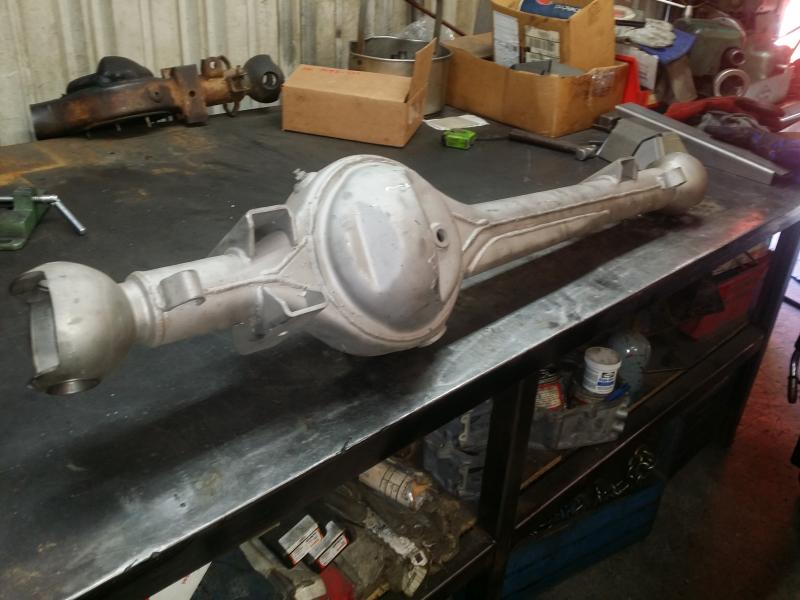

Fab time

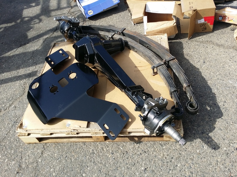

Got the front axle built as well
529,s yukon zip locker, high pinion, chromo shafts and birfs, 25mm pin kit, and backing plate eliminators
