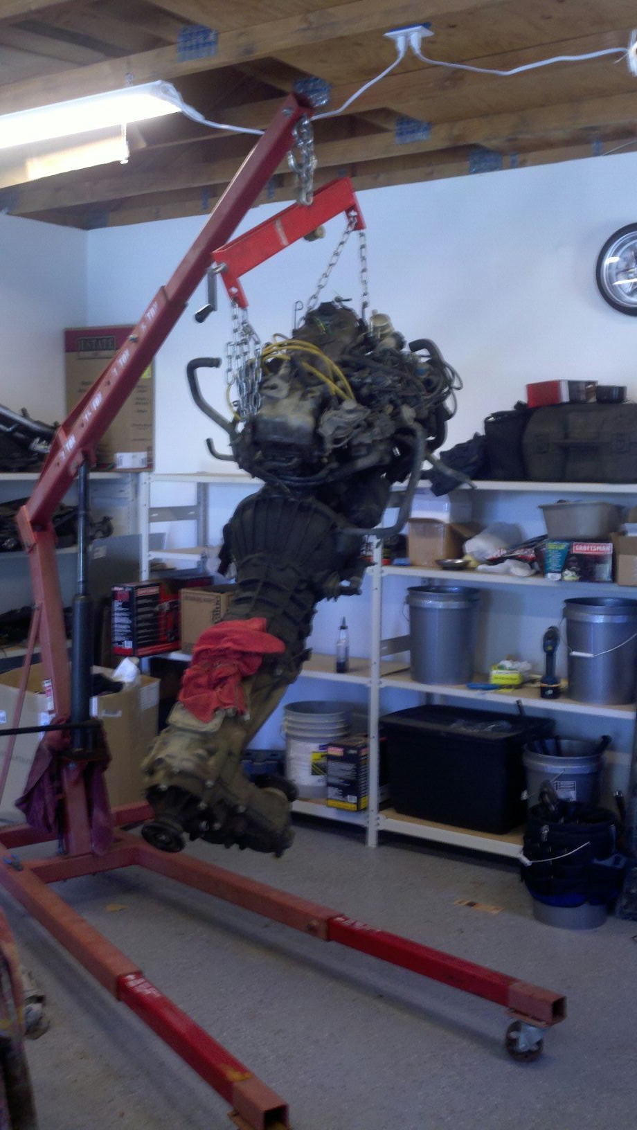

took week off of work to rip engine out and get it built by a toyta freak in Napa. and got boxes n boxes of goodies for my baby.

got my engine back from machine shop, block was already bored .40 over so got a newer block and .20bored over

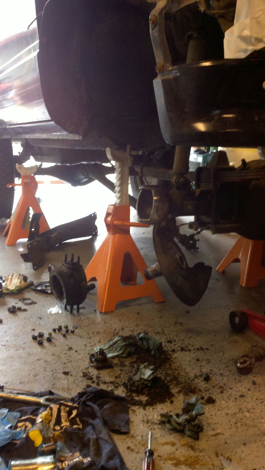

got front axel torn down to knuckle balls and now gotta degrease everything and weld my gussets on.

got my engine rebuilt last week and its sitting on the crate in garage. and got the front axel completely tore down and tomorow pressure washing it before i rebuild it...
so with the shims... I have 1 on bottom on drivers side and on pass side one on top and two on bottom.... and both my inner seals shot. so should I just place two on bottom and top both sides and do the fish scale test or?

well front knuckle is done and axle is complete both sides and ready to finally put engine in. pics will come soon but work has made this project last way way to long...
