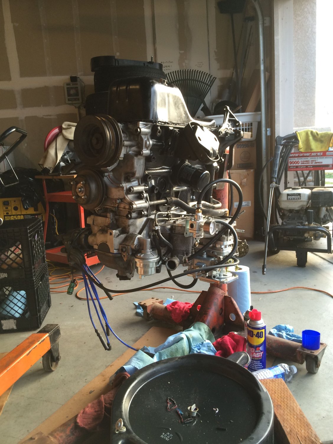

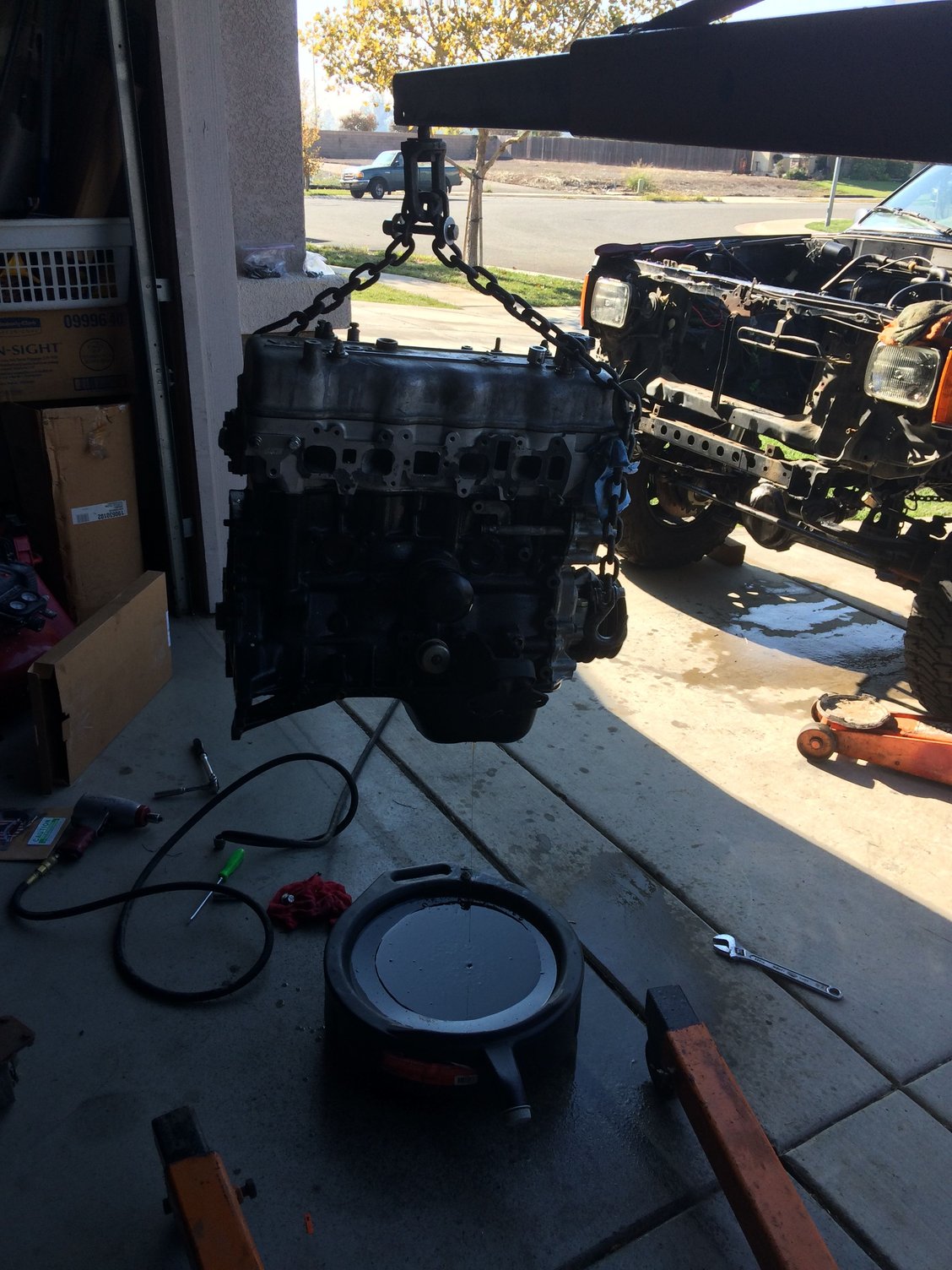

A lot has happened....
I removed the engine and replaced all the gaskets,
Heads, timing cover, front and rear main and removed all the smog components.
Word of advice never ever trust
Someone to do work you can haha.
P.s. I have a rebuilt Asian carb and 99.9% of California emissions components that passed smog for sale now
New inverted 22r lol. I had to really hammer down the oem oil pan, someone pried on it and bent it up... But a couple of brass blocks, punches and a tube of Toyota fipg and she looks sealed right up.

Well been couple weeks since any progress. Mostly becuase the rain and using my neighbors driveway.... Got the engine in and all that's left is:
Fuel line re-routing since I removed charcoal canister
Radiator and checking all coolant lines
Fixing a couple super old cracked out alternator wires
Then:
Remove window: and treat rust
Replace both front calipers, and brake booster and brake master cylinder
Then.... Drive it haha.
