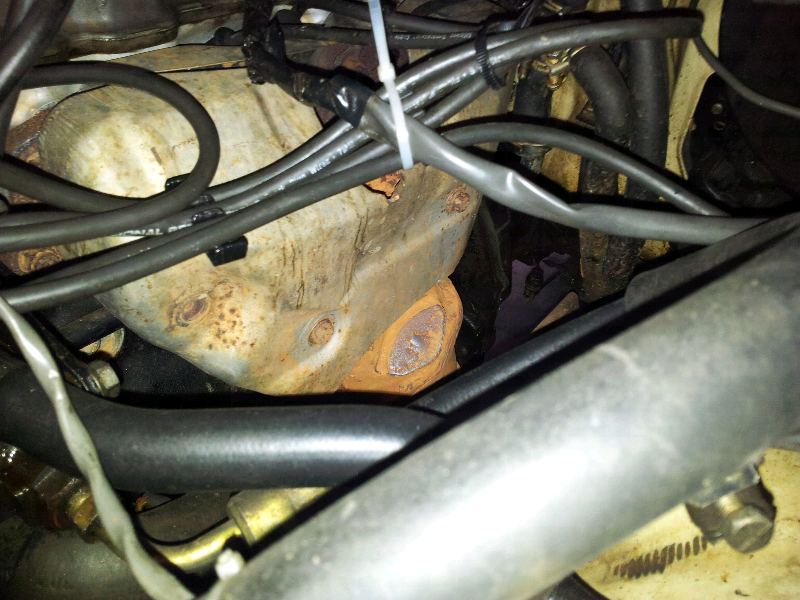

Ok today I opened up the valve cover and check the timing chain and it looks new with metal guides and no rub marks on the timing chain cover. change the spark plugs and wires. But still running like crap! the check engine light was not on but I check for stored codes and got a 2,7 and 8. I unplug the battery to reset the codes then I drove it around and check the codes again and got a 2 and a 8 (AFM and air thermo sensor). is the air thermo sensor inside the air flow meter? wow I was under the hood I was going to check the O 2 sensor and I could not find 1 I did find the plug which has nothing plugged up to it. could this be my problem?

New o2 and manifold
Fixed the bogging issue! Turns out it was the o2 sensor. Got another manifold w/ o2 bung and put a new Denso o2 sensor and runs like a champ now!
This is the old maniflod
and the new one with the bung
