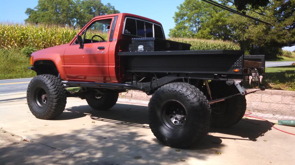

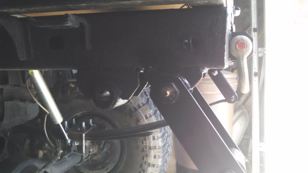

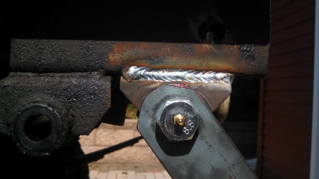

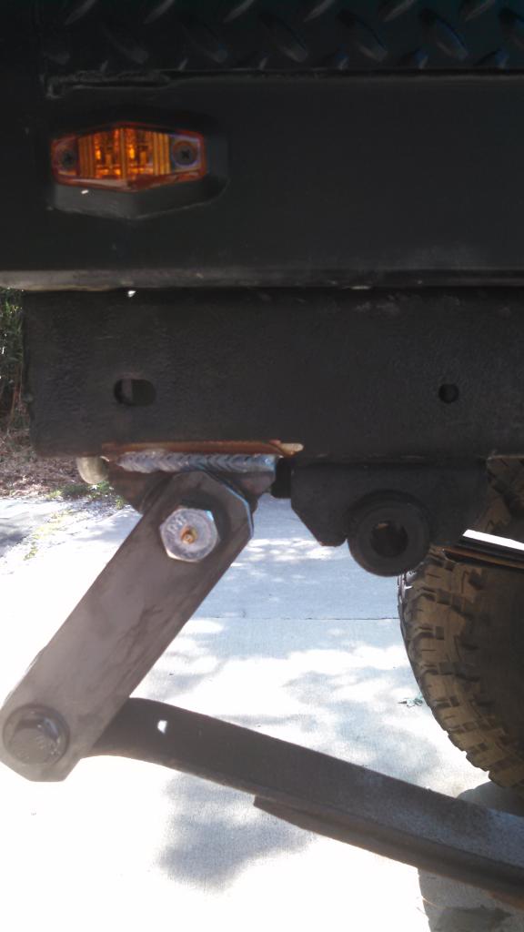

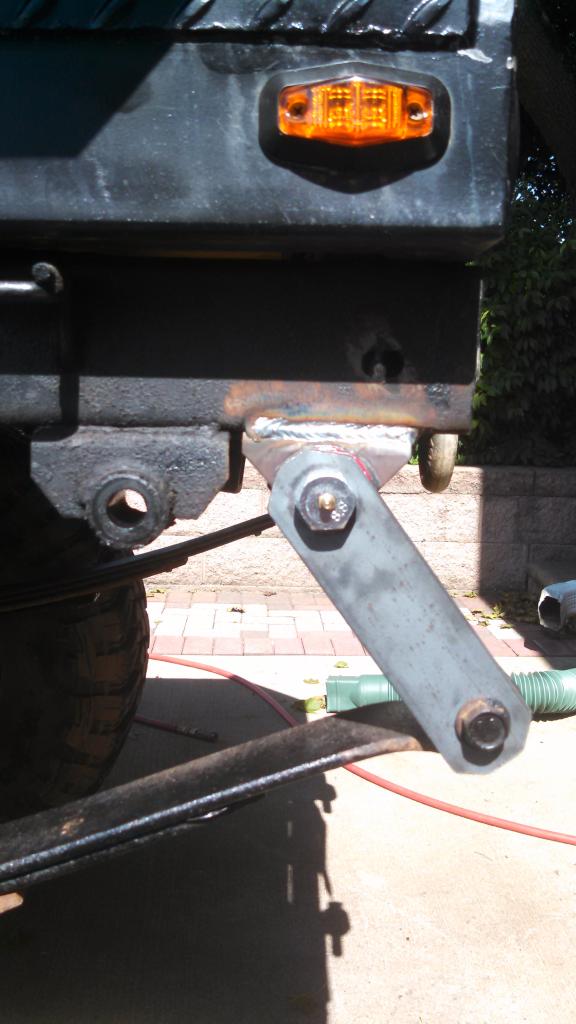

Been slacking on the updates again. Here she is with the single shackles finished up.

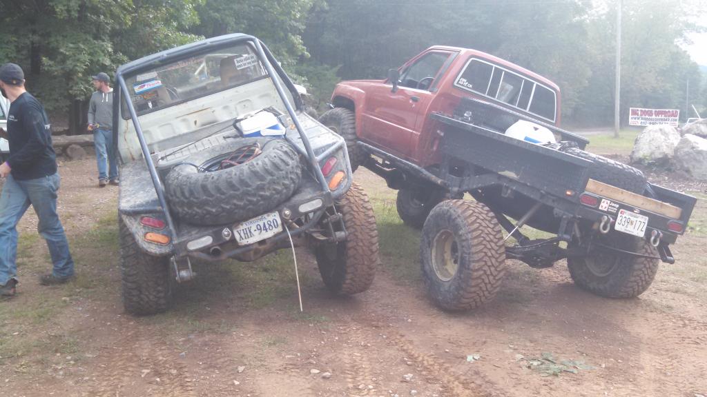

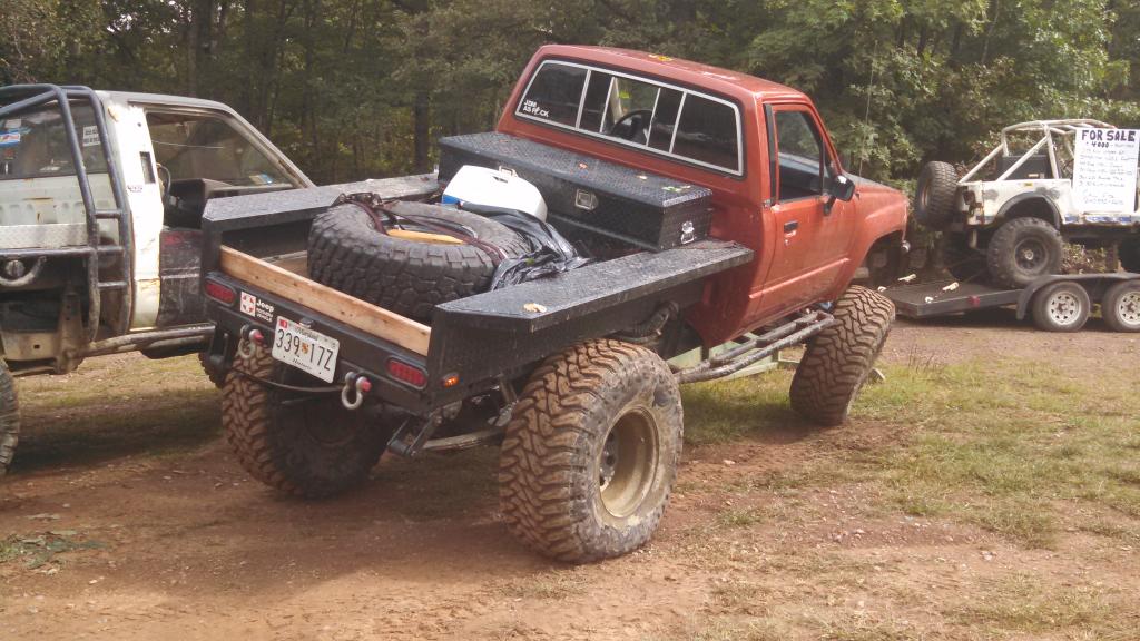

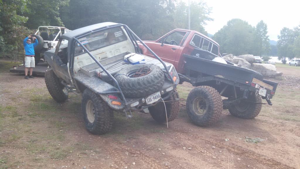

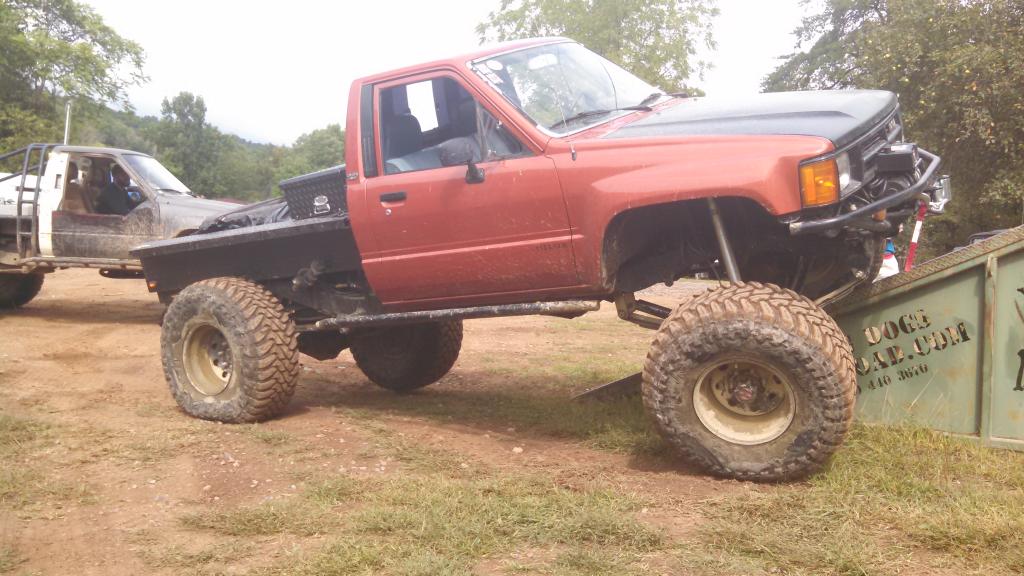

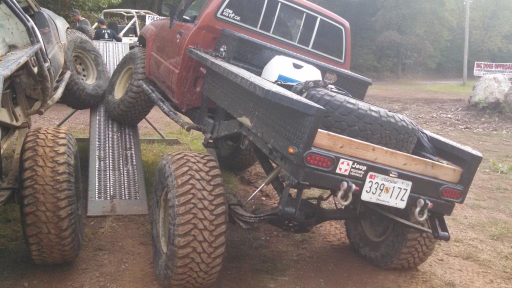

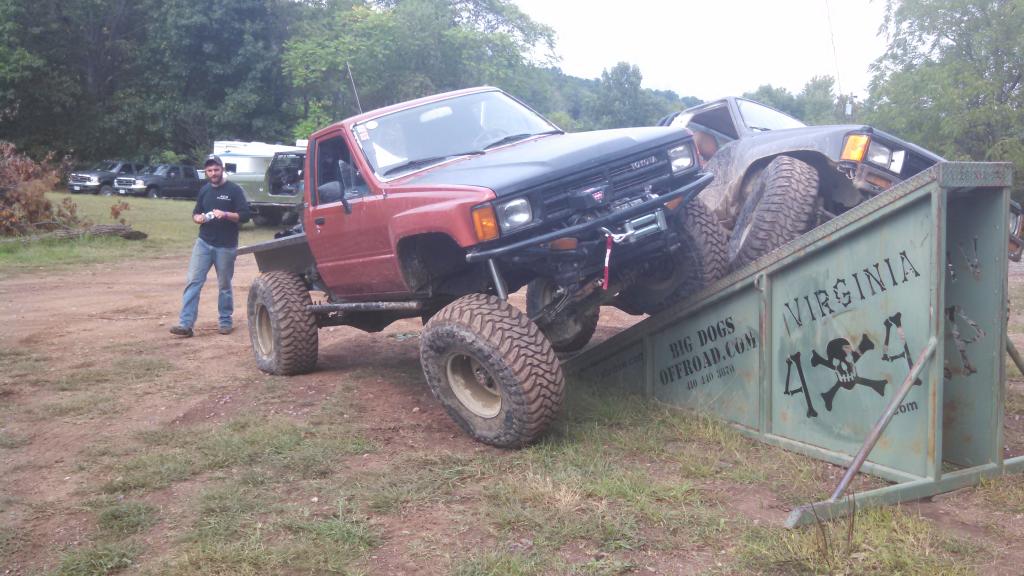

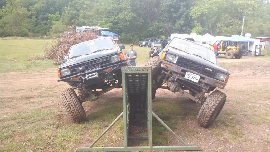

Went wheeling at the cove in Gore, VA again.Name:  IMG_20140912_130717_103_zpsfrbryvr8.jpg
A little comparison for you. Both trucks are 1985's. Truck on left is short wheel base with 37's(mine is long wheelbase with 35's) with Chevy 63's and double shackle in the rear. Front is 2nd gen RUF. Without his double shackle, the our rear setups would have had the same flex but you can see his RUF is better than my 3" TG springs.

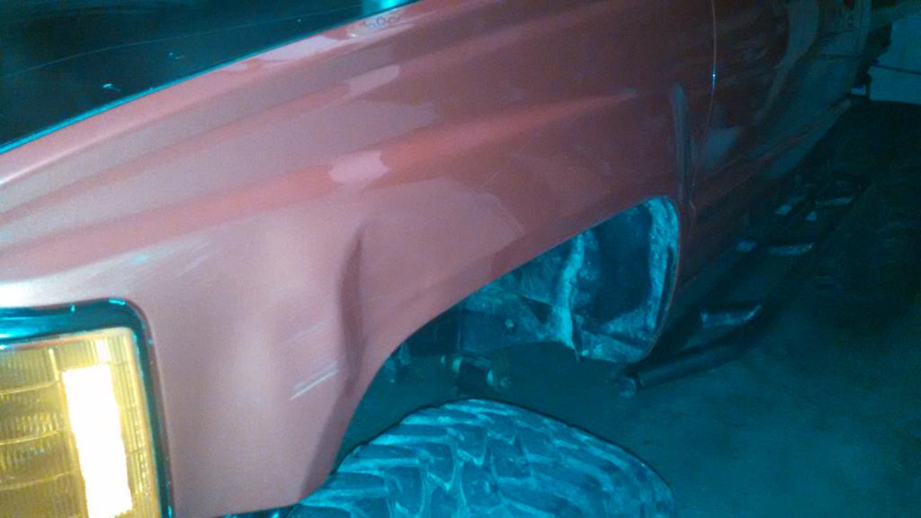

Oh yeah! I got my first wheeling dent last Saturday at Red Cloud. Its all down hill from here
