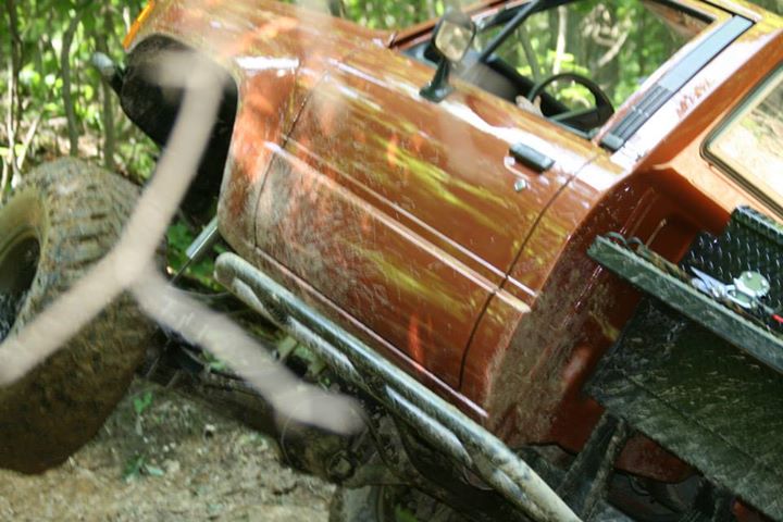

The only pic of the near end over end roll over on Squealer

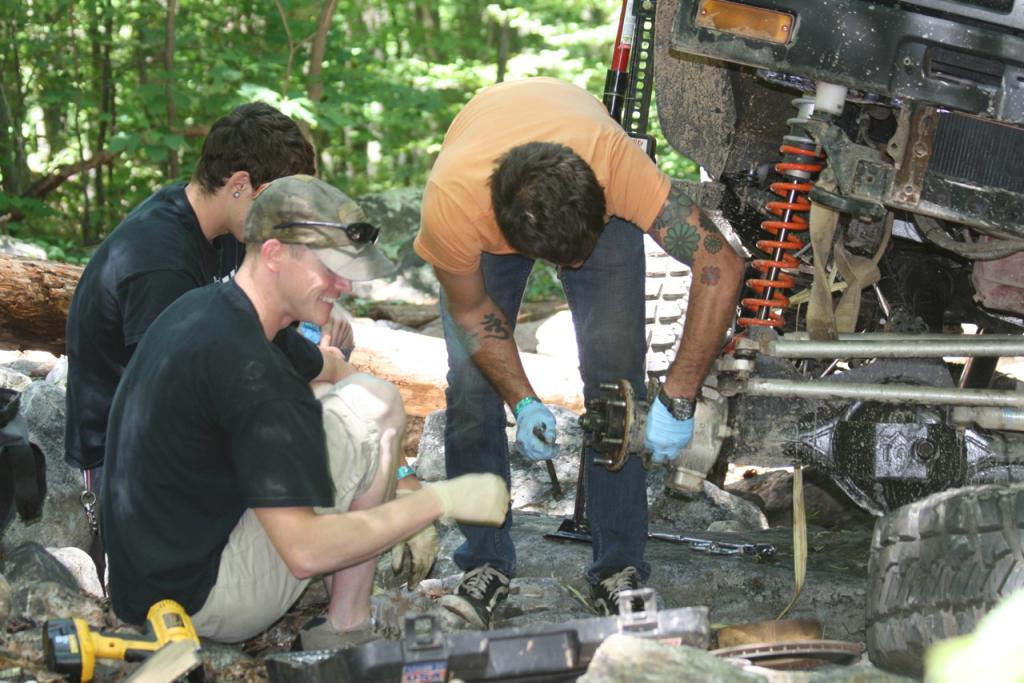

RBX and I tag teaming an exploded birf replacement with NASCAR speed.

Always a good time. We probably could have had the birf changed out quicker if I remembered how to disassemble the FROR Taco Brake adapter...DOH! Next, some RCVs

I think we did OK for a couple of Wahoos who haven't a clue. The trail repair was one of my favorite parts of the weekend.

^^^ agreed, as much as I hated being 'that guy' it was über cool to do the field repair in so little time. Traffic didn't help the restart. Good times. Thanks man.

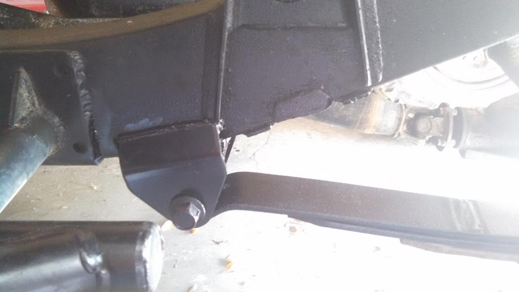

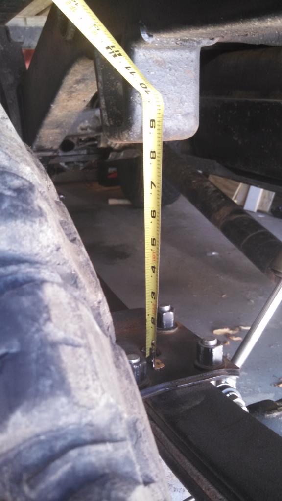

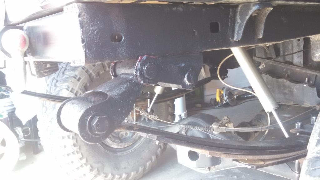

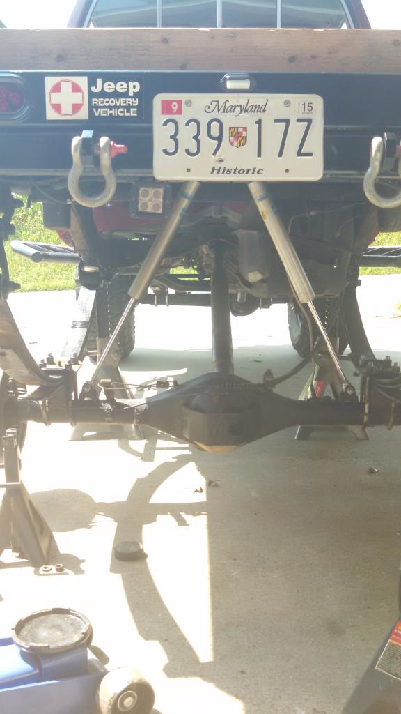

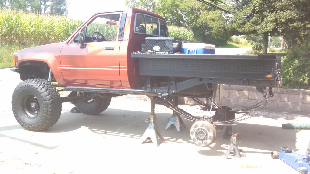

Old Sep 1, 2014 | 04:13 PM
  #131
FailRated's Avatar
Joined: Sep 2013
Posts: 97
From: Baltimore, MD

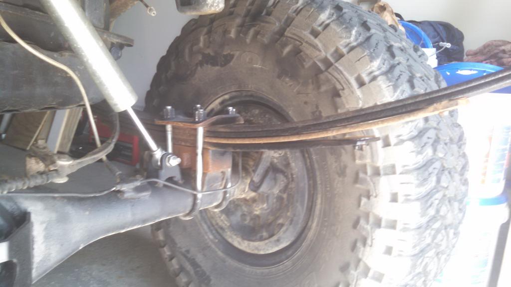

As you can see my stock rear leaf packs sucked balls...
...so I got some 58" 97-03 F150 rear springs
Front spring eye to center pin is 26"
Rear spring eye to center pin is 31.75"
The front spring hanger had to be moved forward 5.5"
I'm temporarily running a dual shackle setup until the new shackle hangers arrive this week. The F150 shackles fit nicely into the stock toyota shackles with new toyota bushings installed in them. The terrible shackle angle is probably causing me to lose an inch of ride height.
A shot of the pack with 2" block. Once I get the shackles setup properly I should be able to step down to a one inch block or no block. You can see the one unpainted leaf I removed initially is reinstalled here.
What it looked like with the third leaf removed with 2" block. A little low in my opinion so I put the leaf back in which raised the rear 1-1.5"
Current ride height measurement for reference. With the dual shackles this measurement is 17" at full droop.

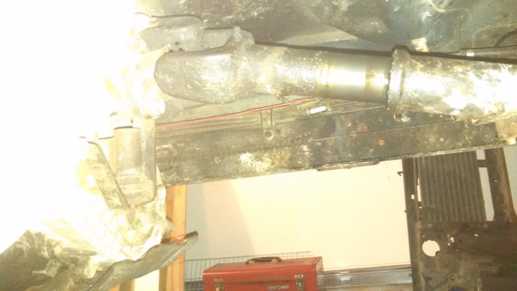

Old Sep 1, 2014 | 05:12 PM
  #132
FailRated's Avatar
Joined: Sep 2013
Posts: 97
From: Baltimore, MD

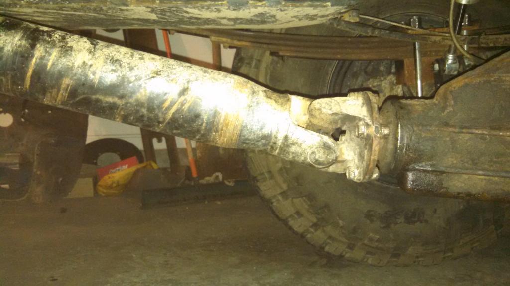

So I've had a jingling/groaning sound during deceleration above 45 MPH for a while now. When I drove the truck sitting low in the rear for a day the sound was gone completely. After I threw the leaf back in and raised the rear up to where I like it, the sound came back. I'm assuming my drive shaft angle is to blame. I have the ujoints at opposite angels like you're supposed to if you're not using a double cardan. So my question is I have an extra front driveshaft with a double cardan and an extra rear driveshaft from a manual trans truck that's about 2" too long. Do you all think I can have a drive shaft shop put the double cardan from a front shaft on my extra rear shaft and fix this problem? Is that a good/bad idea?
Old Sep 1, 2014 | 05:16 PM
  #133
RBX's Avatar
RBX
Joined: Jan 2010
Posts: 3,795
Likes: 33
From: Bloodymore
Pinion and transflange need to be same angle unless you have a cardan.
Old Sep 1, 2014 | 05:30 PM
  #134
FailRated's Avatar
Joined: Sep 2013
Posts: 97
From: Baltimore, MD
Correct. They are.
Old Sep 1, 2014 | 05:38 PM
  #135
FailRated's Avatar
Joined: Sep 2013
Posts: 97
From: Baltimore, MD
Pinion angle
Transmission angle
Old Sep 1, 2014 | 05:52 PM
  #136
rattlewagon's Avatar
Joined: Oct 2009
Posts: 4,832
Likes: 332
From: Northfield, Vermont
Blocks and double shackle? Any axle wrap?
Old Sep 1, 2014 | 06:04 PM
  #137
FailRated's Avatar
Joined: Sep 2013
Posts: 97
From: Baltimore, MD
Lol none that I can tell. But I'd bet my 22re makes 80 HP and the double shackle will be gone next weekend
Old Sep 2, 2014 | 09:55 AM
  #138
rustED's Avatar
Joined: Sep 2010
Posts: 2,716
From: Tri-Cities, Wa
That's what I did on mine, but if you use the double cardan joint you'll have to cut the spring perches off the axel and and rotate it up so the the pinion flange is pointing at the T-case flange.
Old Sep 7, 2014 | 09:52 PM
  #139
775Toy's Avatar
Joined: Dec 2011
Posts: 415
From: 775 Reno Nevada
Look for blocks with built in degree , or if your blocks are steel look for some steel degree shims and weld to the blocks to get your driveline angle correct.
Rusted is correct. To properly run a double cv your rear pinion should point @ transfercase flange.
Truck looks great & looks like it wheels too.
