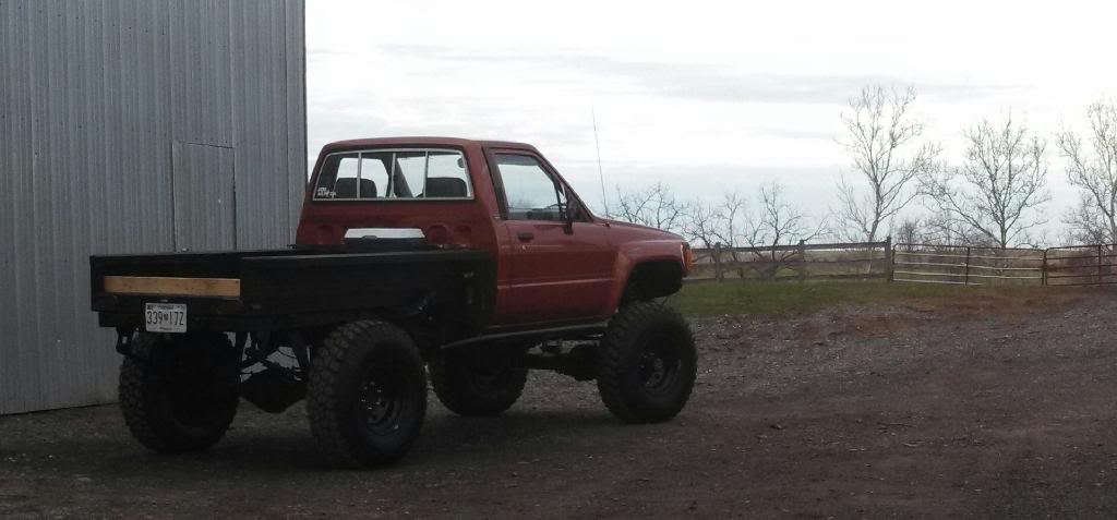

Went on a couple hour drive to a friend's farm this evening. The new suspension and steering seem to be in good working order.

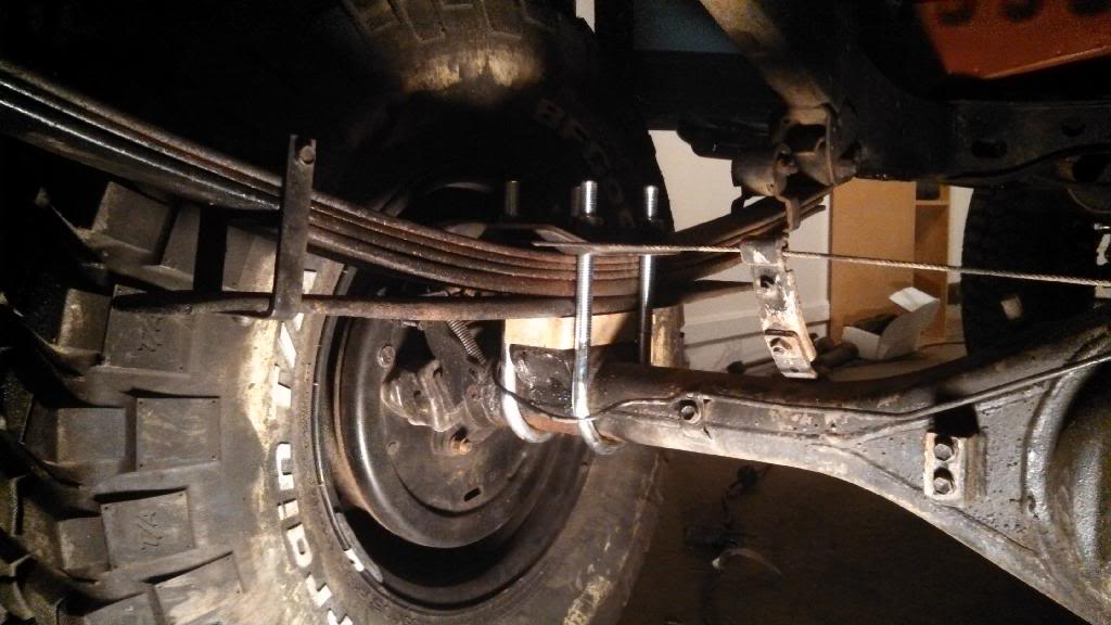

In other news, I got the rear u-bolt flip done tonight. While I had it apart, I threw in a set of one inch blocks I had laying around to help bring the rear up temporarily until the decision on rear suspension is made.

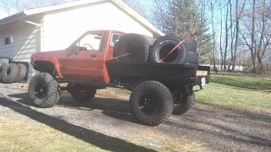

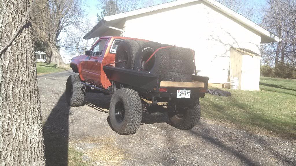

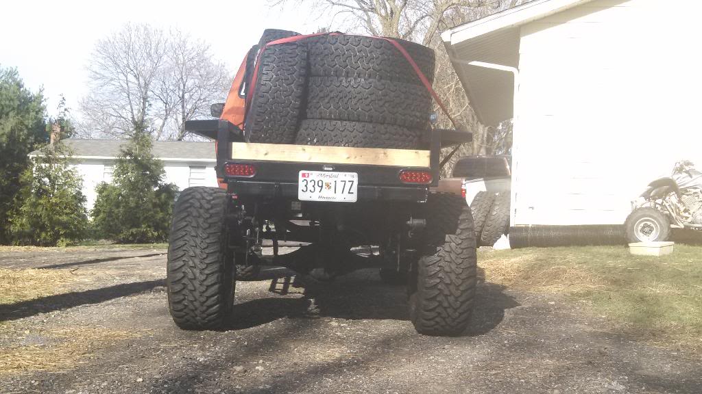

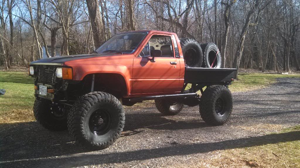

Got some used 35x13.50 Toyo MT's mounted up today. Definitely need to get my wider rear axle swapped in and get some front spacers ASAP!
