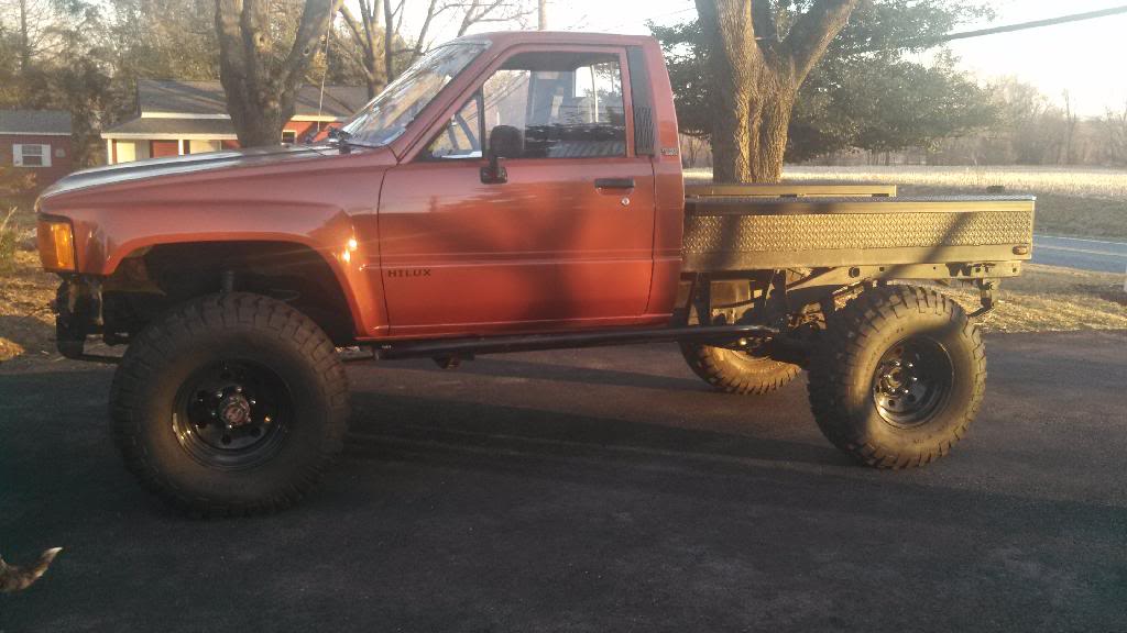

Back from the body shop! Fred Frederick auto body in Laurel did a fantastic job. I dropped it off for frame work only but they went ahead and realigned the entire front clip and core support too. The truck now drives just like it did before. Great service and quick turn around. I may start on the tailgate/tire carrier tomorrow. So much to do before our April 26th Gore, VA trip.

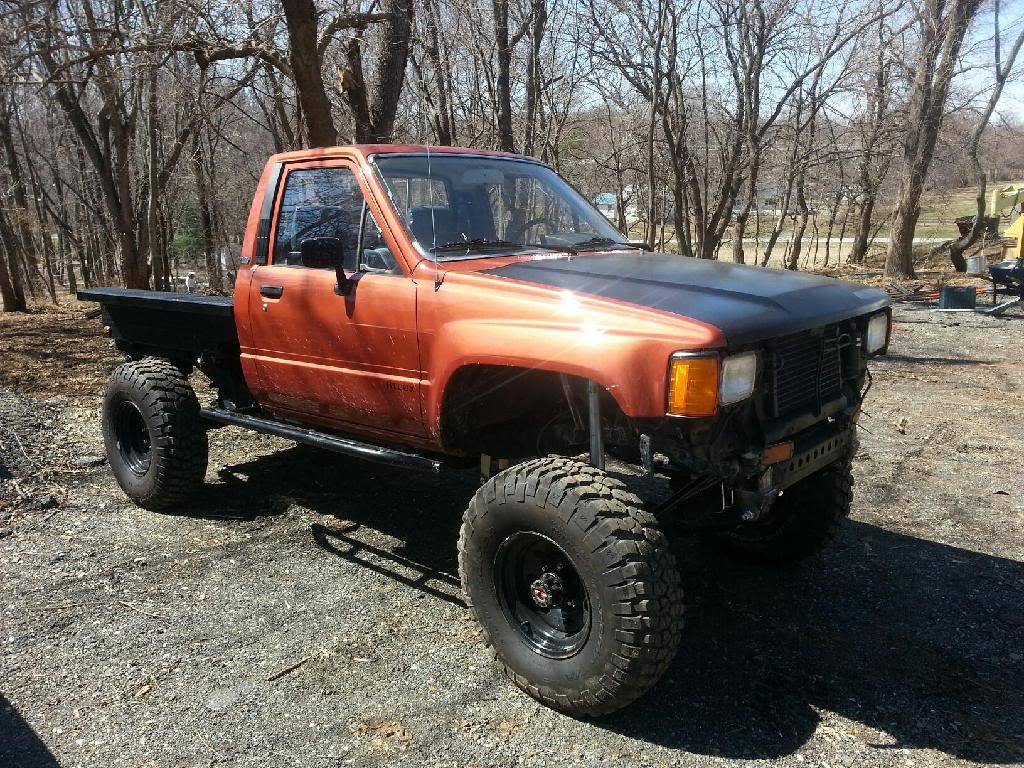

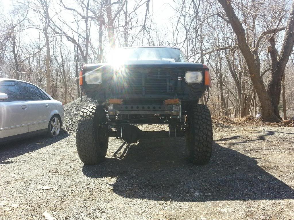

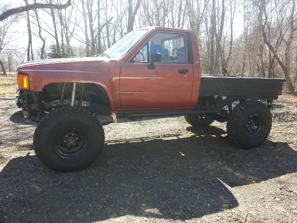

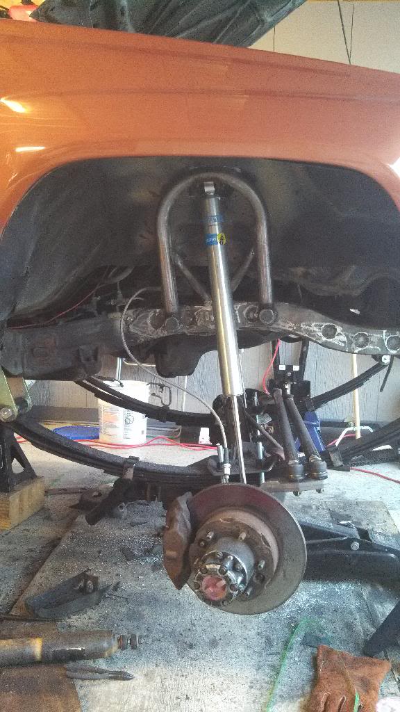

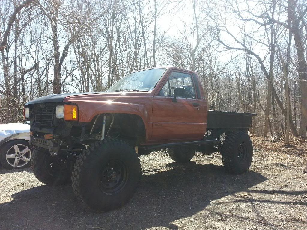

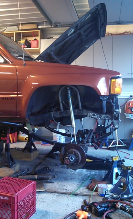

It was a busy weekend!
-TG Front 3" springs(keep in mind I have a 1" body lift)
-TG spring hanger
-TG high steer
-U-bolt flip
-Frame plates
-13" shock hoops
-14" stroke 5125's
-'86 IFS steering box
Now I need my front drive shaft lengthened and I need to decide what to do in the rear. Any suggestions? 56" S-10 springs? 63" Chevy springs? 3 link?

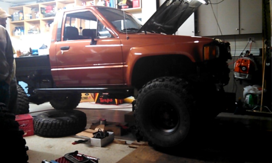

test fitting a 37x12.50

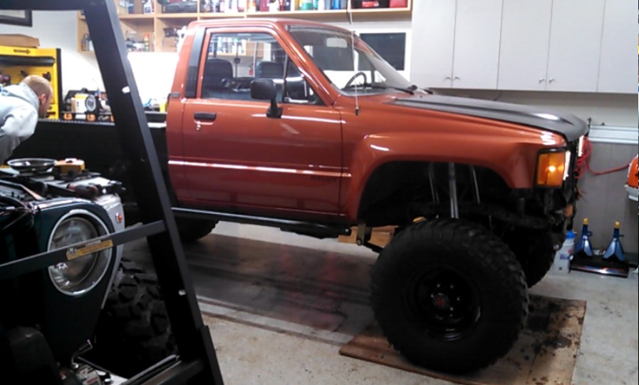

33x10.50s

Nice work, truck looks tuff! Really looks like a beast with the 37's on there, look like you had plenty of clearance with them!

Looks great!! 3" gave it more than I thought it would.
Thanks. I wish the 37's were mine. We just threw one on to see how it would look. I got a set of 35's to run for a while until I get shafts up front. The next set will be 37's for sure. I'm also expecting it to settle quite a bit with bumper, winch and motor swap.

Agreed. But once I started thinking about it, the new front spring hanger combined with the required longer shackles give another 1-1.5" of lift. I'm really glad I didn't go with the 4" springs.
