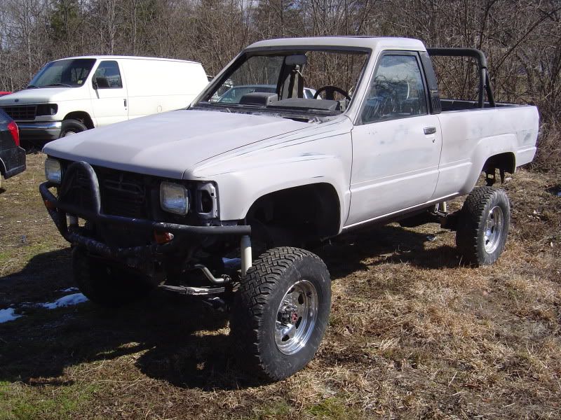

The first one I bought was a really rough 1987 SR5. It had a 3.0 auto (that had been removed by the previous owner) and quite a bit of body rust. But I picked it up dirt cheap, so I bought it. Here's Fred:

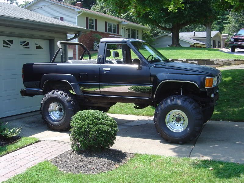

Been a while, fixing lots of little mechanical issues (pinion seal, output seal, new exhaust, replacing weatherstrips, picked up another sunroof, new tail lights, etc). Got the All-Pro rear bumper on, rebuilt front axle. Got s new windshield installed with rubber gasket too. Still have to install temp, oil pressure gauges on the A-pillar mount and rebuild Aisin hubs. It will never be done, but I love it! First coat of wax (after clay-barred) today. Mall crawler driveway shots, but I haven't had him out yet!
And some before and after shots.....same angle

I kind of got the hookup. I wasn't looking for anything too fancy, just wanted basecoat/clearcoat and something that would last. Happened to meet an Allstate insurance adjuster one day who used to paint for a living (in Florida) and he's trying to build a name again to paint as a side gig. He's the one who painted it. He actually painted it better than what I had anticipated.
