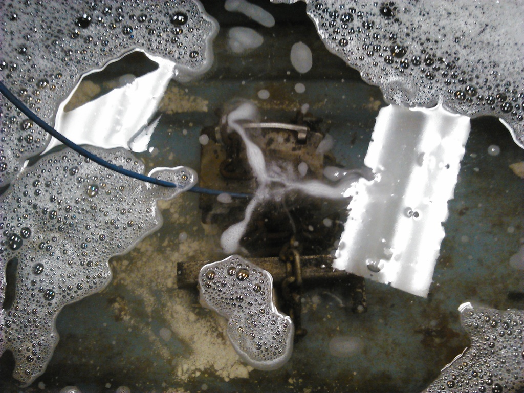

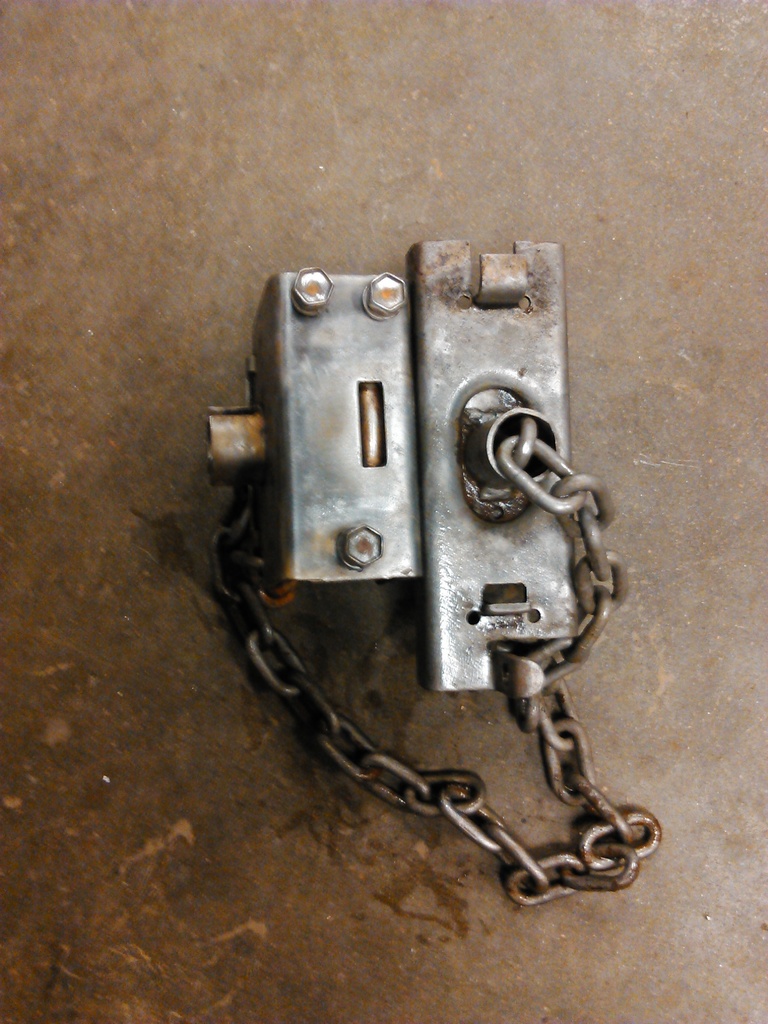

We are getting a ton of rain and more a coming. Not be able to get much done, but I don't have a tire carrier at the moment and I started to clean one up. It was a big chunk of rust but is working great now. I will get it greased and painted here shortly.
Here it is de-rusted, should of gotten a before picture of it but it was bad. One thing I am sure all the other tire carriers I have seen are 4 bolt and I think my truck is set up for 4 bolt. I will just drill a hole into my frame for the 3rd bolt. I know I have two other carriers but just cant seem to find them at the moment. Flash rust is what is showing and happens quick.
Here it is cooking in the tank. The three white stripes is from it getting electrified.

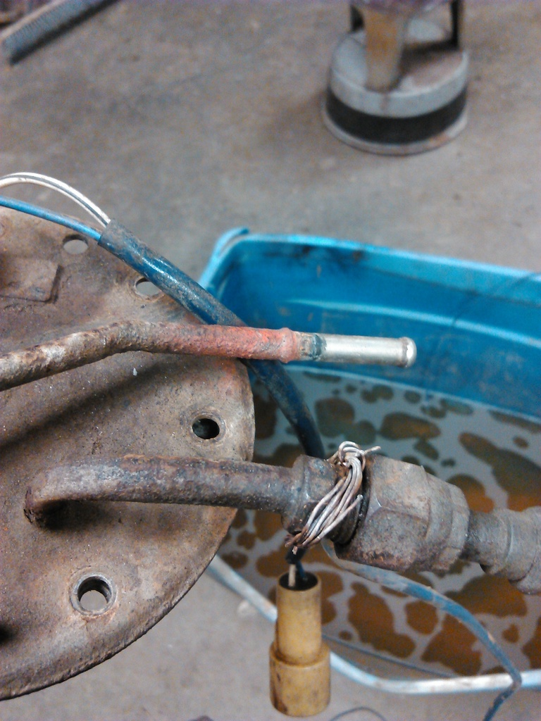

This is the fuel pump bracket off of my 85 when it was fuel injected. I am trying to get it to separate at the connection as it is rusted together. This is a hard and expensive part to find. Got it cooking at the moment in hopes of trying to save the bracket.

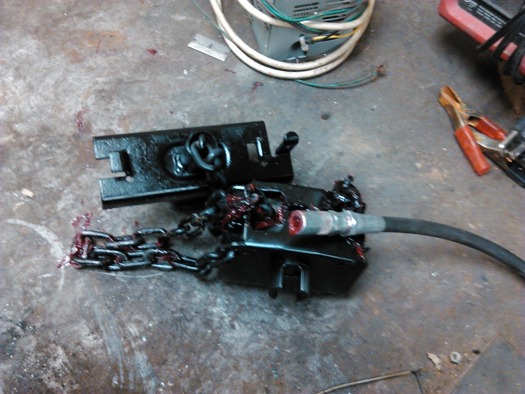

Truck just went over the 2100 mile mark. The miles will start racking up quick when I use it for a daily driver. We have been getting record rain fall and are in a State of Emergency here. Now it is getting cold and was surprised to see snow plows out today. I think I did hear we may be getting some ice so will get to try the 4 wheel out in it later maybe.
I can drive on ice and am able to get around in when conditions are bad. I used to take it as a challenge but now I just want to get from point A to point B as soon as possible. I also will take the back roads to avoid those that try to do 90 miles an hour on bad roads. I trust my driving just no theirs.
This tire carrier was one rusty piece when I started on it. I usually just soak them in PB Blaster or vinegar for a long period of time and can get even the worst ones freed up. The electric tank sped that process up. I got it painted but wanted to show that I use bearing grease before putting it on the truck. It will take quite a bit inside the housing and turns easily now. Once or twice a year, I cycle the tire carrier just to keep it lubed and ready for use. I learned the hard way on a truck one time when I needed the spare.
You will be surprised at how much grease you can get in one of these. I really like how clean the underside is on my truck but the excess will get knocked off eventually.

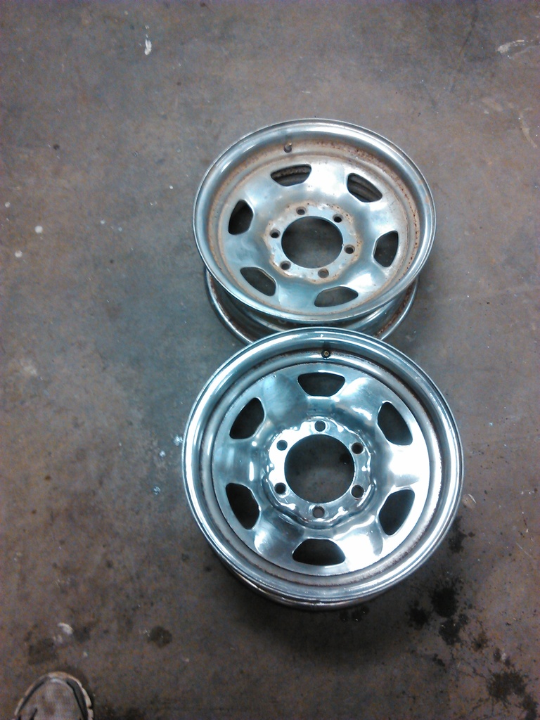

Six hours and a couple of hundred miles later, I finally got a complete set of the chrome rims to have a full matching set. I was originally just going to get one but the guy found out where all I had been and other yards thinking they had the right one he gave me a deal of two for the price of one.
I have started cleaning them up. One I think will just have to be a spare but I will try to make it look as good as possible. I already have a lot elbow grease into getting these to this point. Just one of the benefits of trying to get 30 year old parts to looking as best as possible.
They are in bad shape but think they will look ok. Maybe some year I will have them re chromed or find a better set. A step closer getting the rims. Now just stripes, ac, carpet, and some interior work left.

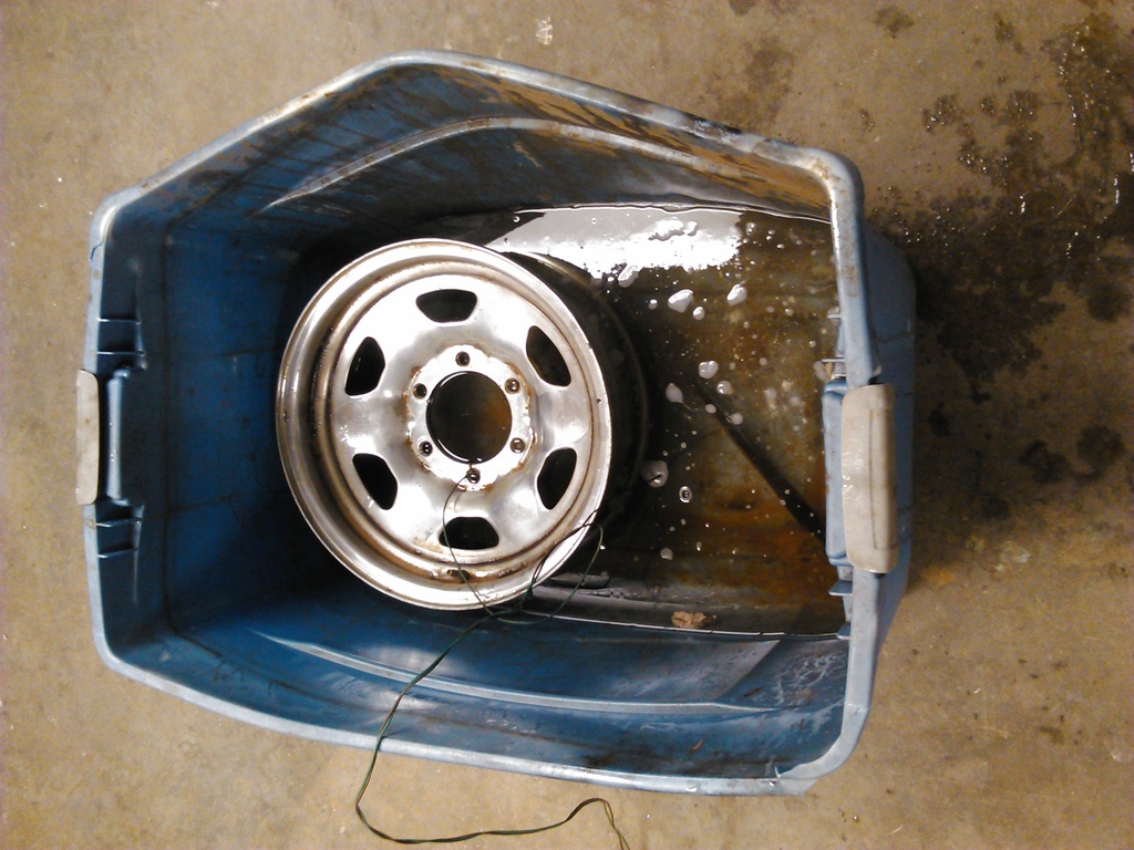

The rim I am going to use full time is cleaning up alright. This one that I have in the electro tank is the one I am going to use as a spare so am not concerned if the chrome can stand up to the electricity. Cyberhorn, could I fully submerse the wheel and get all of the rust? Right now I am just getting the rust on the back side is why it is not completely covered.
