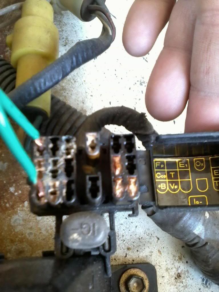

I dont think a 3.0 afm will work but I could be wrong on that, I have never tried it and seems like I have seen others mention about not being able to use them.
Are you getting fire to the plugs? With the fuel pump jumper (should be listed in pic below) I pull the line off of the back of the fuel rail and with the key on it will fill a quart jar in a minute or so to check for fuel isssues.
Is you timing on? Then if all that is good, I see if my injectors are firing. To check that I do the "$3 Noid light thread".
Codes... http://4crawler.com/4x4/CheapTricks/...es/index.shtml
How to get Check Engine Codes. I just put this up for others. Applies to 87 and up. 86 and older is the bottom picture.
The Diagnostic port for the 85-86 is on the Drivers side inner fender and is nothing the same as the 87 and up. Here is T1 and E1 jumped. The codes and engine flashes are the same as the rest of the trucks on the dash.
Codes...http://4crawler.com/4x4/CheapTricks/...es/index.shtml
http://www.youtube.com/watch?v=9qEQM...ature=youtu.be
Here is how you do a Fuel Pump Bypass on the 85/86.
Jumper wire the Yellow Plug on Drivers side. ( Jumper wire should be in both contacts for testing, I just didnt have it in for picture purposes and mostly a referece for me at a later time.)
Fp +B Fuel Pump Test for 87 and newer. Use a paper clip for better results.

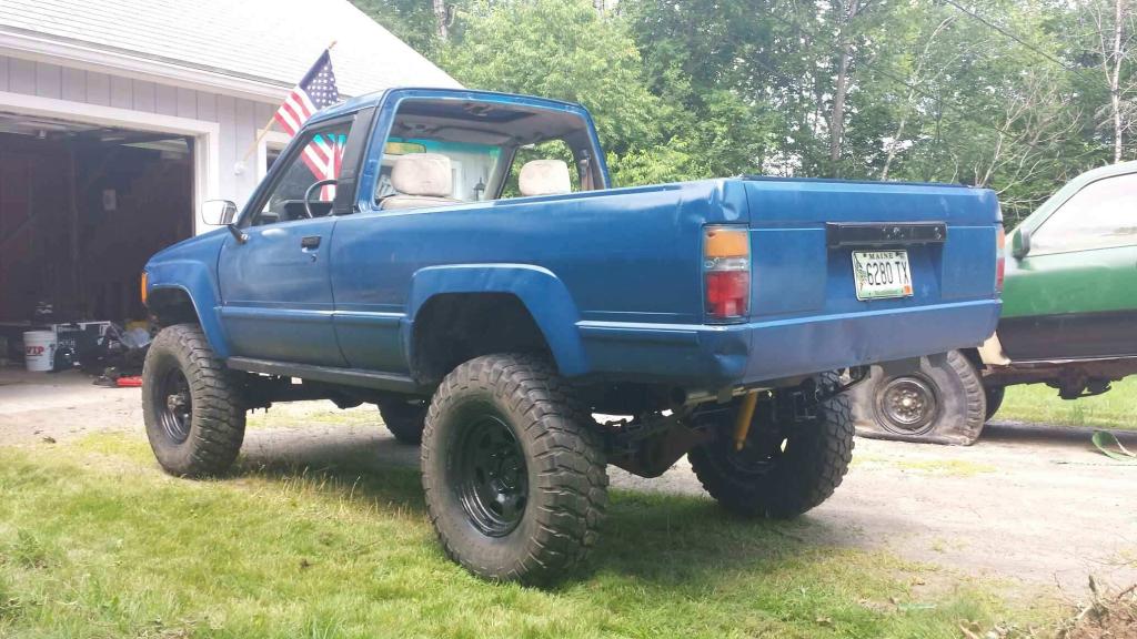

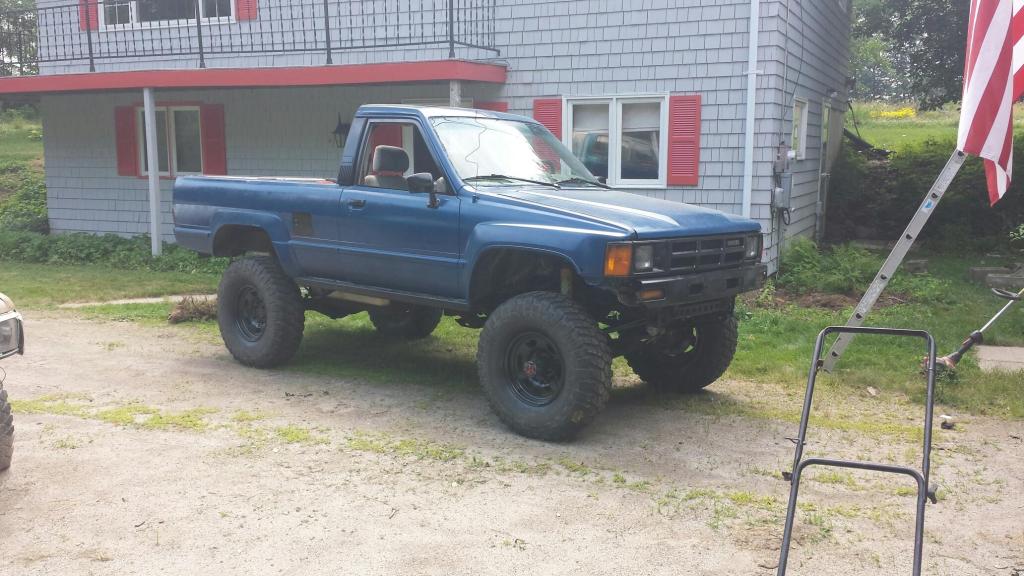

Well it was timing. I took out distributor and rotated engine to tc an put back in where the mark was from washer an bam she fired right up.
Ive been buzzing around in back field. I hate stick. Im not smooth with it at all.
pictures are crappy. sorry camera broken.
I pulled out a bush today with her
more crappy pictures
painted wheels black

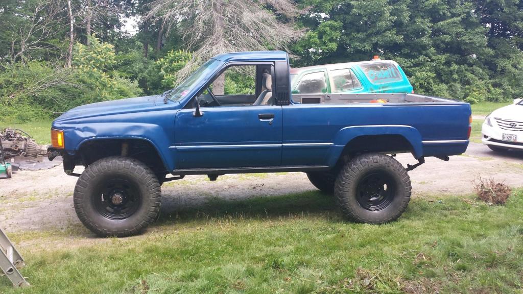

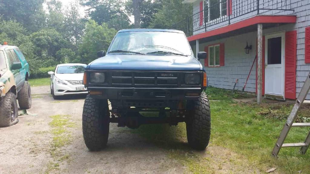

I just gotta get me a dd.
either way heres some pics
