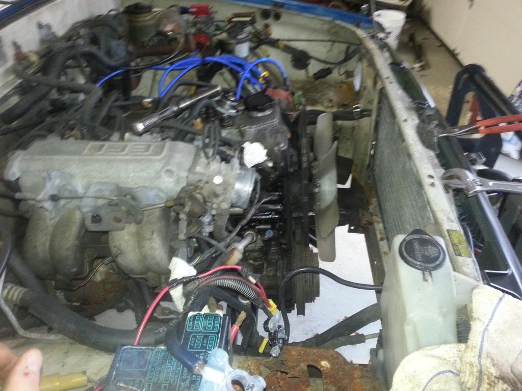

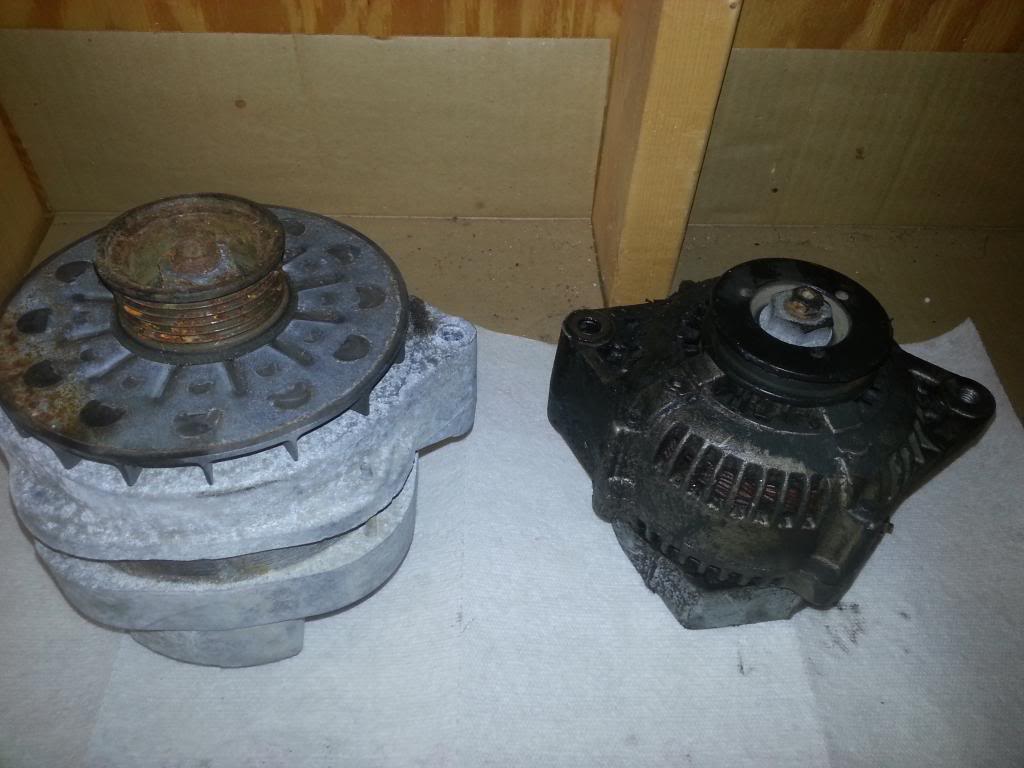

Ok well I took out battery and intake junk. Drained radiator and removed it. Took off belts and took out alternator. Removed old brackets and bam stopped progress.
I leave tmrw but when I get back im put in the gm alternator. New belts. Im take the radiator from my 2nd gen and swap it in. It is exact same size except thicker.
I need to get an elbow for intake swap and some battery cables and the new belts and so on.
The pulley need to be swapped from Toyota alt to gm alt but that's kinda a pain so I am going to just got to a shop and have someone with impact get them off real quick.
Enough gibberish..... on to pointless pics
new vs old..... I bet one will charge better than other

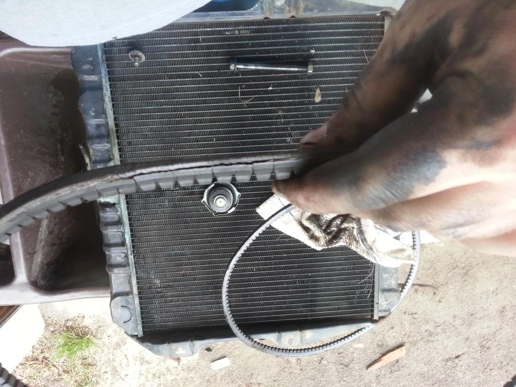

good enough for spares but probably need of a change

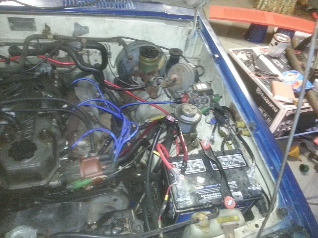

most of this is making it in to the engine bay. Im gonna try find me a supra afm, bit more power.

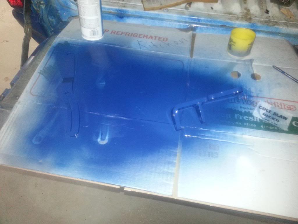

painted the new brackets.

Well ive slowly been doing some stuff. Got the trailgear alternator bracket in and the alternator in. All new belts in.
Battery and intake swapped. Afm wired in and battery hooked up.
I just need to put in a inline fuse on cable that goes from alternator to battery. Swap in the thicker radiator from my 2nd gen parts runner and put on hoses and fill her up.
Oh and put distributor back in and check timing since i spun engine a bit when did the belts.
Old Jun 12, 2014 | 05:40 PM
  #96
julsruls's Avatar
Joined: Jun 2013
Posts: 451
From: Maine
Ok so I hooked everything up. Put it all back together and nothing. Not a lick of power. No lights no nothing.
I ran cable from alternator directly to battery with an inline fuse. I just left the old cable wrapped up.
I thought that I had read that I didn't need to hook it up but I must be mistaken. I jumped from battery to fuse box and had power. So tmrw morning I will run a wire from battery to the old cable. That way I have power to fuse box and don't need to upgrade the wiring.
When I jumped it and had power I tried turning her over but nothing but the battery was almost dead. So once I run the wire well see what happens.

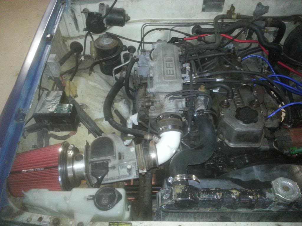

During this ordeal I .....
-put in new radiator hoses (I got the wrong one for bottom so I threw an old one on, once I get correct one ill swap em)
-new belts
-new terminals and new wires
-a spectre filter and afm off of my 3.0 just cause it was attached. I will do supr afm when I find one
-new rad fluid
I was going to swap in the 2nd gen radiator since its thicker but it has additional inlet and outlet. I assume for an internal cooler for tranny maybe??? While I could have just plugged them I started to wonder if it having that in there but not working would effect the performance. Then I thought well maybe ill use them and hook it up to one of the coolers I have on mine but was more work so for now just put the original back in.
Don't mind the intake setup. Im going to find a shorter 90 and am getting new couplings.

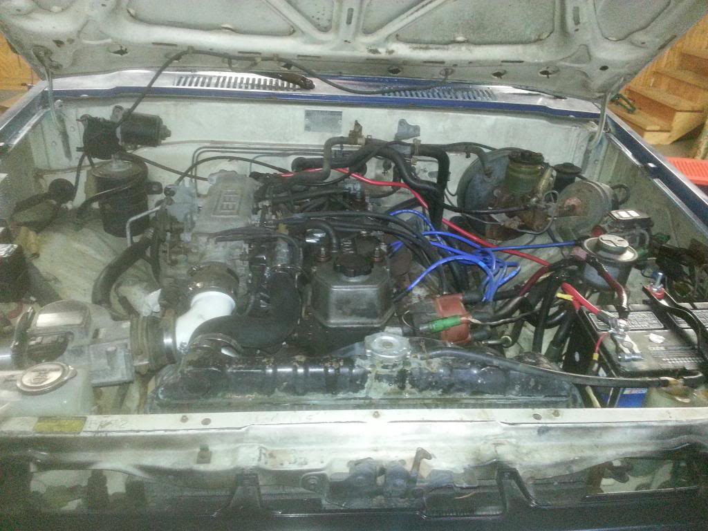

I might mess with wiring some more later but its all solid for now. That's a 140 amp fuse though I might go with a bit smaller of one. Battery is solid now where as was just sitting on other side with bungee attached.
Sorry there bad pics, my phone camera lens is cracked. I like it a bit more than I did before. Still am going to do something about all the hoses. I havnt found a really good desmog thread on 22re yet though.
