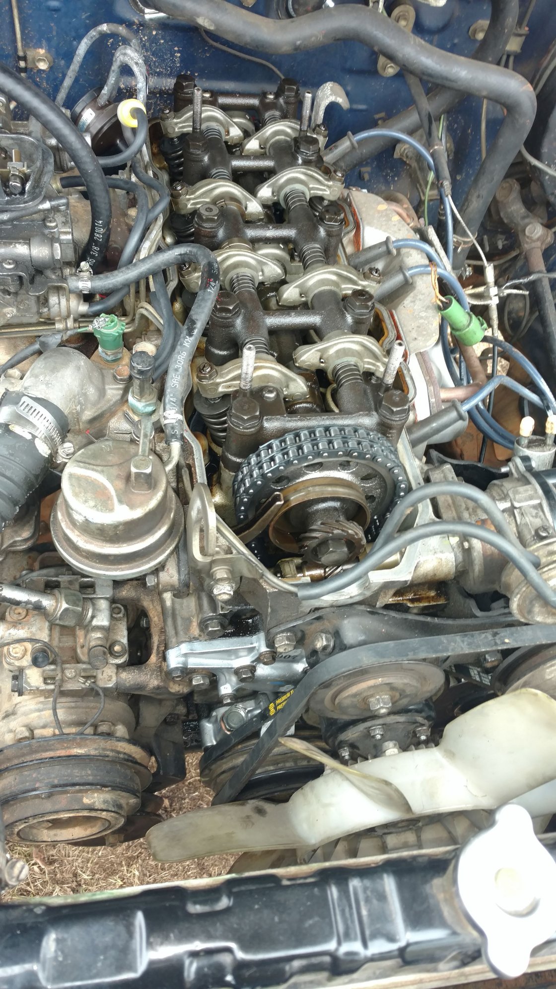

It's running, but I can see a little smoke coming off of the header. I think it's something to do with a valve but every search I've done just takes me to overheating issues dealing with the coolant system. I will borrow a timing light and see if I can zero it in. Good lord I was worried about something happening but this is really really left field.
No there's nothing on the header either, and the truck isn't at operating temperature yet. This is happening after running for a couple minutes.

Link doesn't work for me. But could it just be not all the way sealed. Or some oil residue that's burning off? The last time I did just a timing chain I had a bit of smoke that took a while to dissipate.

Sprayed some carb cleaner on the header and let it run for a little while, the smoke cleared. I'm just paranoid and didn't want to damage anything.
Small oil leak at the oil pan, I've got some fipg on it now and I'm hoping it seals it up.
Truck fires right up with no problem though. Timing is almost 100℅ on point.

Great job on getting it fired up. I still get concerned when I have done some major work to it. Paint, oil, and other contaminates will burn off and make a smell or smoke that can worry you. Just make sure you have your fluids topped off, no major leaks and keep an eye on your temperture for a while. I have seen it take up to 15 minutes for all of the smoke and smells to finally stop.
Another thing is I have let them idle for up to 1/2 an hour and no problems. Then take one for a test drive and have issues. Idling is 850ish but driving your rpm double or triple and that is when leaks can start happening or other things as the pressure increases. Take it on small trips close to your house and have some tools with you. Most time it is something you can correct on the side of the road like tighten up a loose hose clamp or similar.
Congrats on this being your first time and getting it running. Doing things like this is what makes it so addictive. I have fired many motors up for the first time and still get excited each time. You are taking a bunch of nuts, bolts, and parts and then when everything goes right, you get to hear and see them operate.

oil pan leak won't stop.
tried 3 different RTVs and followed instructions each time.
put a gasket on it. still leaks.
puddle of oil has a dab of fresh green coolant sitting in it.
im frustrated as hell. Parking the truck until my 9 day Christmas break where I will be pulling the engine to carefully and correctly redo my work.
I'm thinking I may have disrupted a part of the head gasket, and it's leaking coolant into the pan via the timing cover, and the oil pan leak is letting it out because it floats on top of the oil. This is just a theory. I'm contemplating having the head reworked and using all new bolts, etc.. but still using my LCE chain. I'm sure it's not hurt.

Did you check the timing cover for wear from the timing chain rubbing?Just a thought but maybe not an issue.There is a bolt in the timing cover that does require sealant on the threads.As far as where the headgasket and timing cover meet that should only leak oil if its not sealed good.

Careful having the head reworked. Did you already have it milled? If so how much? If you have it milled again you will probably want to look in to an adjustable timing gear.
I personally won't mill a head. For me if the head needs to be milled I should change out all the valve stems, valves, etc. then I'm going to want to probably do a cam if I haven't already done one. So I just get an engnbldr head setup to what I want and a cam with free shipping.
BARELY touched the cover. Basically scratched it lol
