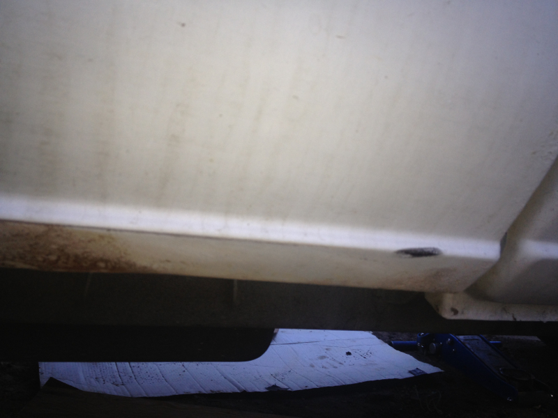

Out with the old and in with the new tomorrow. Pulling the g52 and putting a w56 trans from a 87 4runner. Also doing some sanding to remove some minor surface rust.
Attached Thumbnails 1984 long bed single cab-image-173888700.jpg   1984 long bed single cab-image-3352518369.jpg   1984 long bed single cab-image-1967568431.jpg   1984 long bed single cab-image-1103838700.jpg

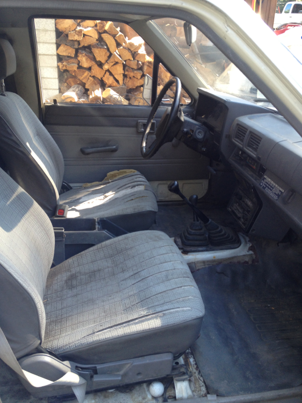

Finally got around to covering up the larger hole that had to be cut into the tunnel after installing the w56. Don't have any pictures of the hole but basically I followed the original shape and extended the opening by 4".
So to make a cover I used an old road sign I had laying around. After cutting to fit the opening shape with some extra lip to put self tapping screwing into. I then cut holes for the shifters. After a couple time of fitting I screwed the plate into place.
I then cut apart the old rubber boot to fit. Since the shifter are further apart now the original one didn't fit. One from a top shift trans probably would but used what I had. Then screwed the rubber boots down(put the screws under the folds to keep out of sight. Think it all turned out pretty good.
Next my girlfriend will be sewing up a faux alligator leather boot to hide it all.
Attached Thumbnails 1984 long bed single cab-image-2633868885.jpg   1984 long bed single cab-image-1329827102.jpg

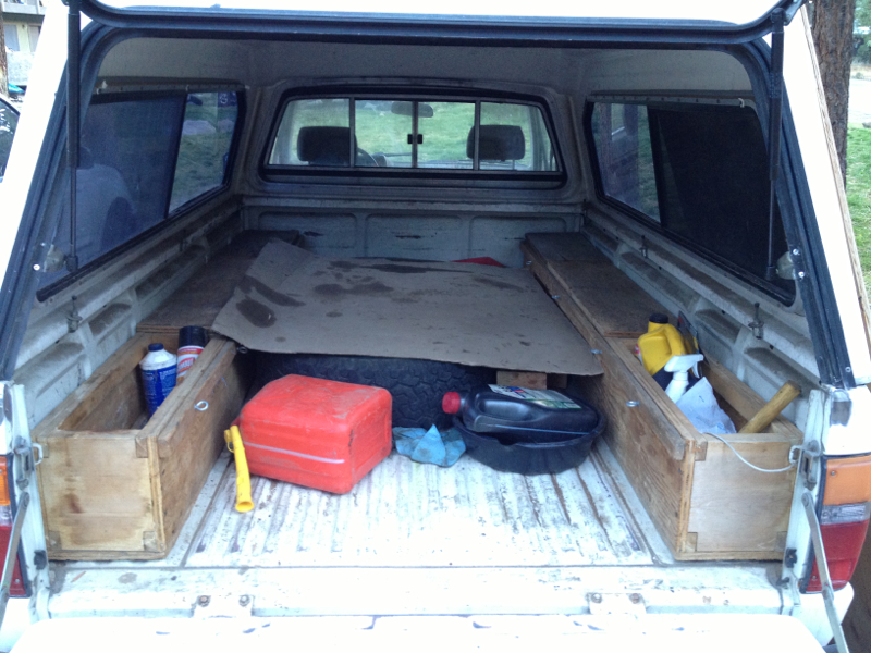

Today after work finished up the bed platform that the previous owner had started to make.
The two sides were already made. So I got some ply wood and some 2x4 and finished it up. Turned out pretty good. Made the whole thing so it can be removed quickly and easily.
The 2x4s are stuck in place by 2piece of ply wood on each side wedging it in.
Attached Thumbnails 1984 long bed single cab-image-2364561093.jpg   1984 long bed single cab-image-3703185865.jpg   1984 long bed single cab-image-3541759096.jpg

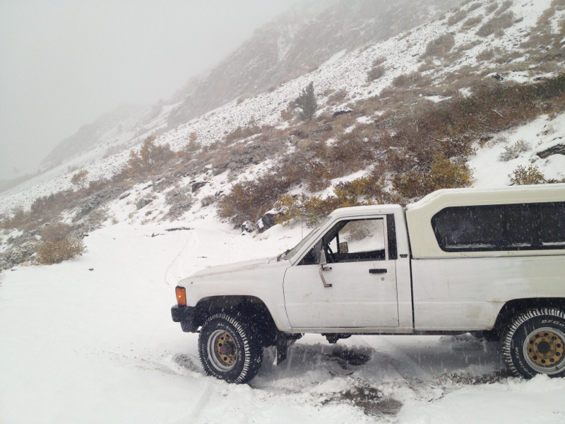

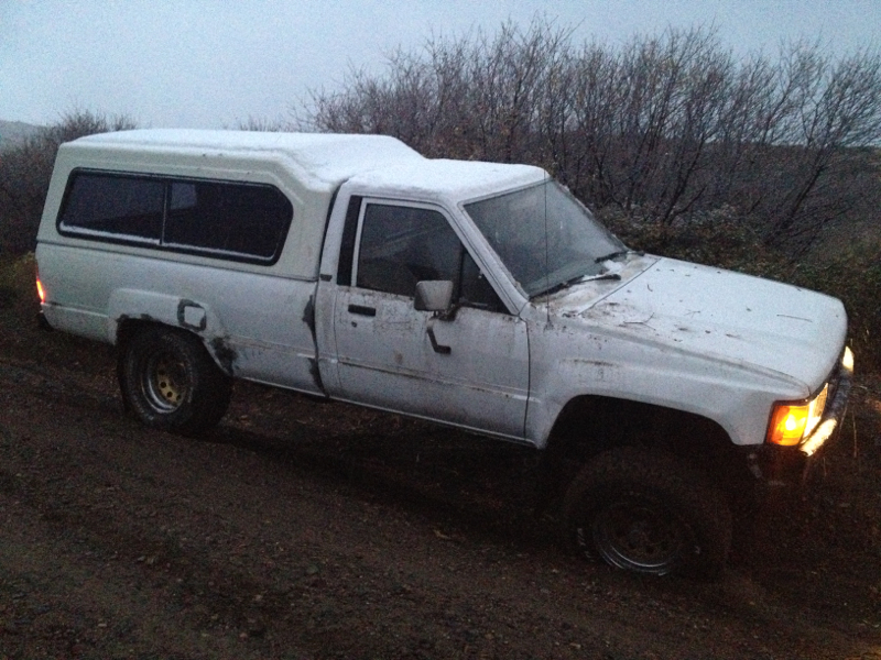

Well we are starting to get some snow so I took the truck out for a little spin. Drove up laurel lakes road here in town. It's nothing crazy but was able to take a couple side lines that were fun. Truck handled everything great. I did manage to rip off the plastic corner on the front bumper. Oh well plans for a new bumper soon hopefully. Also had momma bear and three cubs in the parking lot yesterday.
Attached Thumbnails 1984 long bed single cab-image-3145966989.jpg   1984 long bed single cab-image-4180106290.jpg   1984 long bed single cab-image-1811992668.jpg   1984 long bed single cab-image-3224927117.jpg   1984 long bed single cab-image-2771687368.jpg

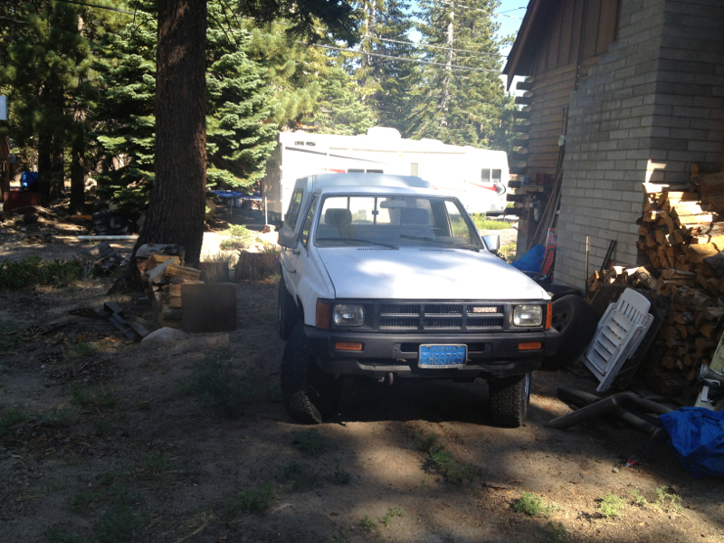

These were taken the day we got it.
[IMG][/IMG][IMG][/IMG]
