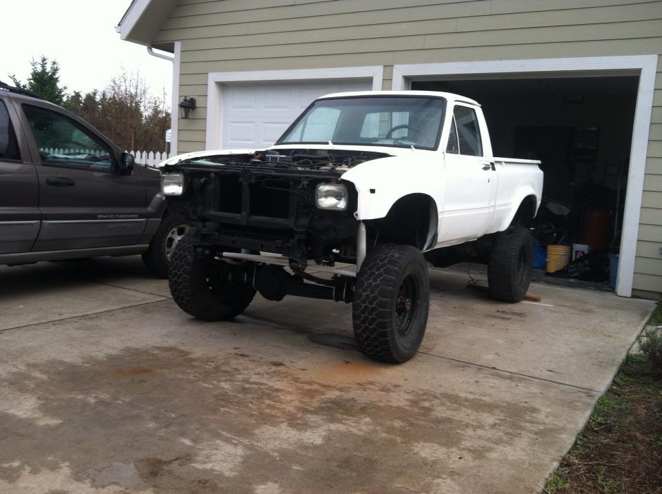

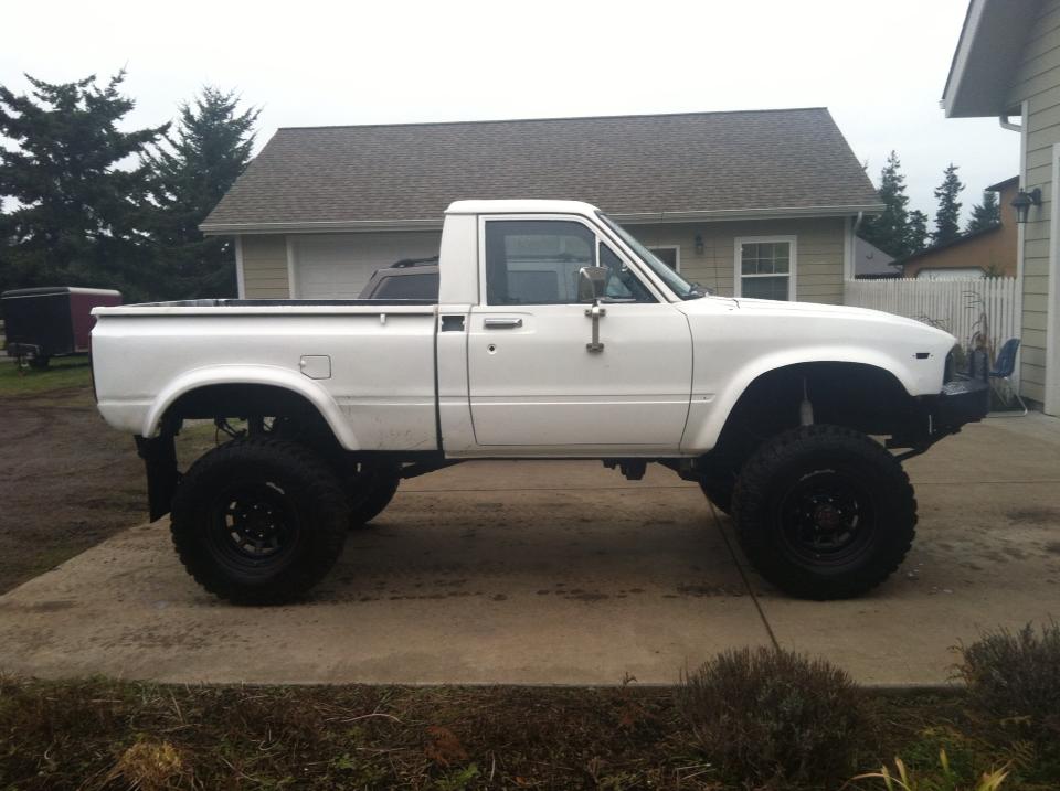

Appreciate The help and the info you gave me on the OME springs , Thought id hop on here and thank you and show you the outcome. I ran 009a's and 009r's with the 5 inch shackles i already had. I had some 6in all pro springs but the stance was ridiculous and way to big for my likings. I had already welded up and installed and ifs box so there was no going back to stock suspension/steering haha
I seen in your picture just as on my truck the rear shackle was way off angle. Did you even get it to straighten out? I am tempted to more the rear shackle hangers in a few inches and see of i can get a better angle, I aint getting any flex from the rear and it is VERY STIFF ! And the rear is sitting a bit higher becasue it is just sitting on the shackles. I am temped to put the stock 3.5's back on also.
Anyway thanks again!
and let me know if you ever got the rear shackle to straight out

The front looks good. The FA's will break in nicely.
About the rear, well funny you should ask, I have about 900 lbs (2 x 55 gallon plastic water barrels) in the back to settle them down. The truck has been sitting because of other projects, but I set that weight in there to see what it's going to do. I would say pull the very short bottom leaf out, put weight in it, and flex it out for a while. And try the 3.5" stock shackles too, or re-drill your new ones shorter.
If my shackle doesn't look good, I'm going to get some rear hangers and move them forward a bit. But I am also thinking of using some F150's and run them reversed, so I can get that 56" spring length. The OME springs are the same part for 4runner and pickup, so in a pickup you have to really load them to get them to work.
