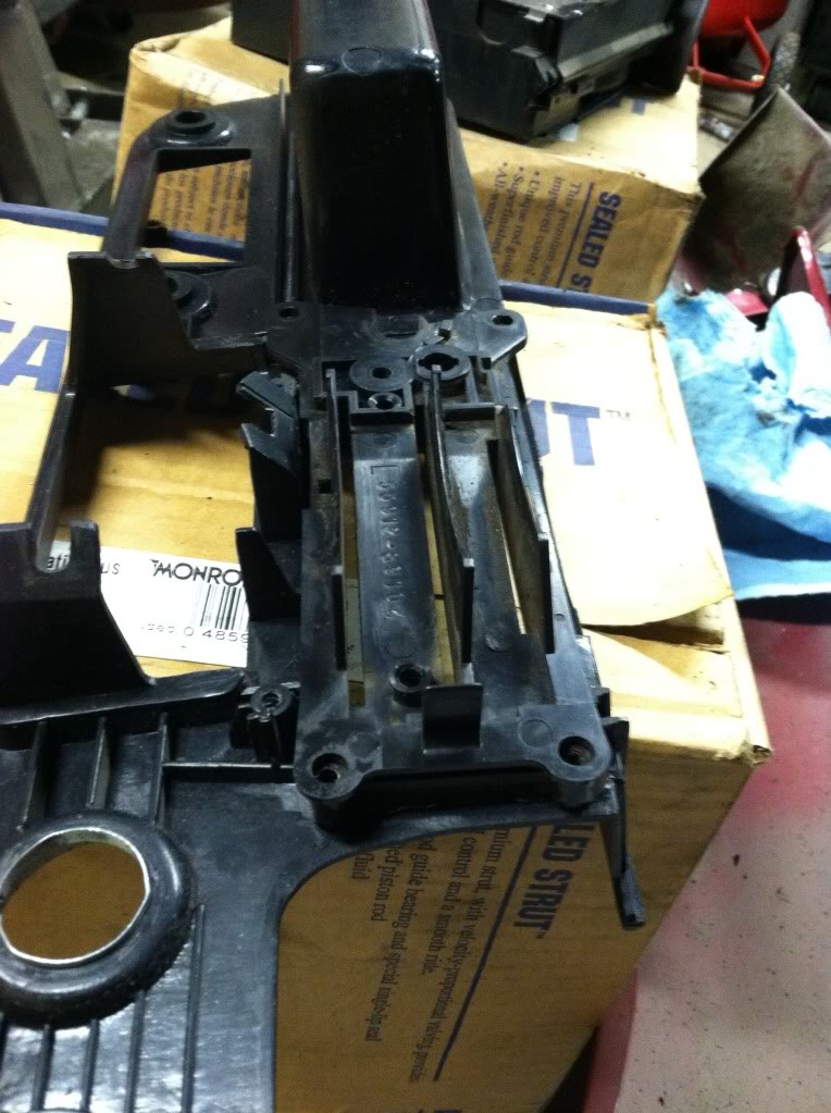

So, I found a junkyard with a few Toyotas in it that I could snag up some parts from. I bought a power steering setup, but Haven't got around to ordering new lines and a belt for it yet, so that will be my next project. Currently I have done a few things here and there.
I went ahead and pulled my shifter out to put in a new seat and end bushing and found this!
Uploaded with ImageShack.us
I cleaned it up pretty well and knocked the burrs off of the ball and retainer with a file and some 300 grit.
This is my shift boot. it was so trashed that it crumbled in my hands after I took this photo. I'm working on stitching another one together right now out of an old pair of pants.
I took the bulb retainers out of the back of my gauge cluster to install some red LEDs, but the green sleeve made it look horrible. So I took my retainers and cut them around the base and left the tabs intact so I could snap them back in and have a nice tight fit for the bulb.
Here is one I cut down.
Here is the finished product. I changed the one behind my two smaller gauges too, so now the whole thing glows a nice mellow red.
This gauge was my next project. I couldn't stand it!
Here it is all apart. I took my swiss army knife and gently pryed up the edge of the chrome surround on the back to take out the glass and plastic.
This is the destroyed ring that came out of the gauge.
So, I glued a few of the rings around the outside diameter of the face to support the glass and used a leftover turn signal lens seal that I found left over from my 84 build last year to make a sealed rubber ring for the glass.
This was my end result. You can sort of see the plastic chunks peeking out from the edge of the chrome, but the gauge is now readable again.
And here is a few photos of my junkyard bounty from Friday.
The fan and climate control setup is a little different from the one in the truck right now, but I think I might go and pull the climate controls from the 2WD and see if I can make them work in the 4WD.

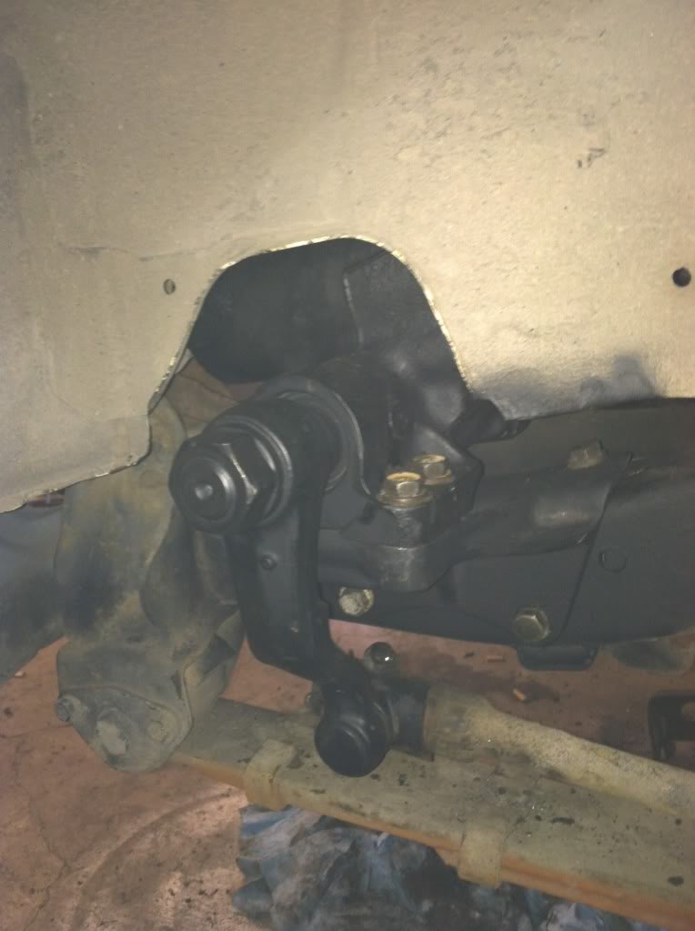

So, I have made some progress and found some problems recently. Photobucket issues have kept me from posting any photos until I downloaded the mobile app for my iphone. Anyway, here are some updates on my ridiculously slow build.

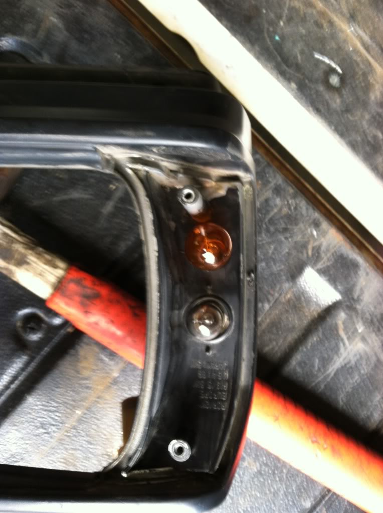

I actually found an extra set of turn signals from my 84, so I decided to relocate my signals into the corner markers!Name:  C919DF27-5CF3-429C-8CCB-3AF8C11F3A53-37663-00002967E29A1EE1.jpg
I really like the end result, whoever came up with this mod is awesome.Name:  4A9C26DE-95E6-4169-97FF-7D6B2EE83854-37663-00002967EEA1C835.jpg

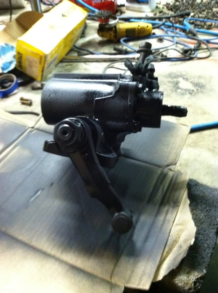

So next I decided to blast off all of the rust from my push pull box while I waited for my high pressure line to come in. Its just until I do real suspension work down the road, the I will put it crossover and an ifs box.Name:  46120FFF-64F8-4FB9-9C79-A75034D891F6-37663-00002967D2E31536.jpg
I went ahead and cleaned the rust off of the mount and frame so I could put a decent coat of paint on before I installed it.Name:  03D53725-0706-414C-AFBF-CC1E8E72943B-37663-00002967B8C37265.jpg

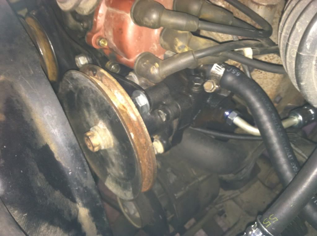

Here is the pump mounted up.Name:  396A727A-D110-4F14-B869-0ECD7C044507-37663-00002967AD7CE412.jpg
I didn't have mounting holes on the fender well, so I played around with the reservoir until it sat level and drilled three holes. I put bolts with large washers on the bottom side after painting the holes I drilled to deter rust.Name:  BCBED6F4-0F3B-459D-BB5A-1CC65530EA01-37663-00002967C5766264.jpg

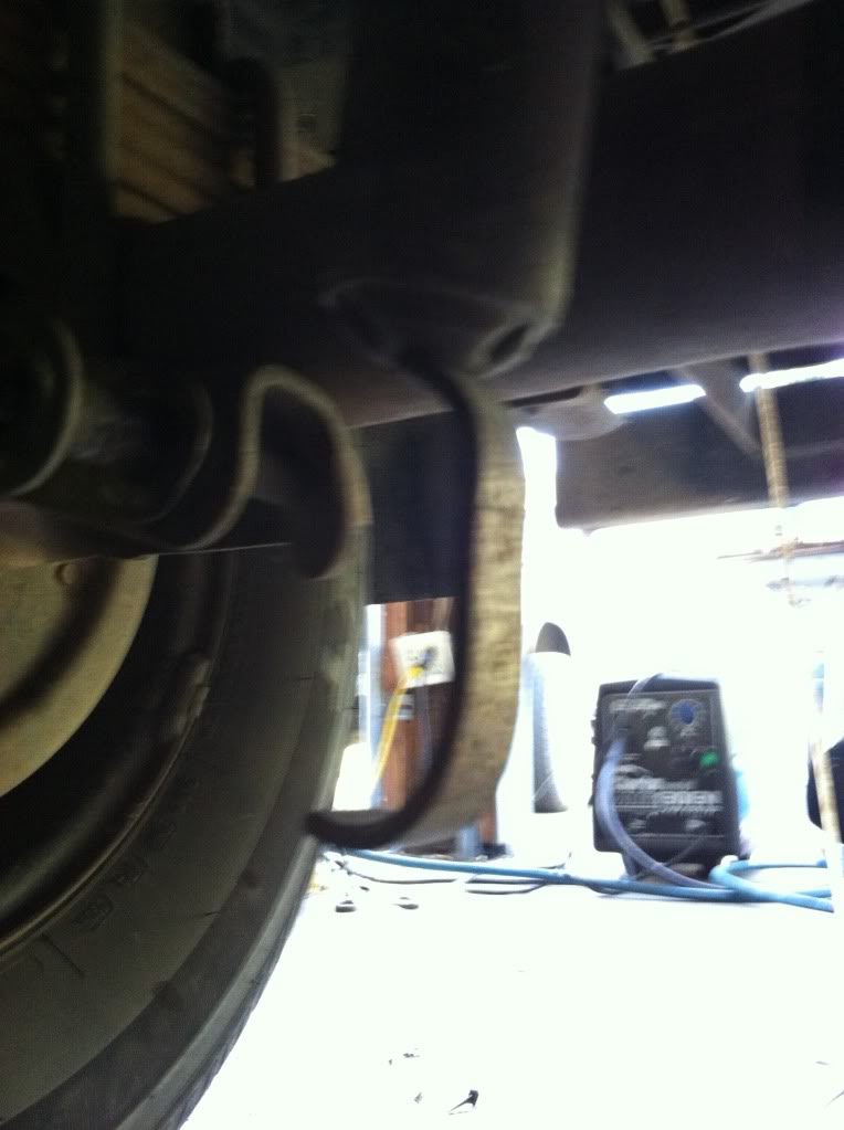

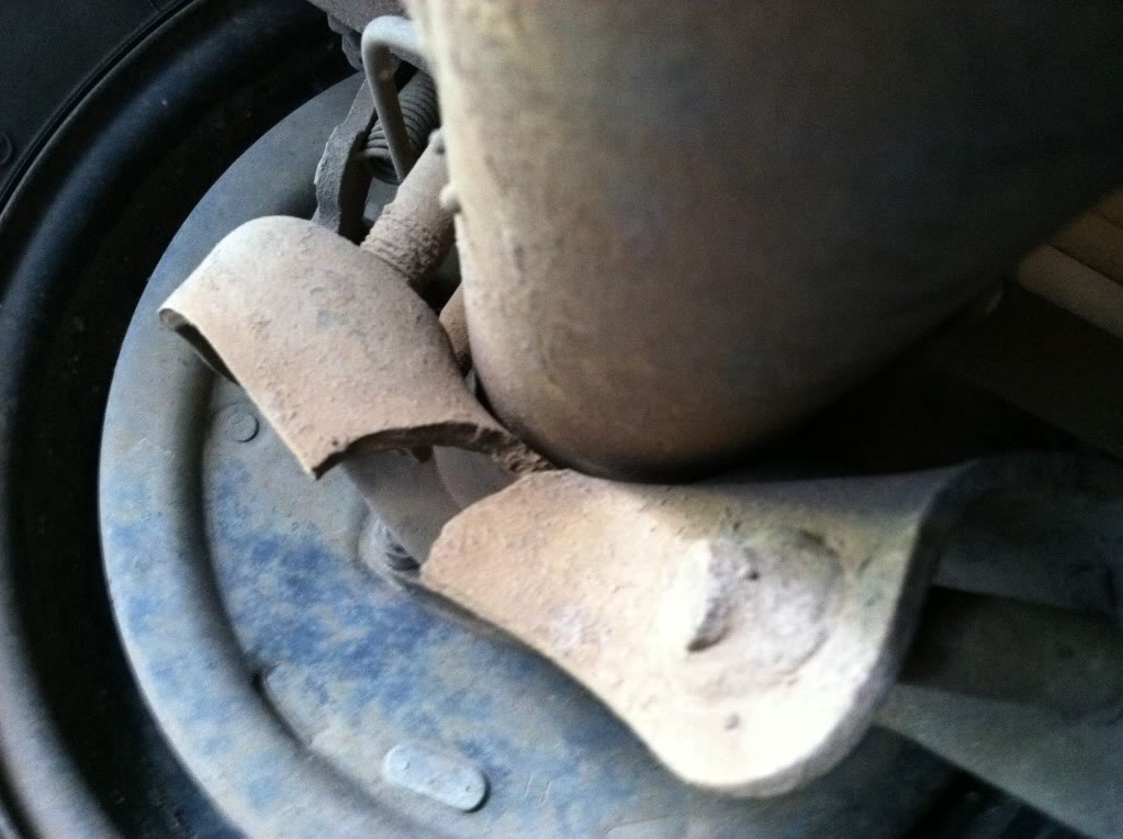

In the process of dealing with this, I was greeted with a split u bolt plate on the rear drivers side.Name:  F0DD4835-BB04-4914-BFEB-AB24DDE18D89-37663-000029678B71A88E.jpg

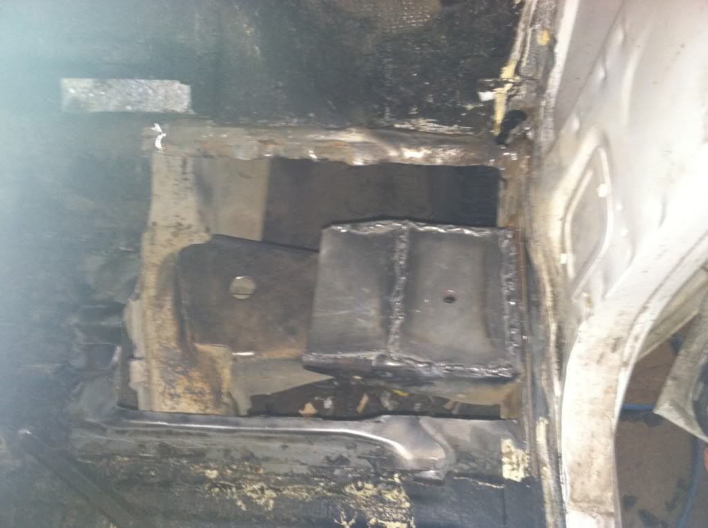

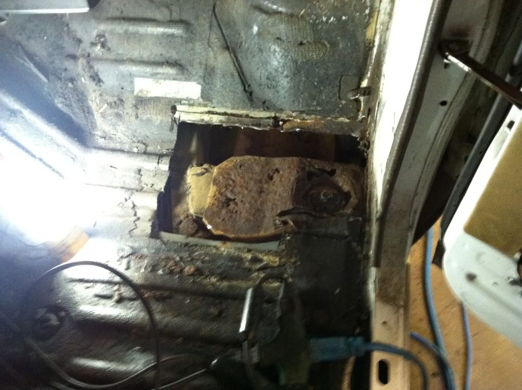

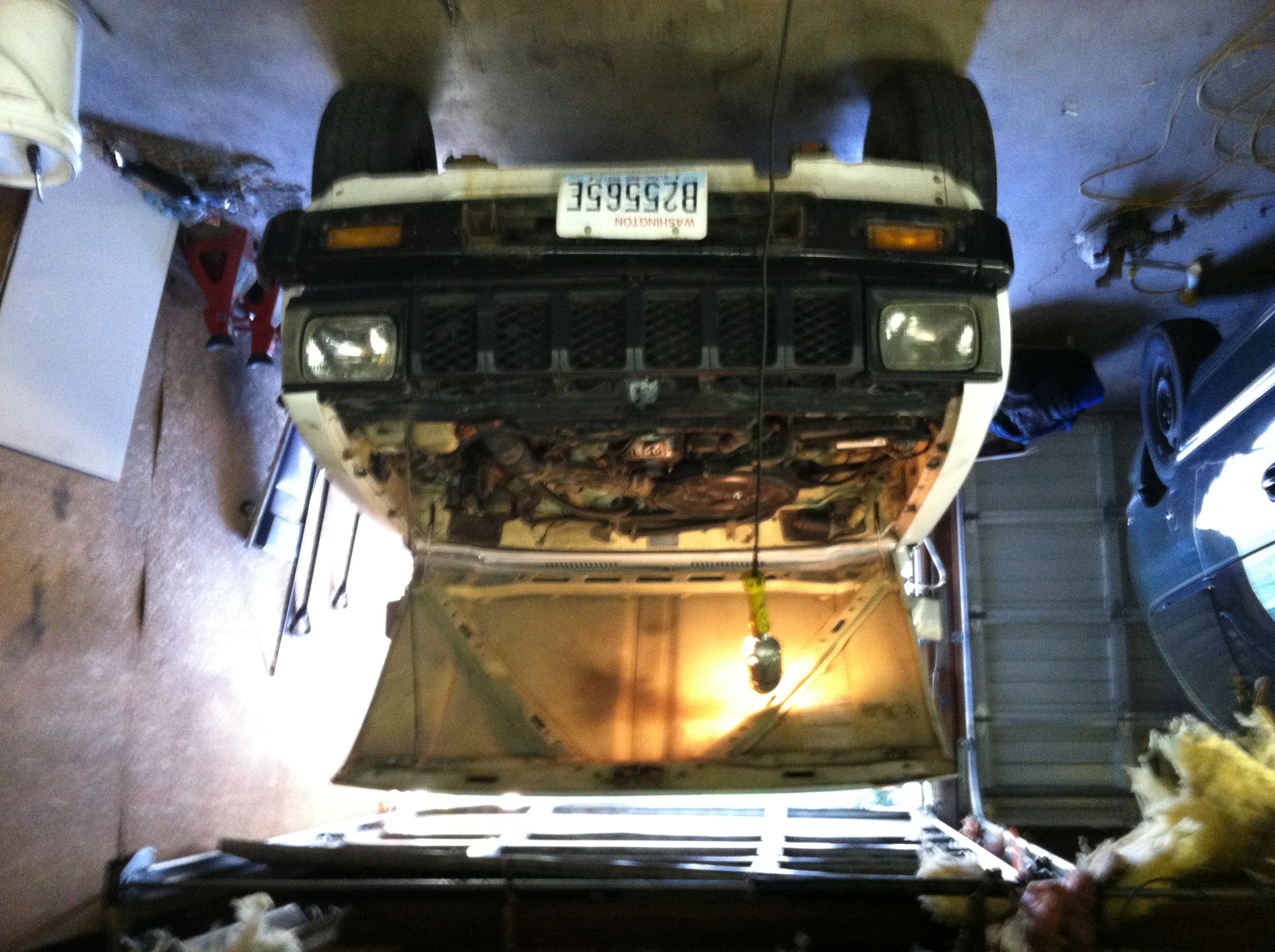

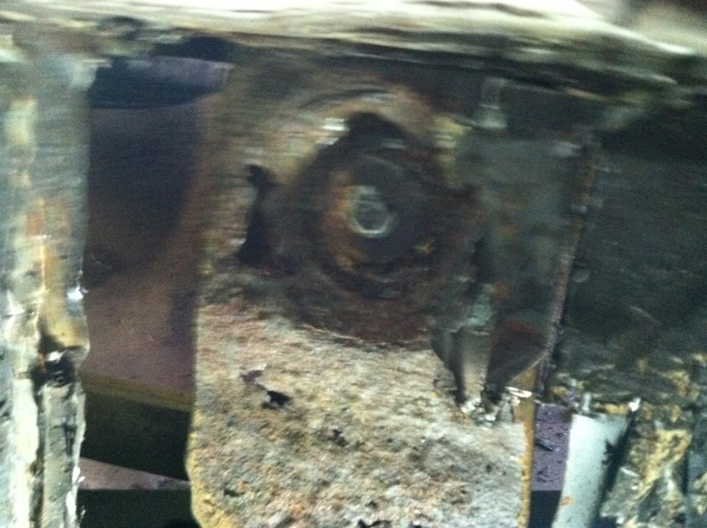

While doing my front shocks the other night, I bumped my elbow on the cab corner and found that a little bit of rusted metal flaked off. after digging at it for a second out of curiosity, I decided to pull up the carpet. This in on both sides. YAY!Name:  64A4B020-D651-4F9C-A088-AE3A6E863DD4-37663-000029677E0E4F29.jpg

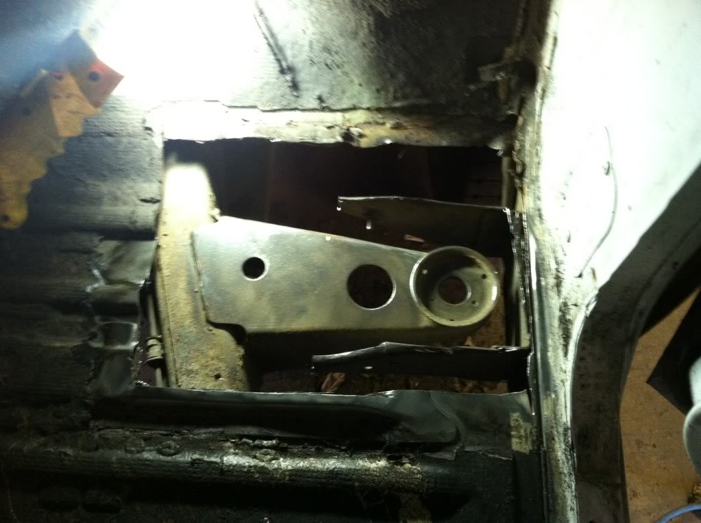

So I pulled my seat and carpet out, and started cutting like a drunk surgeon. All in all, the spots aren't too big, but it did eat out the top of my cab mounts pretty bad, but the sides are fine.Name:  5CE59E25-E7F9-4D9A-B45F-5916CAB23F47-37663-000029676C76E3BA.jpg
so I cut off the top and started cleaning up the sides. When I cut the top out, the sides towed out and I could feel that the metal was still really strong when I pushed it back into place.Name:  833C211A-F2F8-4BD5-A9BF-A5844CE5D80D-37663-000029675D14D208.jpg

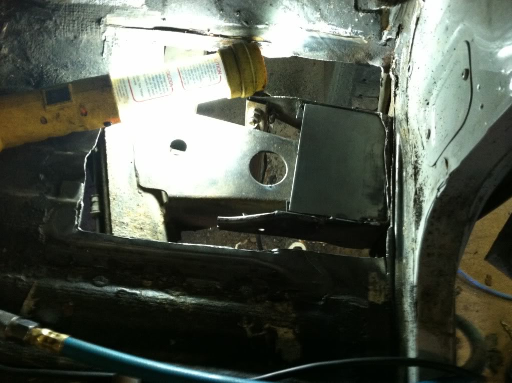

So here is the top of the two part plate I'm making for the body mount. I brought the sides together with a c clamp where the plate ends on the left. Underneath is 1/2 angle iron welded to the sides of the body mount to support the plate for the top. I forgot to take a pic, but I will get one when I do the drivers side on Tuesday.Name:  038198CE-F912-420A-AB8F-AA439241E275-37663-00002967505A6051.jpg
Here it is welded and hole drilled for the bushing. I used the bushing in place to measure the height of the top portion of the mount. It took a while to weld it because I had the bushing in place while welding. I didn't light it on fire though, so it was a success. I have some sheet metal from a set of fenders that I was thinking about cutting up for floor panels, but I have three days of this week, so I might go to the junkyard and cut a set of floorboards out of a 2wd if I can find some decent ones.Name:  3C80BA74-1946-4E31-A6DB-B9E566D2A794-37663-0000296743A1264E.jpg

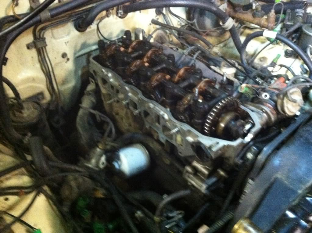

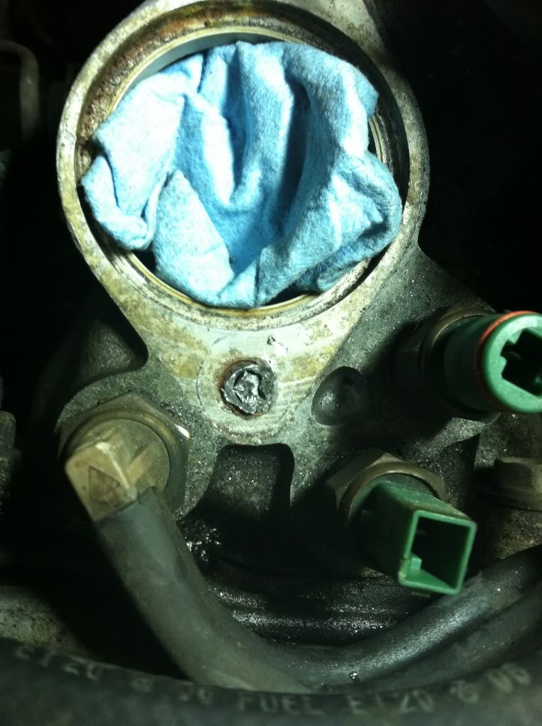

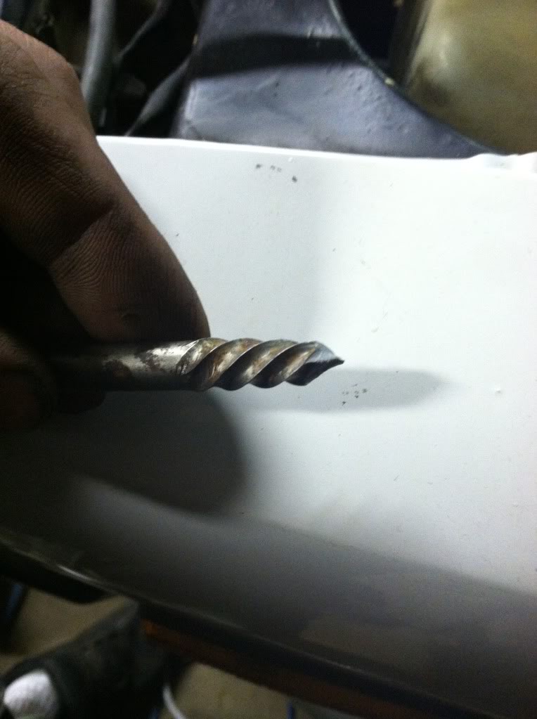

So I decided to replace my thermostat last night, and broke both bolts off. I removed one with a pair of nuts sandwiched together, but the other one broke off almost flush. So I drilled it and used an easy out to extract the bolt. But I shattered that too, leaving a significant chunk inside.Name:  2E1992E4-00C2-44FB-A555-4CF08CE04E73-39117-00002A6FA6A9930B.jpg

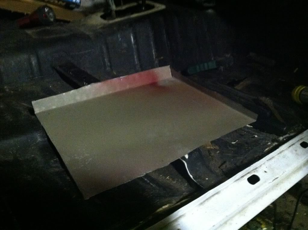

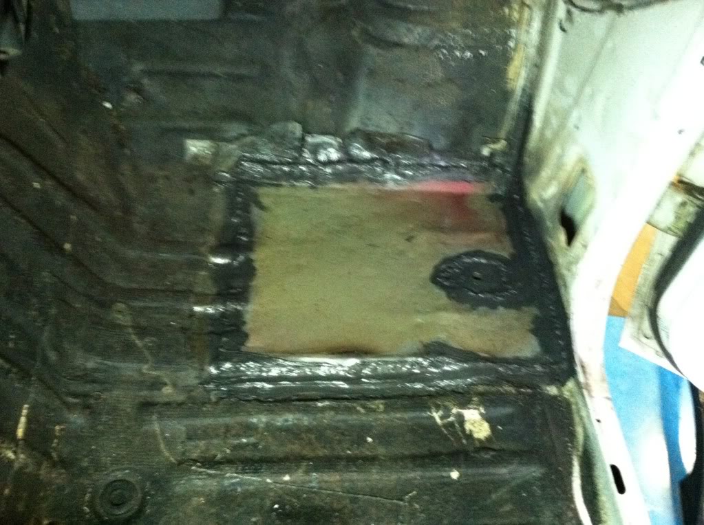

I made some progress on my passenger floor today. I have two more days off, so hopefully I can get the other side done by Thursday afternoon.
So this is the patch I roughed out last night with a pair of tin snips. It took me a while because it was super late and I doubt the neighbors would have appreciated the grinder at 1:00 am.

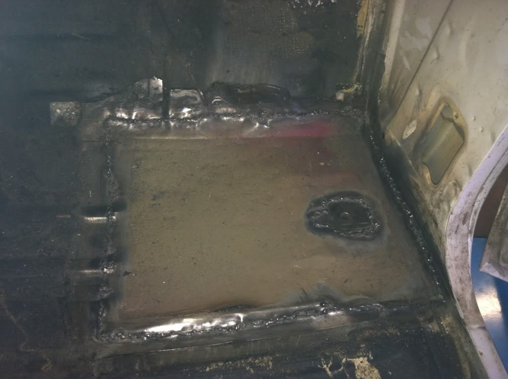

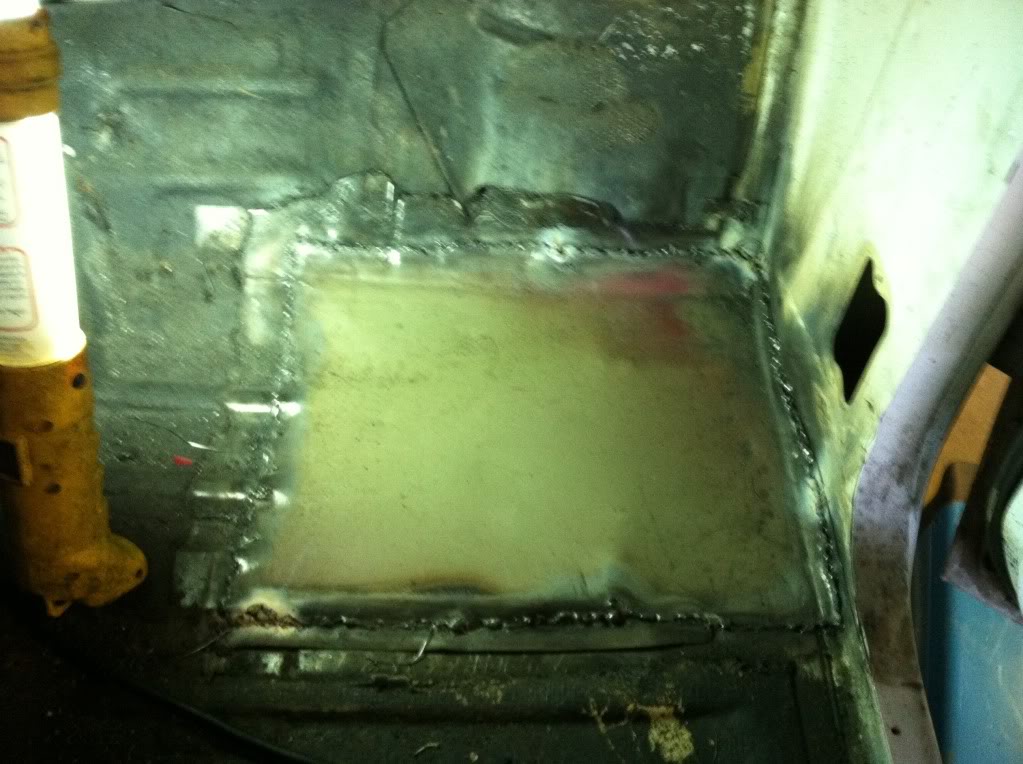

Here it is after about two hours of beating on it with a hammer and chisel and welded up. If you'll notice, I forgot to cut the hole out for the body mount bolt.
So, I decided to make an ugly hole for the bolt and washer to sit in. It's probably a good thing that nobody will ever see it again.
I decided to go ahead and rub some ultra black into the welds from the top since I'm going to paint the floor with some bedliner anyway.
I think I'm going to fill the edges along the bottom side of the cab with some fiberglass and re-enforce the panel before I Spray it with underbody spray.

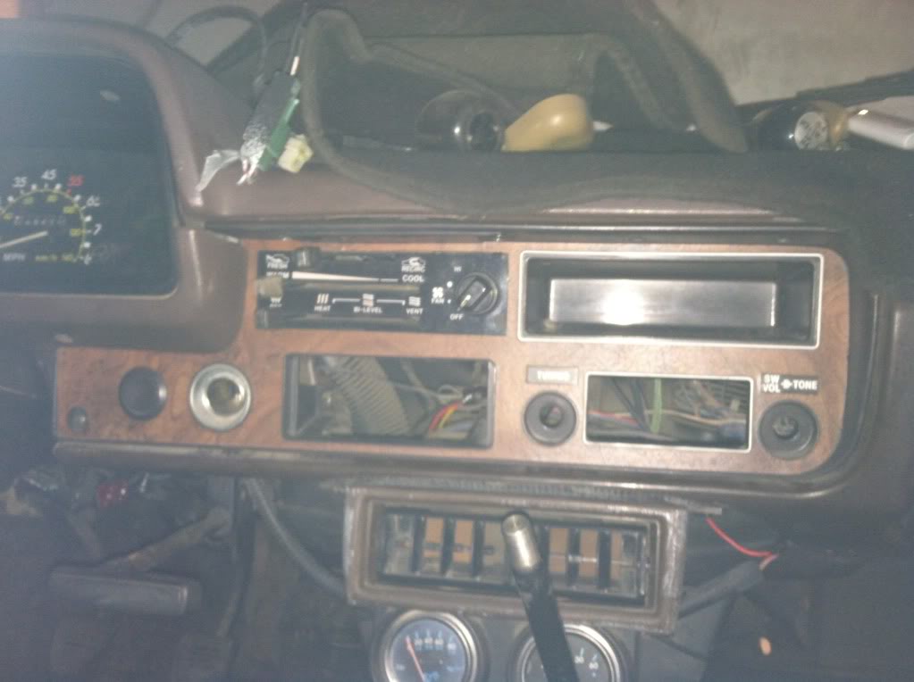

I know I haven't posted anything in a while, but I've been super busy with work. I have gotten quite a few things done on the truck also.

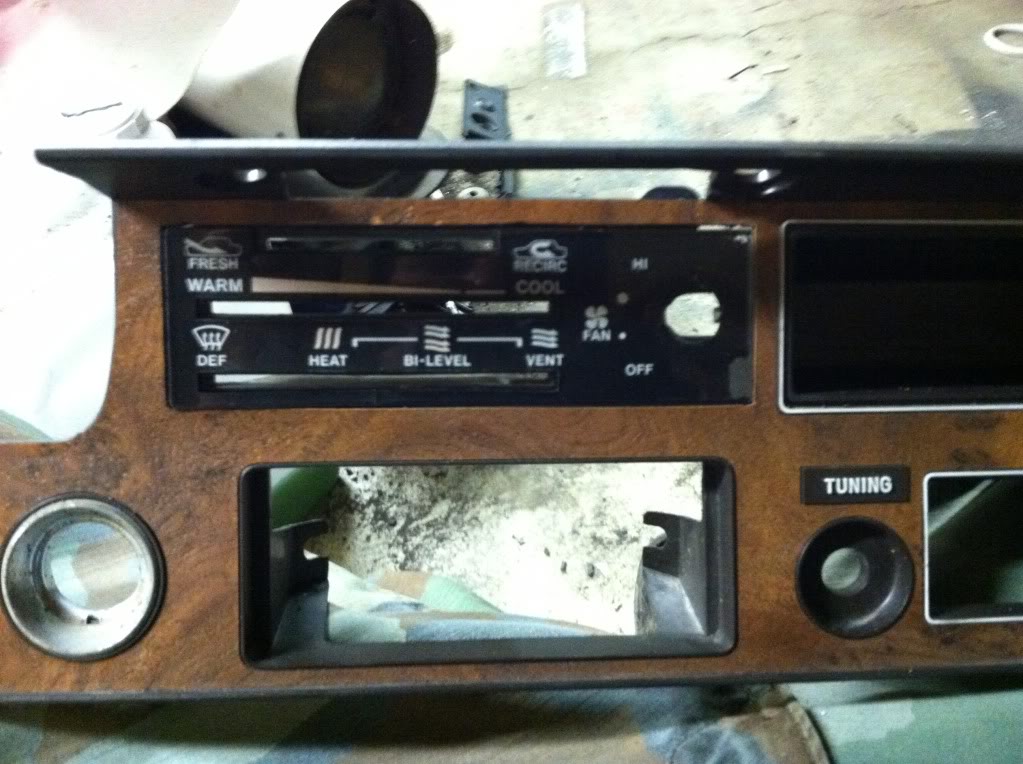

First, I took the complete trim I bought earlier this year and cut out the climate control section to replace it with the one from the 83'. I took forever with a dremel and a file to get it to look decent.
Then I took and cut the climate control mounts off of what was left of the original trim and epoxied them to the back side of the trim. It took forever, but it came out pretty decent.
Here is the final product. it's not perfect, but it's only noticeable if you are looking for defects in it.

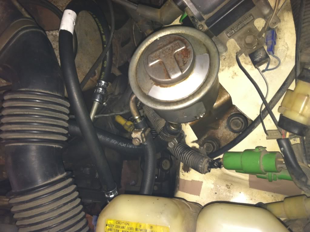

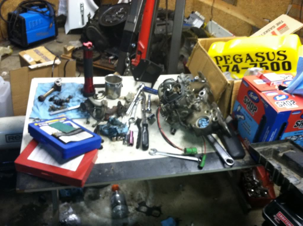

Since I destroyed my intake while changing my thermostat, I picked up another one off ebay and just outright replaced it. The only issue I came up on with that was my original intake was cali smog and the new one was federal. I bypassed everything for California smog and adjusted my valves at the same time.
This is the mess on my workbench in the middle of the intake swap.

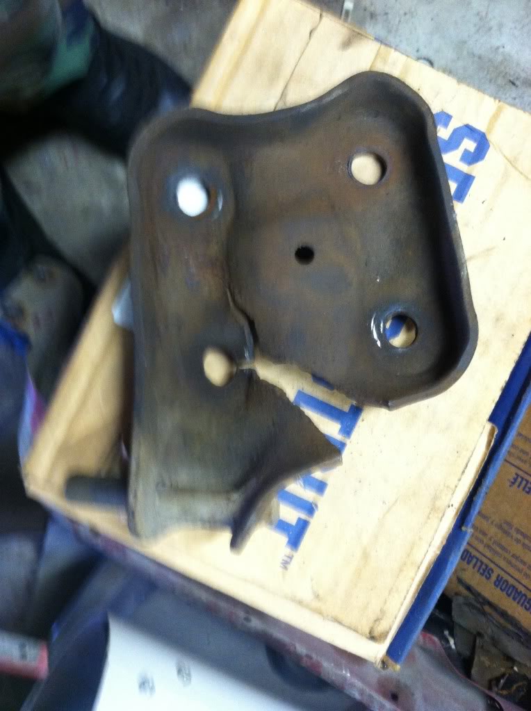

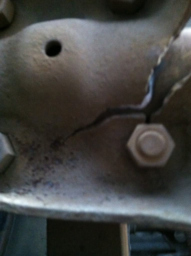

I also managed to find a new u bolt plate from yota jim, and here is the broken one.

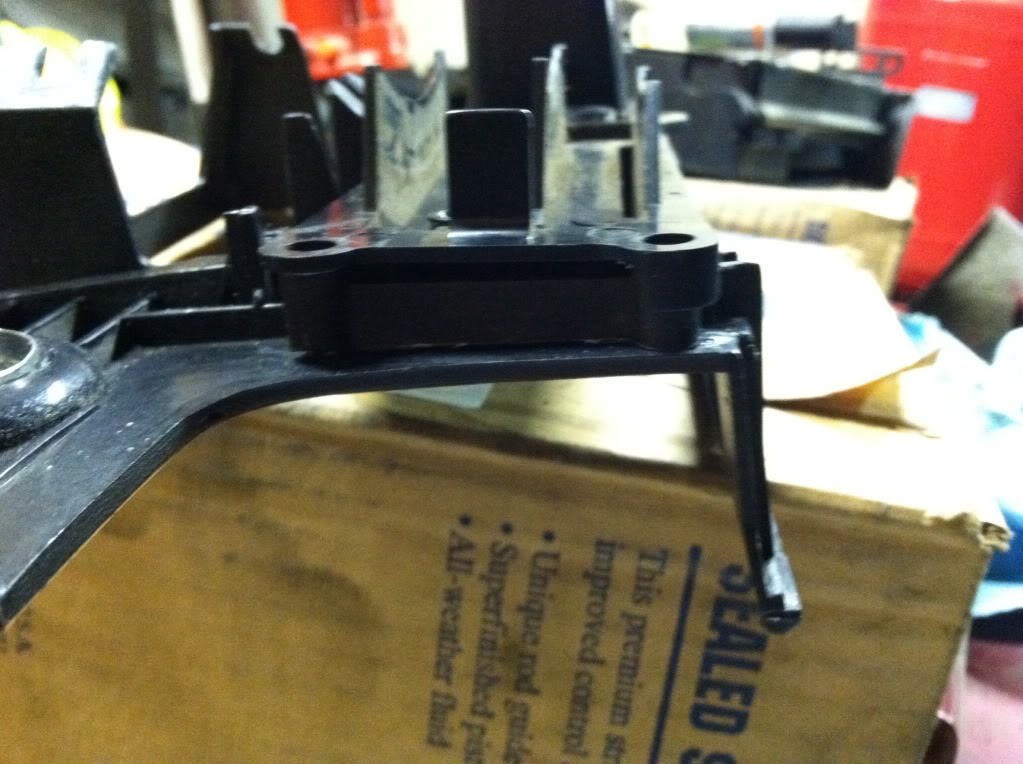

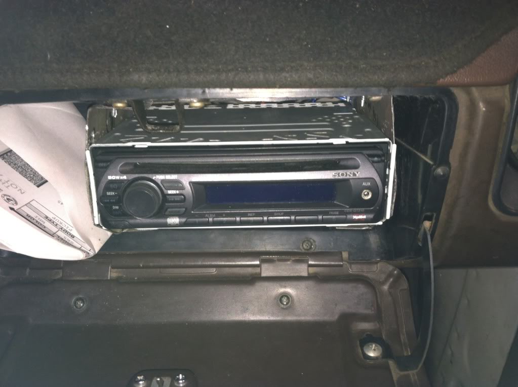

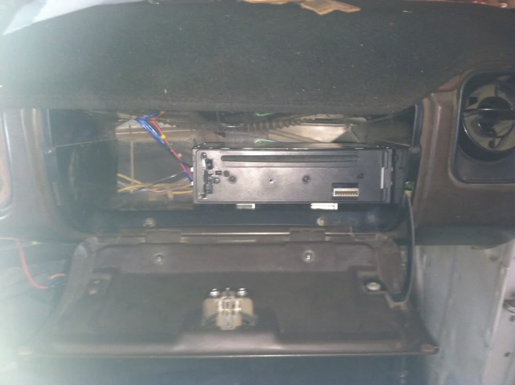

Here is the start of my stereo glove box mount. Its just mocked up on a wood block.
And it finished.

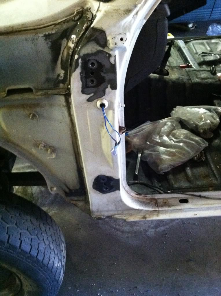

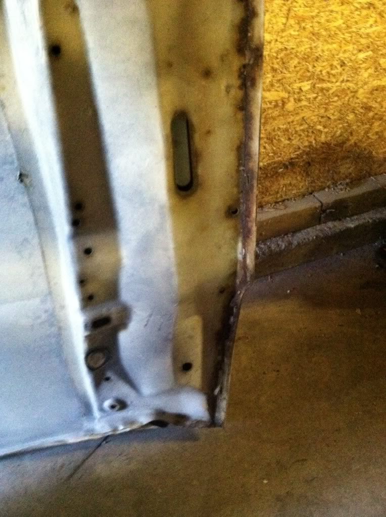

I found this under the front edge of my hood too. I'm not going to deal with it right now, but I think I'm going to cut it out and fill it after the winter mellows out.

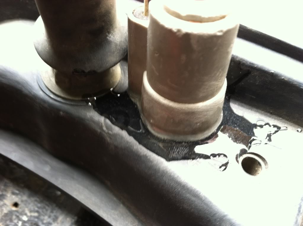

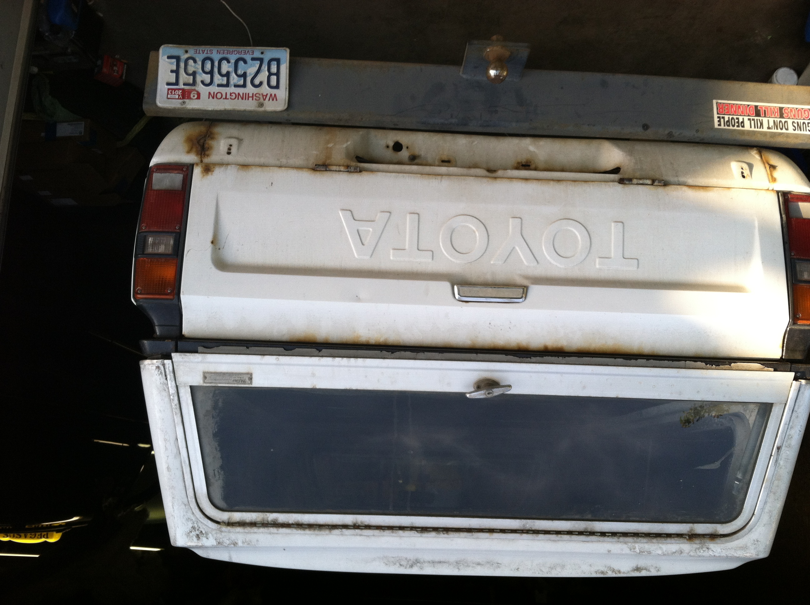

I know it's hard to see, but the PO decided to trim the cab seal for the canopy and did a terrible job of it. I got it pushed up against the cab enough to seal all of the way around.

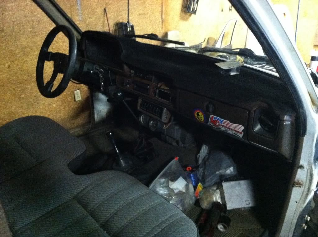

Here is my interior back in.

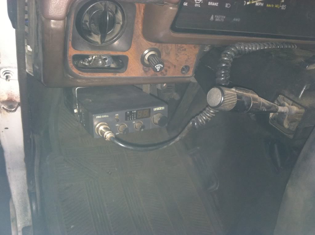

And my CB installed too. I have the whip mount and a new cable coming in Monday.

Lower Passanger corner of my window frame, there is another hole started outside of the frame as well.
The upper drivers side of the frame. This ended up being deeper than it looked. I had to cut out the face of the frames, then deeper to some on the structure underneathbetween the roof and door frame. I treated it with rust neutralizer after pulling the small bits out with some needle nose pliers.
This is the drivers side seam under the dash after removing the caulk. It looks like water was travelling behind the caulking.
This is above the previous photo up to the window frame.
This is the passanger side where the window frame rusted through into the cab. It was dripping off my dash bolt, which broke when i removed the dash.
Repaired passanger floor. I had a few chunks of mild 1/8" plate i stashed at work and a Pirahna press did all of the work for me.
Drivers side was a bit smaller of a section, but I had to cut the floor all of the wasy to the seam at the edge of my door jam.
I know its not pretty, but it will hold a window. Of course everything was super close to the brazing. I also filled the whole that was under the edge of my fender at the window line.
This was the large hole at the top drivers sidey cab, it ended up being three pieces. I know it looks like poo, but it is solid and you wont notice when I do the body filler.
