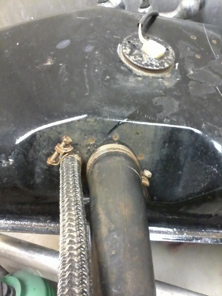

While working on the back half. I wanted to paint the fuel tank. Decided while I had it out may as well as check the float and see what rust was like in the tank. Glad I did.
The float was frozen solid. I put the rust dissolver on it and had it working in 2 minutes. I am really starting to like this brand over PB Blaster. Here it is frozen up with rust. Fuel filter is hard as a rock also.
Cleaned up.
Reference pictures for reassembly.

I had to clean the pickup line as well. I have cleaned tanks before. Found some ways on the web. I am going to use vinegar for a few days and then coat it with Red Coat. Did this on my 88 and worked out great.
Got the spare tire carrier soaking and getting it cleaned up to go back on. Seen someone at one time made a thread on preventive maintainace on the spare tire carrier.

Different links to cleaning a fuel tank.
http://www.mopedarmy.com/wiki/Removi...rom_a_gas_tank
http://www.ehow.com/how_4540637_remo...-gas-tank.html
http://www.vjmog.com/ftopict-3687.html
These are just some I have found. I did the vinegar and it turned it to a powder and then I coated it with Red Kote. I will let it soak a few days in vinegar. To bad i cant get a good pic of before and after. It works really good.

I got the tank soaking. Will let it soak for a few days and give it a good rinsing. Funny thing is, alot of this is quite similar to my 88 restore.

Checked on my fuel tank. It is starting to get some shiny spots in there. Another day or so and think it will be done. I will try and get some pics. Then I will get some coating for the tank and get it on the truck.
