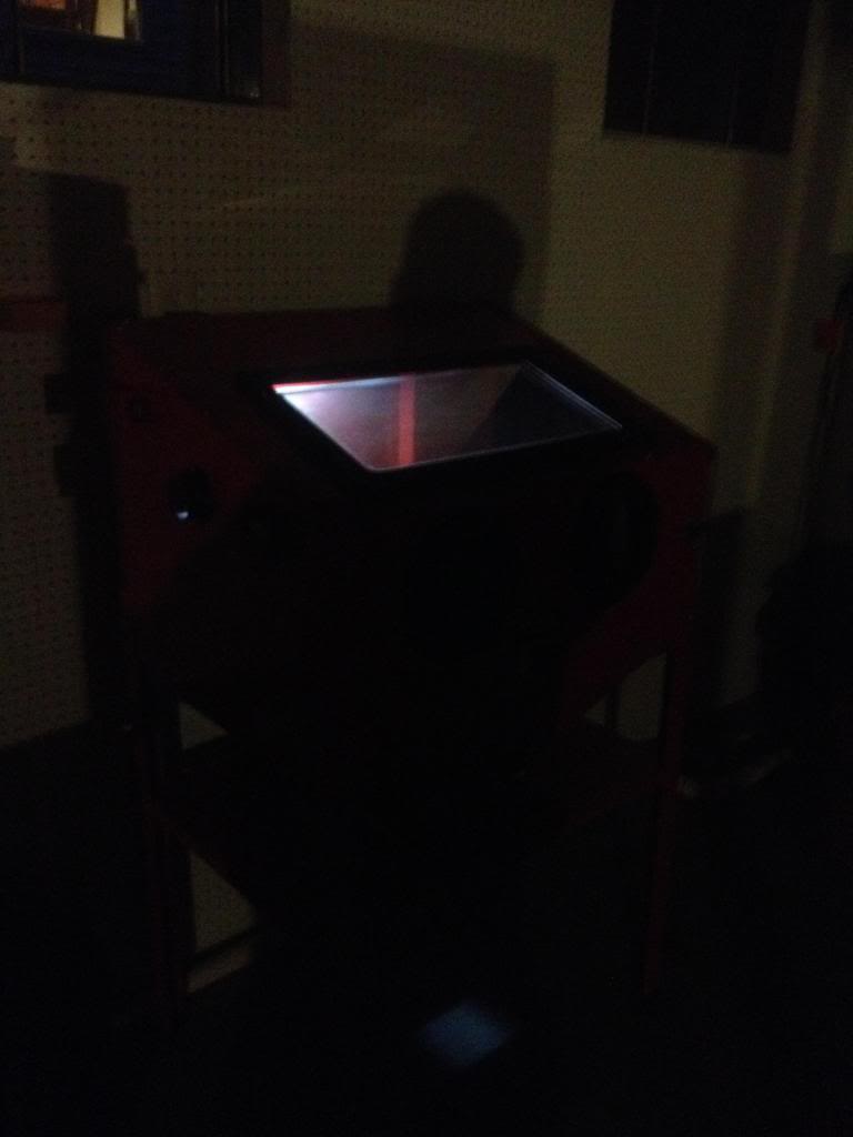

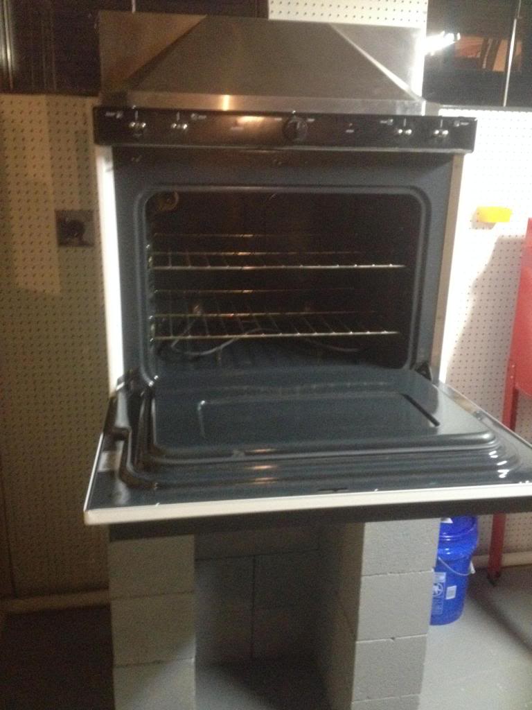

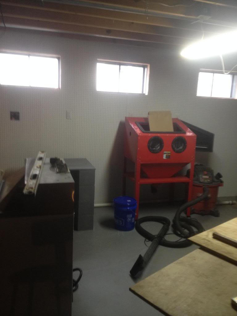

Got more done today with wife's help.

looks good brutha .. make sure you have some water traps or desicants . the sand really dosnt like water at all !
liken' the hood on the stove as well .. will the vent to the outside ? I cut up my stove racks , I found the "stock" ones didn't suite me

Very nicely done! I'm with Corey on the oven racks - they work for some pieces, but can be a real pain in the ass. I ended up drilling a dozen holes in the top of the oven and put in some hooks so that I have options for hanging parts.

Corey...yup. I have 3 new super duper water separators. Running 50 or so feet of 1/2 copper hung from workshop ceiling...will have a short length of hose to the compressor...then the 50 feet will run to a t...shooting back up to garage...then the other line to the blaster cabinet wall..ill do a run there with a separator there then a coupler or 2 and a ball drain valve at the bottom.
With 50 feet of copper line to condense out the water and the separator, I should have nice dry air for blaster and pc gun.
The range hood will be run to the middle window...which I will replace with some 3/4 marine plywood painted with a good outdoor enamel. It will have 2 dryer vents to the outside. One from range hood...one from spray cabinet.
Dave...good idea on the hooks.

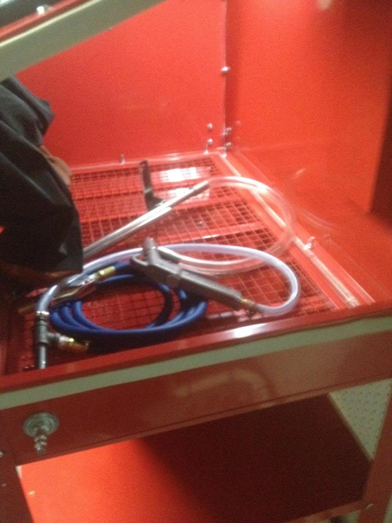

Almost forgot...this is the upgraded blast gun and pickup tube as well as the in cabinet blow off gun to clean parts of debris before you open door. From TP tools. Huge improvement over harbor freight blast gun.

I went with PVC (200PSI rated) instead of the copper , just better pricing for me !
I also added "down pipes" to additionally "trap" moisture .. worked great , but I now have an air drier .. although excess for a home shop , and I'm not a home shop .. this is by far the best purchace for dry air yet , for me .
also .. the less hose you have in your cabinet , the more you'll like it ... there is little room in there as is ...
