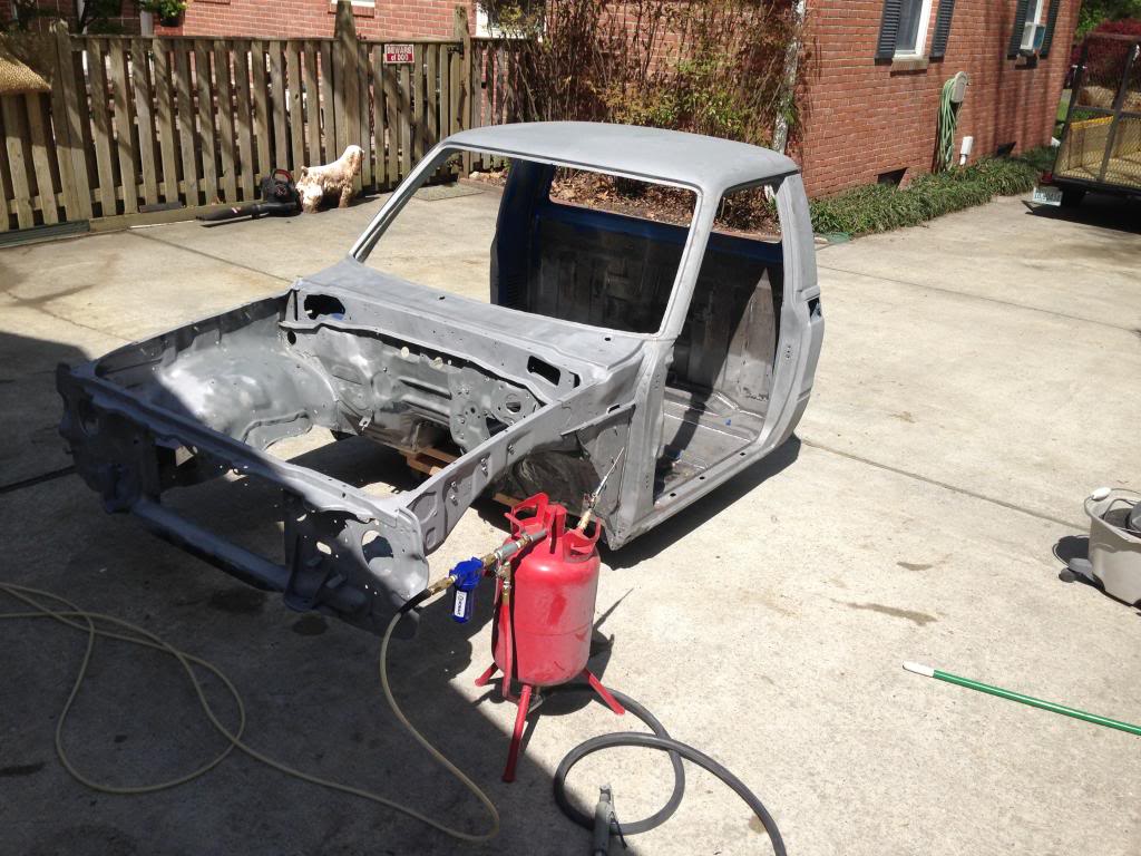

Another friend dropped by out of the blue Monday on his way to work. He works at an aircraft part place that makes stuff from titanium. I showed him my powder coat set up and him being a Mustang guy was pretty excited.
I had showed him the tp tools blast gun I upgraded my harbor freight cabinet with and the tips I use. I told him I need to order more tips becaue the ones I have wear out pretty quick with the 70 grit aluminum oxide I have in the cabinet. He says they blast a lot at work and the tips look to be the same size.
Next day he pops by again. Has a handful of titanium tips for me...and a blast gun they had extra. This gun has the tips on the inside...just like this gun...
This will be for my outside blasting of large parts ie: frame cab.
Now I need to figure out what I need as far as a pickup tube If I am just drawing sand from a bucket. Kawasaki...your ears burning?

Yep, they be burning... And they don't like hearing that your going to try to attempt to blast your frame with a siphon gun. Trust me, you don't want to go down that road - been there, tried that, never again! The cheap 20 or 40 lb pressurized blasters from HF are the way to go. Just slap a deadman valve on it to get rid of the cheap ball valve they use for a nozzle and you're good to go.

School me on the pressurized tank deal. I dont understand about that. How do they work.
Whats wrong with a set up similar to whats in my blast cabinet?

Scope them out on HF and you'll get a better idea. The media goes into a tank (kinda looks like a propane cylinder) and the air inlet goes to the tank and around the tank to a valve at the bottom of the tank where the media is despersed into the flow of air to the nozzle. The design uses gravity and pressure to inject media into the air stream that goes to the nozzle and out on to the part being stripped. So instead of esssentially creating a vacuum like a siphon setup to suck up media, you are getting a constant flow of air with a volume of media that can be controlled with a valve. Here's my 20 lb blaster:
