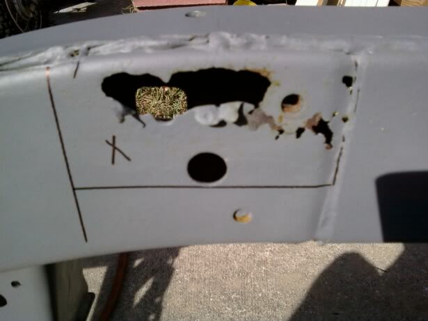

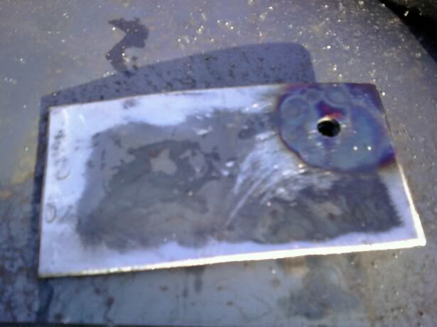

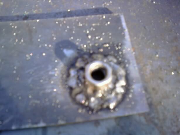

i had a few spare minutes and needed to patch an inside portion of the frame today so here it is.
cut out the bad section, cut a new piece from 1/8 stock.
drilled for the mount and welded the new nut on the backside.
pics are from my phone and it seems i lost the last few shots so i will get one of the finished product tomorrow since my phone has no flash. dude! i need some more practice for sure on the welder. check out the splatter-potomous

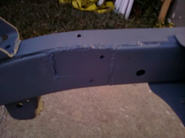

here is the "almost" finished product. sprayed some primer on it for the night. looks like i have some grinding to do tomorrow.

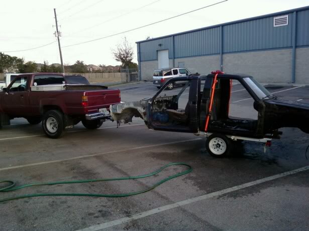

the 83 is pretty clean despite the fact it was a mud bogger. i just hosed out a yard of dirt from the inside today to see what the floor looked like. eh, not too bad . back to work on the 81 tomorrow. weather is supposed to be perfect!

Those little trailers come in handy for parts runs to the carwash. I know what you mean by the wife sometimes "not happy". lol. That is another reason to keep moving forward. Looking like you will be reassembling here soon.

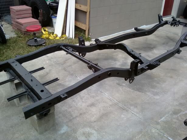

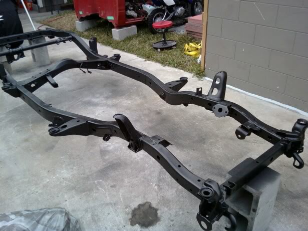

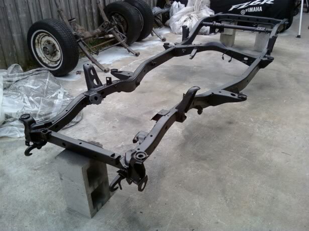

i had all the welding/patching done last night and it was ready for finish coat. i had considered painting the frame but then thought, i'd be pretty pissed off if i chipped it on the reassembly. then considered sending the frame to the powder coat dude down the road, but he wanted an arm and a leg. so i went with 3m undercoating right over the primer. i have used this stuff on all my 4 wheelers and even a couple boat trailers we have taken to the salt water and it has held up very well. so here is the finished product. still waiting for my bushing set to come in. but now i can hopefully start the cab floor and other misc body repair/replacements.

Old Jan 15, 2011 | 04:05 PM

did ya hit the inside ?

Man that looks good! Thanks for sharing what you used on the frame. I have been debating for a couple months on what to use on my 83 frame when I get that far. I looked at chemical dipping it-5-600.00, then it would need top coat. Top coat could be powder coating (3-400) and the finish is not easy to clean up and touch up is impossible. I looked at Linex, but 5-600 for frame and would be taxtured; again hard to touch up. I looked at POR 15, but is not resistant to UV rays and the chemical stripping company told me it was garbage (not sure I agree since I haven't used it) I also looked at DTM (direct to metal) paint with and without primer.
I never thought about the 3M undercoating over the primer. I am going to investigate it and maybe go with that instead. Did you use a sandable primier or an epoxy sealer primer on the frame?

Originally Posted by slacker
looks good brutha !! ..
thanks man! i did por15 the inside but only had a quart so i went the undercoating route on the outside. feels great to have something done
thanks paul, i'll get some close ups tomorrow with my camera instead of my phone, it sprays on really heavy but flows out real good and smooth. i guess it comes down to the prep work.
i used a sandable primer, the 3m undercoating cans say spray directly on bare metal or primed surfaces, so i figured i'd be ok. i have even used it on painted surfaces before and it adheres really well, and its so easy to touch up if needed. plus my home depot had it for 3.99 a can so the whole deal cost me less than 25 bones.

The number I gave you is my cell, so anytime is a good time. 7:00 am until 10:00pm my time (Pacific) will work just fine.
I like the idea of 25.00 for a frame redo. SOunds better than a thousand or more. We have lot of bad weather here, so I may try and experiment with some differnet products, trying them on both primed and bare metal, then set them outside and see what happens with all the rain.
Man I miss the sun.

The finish looks nice on that frame. No pitting or roughness. Looks smooth.

frame looks awesome...almost like just off the assembly line

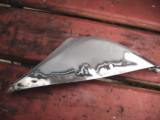

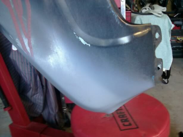

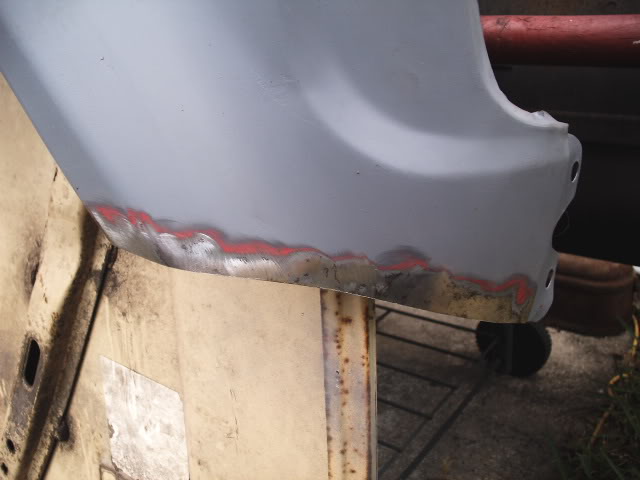

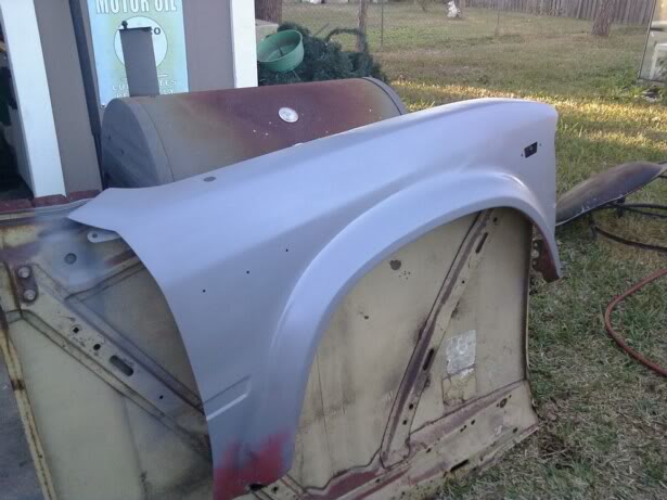

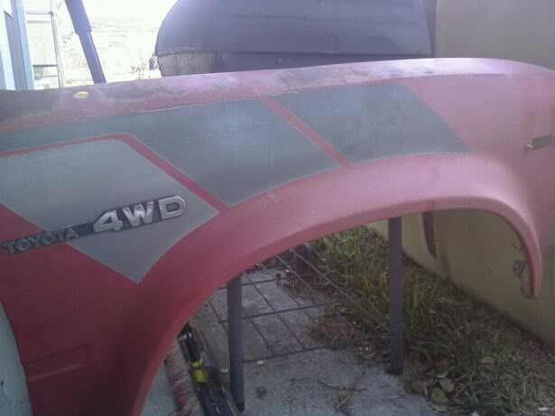

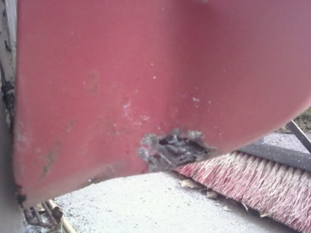

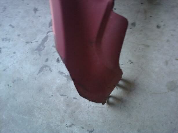

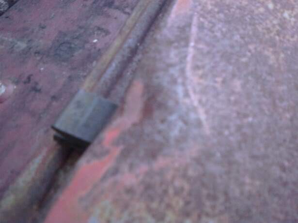

saved another piece of steel

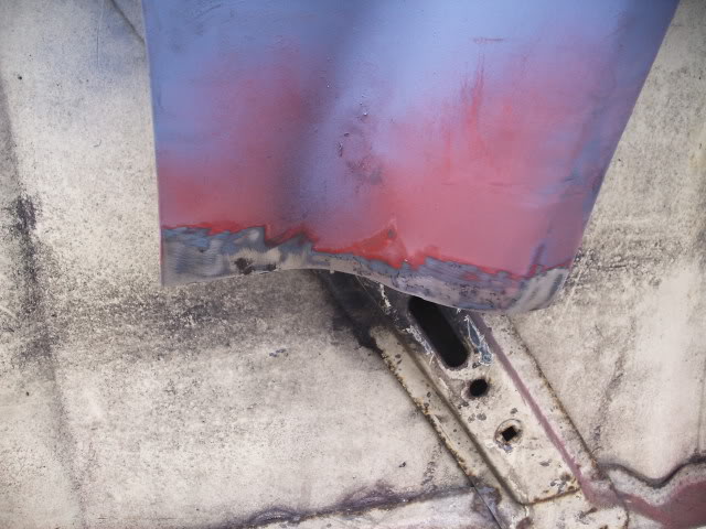

i worked on the passenger fender today. had a few pretty heavy dings in it and a crease on the top edge where it looked like someone closed the hood with a wrench on the fender.
i was careful with the propane torch just to heat the metal up enough to mold it better. the hammer and dolly set i got for christmas is now coming in handy. then removed the old decals and block sanded the fender for an hour or so. no filler just yet, im going to wait til the welding is done in case i get some warpage.
the previous owner had also cut the bottom front of the fenders for clearance. i'll be fixing that with a piece from an extra panel. also the lower cab side where the rust is all the way thru. sure am glad i have some extra panels around to cut up for the repairs as i will be welding those pieces on.
this fender is not ready for the recycler just yet

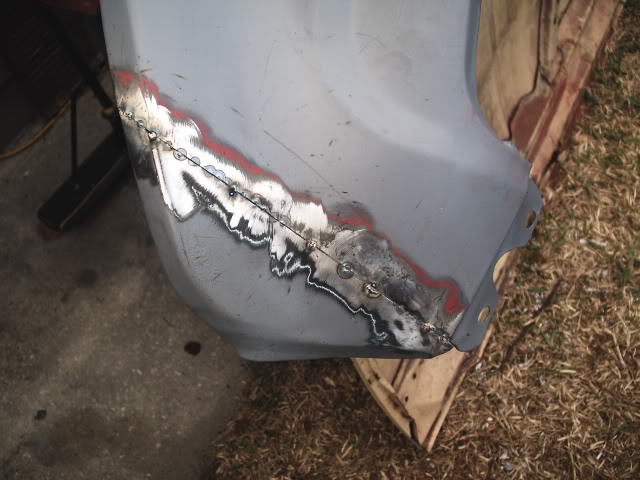

here is the progress for the day: cut the bad sections of the fender, lower right, and lower left, and also cut off the section from the donor fender. got it tacked up for the night. love the cool winter but hate the fact its gets dark at 5pm. too many explosives in the garage to be welding in there
