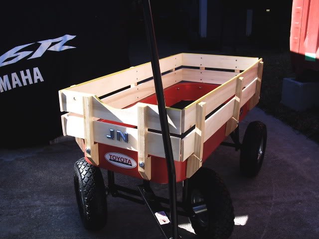

didnt get much done on my 81 but worked a bit on a project a little more near to my heart. my grandaughters christmas gift.
complete with pneumatic tires, custom badging, and a top rail paint job.

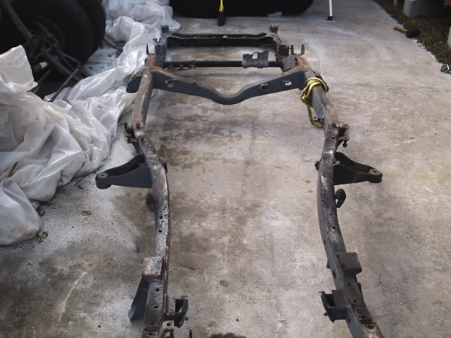

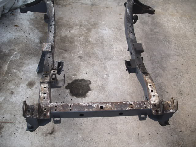

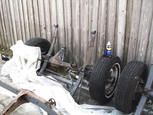

with another day of good weather and a little luck my tiny air compressor holds up, i will be able to finish media blasting the bottom of the frame tomorrow.
inside rails- done
top and sides- done
bottom- fingers crossed
then its time for the fun stuff, rebuilding the front and rear ends, and new bushings all around.

little suggestion for ya ..
take a rasp or die grinder and "clean up" the insides of the bushing supports .. makes for new bushing incersion much smoother + it will help your new bushings last longer , same as for the springs , if your reusing them ?

Originally Posted by slacker
lookin' good !!
thank corey, and thanks for the tip! yep, gonna keep these springs. where did you end up getting your black bushings from?

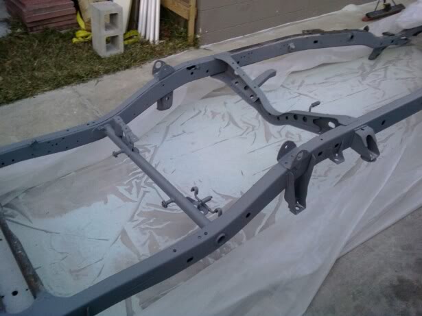

never thought it would take this long, but i can see the light at the end of the tunnel now as far as the frame is concerned. another 5' section on the bottom of the passenger side rail, and its ready for the bushings .

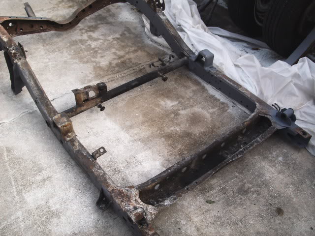

seems like it has taken a year, but the media blasting is completely finished. time to por15 the inside rails. hopefully tomorrow. next time i feel like doing this i'll make sure i find a friends house to make this mess at and definately have an industrial size compressor.
